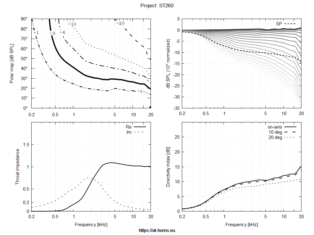

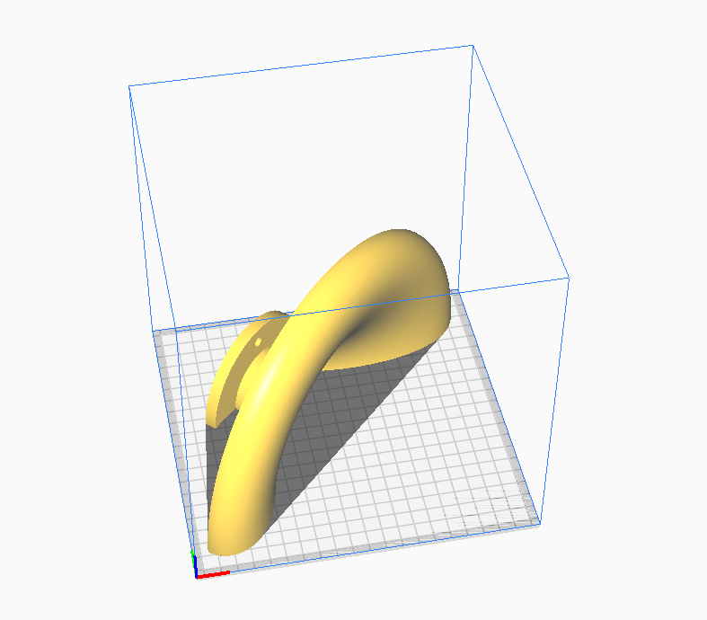

To have some fun and to encourage people to actually try a free standing waveguide, I decided to release my first "serious" design of this type (was already measured here some time ago with several drivers).
It is called ST260 (ST = Small Teaser), cca ⌀260 mm x 83 mm.
Throat entry angle is 19° and should work well with majority of 1" drivers.
STEP and STL files of the ready-to-print waveguide available: https://at-horns.eu/release/ST260.zip
Have fun and give us a feedback!

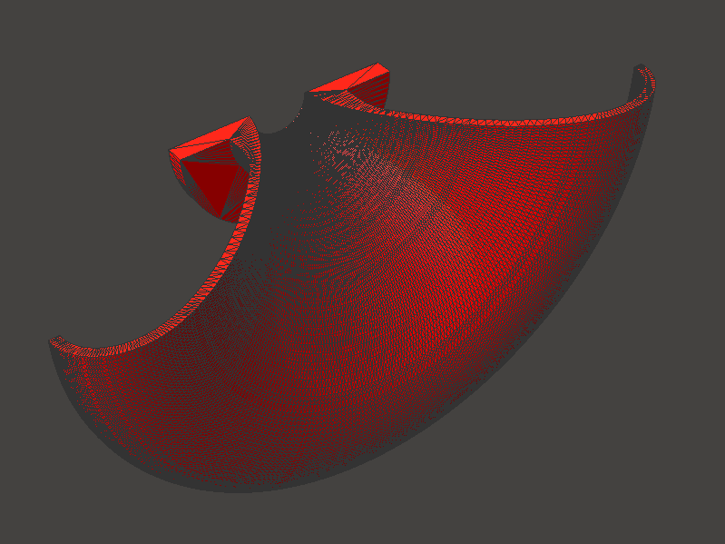

High-resolution 1/2 STL added: https://at-horns.eu/release/ST260.zip

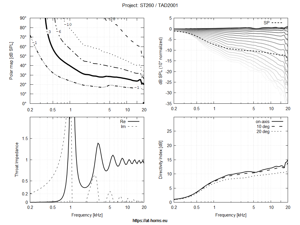

Would this Small Teaser work with TAD2001?
I believe it has a very narrow 3.6degree throat angle.

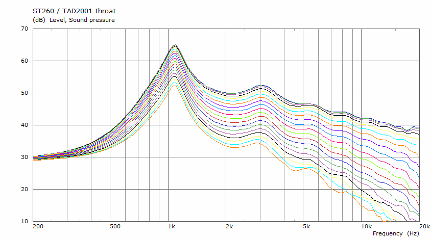

You could try it, the polars are still good, but be carefull about EQ as it will probably tend to ring horrendously on several frequencies (and this could be corrected if done right). Matching the entry angle would not change much in this case, I've just tried that.Would this Small Teaser work with TAD2001?
Below is a simulation of ST260 with the TAD2001 throat added.
You would probably need something like a JMLC horn for this kind of driver (I could do it with OS-SE but it would beam terribly.)

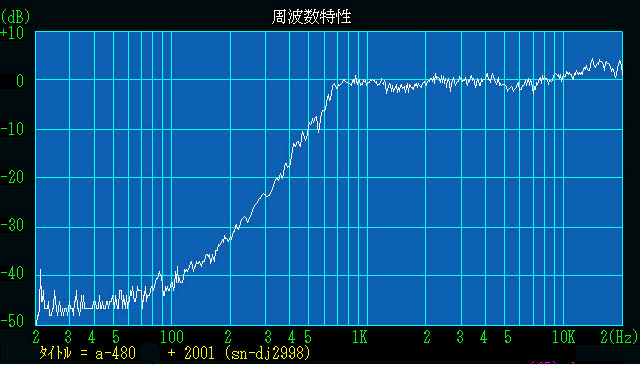

TD-2001 + Arai 480:
