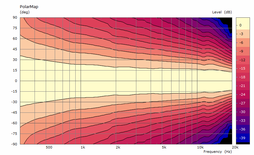

Were the sims of this wg posted previously?
What are the dimensions?

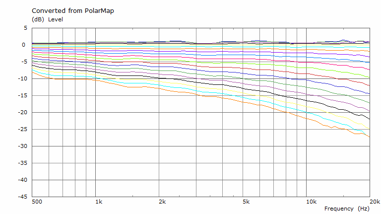

No, I don't think they were. They are around 500 x 200 mm. This is the polar map and all I'll show. To stay competitive I'll have to come up with more compelling and mysterious stories than a bunch of data 🙂

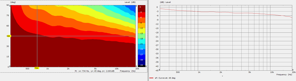

BTW, I tried to simulate a throat extension plug (bridging over the driver's conical exit section) for FANE CD131, which is quite a nice 1" driver. It has a 3-slot phase plug ending at ⌀16 mm and 30° conical exit. Extending the waveguide profile down to the phase plug ending, these are the results for a ⌀320 x 120 mm free standing waveguide based on the latest advancements:

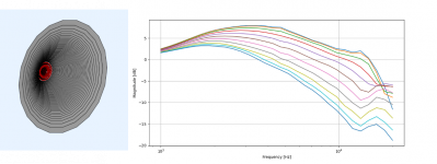

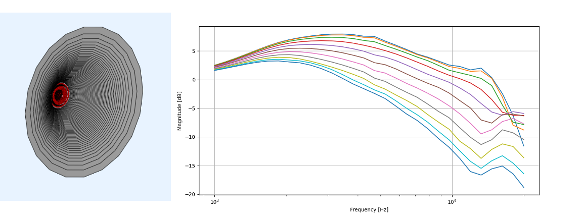

I have a question regarding dome tweeters vs compression drivers in waveguides. I have problems getting a smooth response >10kHz when using domes as a sources. The larger the dome (and throat diameter) the lower in frequency the problem arises.

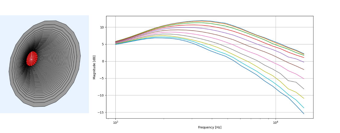

As an example this is the response from a small 150mm diameter waveguide with a flat source moving axially (1" throat diameter):
And this is the same waveguide with a tiny dome source instead (still 1" throat):
Is this a problem in reality? What are the pros of using a dome tweeter instead of a compression driver in general? (after all there exists alot of waveguide loaded dome tweeters)
I wound up using the Tymphany NE19 VTS for many of my waveguide projects, largely for the reasons that you saw in your simulations. Basically there's a very good chance that the waveguide will have a dip in the response, when you use a tweeter that's larger than about 3/4"-5/8".

@Patrick Ok, it definitely seems trickier with larger domes.

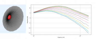

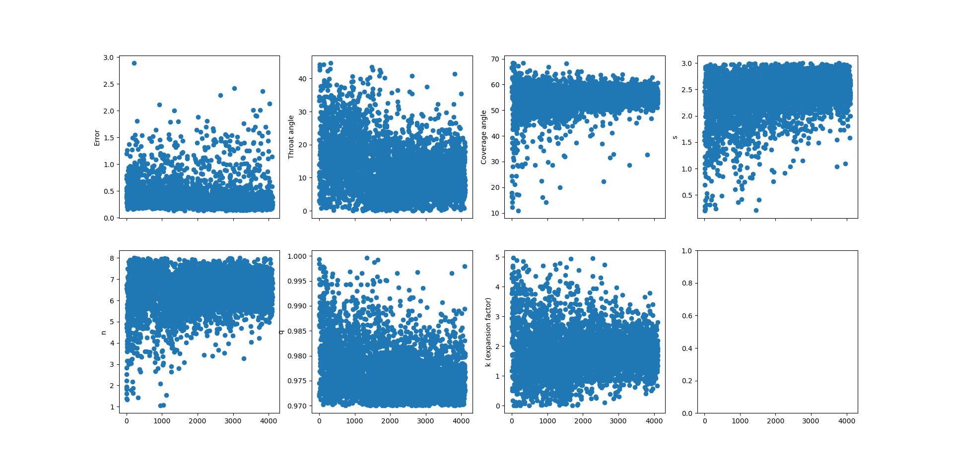

The above waveguide was the result of an first attempt at an optimization using an differential evolution algorithm. Basically it will fiddle around with the parameters in Mabats magic waveguide formula (creating combinations based on evolution), generate an ABEC project with the new parameters, simulate it and evaluate the results by calculate an directivity error. The objective of the algoritm is then to find the parameters that minimizes this error (0=perfect directivity)
I let it run over night and it produced something like 4000 simulations, here is a plot of all simulated combinations (you can see some trends of where the parameters are heading):
However when I tried doing the same thing but with a dome I got garbage since the algorithm did everything it could to reduce these 10kHz resonances, hence my questions above. Guess I have to refine my objective function for those cases
(Bonus animation of the profile for the first 100 iterations):
Wow, now this is something, finally someone has done it. I wish I knew how to do this - I considered it to be very difficult due to the interactive nature of ABEC and VACS. Do you use some sort of GUI automation to control the app? I used to use AutoIt for HolmImpulse automation, maybe that could work too.
I think you can safely make at least the 'q' fixed. What do you mean by "0=perfect directivity" - what's the formula for the error function?

From my limited attempts at putting together an optimization routine (in my case a manual experiment, in orreborre's case an algorithm - I think we all know which is better) I don't think the equation matters all that much.
As long as you can generate a set of points to define the nodes of the waveguide and the driver, ABEC can simulate it. I was using a Google Sheets script and copy-pasting the node definitions into a file attached to a generic ABEC project (which I believe I've shared in this thread). It seems the natural next step would be to write some sort of script to automatically generate nodes, update the ABEC project, run the simulation, evaluate the data, update the input parameters, and then loop.
The error function seems like the hardest and most interesting part of the problem now. Orreborre - please share more details on your approach!

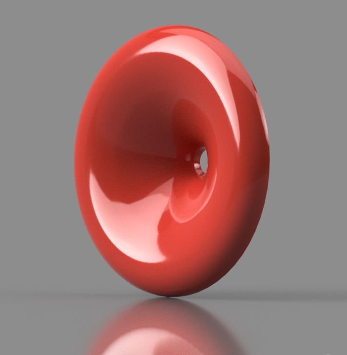

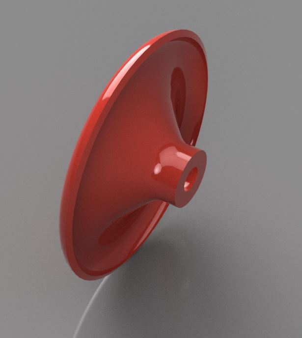

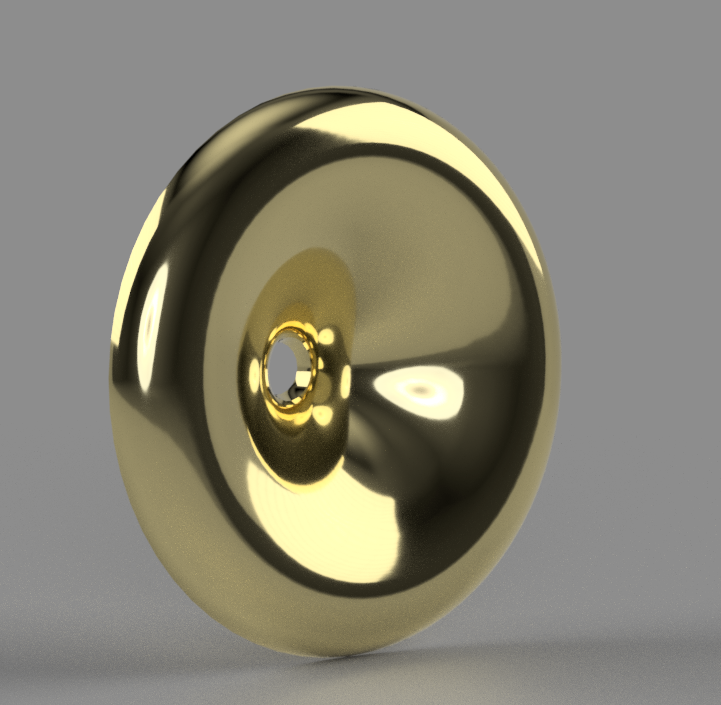

...finally, I can generate full solid bodies of the axisymmetric waveguides directly from the tool (via the Fusion 360 Python API). Can be exported as STL and sent to a 3D printer...
