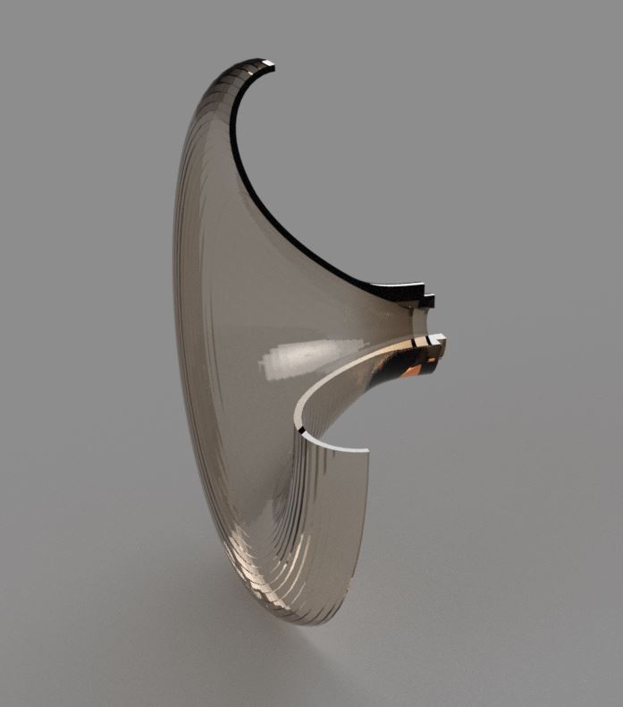

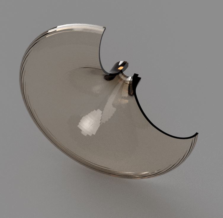

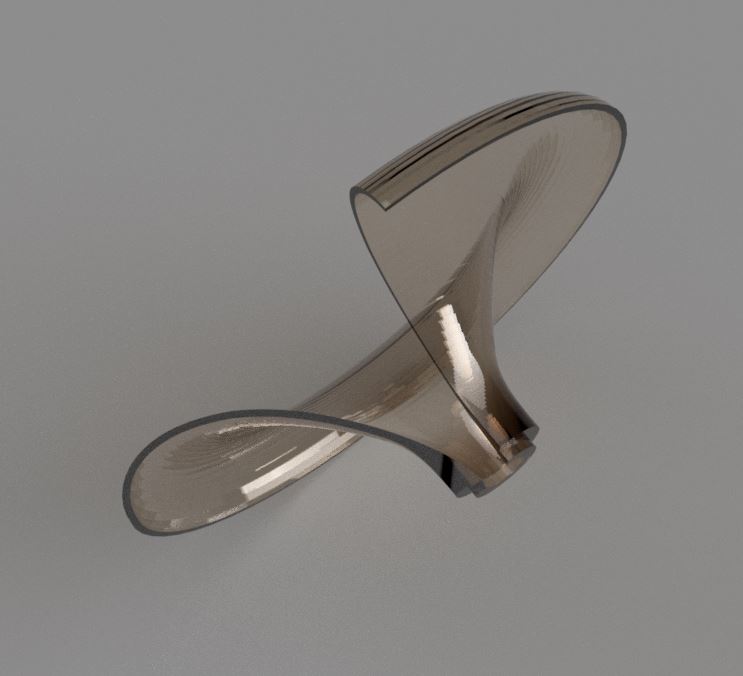

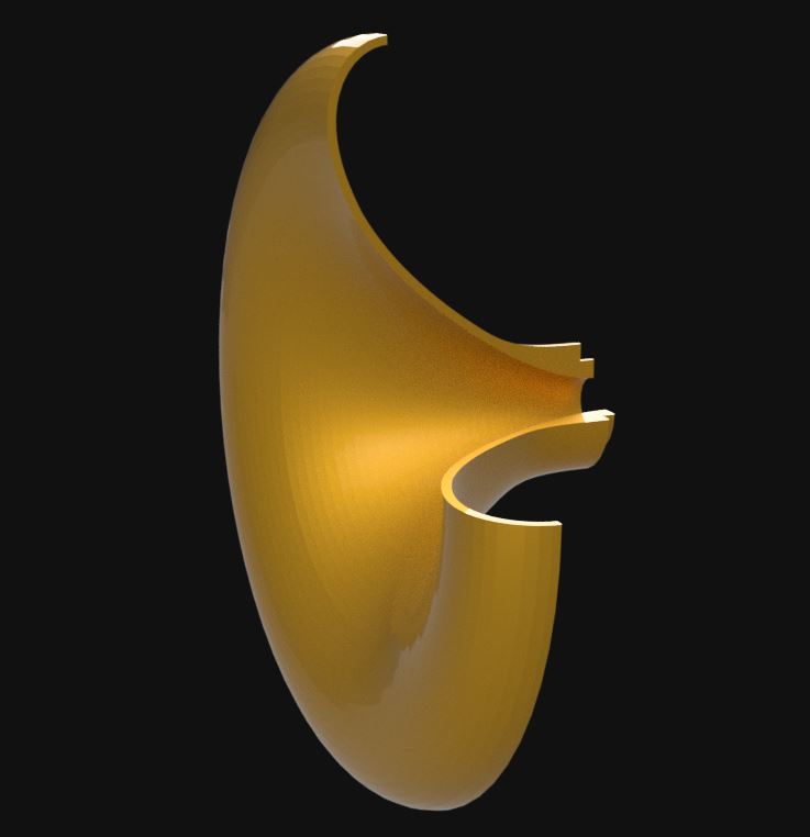

The waveguide for HF1440, I'm gonna to try to cast this -
Were the sims of this wg posted previously?
What are the dimensions?
- Acoustic Horn Design – The Easy Way (Ath4)
