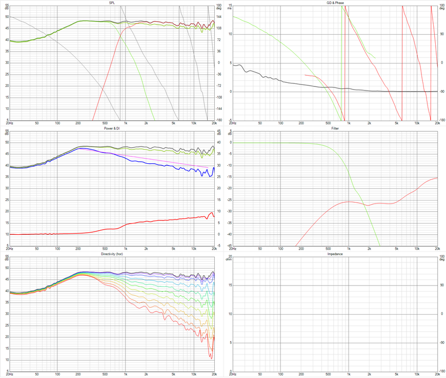

I think Pet007 is testing (and listening to) the following (kind of random) combination right now -
Fountek FW168 (6.5") + B&C DE502 in the free standing waveguide shown above:

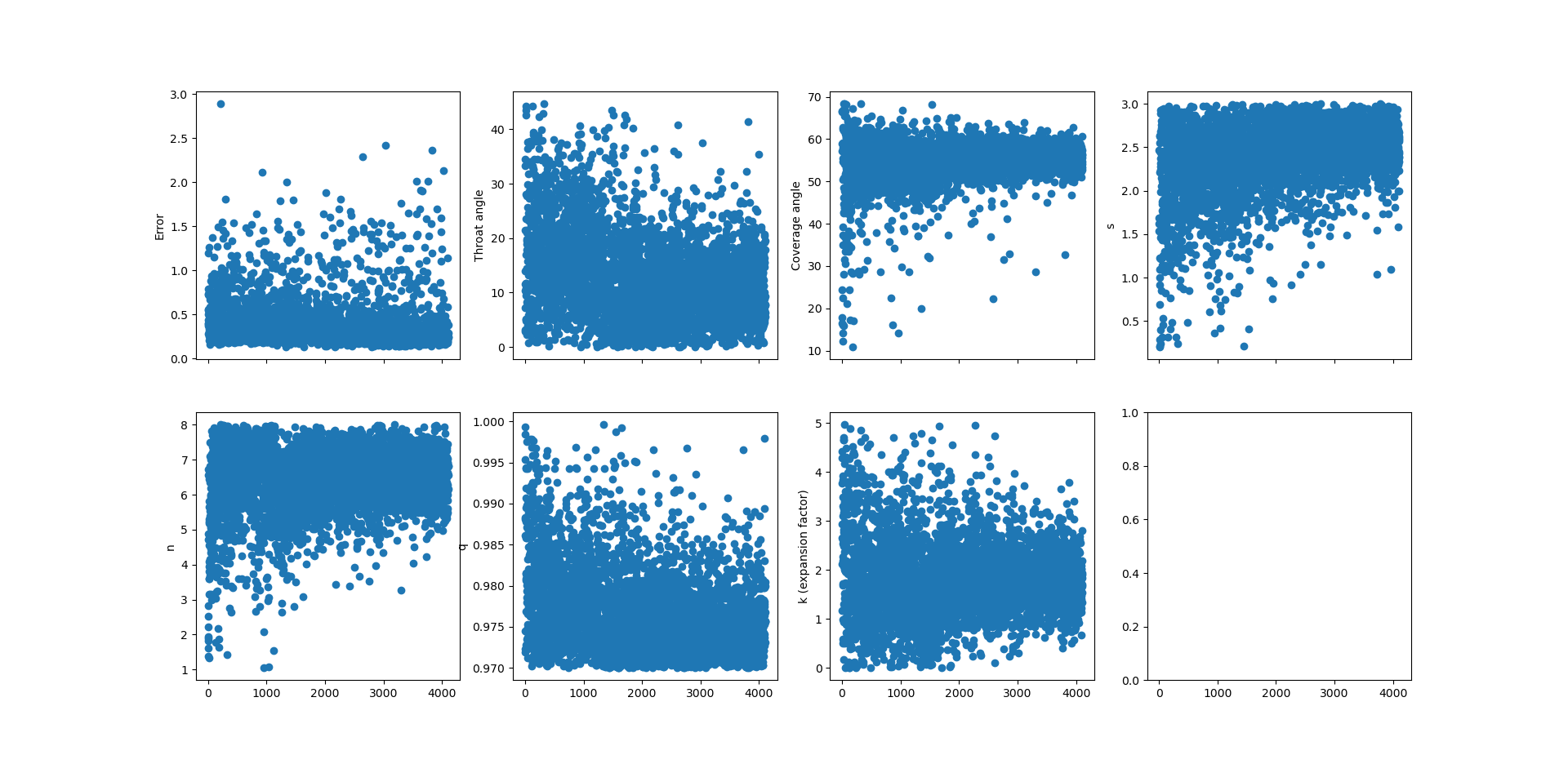

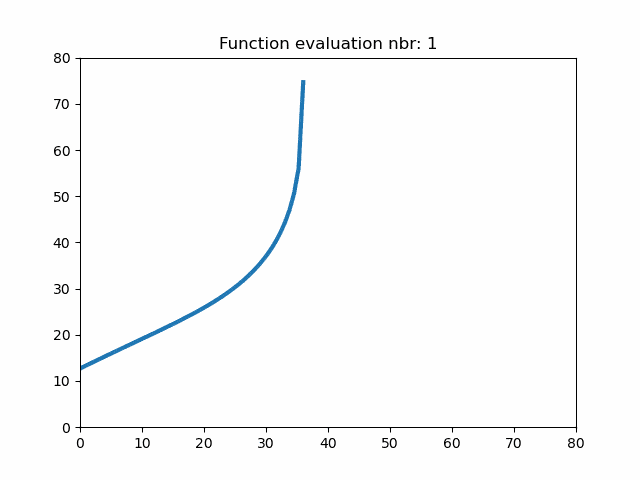

The above waveguide was the result of an first attempt at an optimization using an differential evolution algorithm. Basically it will fiddle around with the parameters in Mabats magic waveguide formula (creating combinations based on evolution), generate an ABEC project with the new parameters, simulate it and evaluate the results by calculate an directivity error. The objective of the algoritm is then to find the parameters that minimizes this error (0=perfect directivity)
I let it run over night and it produced something like 4000 simulations, here is a plot of all simulated combinations (you can see some trends of where the parameters are heading):
However when I tried doing the same thing but with a dome I got garbage since the algorithm did everything it could to reduce these 10kHz resonances, hence my questions above. Guess I have to refine my objective function for those cases
(Bonus animation of the profile for the first 100 iterations):

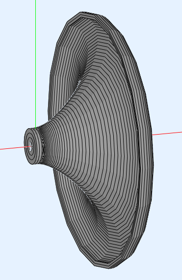

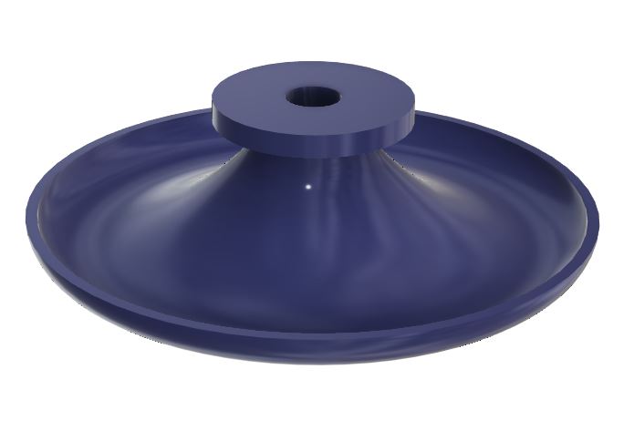

Axisymmetric free-standing waveguide for B&C DE7 - take this one as a promotion 🙂 ...
Fusion 360 public link (3D view): DE7_promo

Promotion. Should I understand it that you plan to sell your designs, make custom ones or even sell ready made horns? That would be really cool! I'd definitely buy some🙂

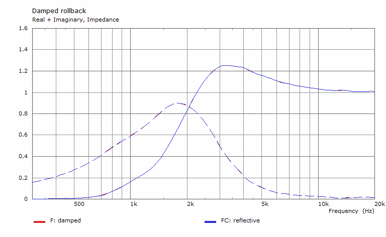

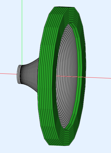

Well, at least I could try this -I have no idea.In a real realisation, would one stuff the backside of the rollback with something. Foam.. etc...??

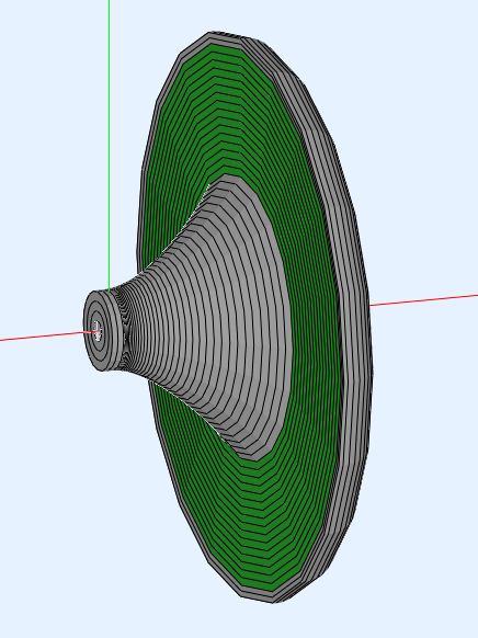

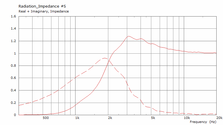

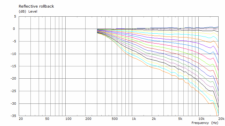

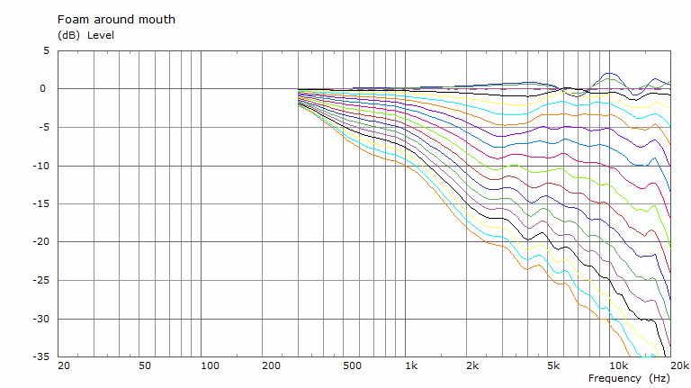

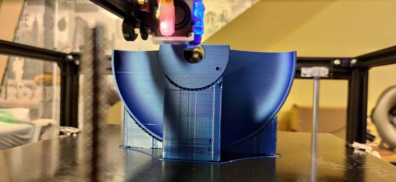

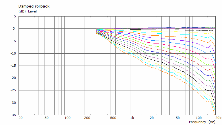

A sample 10" waveguide:
Rollback covered by a fully absorbing boundary element (green):
If carefully examined one next to each other, there's a slight difference below 2 kHz (not necessarily for the better). Of course the question is how well is this simple test close to the real thing, I don't know.
Why "surprising"? A perfect absorber would also be a near perfect reflector, which is not what you want. You want no reflections at the mouth, hence as gradual a termination as possible is going to work best, whether or not it is an absorber or a flare.
