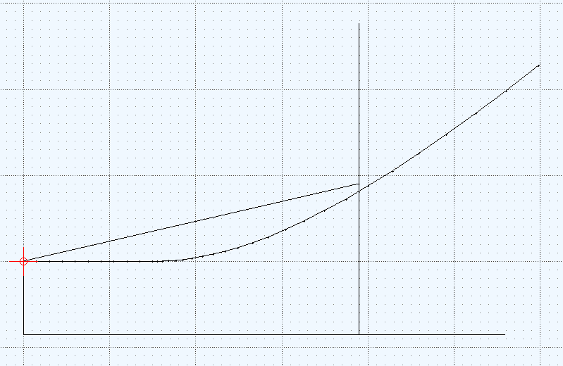

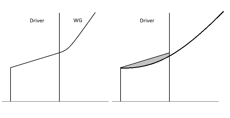

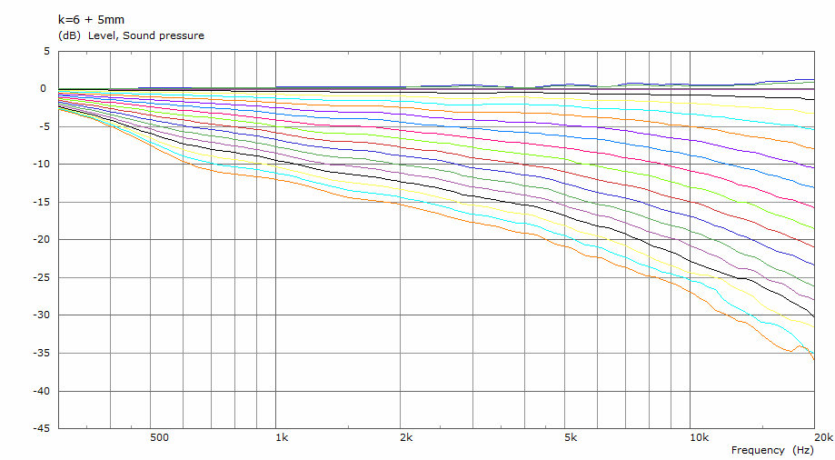

So this would be the idea (some EQ is needed anyway). Especially suitable for drivers with large exit angles.
(Right now I'm looking at FANE CD131 1" driver - seems like a nice candidate.)

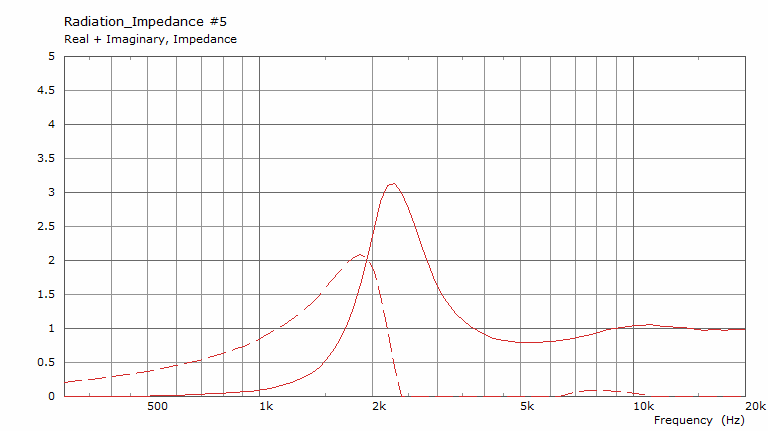

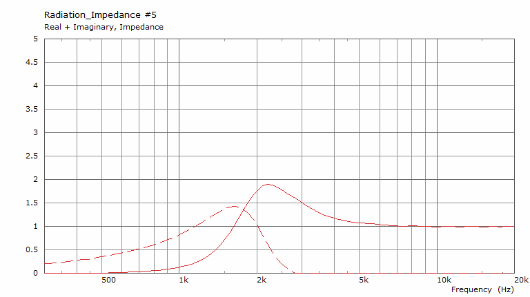

For example, this should be possible with BMS 4554 (note that the throat impedance is referenced to ⌀17 mm, which would be the actual throat diameter in this case).So this would be the idea ...

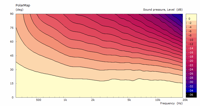

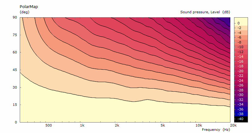

1,5 - 2 kHz without any problem, IMO. This would be for small home speakers.
- It has also a bit wider coverage than typical to be well usable even with 7" midwoofers.
Nothing special, really. After making some proper designs with waveguides, it's just routine. The sensitivity is still there to spare.
