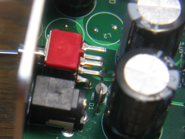

Switch S1 has six legs. Part # is same
as BOM. Does it get modified or is it wrong.
Whoops! That is the right switch, but looking through the build instructions just now I forgot to include the need to clip off the top two leads. I've attached a photo below. Just snip them off with regular wire cutter pliers. Best not to use flush cut pliers though since those leads are fairly large and could damage flush cutters.
The issue that came up with the switch was that just a DPST was needed (4 terminals), but it turns out those are rare in a right angle PC mount version, plus the DPSTs are priced about the same as the much more common DPDTs. So I went with a readily-available DPDT and just clipped two of the leads.
I'll make that change to the build instructions and re-post them in a few days. Thanks for finding that!

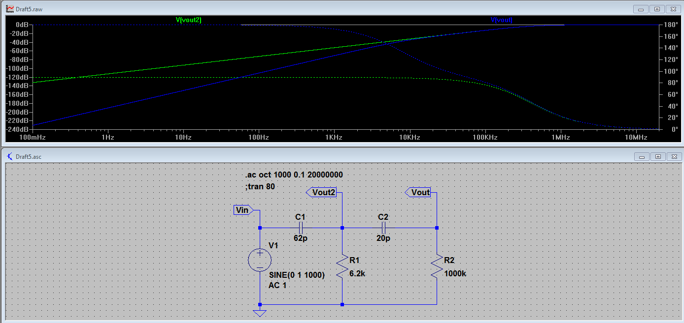

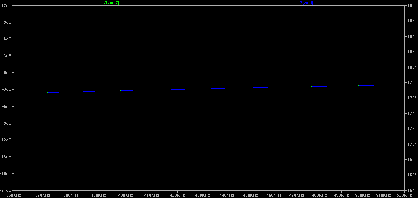

Also some small progress on the second order comp network. I was able to finally get my arms wrapped around this one from a post in the solid state forum right now, which I think may be similar to one of yours, from memory:
http://www.diyaudio.com/forums/solid-state/241799-two-pole-compensation-lme4702-lme49830.html
ImageShack® - Online Photo and Video Hosting
Feeding the network from the CC2 end I get 3dB down at 414kHz for the pole, plot below, exactly as advertised. 🙂
Thanks again for all your compensation ideas and suggestions!

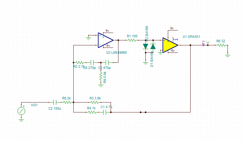

it is not a problem to do something based on OPA551, but it is slightly less convenient because of rather limited bandwight. of the chip.
Here is a small example how you can approach this design.
