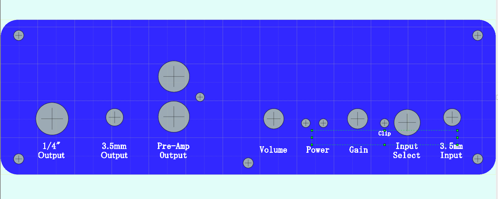

Panel hole dimensions
Here is the set of panel hole dimensions I just sent out to Proto Panel for the front and back panel. I won't know if there are any mistakes until I get the panels back so it is probably best to wait, if possible, but if someone is set up with a CNC system and some stock and wants to give it a try, let me know the results! 🙂
These panels have the lettering left out to keep the costs down. Once these measurements are verified I'll post the CAD files for both panels that their "Cetina" software uses. When placing your panel order it is easy enough to fire up the software and just add any size, font, etc. of lettering wanted. Lettering raises the price and I know from past projects is pretty user-specific. Everyone has their own favorites on fonts and what the labelling is.

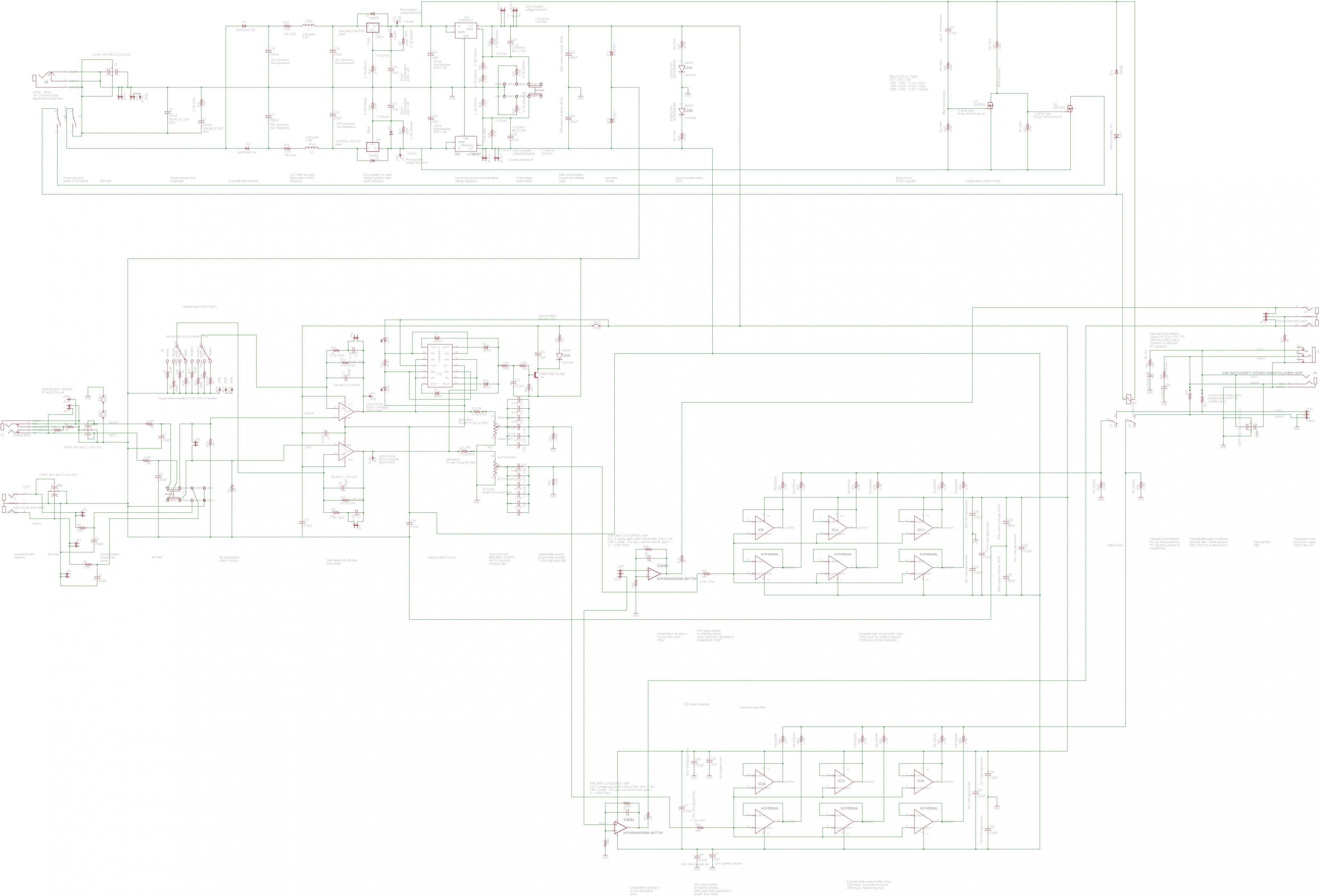

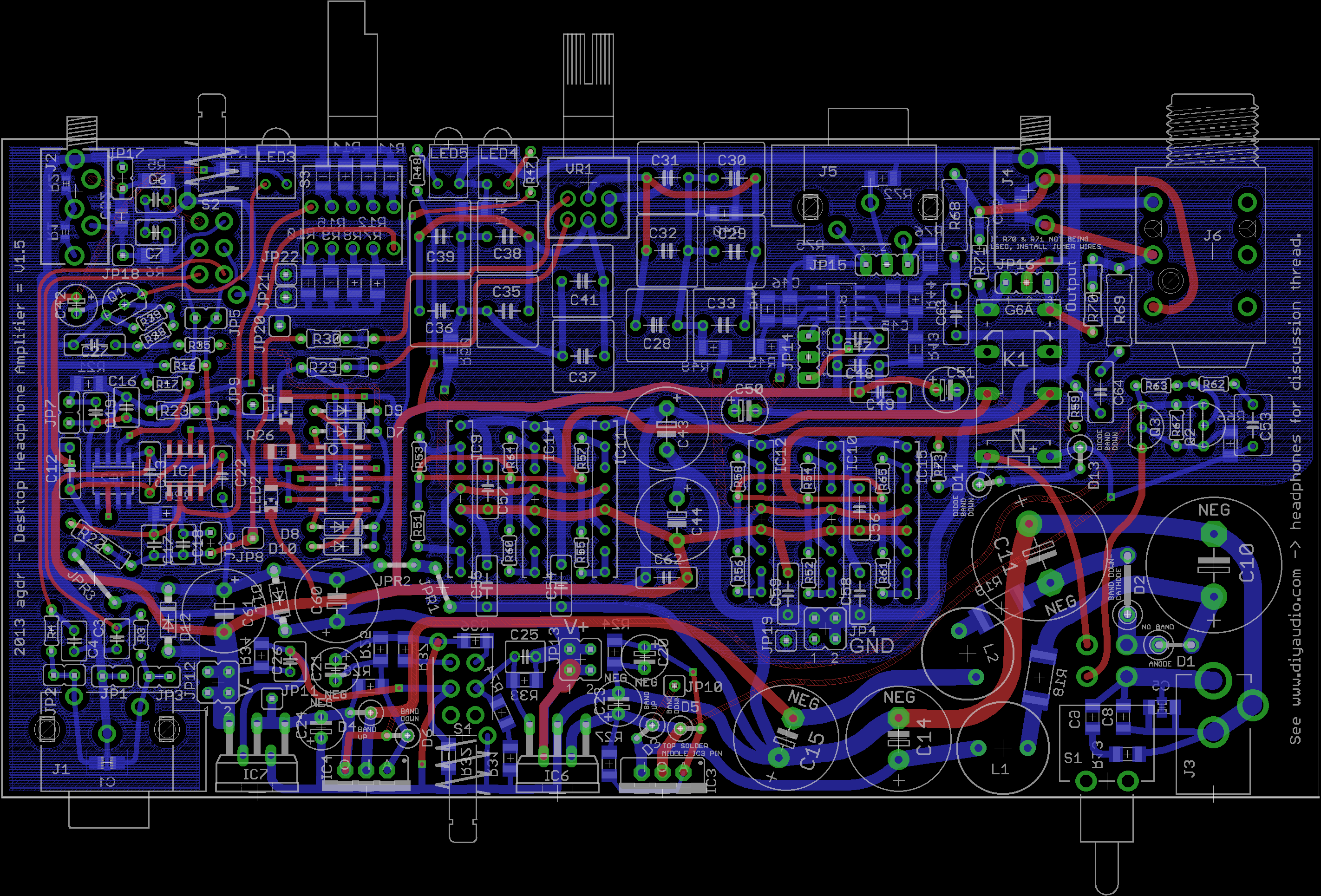

V1.6 4-layer Gerber files, layout, circuit
Here is one more update with a bunch of minor cosmetic updates I noticed during the build. This is still 4-layer, with the DRC and CAM set up for Seeed Studio's 4 layer fab service.
2000impreza - I had forgotten that V1.4 was the last 2 layer set of Gerber files. The 4-layer that was fabbed was V1.5 and this 4-layer is V1.6. Given how (relatively) cheap these 4-layer boards are to fab these days, I would definitely recommend going with the 4-layer version/files. I've updated the wording in post #1 of this thread to point to these latest V1.6 files.
Some of the changes:
- "NEG" lettering added to the negative lead of the large electrolytics, along with the standard "+" on the positive lead.
- Increased the font one size for the letting on the vertical diodes that says band down or band up, just to make it easier to read.
- Decreased the hole size one notch on the DC power jack.
- Increased the hole size one notch on the 3.5mm jacks. No problem here on the existing boards, but during the build I accidentily slopped some solder in one of the holes and had to suck it out with the solder sucker (solder wick works too) to get the jack in.
- The silk screen outline for the 4.7uF coupling caps was square from the Eagle library while the part is 8.4 x 7.2. On the existing boards I left appropriate space between the caps to compensate. I've gone back and added the exact shape to the library.
- The two SMD 0.001uF cap pads under the 4.7uFs are removed. These are not used in the build and are left over from my past DC servo attempts. I hadn't noticed they were still there in V1.5. Just leave those pads unused with the existing boards.
- Added a SMD pad for a 10 ohm 1206 SMD R74 in series with R31 in the power supply section. Now this is getting really perfectionist, 😛 The rail runs at 7.020Vdc in the existing builds and that 10 ohm resistor moves it to 7.000Vdc. I had space so why not. You can just put a 0 ohm jumper in there or short it with a piece of wire and solder if you don't want to mess with it.
- Added a 1206 SMD resistor pad in series with the output on each channel of the pre-amp chip, going to the RCA pre-amp outs. For very long RCA cables some chips may be happiest with 20R or so of series resistance to decouple cable capacitance. This can easily be added with the existing boards by cutting the trace between JP15 and J5 with an xacto knife and soldering in a through-hole resistor between the pins. If not using an output resistor just short those across with a 0R 1206 jumper (in the BOM) or a wire.
- Moved R27 in the power section up slightly from the board edge. If someone left an extremely large solder ball there it could possibly have touched the back panel. No problem on the existing boards - if you use too much solder on that end of R27, just use some solder wick to suck a bit of it off.
- Moved C37 and C41 to better take advantage of free space on the board.

Thanks for the update. I just sent off the updated 4 layer gerbers to seeed studio to run a batch of 10. The price difference between 5 and 10 was small enough I just went with 10.

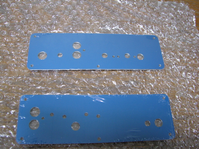

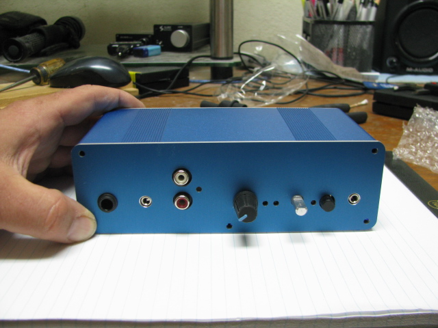

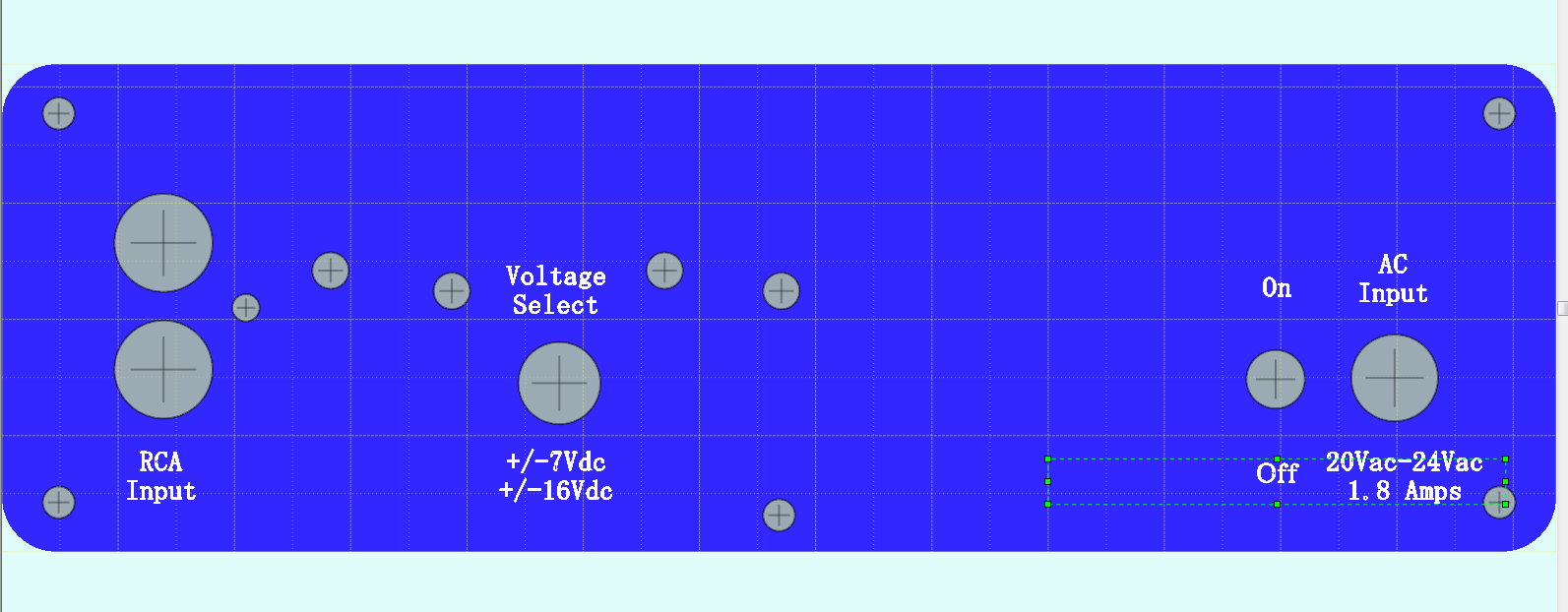

Panels are back
Well I have to say that I'm impressed with Proto Panel! The panels for this project are back already. I emailed the order just last Wednesday, so that is just 4 business days to get them in my hands. Wow. Disclaimer - I'm not affiliated with them in any way, just a happy customer at this point.
They honored the 40% off special they have running through the end of the month. For the panels with no lettering it worked out to be around $8.60 a panel with the discount, plus $6 shipping. Can't beat that. For panels with lettering it looks like it will be around $12 a panel with the discount.
The first photo below is the received panels. Packed in bubble wrap and also shrink-wrapped. The next is the back panel installed, and the third is the front panel.

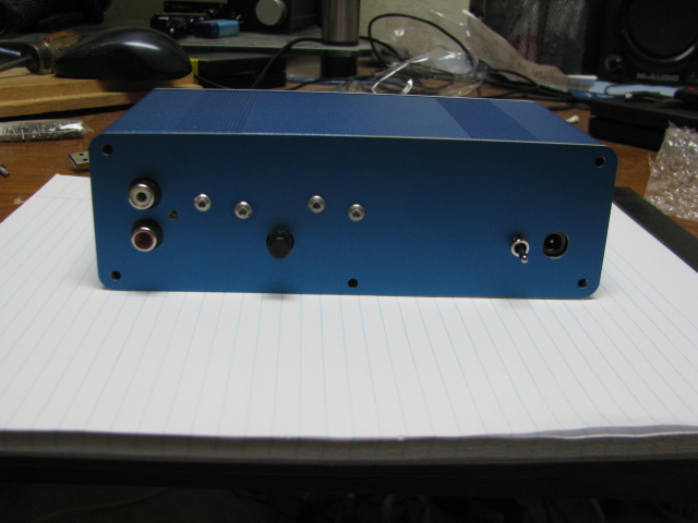

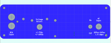

The two CAD renderings are the panels with lettering. I'm going to send those in next to see how lettering works out. Proto Panel says they can only do engraved lettering for the small batches. For silk screened they would send the panels out, which would only work economically in larger batches.
The rear panel was nearly error-free (my measurements) luckily. It is hard to tell from the photo but the hole for the voltage select button needs to be moved up slightly to be centered. The hole for the RCA jack mounting screw could also be 0.2mm bigger. Everything else was right on the money and just fit right together.
The front panel needs a little more work. I had completely left off the hole for the 3.5mm input jack. 😛 Oops. I hand drilled the one in the photo below. The 1/4 inch and 3.5mm jacks need to be moved up about 0.2mm also, and the 3.5mm jack holes should be a little larger, 6.5mm instead of 6. The pot hole also needed to be 1mm larger.
So I'm going to send off another run of the panels with the adjustments and lettering this time and see how it comes out.
