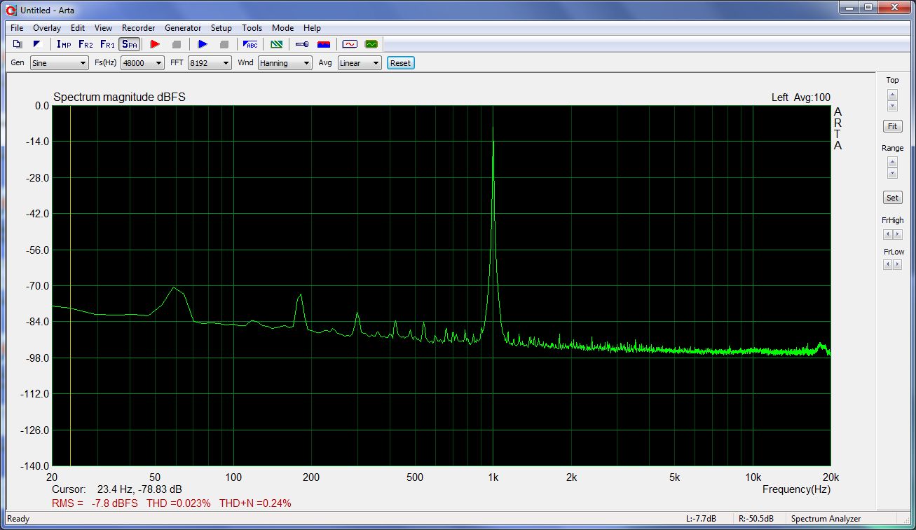

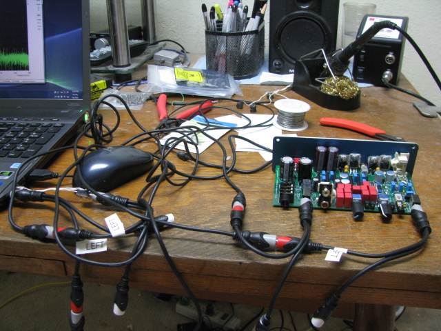

Now the good news. 😀 Using the ARTA soundcard software, the ODA's FFT beats the O2 below 1kHz, as shown below. I'm not a fan of soundcard analysis software as I've written many times. But it occured to me a few days ago that although soundcard software may be useless for absolute measurements, it may in fact have value for relative measurements. In other words, comparing one amp vs. another, ignoring the absolute numbers and instead just looking at relative numbers (the difference in the two measurements). Whatever distortions and noise the soundcard/soundchip adds will add to both and more-or-less subtract out in the difference. In this case it is comparing this amp vs. the O2, which of course has accurate published absolute numbers from RocketScientists's dScope measurements.

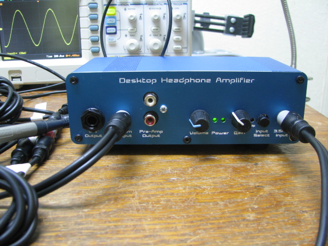

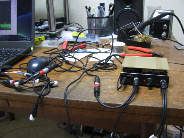

The first two photos show the test setup with the ODA and with the O2. That is a standard O2 that I've just mounted int a taller B3 case. The ARTA software
ARTA Home
in this case works by outputing the test signal on the PC's (24/96 DAC in PC) left channel out, which then goes to the amp's left (or right, just be consistant) input. Then the amp's left channel out goes to the PC's left channel in. I've standardized the output levels of the two amps for the test to -7.8dB. The ARTA software is running in 64 bit mode on windows 7 pro and the soundchip is set for 24/96.

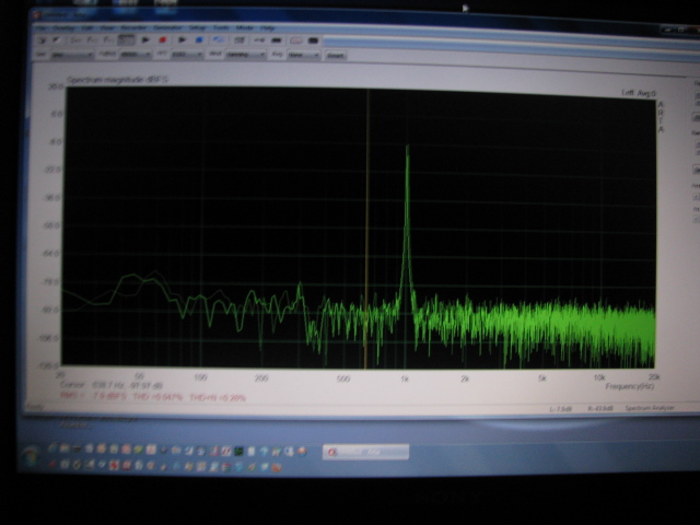

The first spectrum photo below is with the two power supply 47uH inductors installed, and is what tipped me off to the radiated EMI problem. Those spikes you see left of the 1kHz fundamental are all power line harmonics, right on the money: 60Hz, 120Hz, 180Hz, 240Hz, etc. The cursor is sitting right on the 240Hz peak. The levels are all way too low to be audible, which is why I never noticed them when listening to the amp. So theoretically you could actually leave the inductors in, but I would highly recommend nuking them to get those radiated power line harmonics out of the system/spectrum.

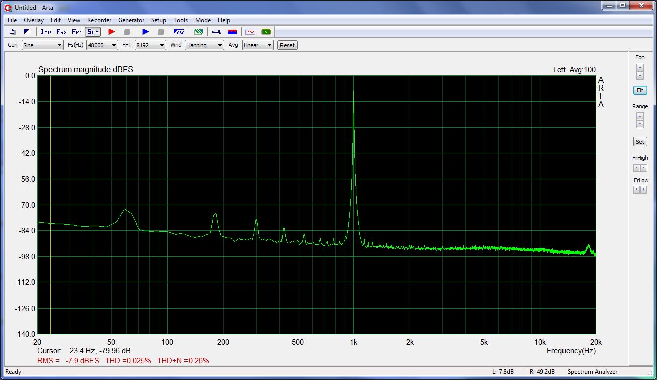

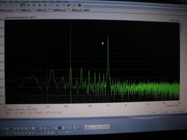

The next spectrum photo is the ODA here with the inductors removed. Not bad, relatively! Now keep in mind the absolute values of dBFS shown on the Y axis are useless since the PC's sound chip's (significant, I've tried it in loopback) noise and distortion are being added, but what were are looking for here is relative change. In this case the power harmonics are gone without the coils.
The final (third) spectrum photo is the O2, with output adjusted for the same -7.8dB. ARTA shows much higher spectral components below the 1kHz tone, up to about -56dBFS vs. -74dBFS for the ODA. Interesting. I'm still pondering why. I was expecting the ODA's FFT to beat the O2 slightly, but this is more than expected. I'm going to try again to verify without the software, instead using a signal generator and the oscilloscope's FFT.

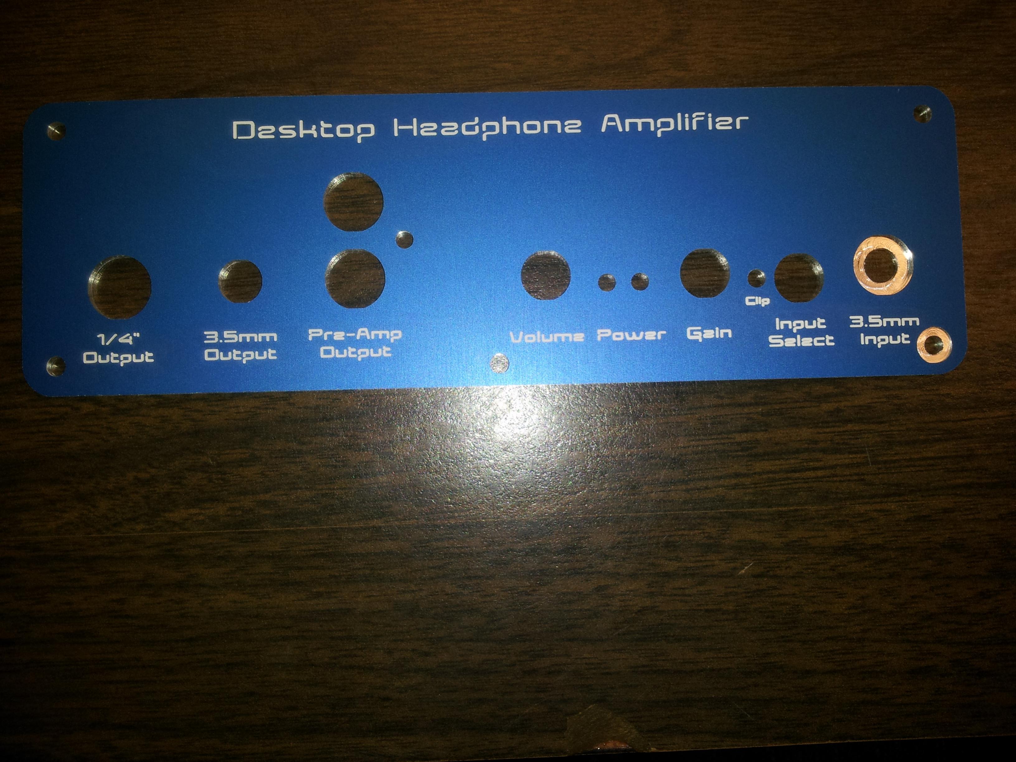

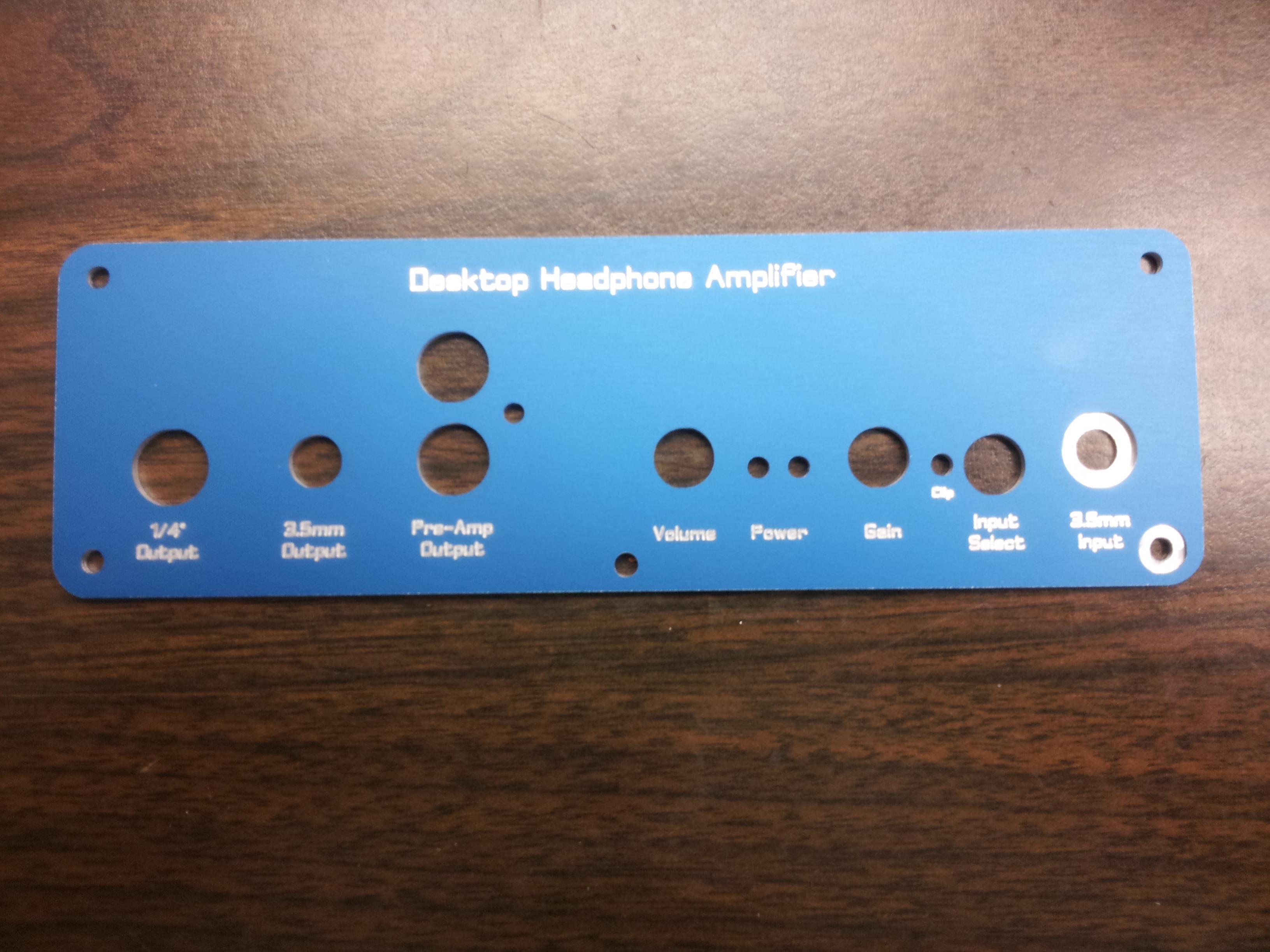

The final two pictures are photos that proto panel has sent of the panels being fabbed. I've picked two different fonts to give a choice. I'm making the panels self-grounding. Recall that RocketScientist/NwAvGuy required that a small wire go from the ground of the input jack around one of the panel cover screws to ground the case. I wanted to make that automatic, so I've countersunk around the input jack. The jack's nut (comes with the jack) then grounds the front panel to the input ground. A countersink around the bottom right screw grounds the panel to the case. A similar countersink in the back panel grounds that to the case.
The countersinks cut through the anodization so the nuts/screws make good electrical contact. Apply some aluminum anti-oxidant compound on the countersinks and it should remain a high quality ground. The other holes in the front panel I've slightly oversized to prevent any of the other shafts or jacks from touching, making the panel single point grounded at the 3.5mm input jack. With this arrangement no wires at all need to be run from the PC board to panel or case for grounding.

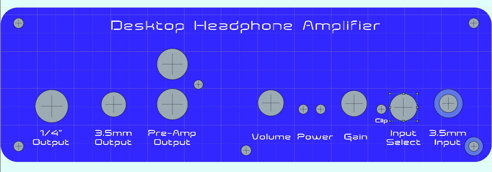

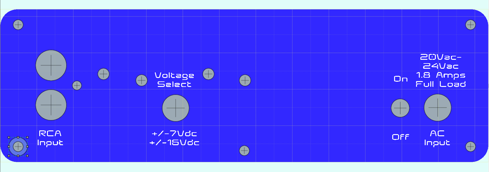

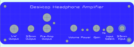

Final panel CAD files and dimensions
I received the latest version of panels today from Proto Panel and everything fits reasonably well. After seeing the panels in person I've decided that smaller font in the picture posted above in post #184 is too narrow, but the wider font in the other picture is great. So I'm only going to use the one with the wider font
The site here won't let me upload the .cgc CAD files - unknown file type - so until I get that figured out I'll just send the files to Proto Panel to have on file. Best to send them an email to order and reference the desktop headphone amp on DIY Audio. Below are the final set of dimensions for self-drilling, or loading into any other CAD system like Front Panel Express.
Proto Panel volunteered to offer a discount to DIYers on the forum on the panels. I'll get in touch with them next week and see what they have in mind. They have had 40% off specials the last couple of months, maybe they have that going on this month too. They are at:
Custom Front Panels, Instrument Panels Manufacturer, Proto Panel
Their "Cetina" program calculates costs with the rightmost menu button. With no discount it comes up with:
Front panel no lettering ...$17.52
Front panel with lettering..$31.37
Rear panel no lettering..$16.53
Rear panel with lettering...$27.16
And again you can simply self-drill the two panels that come with the B4-080 (or B4-160) case if you have a drill press and a good caliper for measuring. Or you can take the measurements below and load them into Front Panel Express' software or any other outfit that does panels. Proto Panel is just coming up as the best deal I've found at the moment and they seem to do good work.

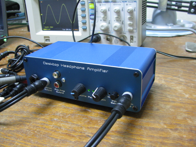

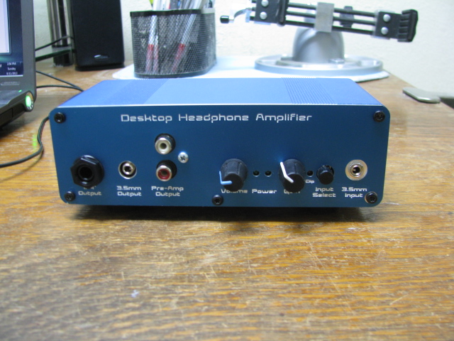

Pictures of the assembled panels are below. A few assembly notes..
Use the finer pitch 4mm Torx "thread forming" screws packed with the B4-080 case rather than the coarser pitch "thread cutting" screws they also pack. The thread forming can be taken out a few times without damage and will leave fewer metal filings. However, oddly enough, Box Enclosures only includes 8 of each screw with the case but it has 5 holes in each panel, including the one at the bottom. That leaves it 2 screws short. I have an email into them about it. But they have the screws available on their website for order, the TB-008
Box Enclosures - New Page
A #10 Torx driver is needed to get those screws in.
The black nylon nut for the Neutrik jack I mentioned above is Mouser #550-1005 (Neutrik #NRJ-NUT-B) for $0.14. It isn't required - the jack is soldered on the PCB and is perfectly stable - I just think it looks kind of slick. 😛
I've found these rubber feet work well, Philmore 10-602 available from all sorts of places on the internet. Here they are at Fry's
FRYS.com*|*Philmore
The adhesive sticks and stays, unlike a few less-rubbery feet I've tried, plus it has a hole in the center and could be mounted with a #8 self tapping screw.
In the photos I've replaced the Alpha DP4T rotary gain switch with the Alps version, from the discussion a few posts back in this thread. The Alps switch works just fine and allows that same T-8 knob used on the volume switch to be used, as I've done in these photos. I have the Alps switch as the primary part on the BOM now, with the Alpha version out in the notes as an option.
The mounting screw that goes into the RCA jacks is a #4 3/8" pan head. It doesn't come with the jack, but is pretty readily available at hardware stores. A good place I've found for hardware on the net is Bolt Depot:

Looks like some high order powerline harmonics in the O2 amp
I just spotted something interesting in the O2 and ODA FFTs I posted above in #189. I can quite audibly hear that this ODA version's background is dead silent at the highest gain and volume vs. just the tiny edge-of-hearing hiss in the O2 with sensitive cans. I've been staring at the FFTs for the last hour or so puzzling over why, given how similar the two FFTs seem to be.
Two interesting things popped up. Below the 1kHz fundamental, from about 300Hz to 1kHz, the ODA has a lower average amplitude, by a couple of dB. But I don't think that is what I'm hearing in the O2 since the hiss sounds higher frequency.
But stare really hard at the O2 spectrum between 1kHz and about 4kHz. Although the average baseline level of the O2 is a couple of dB less that this ODA version in the entire portion to the right of 1kHz, see those tiny spikes from 1KHz to 4kHz? Measuring over and plotting the frequency those are high order powerline harmonics. 10th, 11th, and 12th harmonics - 1200Hz, 1800Hz, 2400Hz, etc. - that are all absent on the ODA spectrum to the right of the 1kHz delta. Looks like I managed to nuke those. Many headphones and ears
http://en.wikipedia.org/wiki/Fletcher%E2%80%93Munson_curves
would have much higher sensitivity to powerline harmonics in that 1-4kHz range than those below 1kHz.
Probably due to the close proximity of the power supply section in the O2 amplifier to the output amp parts. In this ODA version I had the luxury of a bigger case and more PC board real estate that RocketScientist/NwAvGuy didn't with the portable O2. I was able to put more spacing between the noisy AC parts and the amp parts.
So, in other words, that very slight edge-of-hearing background hiss in the O2 while on the highest gain and volume settings with input grounded and running on AC might actually be due to high order powerline harmonics, not atmospheric noise or chip/resistor noise.

I just looked at the build instructions. Holy moly, bro! You put a lot together with this one and I'm very impressed.
Also, isn't 1800Hz the 30th order powerline harmonic for 60Hz? Does such a thing exist in a measurable way?
ethanolson - you are right! 🙂 I was thinking 120Hz for some reason. 1200Hz would be the 20th and 1800 would be the 30th harmonic. Thanks for catching that.

40% off at Proto Panel again - and updated BOM
It looks like Proto Panel is running their 40% off deal again through August. Here is the link with the discount code:
Custom Front Panels Milling 50% Discount
So that would cut the prices I posted above that their CAD program comes up with by 40% for either the panels with or without text.
Again, I 'm not affiliated with these folks in any way, it just seems like a good deal on panels and they have done great work on what I've ordered. The panels that come with the B4-080 case can simply be self-drilled with the measurements I've posted. I've kept everything as a round hole. At one point I was playing around with the idea of moving the power jack foward to be flush with the outside of the rear panel, but that would have required a square hole that is less DIY-friendly.
I have also posted an updated BOM below and at the Google link. I've added the part numbers for the knobs, switch buttons, rubber feet, RCA jack mounting screw, Neutrik 1/4" nylon nut, extra case bolts (both the black and silver) at Box Enclosures and voltage regulator (TO-220) mounting hardware. I've also included part numbers at Bolt Depot (boltdepot.com) in case anyone wants to use the metric M3 stainless steel button head parts I used instead of the 4-40 hardware that comes with most TO-220 mounting kits. The inductors are removed from the BOM since those are left off the board now. The relay is moved to the first section with the switches. I've included part numbers for different color versions of the knobs and buttons in the notes column of the BOM.
I found a mistake on the BOM. The relay should be a 48Vdc unit. It still had the 24Vdc unit listed, before I made the change to run the relay off the pre-regulators.
I've posted both an excel and PDF version at the Google link.

How about a Group Buy on the following.....
How about a Group Buy on the following:
(1) Case
(2) Front and Back Custom Panels
(3) Switches, controls, connectors, etc.
Just an idea. It makes it easier to build this unit. I would be in
for four sets. Ideas.😀
