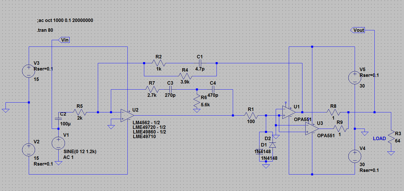

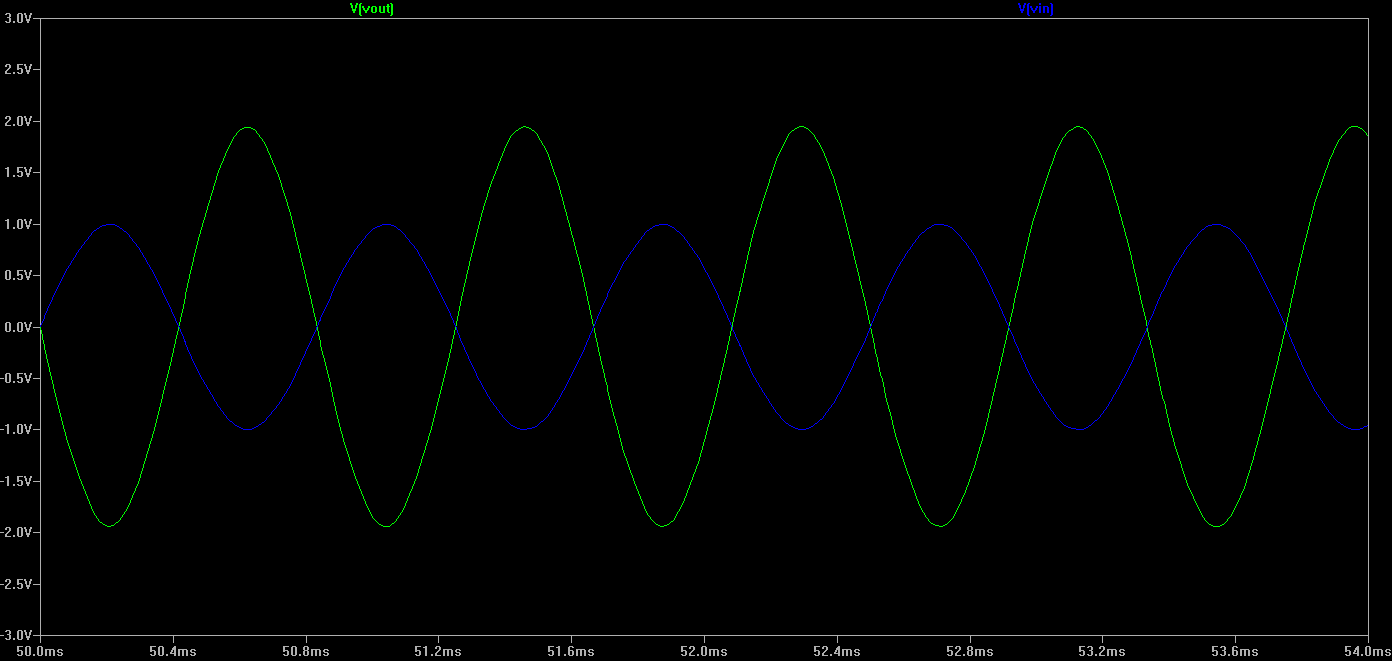

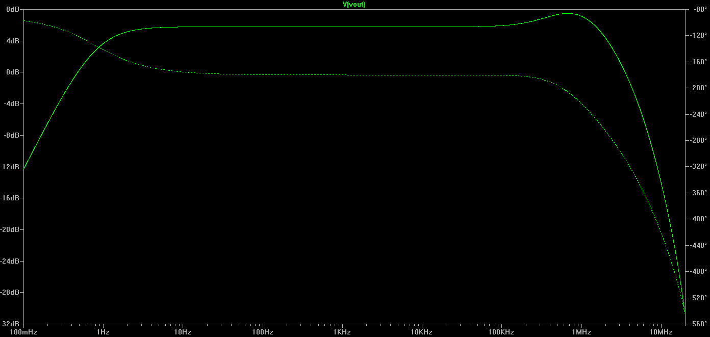

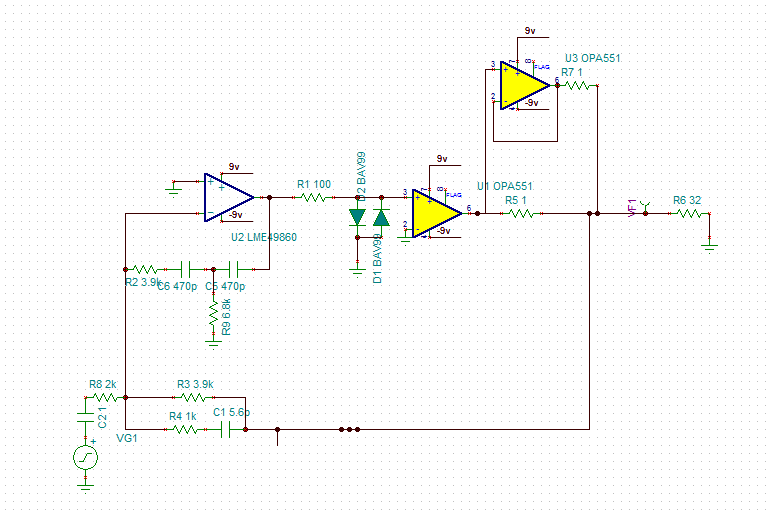

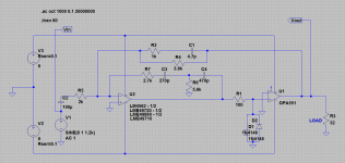

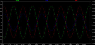

it is not a problem to do something based on OPA551, but it is slightly less convenient because of rather limited bandwight. of the chip.
Here is a small example how you can approach this design.
I like it! I like it enough to build it, in fact. I may have just that much circuit fabbed to play around with. Thanks again for your input!

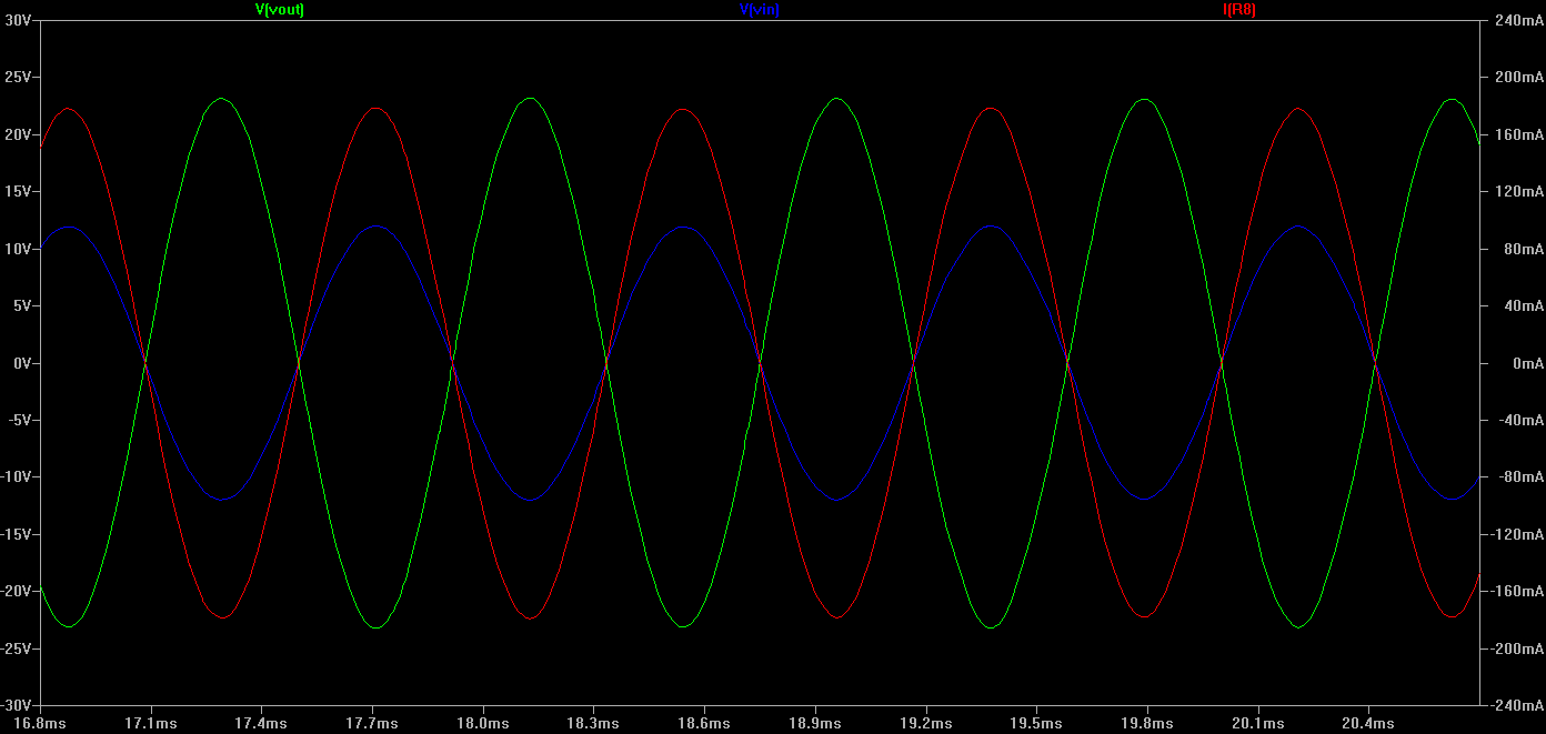

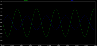

... and a version of sergey888's OPA551 circuit with dual parallel OPA551's running on seperate higher-voltage supplies from a dual tap voltage quadrupler. The second OPA551 is required to handle the output current with the higher voltage output swing. 24Vpeak output swing (17Vrms) into 32R, which is 180mA peak current per OPA551 (the red plot).

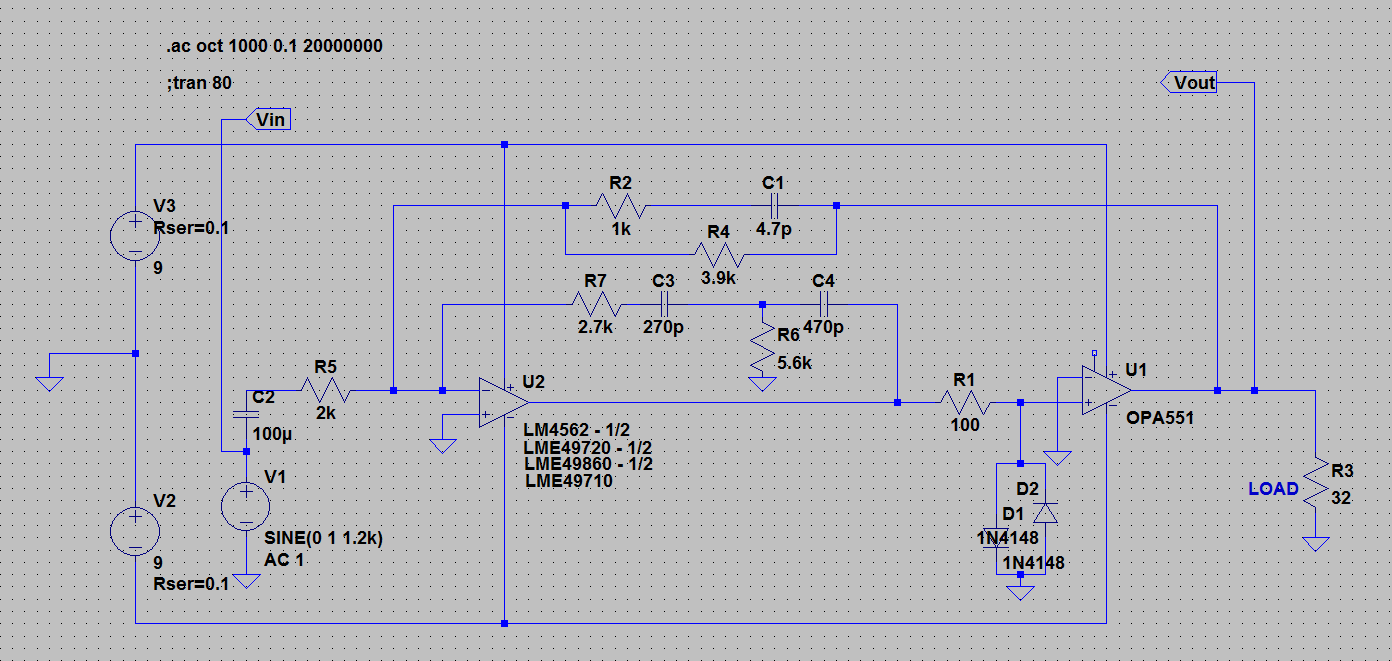

Ok, so
Each opamp has individual input offset voltage and individual gain, even if they are the same model. Because of this voltage difference between OP551s outputs is unpredictable and changes with the temperature.
The best you can do is to make it similar to what you using earlier, see the first example.
The second example shows also input filter, which you don't want to forget to include into schematic. Output filter is not shown, but also "must have".
I also would like to mentioned that having separate supply rails for the input opamp is a good thing, but may be somewhat redundant. You can easily make lower and filtered voltage right on the palce using RC, R-zener or R-zener-R-C chains. It may allow you to simplify board layout. In fact there is a high chance that distortion performance will be can be compromised by layout, so this is something worth of paying attention.

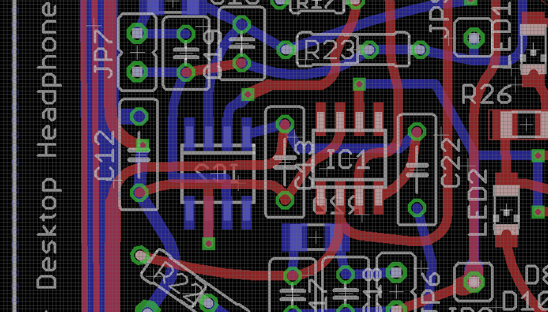

Does it matter which way IC1 and 2 go as there is no marking on the board?
I didn't notice this one because I went by the Eagle layout as much as the board labelling when I stuffed mine. Turns out the Eagle part library I used has a marking problem here. I've attached an image below of what shows up on the board layout in Eagle. Those double bands on the side of IC1 and IC2 correspond to the bevelled edge on each. BUT, the marking doesn't show up on the board! I missed that. I just took a look at the part library and Eagle has those markings on the "doc" layer that doesn't print to the board, even though it looks like it does on the layout. I'll fix that.
So... go by that diagram below. Pin 1 on IC1 is at the top of that bevelled edge, so the end next to C13 and the corner towards the bottom of the PCB. For IC2 on the back, pin 1 is the end next to C12 and the corner towards the top of the PCB.
