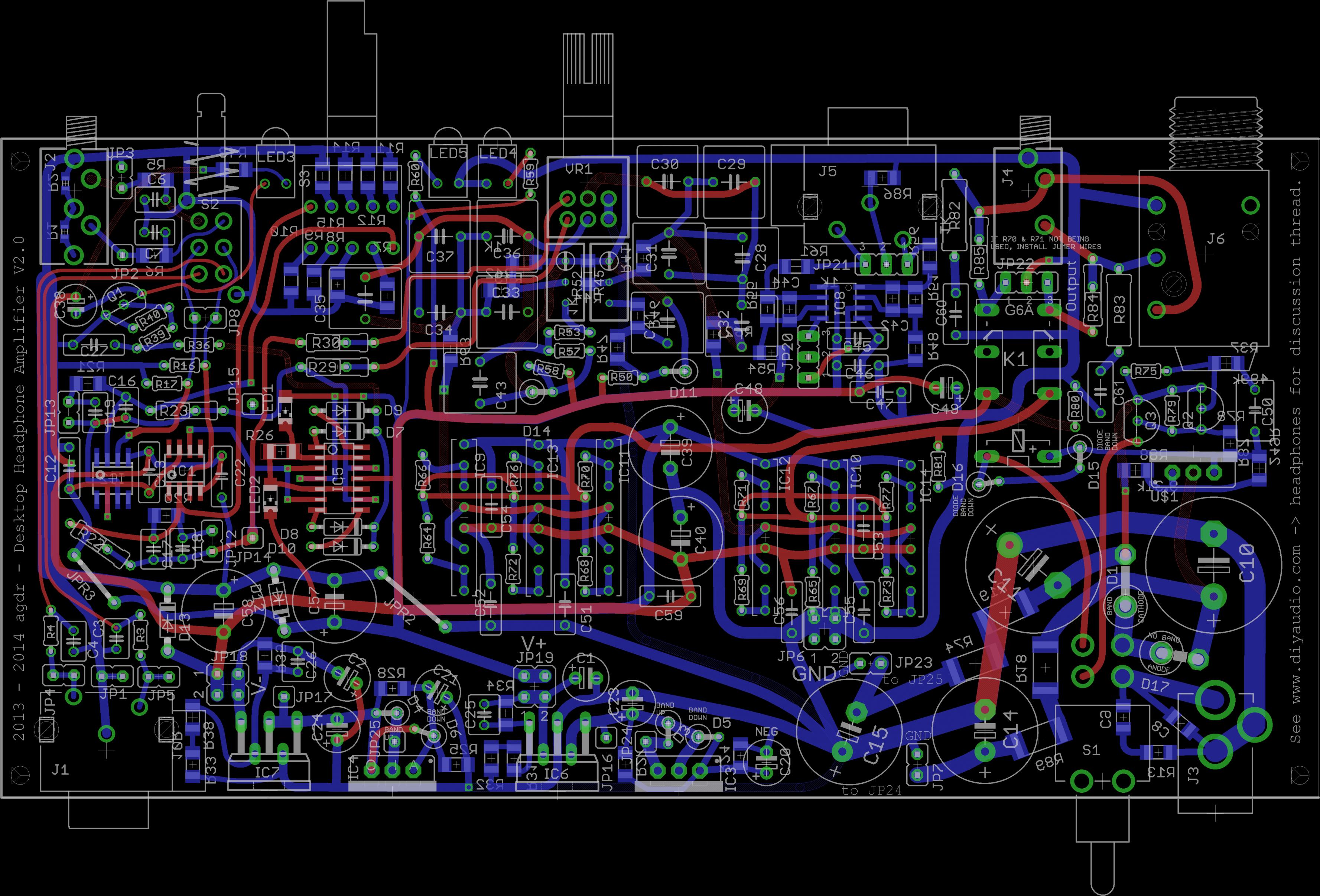

Any chance you'll have Front Panel Express .fpd files as well for the next round, since you mentioned those at one point?
Make that a definite. I was intending to do that with the current version and never did. Proto Panel has done great work but I know FPE is the 800lb gorilla in the room and some folks may prefer to use them.

One last question: it doesn't look like your current layout has any drill holes for standoffs - any thought to adding some in the next version to provide for more flexible mounting options?
I like it! Some holes would allow the board to be mounted in a bigger box. In fact, I'll see if I can find space on the current version too when I re-spin that this week.
ODA V2.0 - my version of a O2 Desktop Headphone Amplifier
Here in a update on this project. I didn't meet my estimate a couple of posts above of having a revision out in a week. 😛 I've been working on it the last few days. I was further along on V2.0 with the DC offset null/adjust and some other stuff than I remembered. I'm going to go ahead and send V2.0 out to fabrication in a couple of weeks and see if that offset null circuit works. 😀
Several changes in V2.0, below...
* I've used dace's suggestion above and put M2 holes on each corner of the board so it could be stand-alone mounted in a larger case. M2 (threaded) sized metal or nylon standoffs in all sorts of lengths are readily available on eBay and probably Mouser and Digikey.
* The two CLC inductors that had to be jumpered are gone, replaced with another series 0.5R resistor under the board for the resulting CRC AC powerline noise filter.
* The DC power jack is now moved 2mm forward to be flush with the front surface of the back panel. This results in the plastic jack insulation all the way around between the hole and metal back panel, a good thing. This means a rectangular hole in the back panel. I'll post a new
Proto Panel rear panel CAD file. As per dace's suggestion above I'll also post those CADs in Front Panel Express format.

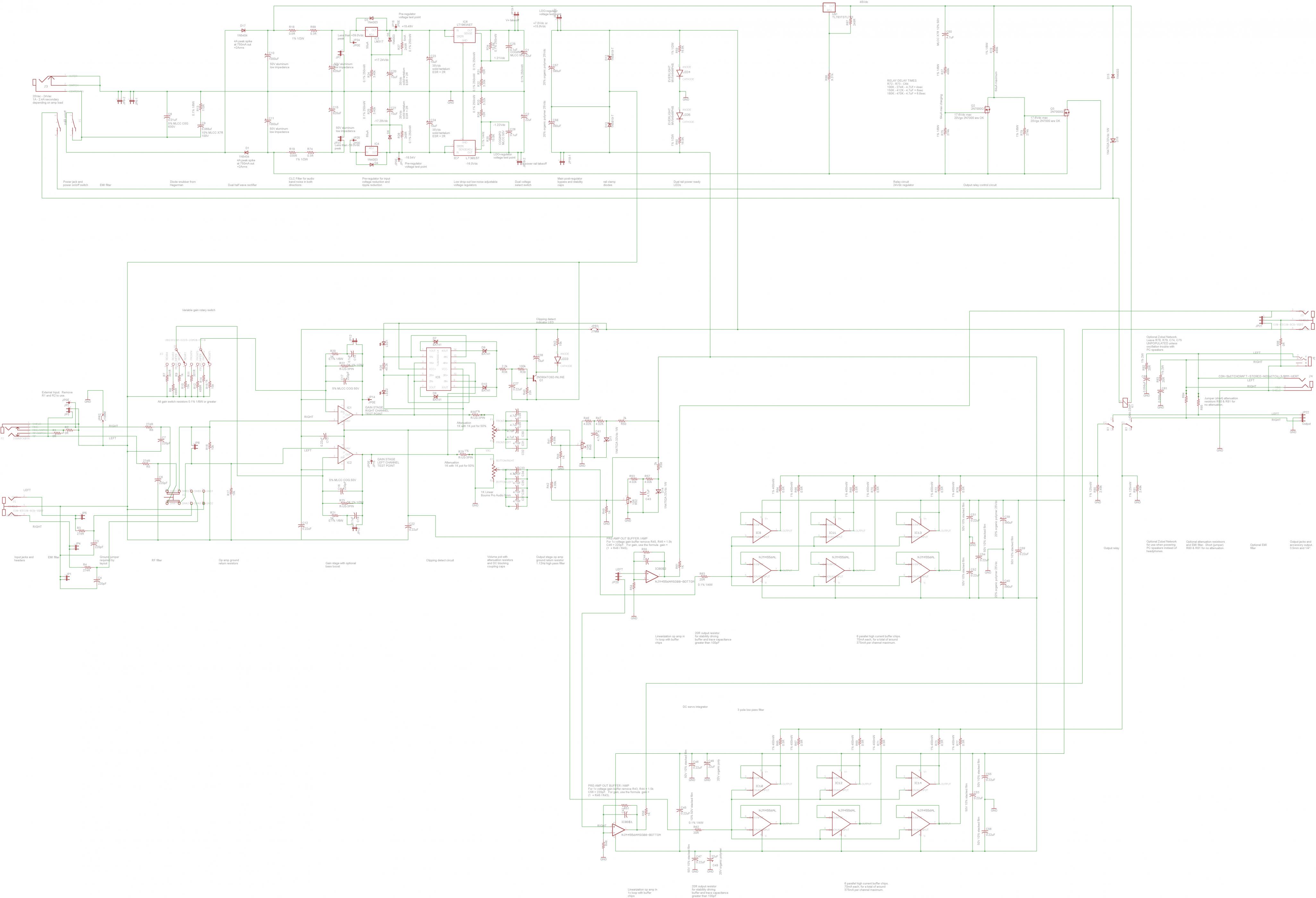

* The relay circuit has its own voltage regulator, a high voltage LM317HV unit, which reduces the length of traces needed to feed it.
* The output of the AC CLC section of the power supply now feeds the pre-regulator chips via a short length of shielded mini-coax cable (grounded at just one end of course). This keeps the output of the CLC filter, which still has a couple of volts of DC sawtooth on it, away from the "clean" power traces coming out of the final regulators and feeding the board. No concerns here on the previous version, it is silent and noiseless, I'm just prepping for the day when I can measure this thing all the way down to -140dB noise floor with an AP or possibly this QA400 thing with the notch filter board I have out to fab.
* Disconnects added to the power supply section. The JP18 and JP19 V- and V+ test points (output of the power supply section) are now split into two sets of isolated holes which are not connected by default and require a jumper be soldered into both to connect the power supply output to the rest of the board. This does a few things. It allows the power supply to be tested independantly from the rest of the board. If you get a short in the rest of the board in the future (like my C51 screw-up on the previous board) you can just remove the jumpers to test if your power supply section is still OK. Also in the case of using the 2-board build option with the power supply on the rear board in the longer B4-160 case, the disconnects make it easy to run power from the power output half of JP18 and JP19 on the rear board to the power input half of JP18 and JP19 on the front board. The existing boards had the power supply section hard-wired via traces into the rest of the board, making it harder (would have to cut the two power supply PCB traces) to troubleshoot a short on the board.
* The DC output offset circuit is added to both channels. Essentially a filtered zener voltage reference (running in zener breakdown below 6.1V and not the noiser avalance breakdown above 6.1V) divided down to just a few milivolts, then feeding a 20 turn 10 ohm trimmer to null out the normal 3mV or so amplifier output offset voltage. A safety resistor is added so if the trimmer pot wiper dies years down the road the output won't go up to some DC voltage. The filter corner frequency is set so the AC (music) signal looking back into the circuit isn't affected in any way. Should be possible to get the DC offset down to 200uV
* The voltage select switch is gone. This feature turned out to be less useful that I originally planned. Plus with the new DC offset null circuit there is a slight 200uV change going between the two voltages. Running at just +/-16Vdc solves that problem. Eliminating the switch allows slightly more spacing between teh 4 voltageds regulators, making the positioning of the insulating micas a little less critical. Yet another reason the back panel is changing. The front panel is still the same in V2.0 as the previous version.
* The volume pot is now independently star grounded, something I wanted to do in the original version. Lol - again just getting it -140dB noise floor testing ready. 😛
* Several text label screw-ups that folks building the previous version let me know about, like missing pin 1 dots on IC1 and IC2, the IC5 label on the wrong side of the board, etc. The outlines for the 4.7uF caps were slightly wrong even though enough space was left. That is fixed now. I had over-shrunk the holes for the power jack and switch pins in the previous version, which is fixed now. OK to drill those out slightly with a micro-sized drill and Dremel in the previous boards if necessary, there are no middle-board traces in those areas.
* The DC offset null circuit required one of the 6 4.7uF coupling caps be re-tracked for the offset null circuit, so the coupling caps are now down to 5 in parallel. This changes the corner frequency from 1.2Hz to 4 or so, but still much lower than the O2.
* and, of course, my C51 polarity screw-up is fixed. 😀

Parametric bass boost top-slot board
Here is some other news about the project. The PCB holes for the two (optional) attenuation resistors, R29 and R30, also essentially work as disconnects between the output of the gain stage and the input of the volume pot. Something else can take the signal at this point, mess with it, then send it back to the pot.
The something else I have in mind is a parametric bass boost (state variable filter) board that would fit upside down in the top slot. Power and ground on the top board would be fed from the extra holes on the power supply disconnects (that is why the extra holes, to power other stuff in the case). The board would work with any of the past ODA versions too.
Any more I'm coming to the opinion that ruler flat frequency response (which the ODA does) is less important than the whole thing simply sounding the best. A lot of headphones - and probably some ears - seem to have varying levels of bass roll-off that really needs to be corrected. A parametric bass booster would allow the break point to be varied between 30Hz and 400Hz or so, then the gain amount of boost varied independently, all with front panel pots. The optional bass boost circuit on the ODA board right now is fixed is corner frequency and gain once the parts are soldered on, which would make it hard to adjust on the fly for different headphones.
A board in the top slot would also give more front panel space, above the ODA board, for the 4 pots required. Frequency and gain for both channels.
I haven't designed anything here yet, just a thought at this point, but I'm going to keep it in mind for a future project. 😀 Equalizer software for a digital player can do the same thing of course, but I kind of like having physical pots to turn for this kind of thing.

I've done a renumber on the board part numbers to make the layout look as snappy as possible. I'm in the process of updating the BOM to match the new part numbers and I'll post that, along with the latest layout and circuit, over the next day or two at the Google Drive link.
I'm going to do the same thing I did with the O2 booster board pins and offer anything that has to come from Digikey (Mouser doesn't stock or out of stock) at-cost to ship with the board. That way at least only one order to Mouser will be neeeded. I'll also pack lengths of the mini-coax cable that the power supply uses now along with the boards.
The PC board went out to fabrication yesterday and will have the ENIG (gold) finish. Usually takes them about a week to fabricate, then another 7-10 days to go from China to the US. Then a few days for me to build one up and test it. If all tests out OK then I will post the PC board Gerber files at the Google Drive link.
