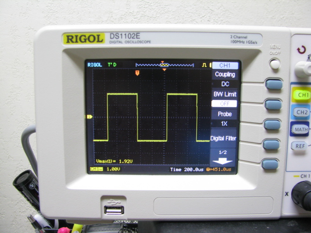

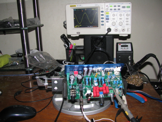

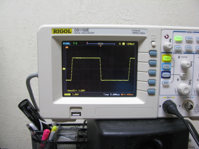

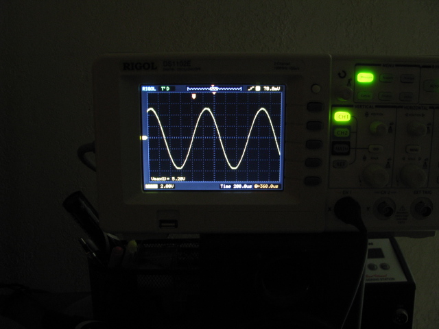

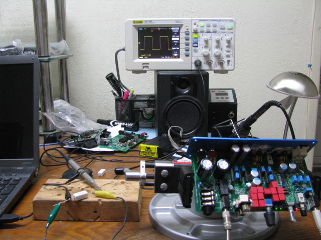

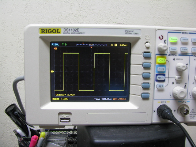

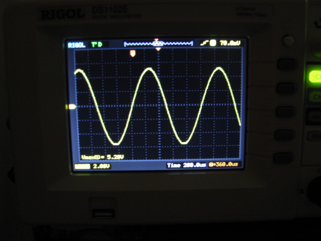

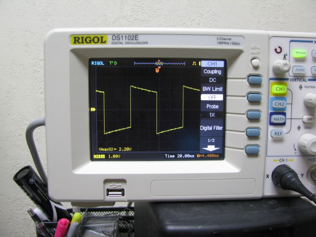

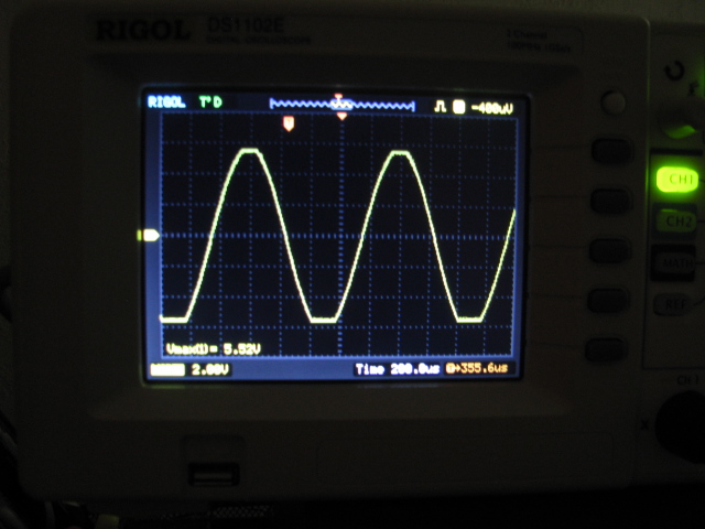

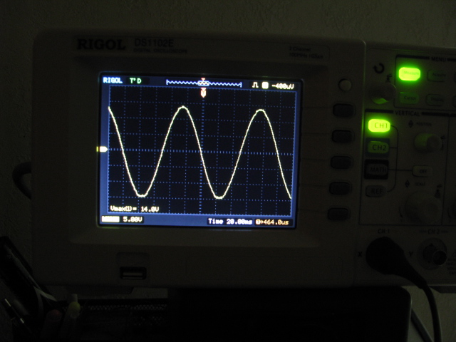

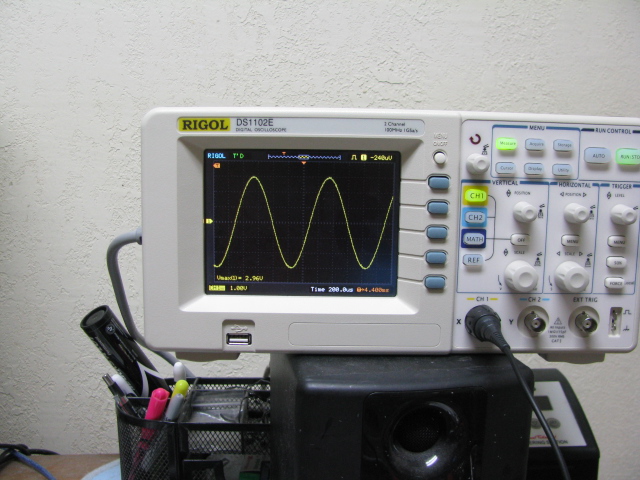

Here are the waveforms from some testing of this amp project, both for the first (gain) stage and the output stage powering headphones.
The first photo is the test setup. A function generator going into one channel and a scope on the output. The gain stage waveforms are taken off the input to the 1K attenuation resistor, which is the output of one channel's LME49990 gain chip. The output stage waveforms are taken off the amp output with a fairly sensitive 110dB/V set of test headphones (100mV for full volume, approximately).
The next photos are checking for clipping behavior. I increased a sine wave's amplitude until one of the rails clipped at 1kHz, then ran it down to 10Hz and up to 20Khz to see how consistant everything is. The result: extremely consistent vs. frequency! Almost nil change in amplitude or clipping level from 10Hz to 20kHz.
The clipping first occurs at -5.6Vdc on the negative rail, because the gain stage will have a small amount of DC offset from the chip's input offset voltage, the 10K input resistor (times the op amp input bias current) and then increased by the closed loop gain of the stage. All of this is the same for RocketScientist's O2 amp, which is one of the reasons he included that coupling cap in the middle to isolate gain stage offset from the output stage. If the signal amplitude is run up further (as shown in one photo) until the positive rail clips, it is also at +5.6Vdc. So no lack of symmetry in the amp per se, just the normal DC offset.
One of the outcomes here is to verify where I have the clipping indicator reference voltage levels set. The blue LEDs set the clipping points at about 2V below (positive rail) or above (negative rail). The results here show that for +/-7Vdc rails the clipping is at 7Vdc - 5.6Vdc = 1.4Vdc below the rail, and with the +/-16Vdc rails the clipping in the photos is 16Vdc - 14.5Vdc = 1.5Vdc. So for either rail voltage the clipping indicator LED will light about 1/2 volt *before* clipping actually occurs, which is exactly what I want it to do, to be an alert that signal levels are getting too high before they actually hit clipping. So I'm probably going to keep the internal blue LEDs, just tone then down a bit by increasing the series resistor so it doesn't glow blue through the end panel cracks. 🙂
Photos:
1-8 are all done with the power supply rails set to +/-7Vdc
1. test setup.
2. 1kHz gain stage output, showing neg half clipping onset at -5.6Vdc
3. 10Hz gain stage output, showing neg half clipping onset at -5.6Vdc
4. 20kHz gain stage output, showing neg half clipping onset at -5.6Vdc
5. 1kHz gain stage output, amplitude increased until both rails clip at +/-5.6Vdc
The next three have the amplitude backed down about a volt to stay away from clipping, to look at square wave waveshapes.
6. 1kHz gain stage output square wave.
7. 10Hz gain stage output square wave.
8. 20kHz gain stage output square wave.

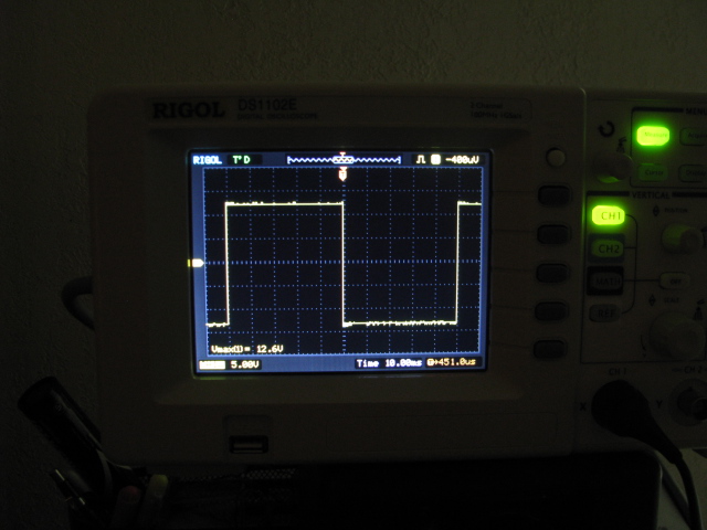

9 and 10 are done with the power supply rails set to +/-16Vdc
9. 1kHz gain stage output, amplitude run up to show clipping on both wave haves, clipping onset on both wave halves at 14.5Vdc
10. 10Hz gain stage output, clipping onset on both wave halves at 14.5Vdc

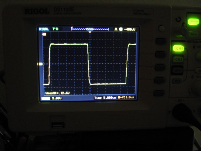

All using the +/-16Vdc power supply rail setting now. Amplitude backed down to about +/-12.6Vdc to avoid clipping to show the square wave shapes.
1. gain stage output square waves at 20kHz.
2. gain stage output square waves at 10Hz.
I ran out of attachments. Here is part 2...

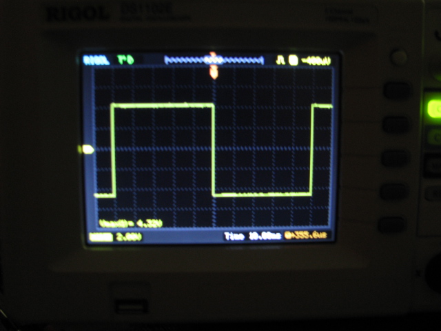

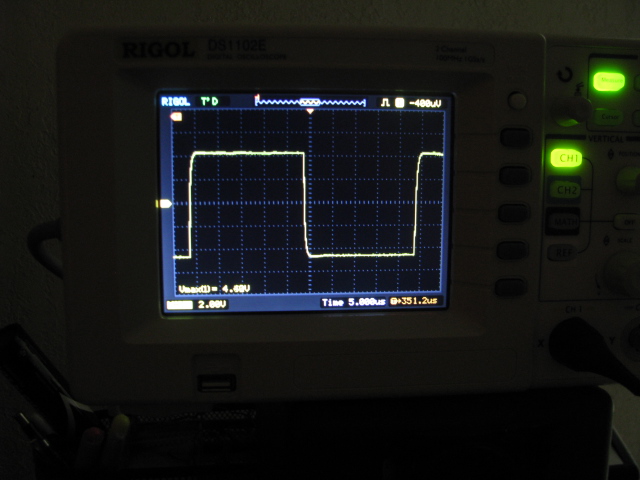

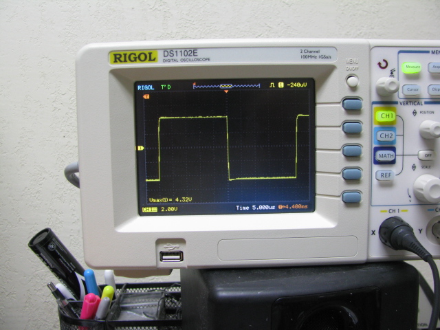

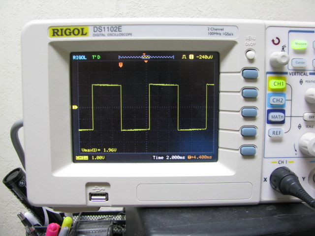

Here are some pictures of the parallel output stage under load. The test setup in the first photo is just a 15R and 43R 5W resistor sitting on a 2x4. These are all with the power supply rails set for the +/-7Vdc position to show the high current output capability of the amp for hard-to-drive headphones with low ohm loads and low sensitivity.
The first two scope shots show something the O2 headphone amp can't do. That is a 4Vpeak 1kHz square wave and sine wave into 15 ohms. For the sine wave that would be 4Vpk / 15R = 267mA(peak), or (4 * .707) / 15R = 188mA(rms). That is about twice the output current capability of the O2. The output chips were just slightly warm at that level since it is running on the +/-7Vdc power rail position.
The next 3 square wave shots are with the 43R resistor (my Shure SRH940s are 44R), +/-7Vdc rails, and a 2Vpeak wave. 1kHz, 10Hz, 100Hz, and 20kHz. The droop on the 10Hz square wave is the effect of the coupling cap, as expected, forming the high pass input filter with Fc = 1.12Hz.
The final 3 square wave shots are with the 15R resistor, +/-7Vdc rails, and a 2V peak wave. 20Khz, 10Hz, and 100Hz.

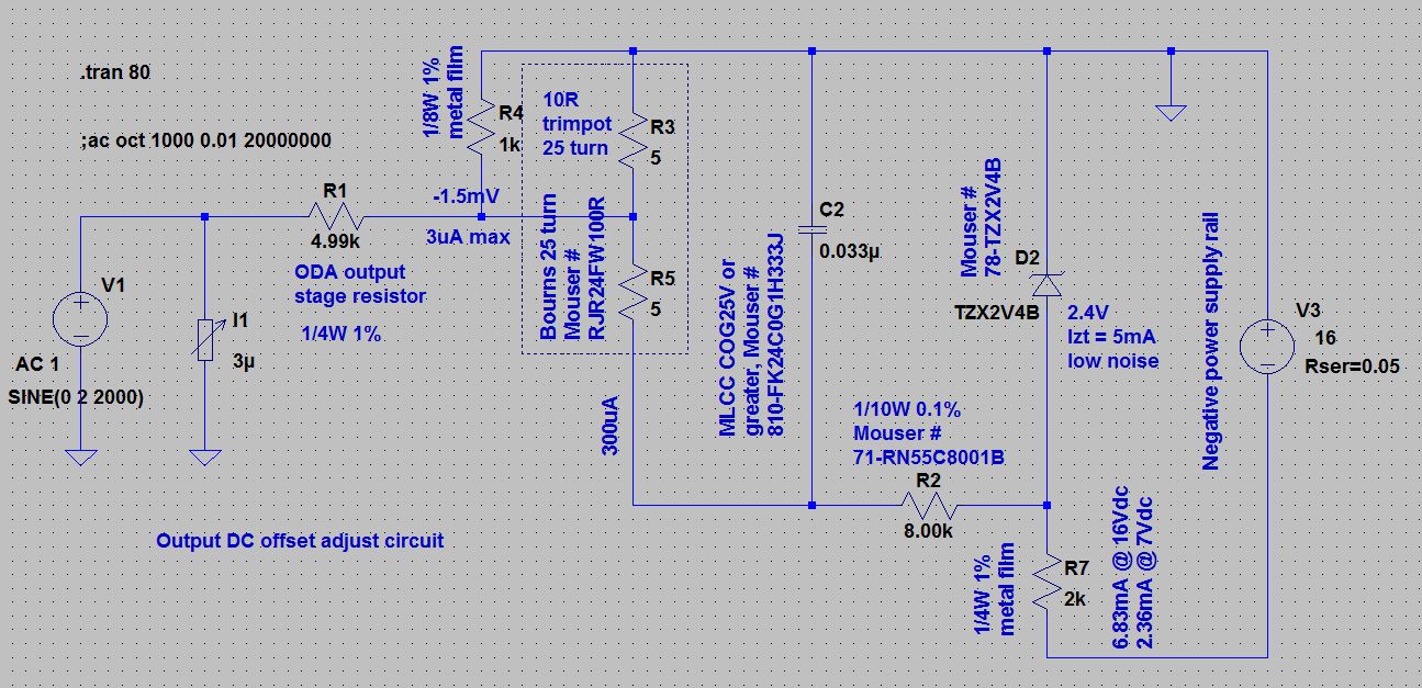

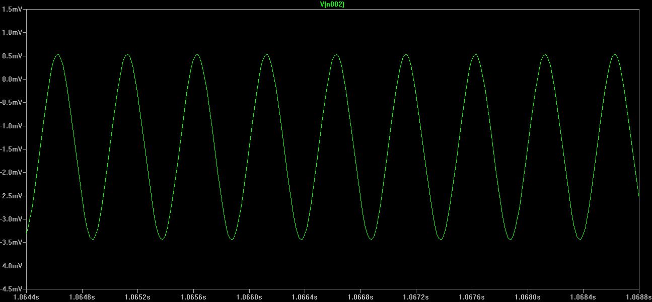

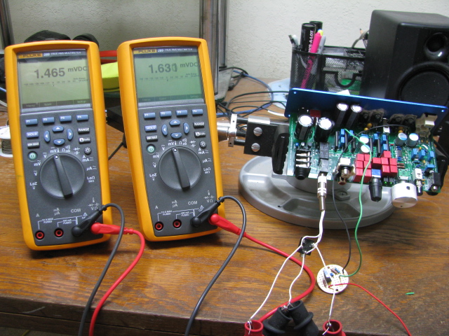

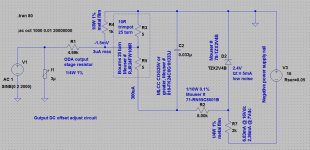

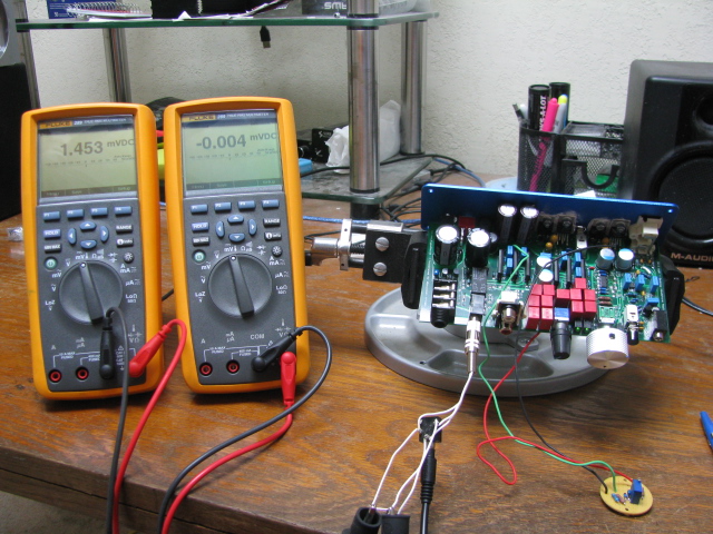

DC offset fixed passive reduction circuit
Here is something kind of interesting. From the table of per-output-chip DC offset numbers I posted a few posts back it appears that the NJM4556A output chips have a rather consistent DC offset. All around +1.5mVdc, plus or minus a few hundred microvolts.
So rather than a DC servo, it hit me that a fixed passive DC offset correction might work well. In other words return the input bias ground return resistor on the output stage to -1.5mVdc rather than ground to cancel out the combined amp DC output offset of +1.5mV. The results are below. All in all it seems to work extremely well and, most importantly, seems to be fairly stable over time. Unfortunately there is no space on the PC board to add the circuit but this might be a good addition to a top-slot accessory board at some point in the future.
The circuit is below. Just a 10 ohm precision 25 turn trimmer pot and series resistor being fed from a 2.5Vdc zener or precision voltage reference through a noise filter. There are a few advantages of the fixed circuit over a servo:
* No oscillation, either high frequency or subsonic. Since there is no (servo) feedback loop there are no loop oscillation problems.
* No virtual ground through an active class AB output stage. This circuit is essentially just 5 ohms to ground in series with the 4.99K input bias ground return resistor. If a OPA627, etc, is used in a DC servo loop there is the chance that the AC signal going in the reverse direction toward the chip's output could force the chip's output stage through the class AB transition region, potentially adding distortion. In other words, the DC servo chip's output essentiially is forming the dreaded virtual ground with the AC signal being returned to it. This is even more likely since the DC correction voltage being produced is just 1.5mV while the reverse direction AC signal (5R in series with 4.99k) can be up to 10mV or so with a full 10Vrms signal swing in the amp.
* (essentially) no frequency sensitive components. The corner frequency of the zener filter is high enough to be out of the way with the listed 0.033uF capacitor. An active precision DC servo chip may otherwise require an output T filter to start shunting the reverse AC signal to ground at 1kHz or so.
There is one hiccup with the circuit. The DC output offset voltage of the NJM4556A chips is around 1.45mV with +/-7Vdc power rails, but around 1.65mV Vdc with the +/-16Vdc rails. In other words, pushing the power rail voltage selector switch causes a 200 microvolt shift in overall DC output offset. From the photos below, the circuit works so well that either offset can be reduced to around 20uV. So one rail setting or the other can be nulled out, which will leave the other at around 400uV, which is still just 400uV / 1.45mV = 30% of the uncorrected DC offset in the "higher" position. The other way, which I've tested, is set the +/-7Vdc rail position for +200uV offset, which then cause the +/-16Vdc rail position to be -200uV. Either one is just 200uV / 1.5mV = 14% of the uncorrected value.

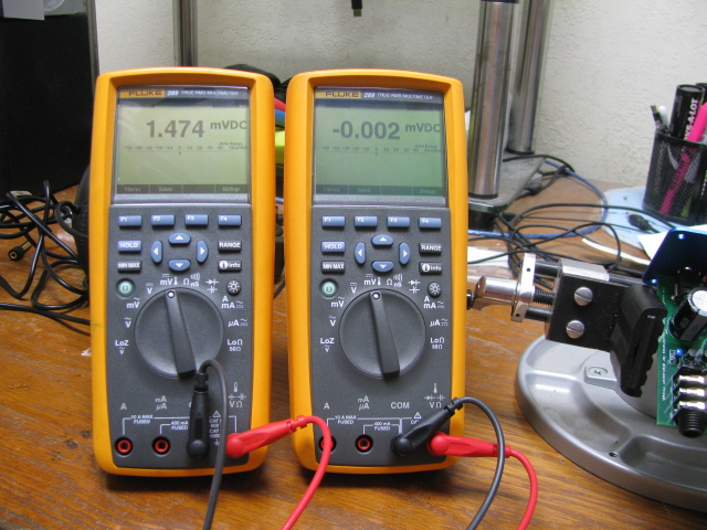

The first photo shows the test setup with the DC offset readings of the amp output on the two channels. The round circuit board is the implemented circuit but unhooked (red wire is output) at this point. 1.46mV and 1.63mV, again rather close and both the same polarity.
The next photo shows the circuit wired into one channel. The next photo shows the new DC offset on that channel. I was able to adjust the trim pot for just -4uV (microvolts!) of DC offset. The setting at this point is with the circuit only having been on about 5 minutes since power-on.
The last photo is the good stuff. 😀 This is 30 minutes of music playing later to warm up the parts, looking for the amount of thermal drift at this point. Essentially unchanged at -2uV. With the unit in the case where things would get a lot warmer inside I would expect more thermal drift than this, but still pretty darn good.
I didn't take a photo of the case where the +/-7Vdc rails were adjusted for -186uV of output DC offset, but the result in the +/-16Vdc rail position was around +195uV.
