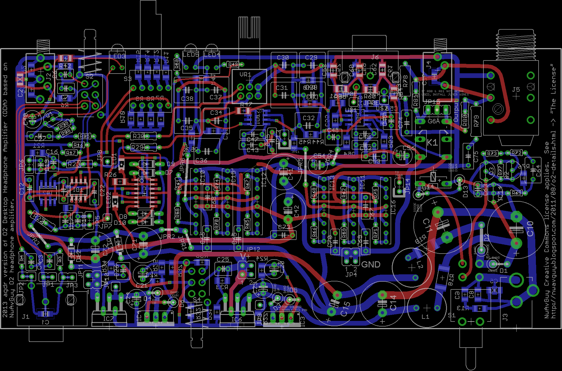

V1.2 updated Gerbers, layout, schematic
As per the license discussion, here is a revised layout with the license wording on the PC board changed to reflect NwAvGuy's Creative Commons license.
I've made a few more upgrades. :) I realized that 5 of the 4.7uF coupling capacitors per channel are adequate rather than 6, chopping $10 off the cost. The corner frequency of the O2's 2.2uF + 40.2k pair is around 1.8Hz. With the 6 4.7uF caps and 4.99k the ODA previously was around 1.12Hz. Now with 5 caps the corner frequency is around 1.3Hz, still better than the O2.
And... getting rid of those caps freed up some PC board space to make another attempt at adding back in a linearization loop around each channel's paralleled buffers. Occured to me a couple of days ago that although the LME49990 is apparently way to fast to be using in a loop with the slow NJM4556AL buffers, the NJM2068 (the gain chip in the O2) is a lot more in the ballpark and should work. The unity gain bandwidth of the NJM2068 is 27Mhz vs. 110Mhz for the LME49990, vs just 8Mhz for the buffers. Still faster than buffers, but at least a fair shot at keeping the NJM2068 stable.
Plus, the best part, looking at the gain/phase curve the NJM2068 starts out at 0 degrees, going down to -90 (90 degrees lag) at unity gain. Recall from past posting that the NJM4556A has a 30 degree lag which starts dropping rapidly after the audio band. Together the loop should have a fairly large phase margin. Enough that I wouldn't be worried about the various headphone capacitive loads that could be attached. TI still hasn't come up with the gain/phase plot for the LME49990. The OPA627 that I tried for the loop at the start of this thread and eventually oscillated at 70K started out with the fairly large 90 degree phase lag, which together with the NJM4556A's lag resulted in no phase margin.
RocketScientist / NwAvGuy wrote that he measured the NJM2068 at having lower distortion than the NJM4556A and that the distortion numbers of the NJM4556A are theerfore the limiting factor in the O2. So if the loop here works properly, there is at least the possibility of reduced output stage distortion vs. the O2. I've laid it out so that the NJM2068 loops on the output don't have to be used. The parts can be left unpopulated and 1206 0R jumper resistors soldered in to bridge input to output, in which case the design reverts to the previous V1.1 without the output stage feedback loop.
I'm going to pull a RocketScientist / NwAvGuy at this point and disappear myself. :) John has some very good points about the licensing questions with the ODA. I'm not going to sink any more time into it. But these Gerbers should be fully functional if anyone should want to give it a try, although for home use and not commercial sale.

Back to the technology... if anyone etches the last set of Gerbers I posted, two things need to be done. First I've realized that the 0.51R CLC resistors really should be a higher wattage for longevity given the half wave charging spikes. I've changed those to 2512 2W SMD parts, but an easy fix on the board is leave the two surface mount 1206 SMD resistors off and just solder a through-hole axial 0.51R 2W between the two pins on the cap and inductor that the SMD traces went to for each resistor, right under the board. Plenty of space in the case for that. Or the two 0.51R resistor pads can simply be shorted. Those resistors are just a small tweak to lower the Q of the filter circuit to get rid of a tiny amount of overshoot.
Second the NJM2068 loop around the output buffers is likely not going to work, so leave that chip off and use the two 0R bypass resistors that I included on the layout to feed the output buffer chips directly from the coupling caps. I was able to reproduce the triangle wave oscillation that I saw with the LME49990 loop chips in an LT Spice simulation using the NJM2068 chips instead and the output buffers. I believe I know what is going on now. It is likely more related to slew rate, in having a faster slewing chip (the NJM2068) powering a slower slewing chip (NJM4556AL at only 3V/uS). The slow chip trying to keep up with the faster slewing chip produces the small-amplitude triangle waveform.
This one was a little tricky to figure out. The audio has a swing of up to 10V rms with the 17Vdc rails. So with a 3V/uS slew that would be about 3.2uS for 1/4 of the wave or a frequency of 78kHz for the full cycle. Still adequate for audio. But the problem is with much smaller amplitude swings (noise) which takes considerably less time even at 3V/uS, and can result in small amplitude, but fast frequency, triangle wave oscillation.
There really isn't a workable audio-capable chip with a slew less than 3V/uS to wrap around the NJM4556As that I can find, so the best solution is just not to go there with this design and leave the NJM2068 chips around the buffers out entirely. Just feed the buffers directly from the coupling caps, as in the O2 by using those 0R 1206 resistors.

Hey agdr, sweet project! Its clear you've put a lot of effort into it and I would love to hear it.
If I could make one suggestion, it would be to clean up your schematic in Eagle and split it up over multiple sheets. As it stands, its pretty hard to decipher everything that's going on.
Olin Lathrop has a great post on how to keep schematics tidy and legible.
Rules and guidelines for drawing good schematics - Electrical Engineering Stack Exchange
Excellent suggestion! Thanks. :) I didn't know Eagle could do that. I've only been using Eagle for about 6 months now, so definitely still in the learning mode. Its been a couple of decades since I last laid anything out.
Hey I just adopted one of your design points. I had forgotten about that 300mW surface mount version of the NJM4556A until I saw it in your design. Earlier in the thread it was suggested to add a pre-amp output jack on the front. I've finally got onboard the train and decided that is a good idea. That NJM4556AM surface mount chip makes the perfect buffer for the pre-amp out! 300mw is perfectly adequate for just driving an RCA cable and line-level pre-amp inputs. Earlier in the thread I was thinking of taking pre-amp outs directly off of the gain stage LME49990 chip, but that would be a bad idea due to cable capacitance.
Excellent suggestion! Thanks. :) ....That NJM4556AM surface mount chip makes the perfect buffer for the pre-amp out! 300mw is perfectly adequate for just driving an RCA cable and line-level pre-amp inputs. Earlier in the thread I was thinking of taking pre-amp outs directly off of the gain stage LME49990 chip, but that would be a bad idea due to cable capacitance.

V 1.4 Gerbers, layout, circuit, BOM, changes
Here is the latest and hopefully last revision of this project. Gerber files, layout, circuit, BOM, and list of changes. Still coming are updated build instructions and Front Panel Express CAD files.
The change list has the details. The DC servo is gone, output balancing resistors changed to 0.5R, pre-amp jack and optional buffer/amp added, the 6th coupling cap on each channel is back for a Fc of 1.12Hz, upper power rail voltage switch choice is now +/-16Vdc isntead of +/-17Vdc, test points added for the pre-regulator voltages, and CLC resistors now 2512 size.
Feeding the pre-amp out jacks from the gain stage doesn't make any sense given that it can produce up to 10V of swing for the output stage and we need line level. Instead a twisted pair of wires from PCB holes provided can be used to hook it up in various ways:
* Connect to the input jacks for signal pass-through
* Run the input jacks through a new 1x buffer stage for pass-through with current buffer
* Same as above, but add a gain resistor for voltage gain. Default is 2.5x.
* And the option is still there to hook the pre-amp out to the out of the gain stage or even amp output, if needed.
The OPA2188 chip turned out to be useless for the DC servo in some testing I've done. I missed that the input offset current with the chip is so large that when multiplied by the servo resistors produces an offset of about the same size as what is being corrected. I tried an OPA627 instead and that did work well for the servo, dropping the DC offset to about 250mV. But the 80kHz oscillation from the start of this thread was back, due to the 90 + 60 degree lag leaving no phase margin in the loop. The new 0.5R balancing resistors further lower the output offset to about 1mV, so I'm dropping the DC servo entirely and calling that good. Still 3x lower output DC offset than the O2 amp.

My main intent with the board run is to build one up and check the 4 layer design, but it looks like I get 10 boards for $120 plus $32 in DHL express costs, or about $15.20 a board. I want to keep 3 bare boards, but that leaves 6. :D Assuming all works properly when I build the test board up, I'll go ahead and make the remaining 6 available at cost plus shipping if anyone is interested. Just send me a PM. I'll have to PM the moderators and find out what the appropriate forum is here for such thing for the subsequent follow-ups, group buy forum, vendors forum, etc. I'll even make a $1 donation to the forum out of my pocket for each board. Anyone interested in the remaining boards just PM me and I'll parcel the 6 out in order of requests received. 1 board maximum per person and anyone can decide to "opt out" along the way if they change their mind. I'll only collect money via paypal when it comes time to ship out. Shipping will be somewhat more expensive since I insist on using something with tracking and/or delivery confirmation. Here in the US postal service priority mail plus delivery confirmation would do the job, which is probably $7 or so. I'll find out. I'm going to have to do some work to add the 3rd and 4th layers so it may be a couple of weeks before I send an order out. Then once I get the boards back probably another week or so for me to build up one and test/verify it.
mrsavage - if interested you can have first dibs on one of the extras at the $15.20 plus shipping cost so you don't have to buy a whole run of them. :) No pressure though, go right ahead and do an order yourself if you want. Here are the details on the board houses. Good you asked, I've forgotten to post that information.
