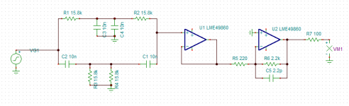

To make a notch filter with preamp you need less than you think. I assembled few myself using prototyping board. There is a schematic below shows simple notch filter with freq around 1kHz and Q of 0.5 and preamp with gain of 20dB. The only thing you need is tight tolerance components for the filter itself. In this case you may want to select manually matching component from a tray.
As for opamp in preamp, it is good to use some high performer/low noise, but it is not really essential. Signal level will be very low, so distortion of amplifier are going to be on a very low level. You can also deal with noise decreasing resolution bandwidth of a spectrum analyses. I was using LM4562 myself. Probably OPA211/1611 can give a bit better noise level. May be LME49990, but I think this is overkill. Resistors - thin film MELF 0204, capacitors - NP0 1206.
To achieve good main tone suppression you will need to tune freq of sig gen withing 1Hz. With these values I was usually getting something around 1013Hz and something like 70dB of suppression. Mind you that if you will be using sound cards you will notice that frequency is a bit off from card to card.
Do not forget that notch filter affects also level of harmonics, so you will need to add some correction coefficients to numbers you will be getting.
If you want to have higher Q, you may do as described in this paper http://www.analog.com/static/imported-files/tutorials/MT-225.pdf, but don't push it to far, will be hard to find the center of the notch.
Also depends on situation some DC decoupling and EMI filtering can make a difference 🙂

I just realised that it could make sence to use JFET input op amp, at least for the fist stage. With BJT input current noise will dominate over the thermal noise of the filter itself.
agdr

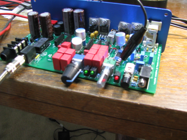

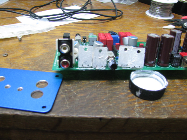

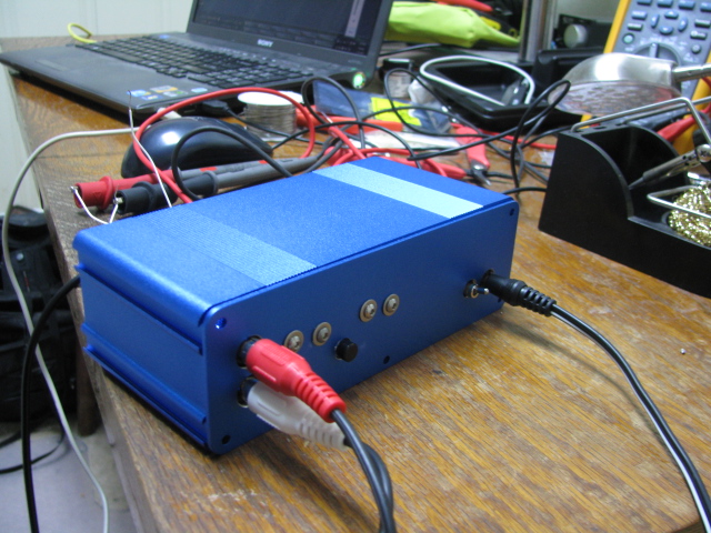

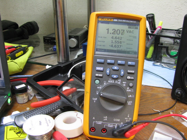

Well I just managed to get the clipping indicator on the ODA board working. I have to say this indicator absolutely rocks. 😀 Every O2 needs one of these. Wasn't working until now because (1) I forgot to solder in the resistor that is in series with the clipping indicator LED and (2) pin 1 of the TL064 didn't get soldered properly.
The first two photos below show the results. The two green LEDs are the power LEDs, one per rail, and the red LED to the right is the clipping indicator. I had the source input level and gain set so that it was flashing on and off intermittently with the clipping, like it should, and took a few photos to catch it while "on" like this.
I have the DMM in the background set to record AC peaks, and on the screen you can see the highest peak is 4.6V. Remember that the clipping indicator is on the FIRST stage, the output of the gain stage, so the meter is hooked to that black test clip that is taking the signal off the input to one attenuation resistor, which is the output of one channel's LME49990 chip. The position of the pot won't matter for clipping, of course, since it is what the gain stage is powering. But the gain switch position does matter. Here I have it set to the 3rd rotary position (4x before the atten resistor). Setting the gain switch to the last 6x position results in the clipping LED going on solid (continuous) red, as it should.
I have the power rails set for the lower +/-7Vdc position. I've measured the two blue LEDs that form the window comparator upper and lower reference voltage levels at 2.9V for one and 2.8V for the other. That gives clipping reference levels of 7Vdc - 2.9Vdc = 4.1Vdc and -7Vdc - (-2.8Vdc) = -4.2Vdc.
So you can see the meter's peak gain stage measurement of 4.6V is right where it should be with clipping reference levels (the levels that have to be exceeded to signal clipping) of 4.1V in the positive swing direction and -4.2V in the negative directly. By dropping the volume level of the source (laptop) very slowly and carefully I was able to get the music peaks right at 4.1 and could see the LED just barely start to flash. The source level worked out well. On the 4x gain setting clipping happens with the PC volume slider up about 95% of the way. The PC software volume slider is very logarithmic, so a little movement produces a big output change near the top.
Note that actual clipping isn't being measured, just how close the gain stage output swing is getting to the rail. But by the time the swing is within 3V like this for +/-7V rails, it is getting near to the maximum swing level for the chips. The main purpose is to alert the user that the swing is getting too large and any distorted sounding music that follows is due to clipping, not the amp. With the O2 there is no way to know how close you are getting to clipping without a scope or knowing exaclty what the output of your source is, peak, times the O2 gain.

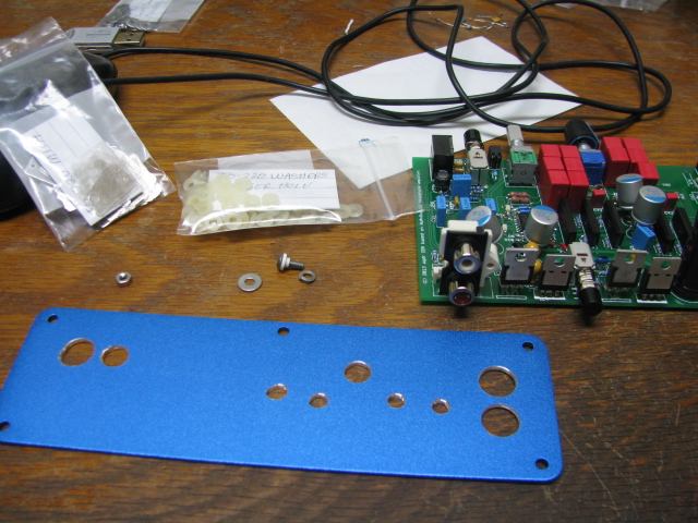

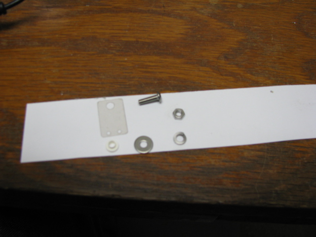

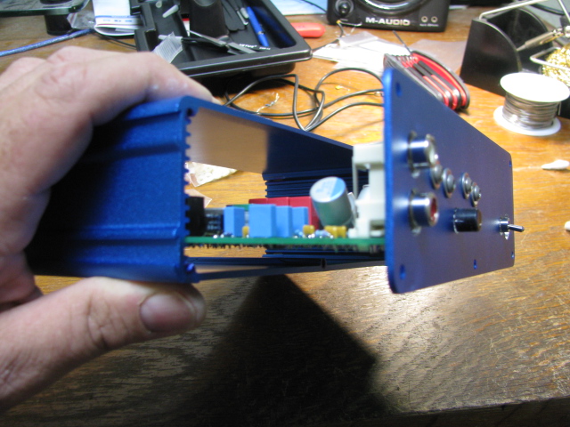

The other pictures below show adding the back panel and attaching the heat-sink mica washers and hardware to the voltage regulators. I used 3mm x 10mm stainless steel button head bolts, fender washers, lock washers, nuts, etc. I made the panel myself using caliper measurements and a step drill. I'm working on a CAD pattern for Front Panel Express from the PCB and part's CAD measurements. Should look more professional than my panel here. 🙂
The rear panel RCA jacks and input selector switch work! That is what I used for the tests above.
I've uncovered a problem with the layout and schematic I posted. When I switched from using a 16Vac transformer to 24Vac I discovered that the protection diodes across the pre-regulators, D3 and D4, are backwards! That is right, they were completely bypassing the pre-regulators, Just flip them around. I'm 500% more impressed with Linear Technology parts now, though. With the pre-regulators bypassed the LT1963A, with a maximum datasheet input voltage of 20V, got hit with 35V and survived. I couldn't believe it. I've had parts actually explode when hit with just a couple of volts past maximum. It did shut down with the overload, but then came right back with proper voltage applied. The LT3015 kept regulating right on the money even with 35V going into the 30v max part. I've replaced both LT regulators regardless, figuring they were long-term damaged, but still a pretty impressive showing for those LT parts.

JFET input has much lower input current noise, in range of fA instead of pA for BJT. This matters when it works from high impedance source. If current noise multiplied by impedance of the source higher than voltage noise or/and thermal noise - it will dominate. In example I've shown voltage noise of the notch filter will be around ten of nV/sqrtHz, so input voltage noise of almost any low noise opamp will be less than that. But if you multiply typical input current noise of, for example NE5532, 2.7pA/sqrtHz by impedance, say 10k (freq dependent) you will get value around 27nV/sqrtHz. This noise source will dominate in this case. If you aiming for lower noise, you'll need opamp with lower input current noise. That is where JFET may have benefit, since they have lower input current noise.
Another way to improve situation with noise in this case is to drop all resistor values, for example 10 time, and increase all capacitors by the same factor. Despite thermal noise will go down only around 3.2 times, effect of opamp current noise will be scaled down by the factor of 10. This will allow to use BJT input opamps without danger of degradation of noise performance. This may also improve linearity, since distortion caused by non-linearity of input current will be also scaled down.
Though it may cause other problem, since filter may load signal source too havy.
Cheers

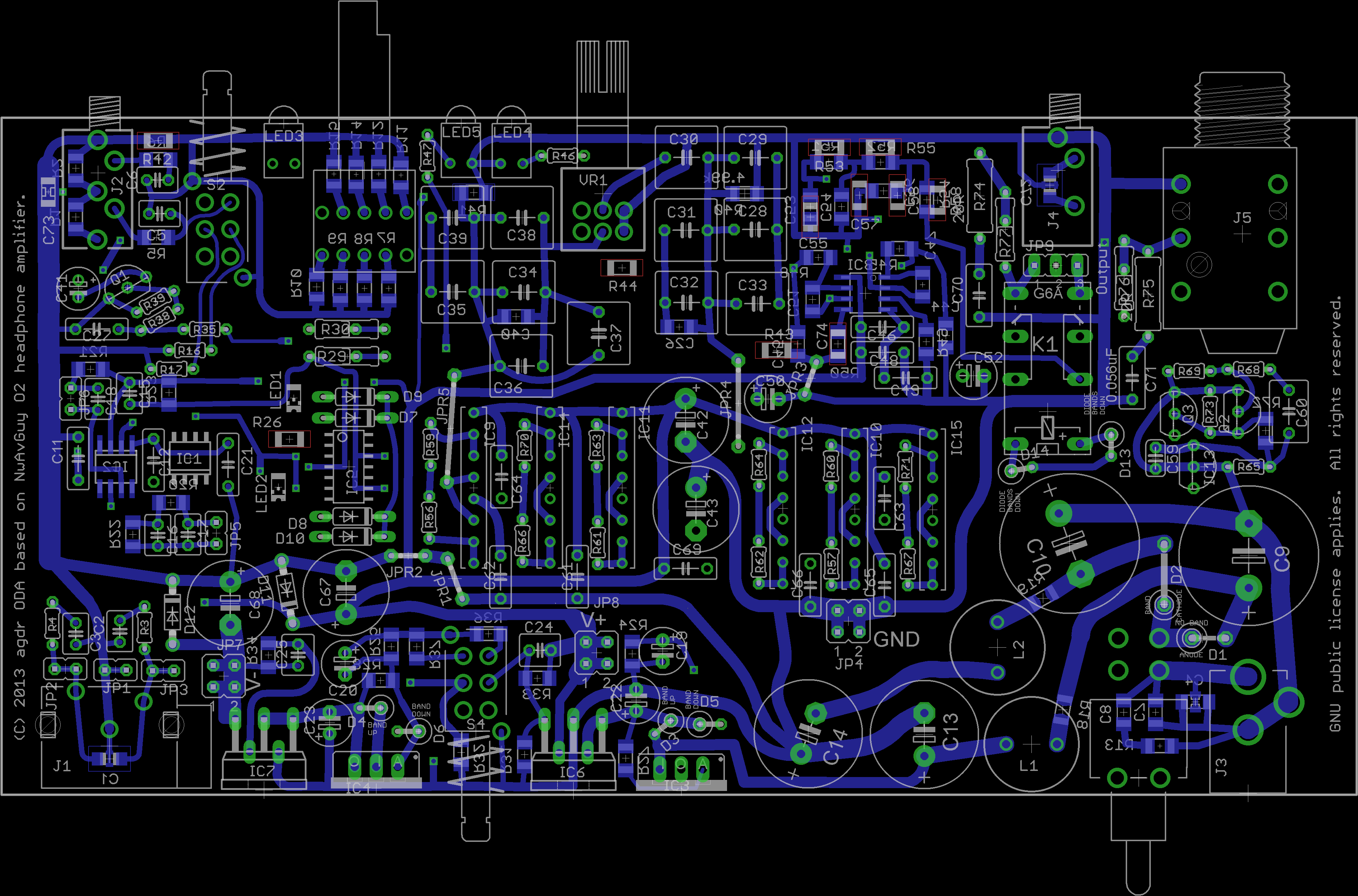

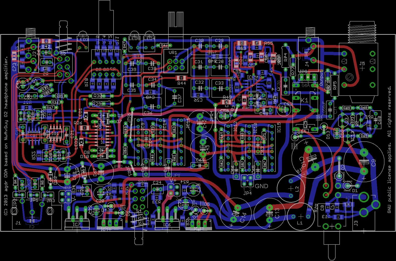

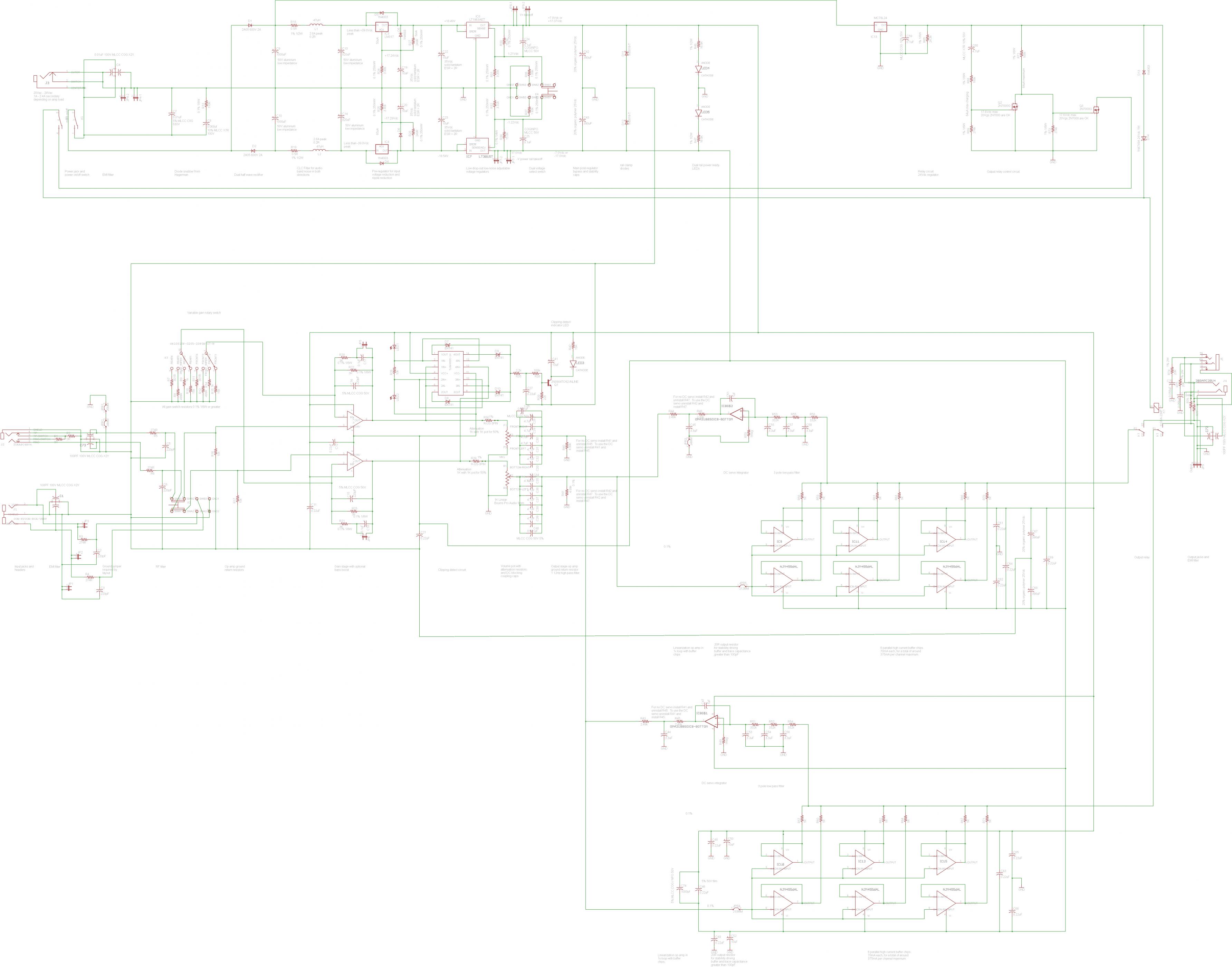

ODA V1.1 updated Gerbers, layout, schematic, BOM
Here is V1.1 of the PC board Gerbers, layout, schematic, BOM and change list for this O2 Desktop Headphone Amp project.
I'll post a revised set of build instructions this weekend.
Front Panel Express CAD files for the front and back panels will come eventually... working on them.
