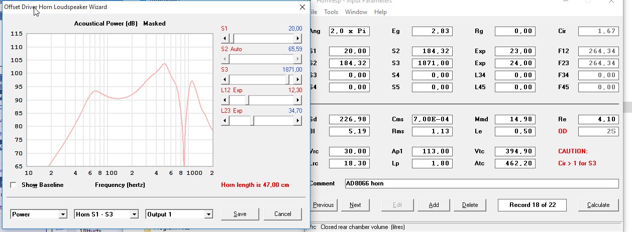

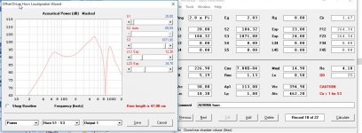

X you say put woofer more to throat give a horn load for it, and the peak (that is because of hornload) and dsp it away is not a good idea, because it will possible also modulate the HF, and when you need dsp it then efficienty is also dsp away.
The frequenties below horn cut off is the problem, making it normal efficienty not more then sensitivity of used speaker, so no dsp but put woofer more to mouth giving a nice output when use a analog low pass filer and dsp the hf alone.
What happens when put woofer close to throat you can see here, a uge peak where hornloading occurs, but below it loos everything, so dsp this is useless.
Maybe I am wrong, I am not so educated what speaker systems concerns but learn fast I think. Yes calculations still is a problem, I am never be good in this, and use help from internet and calculator.
regards

Maybe you are right about the HF modulation - probably bad. But lots of builds are putting big woofers right at throat. Look at Legis' horn and also the Jubilee with a pair of sizable woofers in Cask05's thread:
Something to be said for horns with a flat wall that allows easy and closeup woofer mounting with a simple plywood board.
Kees, the "big" bandpass overshoot peak is no big deal for DSP to flatten out with a single -peak cut PEQ.

X you are right however we are deal with a wide band speaker and not a compression driver, there is differents, and with the synergy there are threat's about the speaker modulations also, yes I now it are all compromisses and I like the idea to do all analog, with a simple coil I can make a 12 dB because if natural fall off, and peak is 6 db also, so the coil flatten it out easely as you did see in previous posts with pictures.

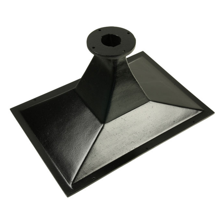

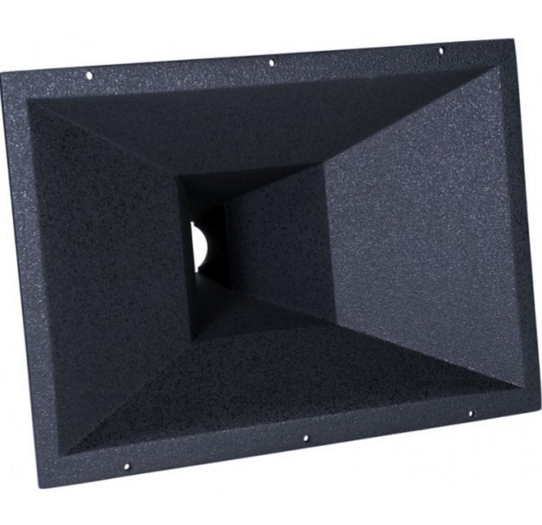

Speaking of bigger horns I came across the BMS 2236 Fibreglass horn designed for the 2" throat 4590 compression drivers. It is an interesting shape with a few flat sides that woofers might be mounted to.
At nearly 500mm wide it's not really suitable for a bookshelf
View attachment 528764 View attachment 528765 View attachment 528766 View attachment 528767
528765d1454418769-bookshelf-multi-way-point-source-horn-screen-shot-2016-02-02-9.08.10-pm.png
There are a lot of flat walls to attach woofers/mids to with this thing. Fully-loaded you can add 4 mids and 4 woofers! A beast for sure. The 2in throat may be perfect for a SS 10F though.
Thread title of "Bookshelf" notwithstanding, a great find and thanks for pointing it out.

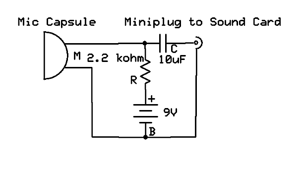

Is that the Siegfried Linkwitz special based on Panasonic WM-61A capsule for $2? I made one of those too but the USB interface of the UMIK is oh so nice. 🙂
Yes it is, I am use a other microphone amp with very high quality opamps, and cap is modified, it works fine, can go high spl if i want... But UMIK has also just a capsule and a calibration who works the same. But it have a usb and works without al that stuff connected like here is indeed very easy, WM-61 is not made anymore so maybe I go to the UMIK because it is not so expensive. But I like making things, that is why we are on diy here. I have to build the amp and mike in a case so I have one box and one cable connected to.

Yes, I used a WM-61 capsule for many years with ARTA. Here's my schematic
