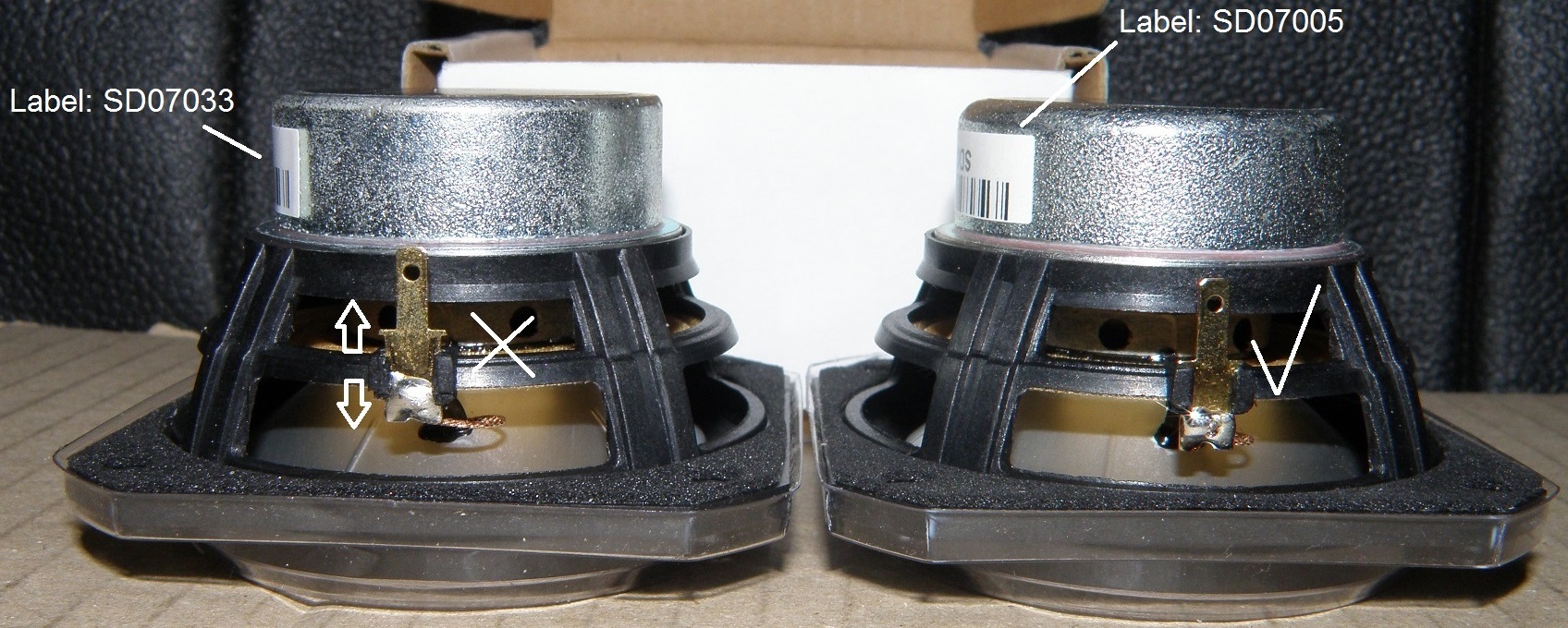

If you interested in trials to mod a SB65WBAC25-4 driver to see if small improvement can be find seems i got one we can play with and think of if we can improve a bit on waterfall in REW. Either i could do trials on a small OB where you suggest mods and i do them and publish measurements before and after, or i could send it to bushmeister and he could mod it.
Reason is received a pair before weekend where positive terminal on one of them was loose and rocking and Intertechnik via email told me they send one more for free on monday. 🙂 never had such a small full ranger in hand and couldn't resist compare dimensions to 10F/8424 and SPA-115PA.

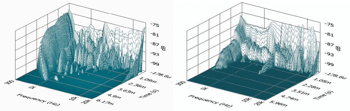

Third picture is CSD SB65WBAC25-4 verse 10F8414G10 from here:
Test Bench - SB Acoustics SB65WBAC25-4 2.5? full-range driver | audioXpress
Test Bench - Scan-Speak 10F/8414G10 Small 3.5? Full-Range Woofer | audioXpress

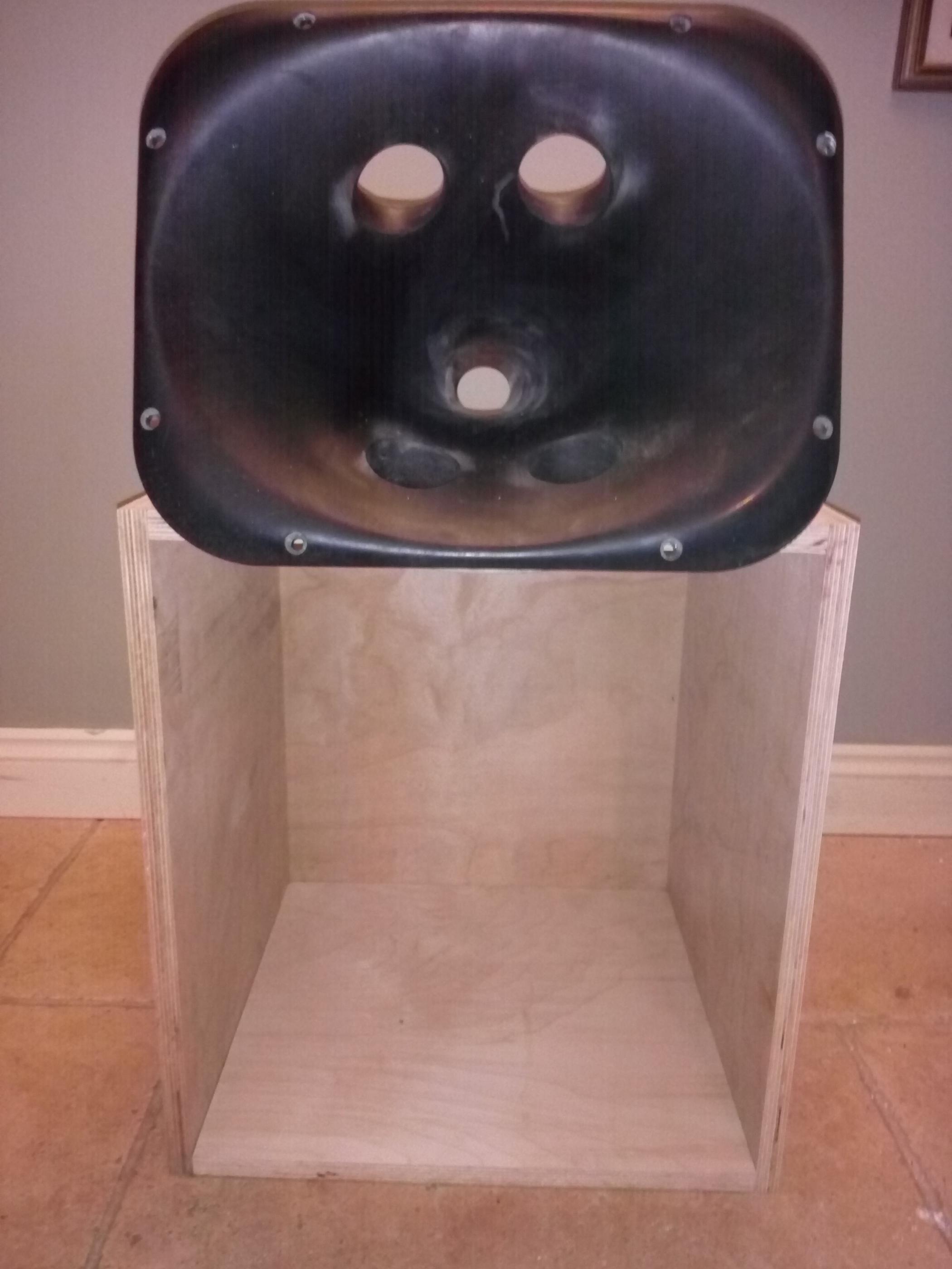

I ended up using hot melt glue to fill the gaps and bond the insert to the horn. I was also able to shape the hot glue as it cooled to a pretty smooth profile. I then put a layer of black electrical tape over the glue for the joint temporarily for smooth transition.
528427d1454257369-bookshelf-multi-way-point-source-horn-hole-repiar-success-photo.png
Measurements show that it was quite successful in boosting the output by about +2.5dB and smoothing it out - compared to taping over the holes to simulate a pristine horn.
I concentrated on the 30 deg measurement in detail to see this effect (red=big holes, blue=repaired, green=holes taped over):
528425d1454257077-bookshelf-multi-way-point-source-horn-sb65-lth142-eq-6thfdw-polar-vertical-big-holes-repair-compare-30deg.png
There is still a mild dip at 2.5kHz but the overall shape follows the pristine horn pretty well that I am satisfied with this performance. The taped over holes also has a bit more bass extension.
