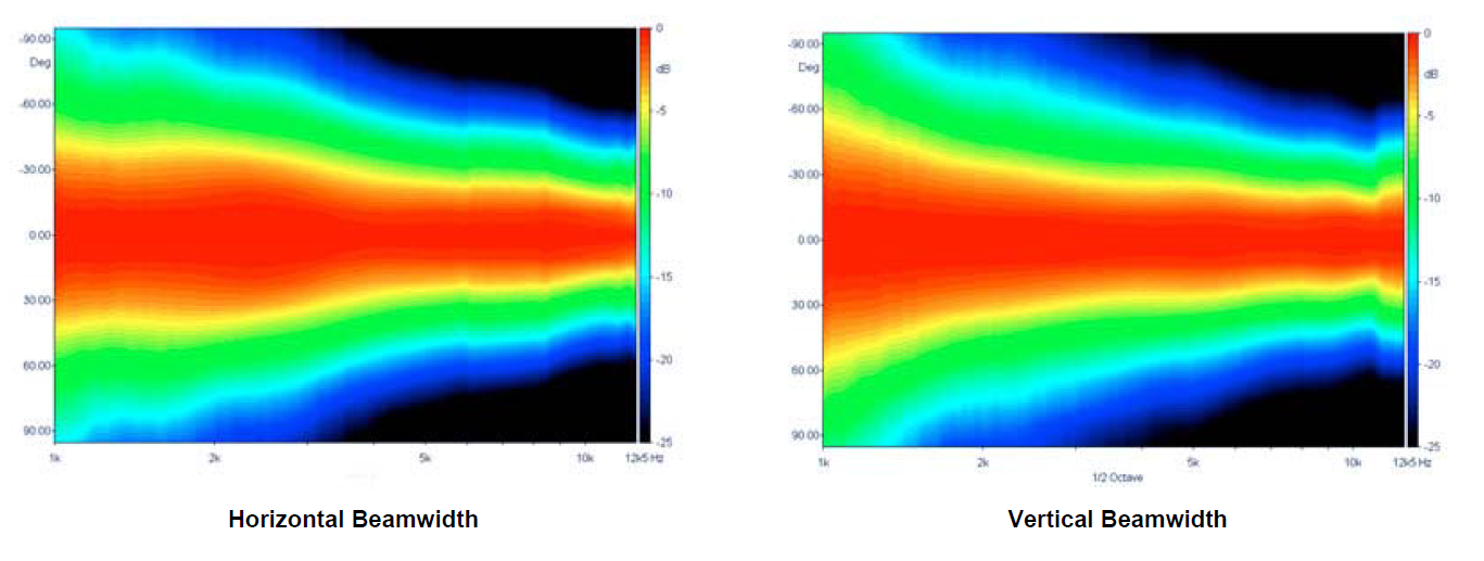

I think what you are describing about the LTH142 is consistent with its beamwidth map. It is after all, a tractrix. The 50 deg (25 deg half angle) specification if you go with the yellow contour where it is -5dB in the Vertical orientaion appears to be good for 3k and up, below which it widens.
Factory beamwidth map for LTH142:
xrk971,
Yes, consistent with tractrix (or similar) contours, the directivity increases with frequency, (less so above 3kHz, where it approximates the nominal pattern designation) and it appears that the upper beamwidth using the inherently "beamy" SB65 also is a bit reduced in comparison to the compression driver used for the spec sheet polar map.
I primarily used beaming horns for almost half my audio career, but after starting to use constant directivity horns, it is hard to go back to the "different in every seat" response of beaming horns.
That said, if you can sit in the center, (or where you have decided to EQ the response for) beaming presents no real problems.

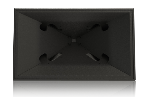

JBL VTX pro series have separate cabinets for low and mids and another cab forming a unity horn for mid/higs. I see their concept is a 3 way "standard" design but with adding horn.
The only I know with "similar" (not to much) concept is a design from Thomas Danley (I think he are in your country) and it was a novelty with very good reviews few years ago. He's horn unity / sinergy with 2 ways that can be seen in the link attached.
SH95 | Danley Sounds Labs | Danley Sound Labs, Inc.
All horns designs unity / synergy (at least that I know or have heard) has its bandpass holes drivers for mid / low at the entrance to the neck of the horn or so close the CD. I never saw a design that has the holes in the walls or so much closer to the mouth.
But again you can see he is using a 1" CD and a unity/sinergy typical design.
This is probably because the designers maninly try to keep intact all the radiant characteristics of the horn.
I see here that build have a so promissing re-think about all that and the observed results from your data shows are on rigth track to really improve much things with a building that people will speak much much time because his inovation and mainly his achieved performance and quality at highest level.
A near field monitor with FR driver and unity/synergy build ? 😱 ... yeah a real inovattion.
Time will give us all the answers...will see

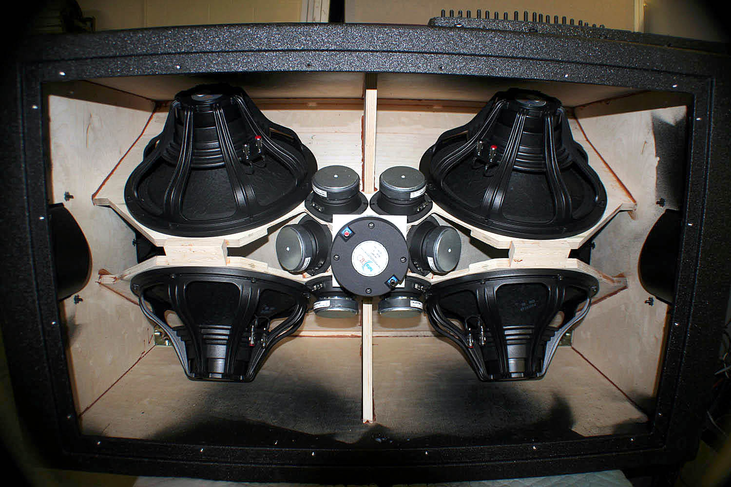

A 3 way Danley SH 96 as example
attachment.php
attachment.php
I think I see midrange ports close to the horn entrance, (slot) woofer holes further out and ported holes even further out towards the mouth.

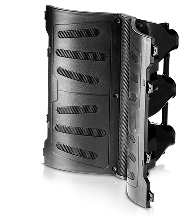

The JBL VTX uses what they all a Radiation Boundary Integrator (RBI) which has 6 mid/bass drivers (6in I think) mounted on the walls of a V-horn. Three D2 dual diaphragm coaxial compression drivers feed waveguides leading to the vertex of the V horn. The 6 mid bass drivers here also volume plugs on the cone side with 3 band pass slots per driver. This is what I was saying is similar in the concept of bass injection on the horn wall towards the periphery near the mouth. Although the VTX uses longitudinally disposed slots rather than round holes.

The JBL isn't a point source while Tom's products are usually designed to be just that.

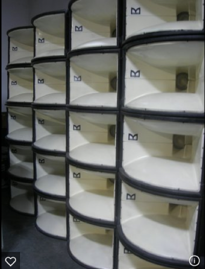

Martin introduced the concept back in 1978 with the "Philishave" offset 2x12" driver radial low mid horn, though the 12" entrance was large enough that it would not quite be considered a band pass. There have been a lotof variations on the theme since, sharing the horn with additional HF drivers.
It will be interesting to see the before and after horizontal and vertical polars after completion- remember to short the mid drivers (unless powered) out when conducting tests to avoid them acting as "tuned traps".

I don't see the band pass holes in the above photo.
The Martin MH-212 "Philishave" (with the grill on it looks like a Philips electric shaver) cabinet height is 18.25", 36" wide. You may have thought you are seeing the entire 12" cone in the picture, but only a portion of the house left cone is visible to the left of the "V" divider between the two throats.
As I mentioned, "the 12" entrance was large enough that it would not quite be considered a band pass", a 12" speaker behind an approximately 4.5" diameter entrance will band pass the response somewhat, as will the coupling between the two drivers and the horn throat, and the offset angle.
I stated the wrong date of introduction, it was 1976. First heard of them when Supertramp was touring the USA with a Martin/Midas system in '78.
The introduction of a dedicated low mid horn that was capable of clean, controlled directivity output to 1500 Hz was a radical departure from the norm back then of crossing HF compression drivers at 500-800 Hz, a 2-3 octave difference. The reduction in mid distortion was instantly apparent.

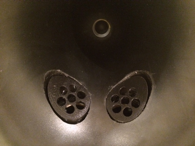

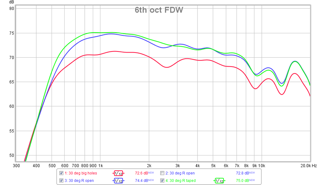

Band pass injection hole repair success
I ended up using hot melt glue to fill the gaps and bond the insert to the horn. I was also able to shape the hot glue as it cooled to a pretty smooth profile. I then put a layer of black electrical tape over the glue for the joint temporarily for smooth transition.
528427d1454257369-bookshelf-multi-way-point-source-horn-hole-repiar-success-photo.png

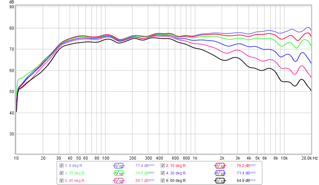

Measurements show that it was quite successful in boosting the output by about +2.5dB and smoothing it out - compared to taping over the holes to simulate a pristine horn.
I concentrated on the 30 deg measurement in detail to see this effect (red=big holes, blue=repaired, green=holes taped over):
528425d1454257077-bookshelf-multi-way-point-source-horn-sb65-lth142-eq-6thfdw-polar-vertical-big-holes-repair-compare-30deg.png
There is still a mild dip at 2.5kHz but the overall shape follows the pristine horn pretty well that I am satisfied with this performance. The taped over holes also has a bit more bass extension.
And here are polars with woofer running :
528426d1454257077-bookshelf-multi-way-point-source-horn-sb65-lth142-eq-6thfdw-polar-vertical-big-holes-repaired-10db-scale.png
