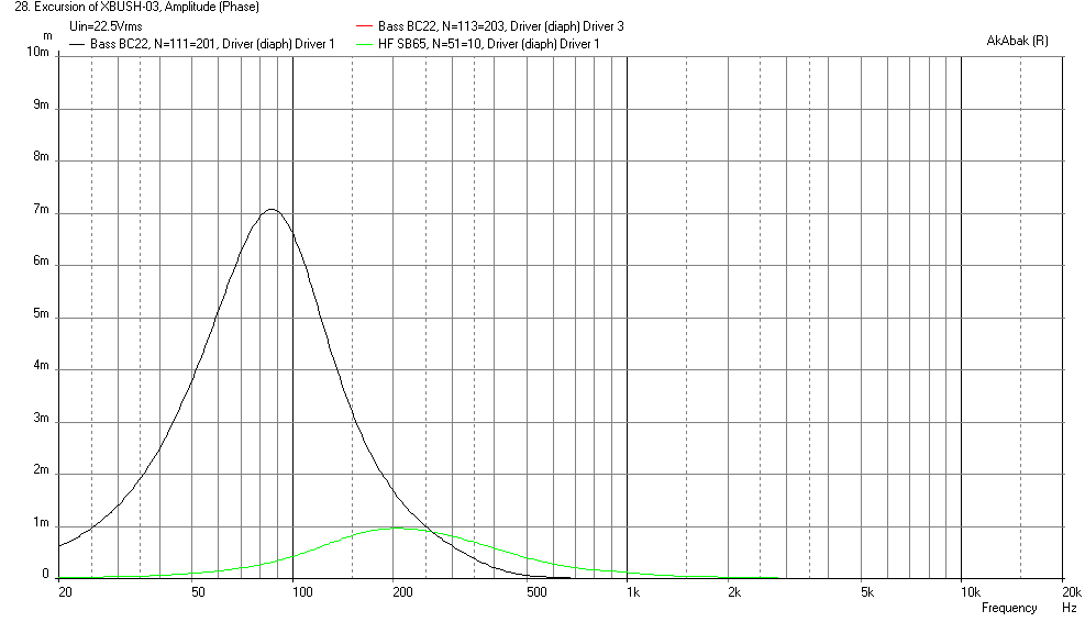

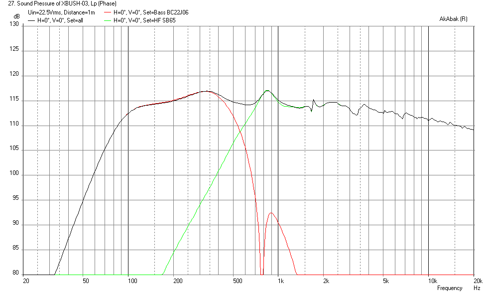

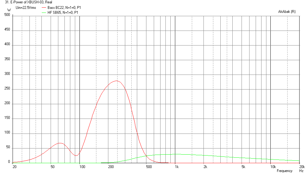

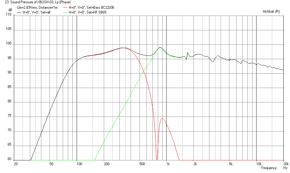

That's a nice driver - very sensitive. You can run them in series for 8ohm and about 91dB or in parallel if you have a 2ohm amp to get 96dB at 2.83v. They have an f3 of 90Hz with an 8 liter rear chamber ea. I have a 6.5in version of this woofer with the polymer basket and it works well. I could not find an xmax spec so assumed it is 7mm. You can getn 114dB output at 22.5v assuming 7mm xmax. Although at that voltage your are putting 280 watts into them and do so for more than a few seconds and magic smoke will come out 🙂
Sensitivity at 2.83v:
Displacement at 22.5v:
SPL at 22.5v:
Electrical Power at 22.5v:

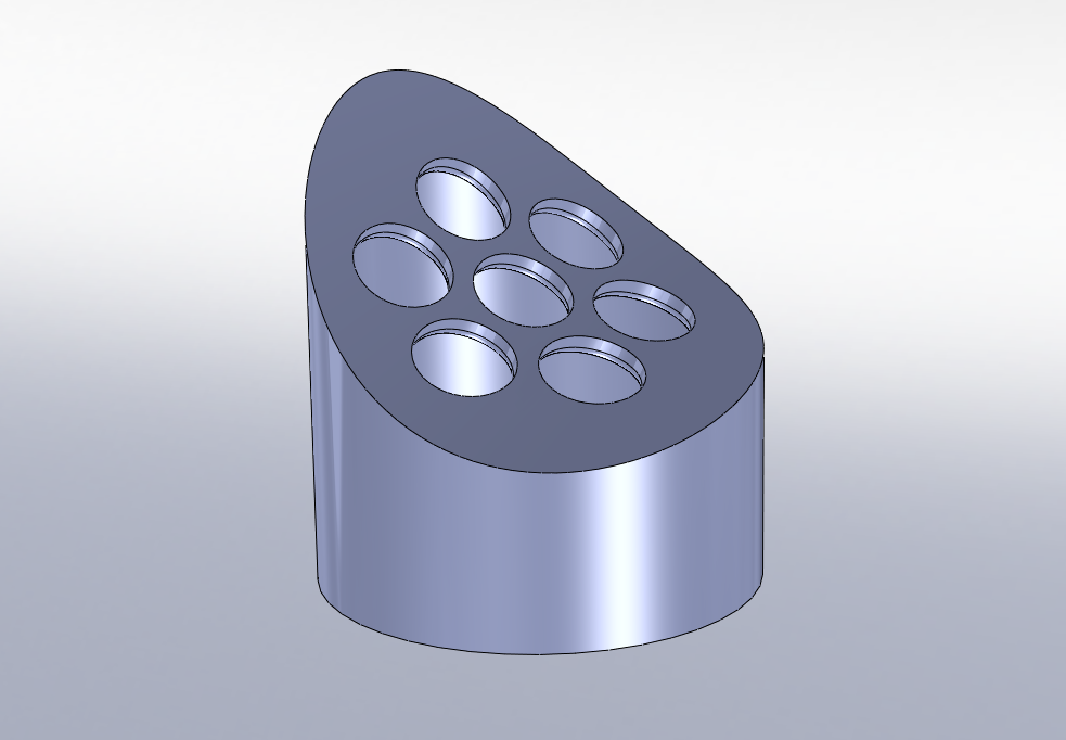

The six hole horn "repair" inserts are printing now. Hopefully they fit and match the horn profile - it was based on the curve on the outside of the horn.
Repair plug insert with six holes now printed. Due to left right symmetry there are two similar ones that had to be modeled and printed. They look pretty good but will have to await until evening before seeing how they fit.

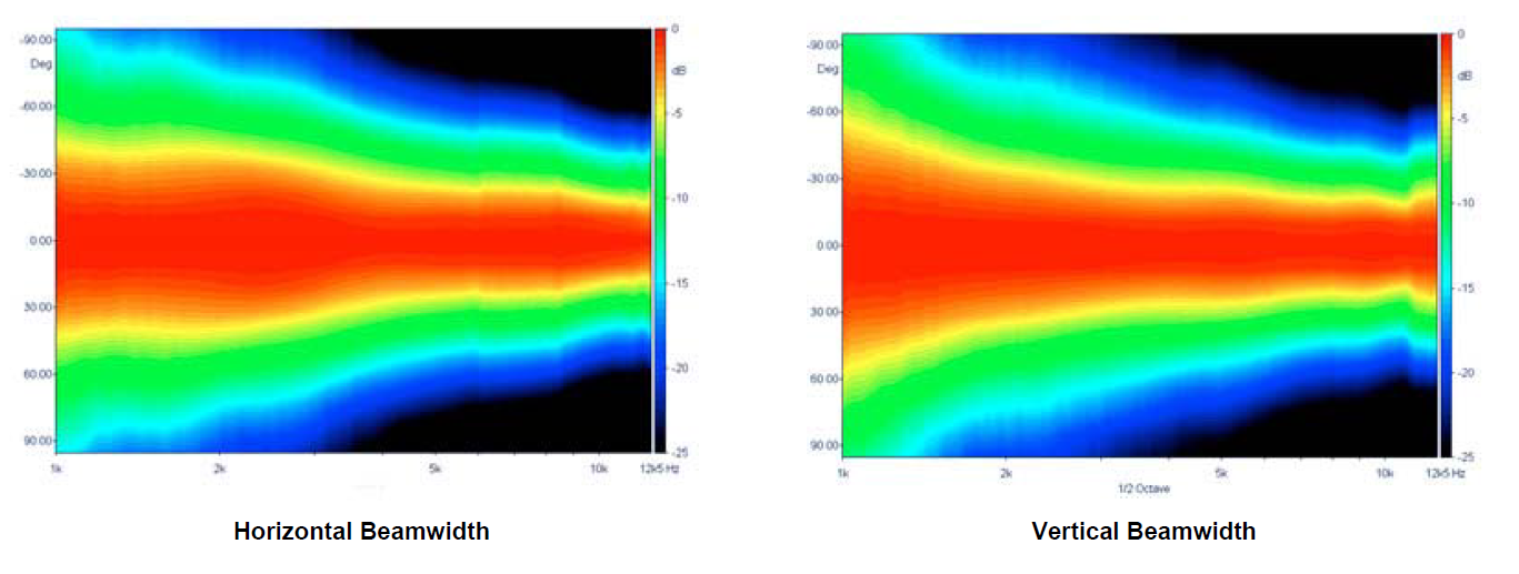

"Pattern control" is generally accepted to be the angle where the nominal dispersion of a horn is -6 dB.So pattern control is held to roughly 600hz which isn't too shabby for a relatively small horn.
In the case of the SB65 loaded 60 x 50 horn xrk971 is working with presently, in the 50 degree orientation, it is "loosing control" below 2000 Hz, and the pattern has expanded to over 120 degrees at 900 Hz, while contracting to about 30 degrees at 10kHz.
The collapsing pattern the horn exhibits is known as "beaming", similar to the piston response expected of a cone loudspeaker of a similar diameter.
Some people seem to like beaming speakers, others prefer constant directivity.
Constant directivity requires a larger horn dimension in the narrower dispersion direction.
A simple formula to roughly figure pattern control is 1,000,000/Horn angle x horn mouth width (in inches).
For a 15" wide horn with a nominal 60 degree pattern, that works out to 1111 Hz pattern control. For a 10" tall horn with a nominal 50 degree pattern, 2000 Hz.

I think what you are describing about the LTH142 is consistent with its beamwidth map. It is after all, a tractrix. The 50 deg (25 deg half angle) specification if you go with the yellow contour where it is -5dB in the Vertical orientaion appears to be good for 3k and up, below which it widens.
Factory beamwidth map for LTH142:
