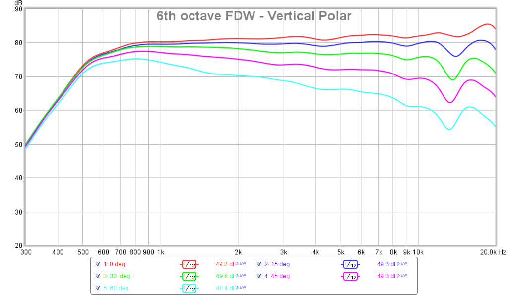

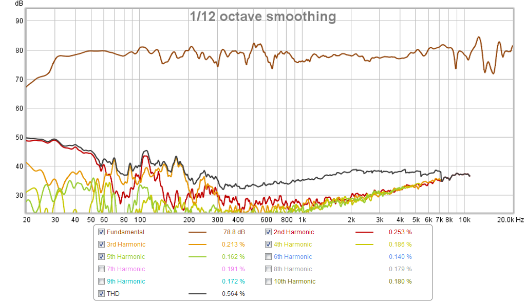

Mwasurements with the big holes

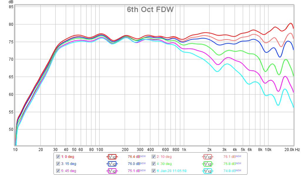

To refresh your memory, here is what the vertical orientation polars looked like before the holes were cut (0.5m distance):

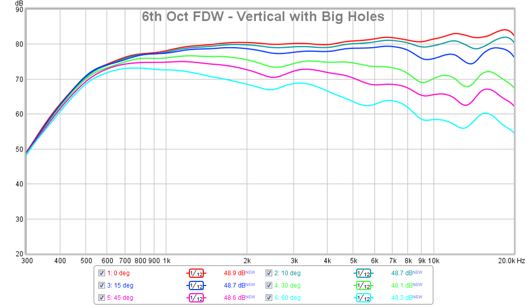

Here is after the holes were cut:
We can see that the big holes did some damage to the rather pristine polars at the larger angles - with a noticeable dip at 2.5kHz, and the lower frequency extension is not as deep. Although this horn is supposed to be 50deg in this orienation so for 30deg, it is not too bad.

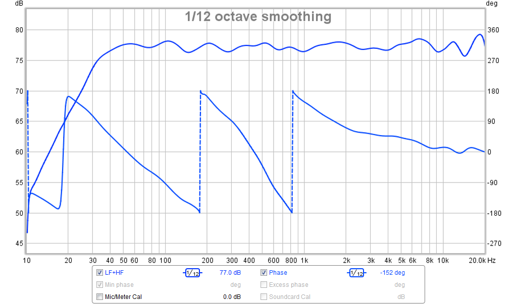

Out of curiosity, I wondered how the woofers would measure and sound with a heavy curtains draped on it. Surprising bass extension with this semi cardiod setup. This is at 10deg off axis and 0.5m away. Raw woofer response is shown in grey - the characteristic band pass overshoot peak is there and can be EQ'd out as shown in red curve which also has 5dB Q=0.8 bass low-shelf at 43Hz and 600Hz LR4 HPF. Combined with 600Hz LR4 HPF on the SB65, we get a pretty nice, albeit not transient perfect response:

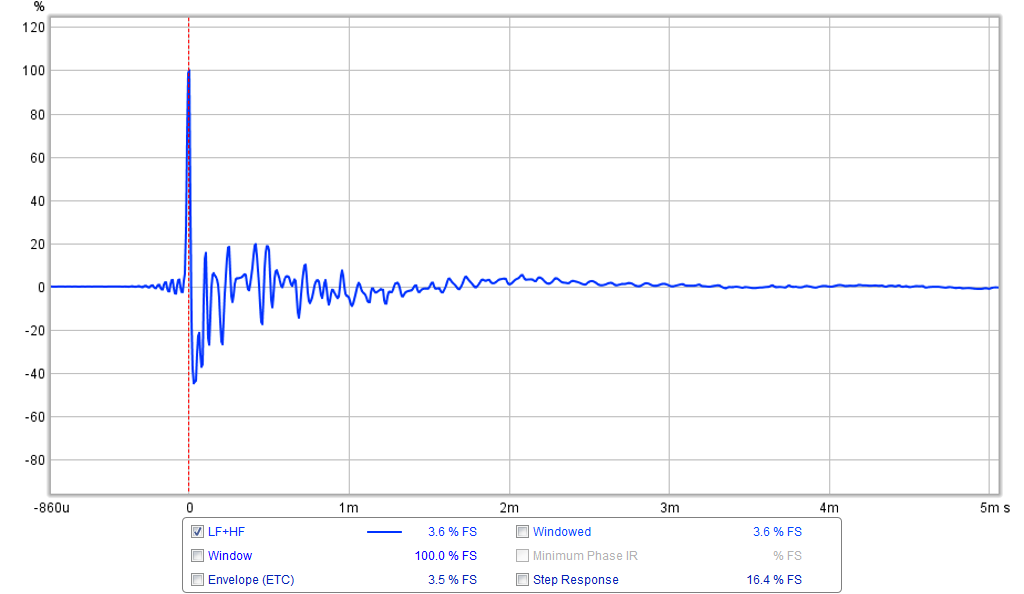

Here are corresponding IR:
Measured HD at this rather low SPL:

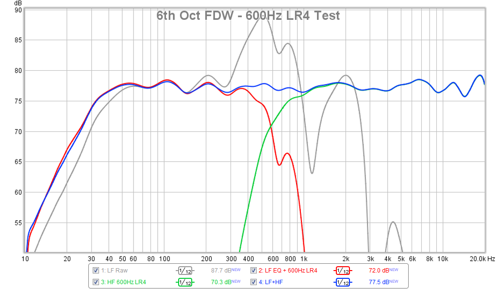

Here is measured phase typical of a 4th order Linkwitz Riley XO. The reverse polarity null (not shown) was exactly at 600Hz:
Here is corresponding polars with woofer playing:
Overall, not too bad with an f3 of 30Hz. Only had a chance to listen to a few songs, but what I hear sounds very nice. The issues with the polar plots are not readily apparent to my ears.
