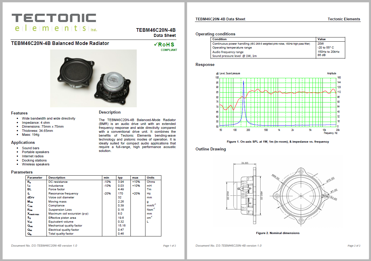

xrk971,
: ) if you still have TEBM46C20N-4B from camparison thread round 5, think would be worth a quick test on the other Faital waveguide, Xmax 4mm and Qts 0,46.

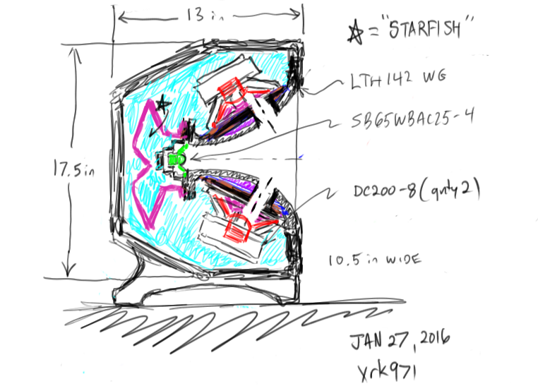

Current design for LTH142 Point Source Horn
Here is sort of what I am envisioning as the enclosure for the current LTH142 based WG horn.
I will provide details of the "Starfish" rear chamber for the SB65 in a later post. Basically a very low profile 5-point radial Dagger that will be 3d printed. I will use the sparse 20% solid fill as the damping material and see if that works.
Overall speaker will be 10.5in wide x 17.5in tall x 13in deep (not including short legs extending from side panels).
