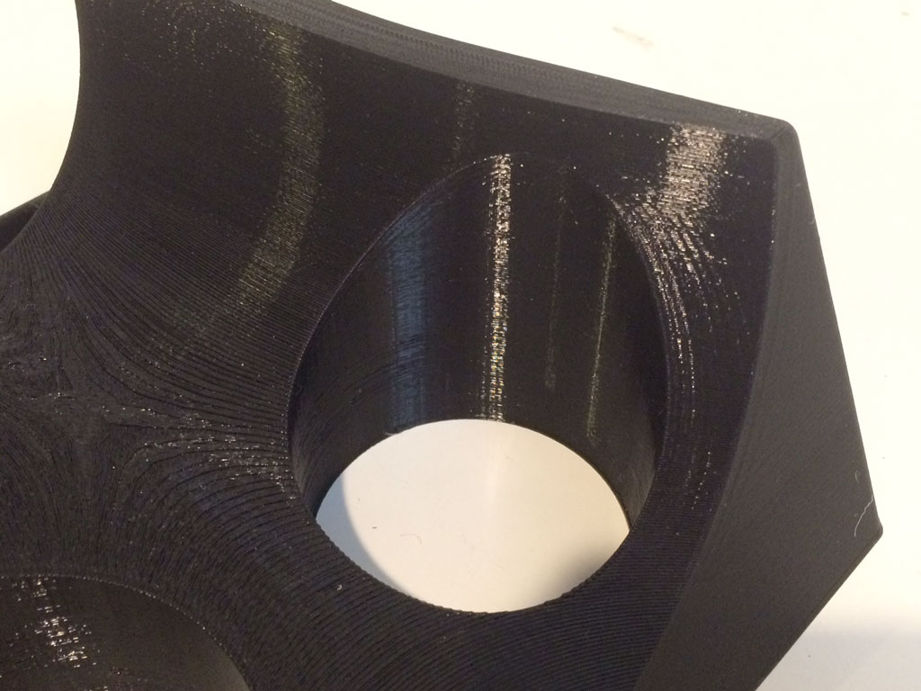

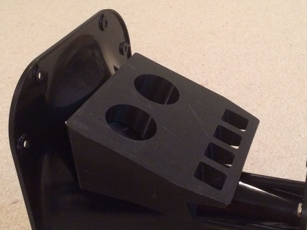

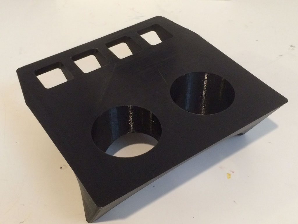

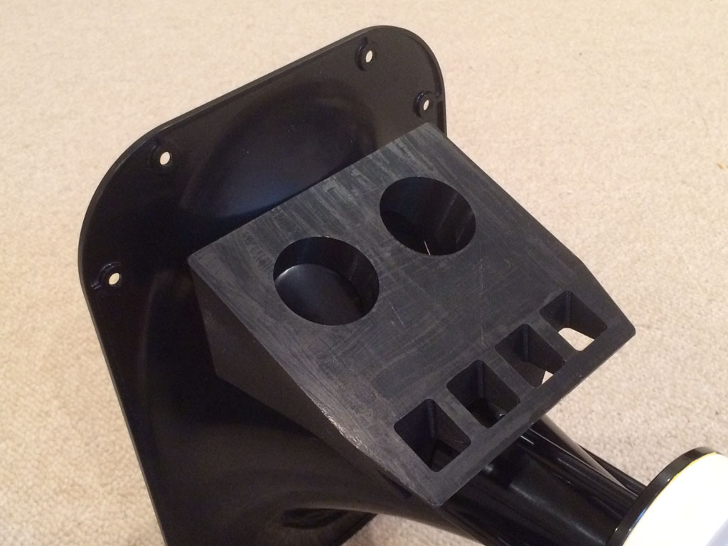

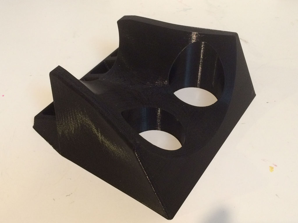

Woofer mount adapter success
These are photos of the part fresh off the printer with no post cleanup or sanding - as is. Looks great and very stiff and strong. Fit is excellent with maybe 1-2mm gap between horn wall and adapter that should fill up nicely with adhesive/caulking or glue.
I will use 0.5in plywood board mounted on top of the adapter, a standoff ring will be used to prevent surround bumping into plywood and a 3d printed conformal shape cone volume filler will be used to reduce chamber volume to push bandwidth up in HF.

I think I will go ahead and print as the fit looks excellent and it takes 11 hours (easy hours as I start it in the evening, go to bed and ready in the morning). I will make sure woofer fits and all that though with the first one. It's amazing what very small changes in the temperature profile and nozzle can do - it's like new and different printer. The PVA base coat is also a major improvement - I had a bit of a hard time removing part as it was bonded onto the glass pretty securely!

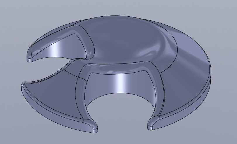

Woofer cone volume filler
Here is a 3d model of a conformal woofer cone volume filler for the DC200-8 fitted with the two 50mm ducts for the horn. It has a calculated volume reduction of 242 cc's - that is a significant reduction that will hopefully help to push the HF extension up a bit for a better XO slope. Again, paper and scissors to transfer profile.
The volume filler also extends the port length considerably, will be interesting to see what that does to the response.
I just ran the sims, the average port length including 3d adapter, 3d volume filler, and 11/32 plywood is about 60mm vs 12mm assumed before. I will suffer a -1.3dB hit to sensitivity but the bass extension (f3) goes from 89Hz to 82Hz, assuming an 11 liter common rear chamber. I think this is not too bad a hit. Upper frequency extension is usable up to 730Hz.

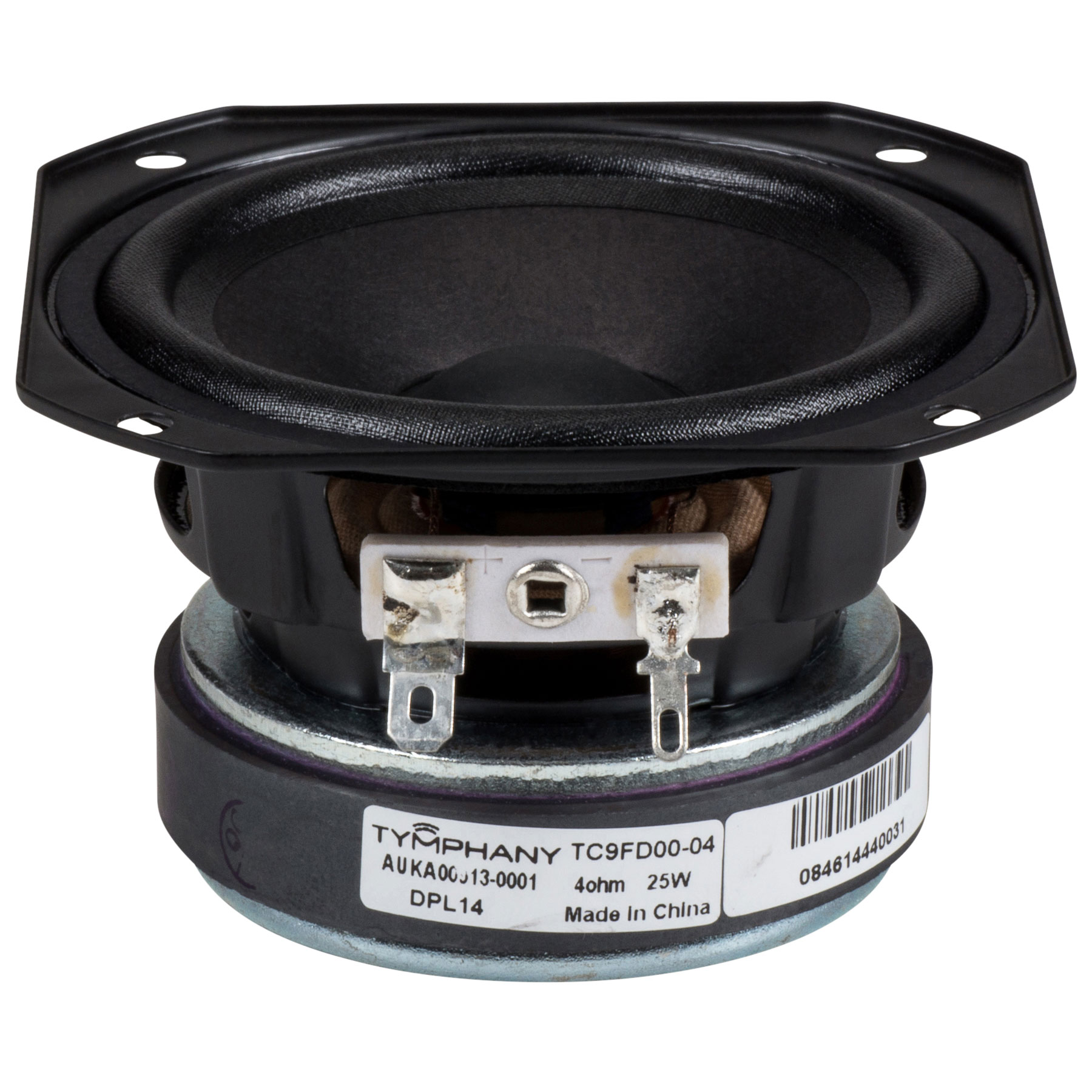

I have on order some of the all-purpose Tymphany TC9FD00-04. Will these really go down to 250 Hz? Won't even need to make a Synergy then 🙂

Soldermizer, you might want to re-think that order...
Your proposed TC9 FD00-04 (x-max 1.6 mm):
attachment.php
The multi purpose TC9 FD18-08 (x-max 2.55 mm):
attachment.php
I'd pick the FD18-08, actually I did....

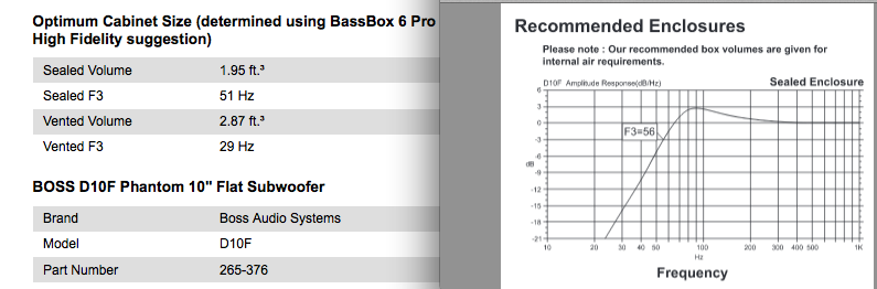

I have so much volume inside the box and the DC200's only need 11 liters. I just ordered a cheap but well regarded 94dB Boss D10F Phantom driver designed for sealed enclosures in a car. Supposedly all it needs is 0.5cu ft to reach 50Hz. I probanly have close to 1cu ft. Could mount it on bottom to save baffle real estate like my original design. It would make a nice 3 way.
.5 cube results in a +3dB bump at 90 Hz and a F3 of 56 Hz according to the ownersmanual. According to Bass box Pro, needs almost 2 cubic feet for a 51 Hz F3.

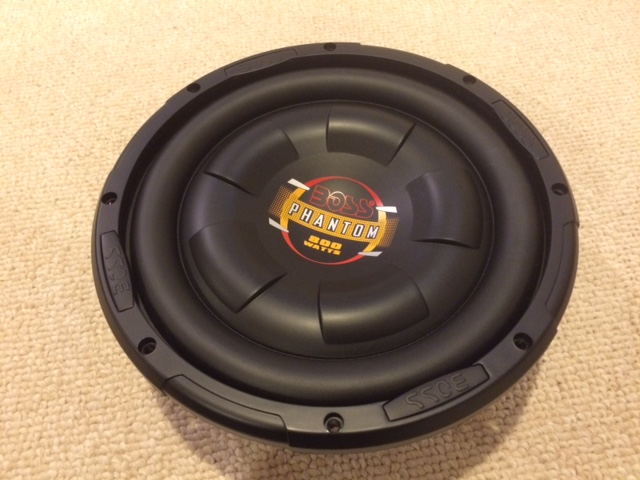

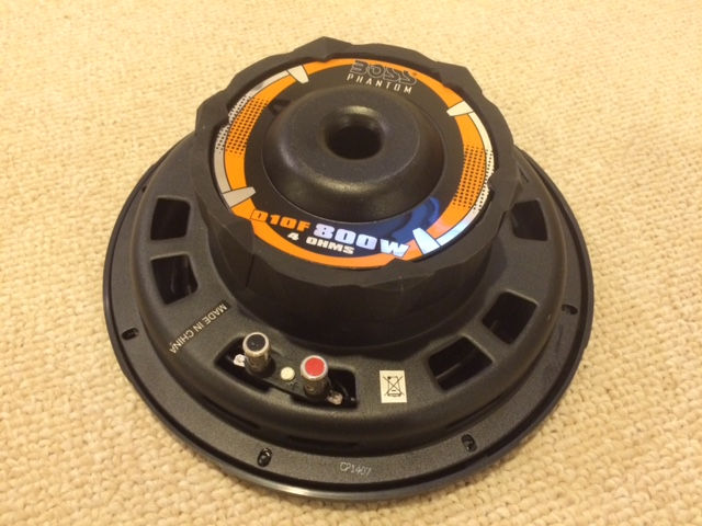

The D10F just arrived - an impressive driver for $36 - well built. This sub has one of the stiffest suspensions I have ever felt. Maybe that and a fat magnet is how they get 94dB sensitivity? It's got an alloy frame, a huge half-roll surround, nickel plated spring loaded terminals, and a very low profile at 3in deep. Ugly graphics on cone but if I aim it at the bottom, no harm done.
Will put it through DATS for some real TS parameters and maybe an OB to see how high up it can go. might be a good FAST driver in general.
