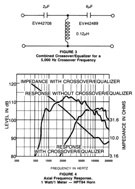

It sounds terrible without DSP EQ - I suppose one could try to apply all that EQ passively and it is possible as you have shown that a simple 6uF capacitor HPF flattened the response of the Trynergy. It may be worth a trying a hybrid where a simple cap is used to take care of the predominant HF falloff and flatten the response, but then if you have DSP why bother because the cap adds a reactive system to the amp trying to drive it?
With "normal" passive crossovers (even with a high frequency bypass capacitor) the sensitivity of the system is limited to the high frequency response sensitivity, which in the case of the full range driver on a horn with dispersion wider than the raw driver response will be a bit less than the raw response.
By using a circuit similar to the one shown below, the falling response can be flattened, and 5-6 dB of boost can be achieved. This does lower the impedance at the HF boost frequency, the nominal 8 ohm EV DH3 driver drops to 5 ohms, same as it's DC resistance.
A similar high frequency circuit for the 4 ohm nominal SB8 would probably result in a 3.6 ohm high frequency minimum impedance, but could bring the HF sensitivity up to around 85 dB 1 watt one meter, and flatten the response of the driver on the horn.
Art
Art

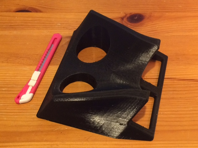

Horn wall woofer mount adapter printed. It actually looks pretty good and is quite sturdy. However, there are a few issues with print quality on one of the layers that is causing delamination (on layer 10 or 2mm from the flat face on the bottom). I think the nozzle got clogged on one layer and as a result extruded insufficient filament to bond. I will try to repair by gluing the partial delamination, and if not successful, this was a teaching exercise to refine and improve the next one. This is the nature of 3d printing large objects with filament. It's iterative and there are so many variable like nozzle temp, bed temp, fan speed, movement speed, etc. And these parameters depend on the size of the job and the color of the filament and I just switched from white to black.

X, sounds like you have your hands full. To be honest I would rather play with epoxy and routers, as I know nothing about 3d printing!

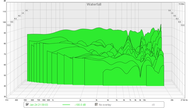

Yes, the difference in phase immediately caught my eye too. Would love to see another early waterfall with the same settings as before. Just to see if there is indeed a change.

Yes very interesting linear phase as was XO a BW1 or B&O hole filler that both sum perfect when ctc distance is zero as in electric domain, that said phase was very flat but system couldn't run from had the Harsch signature when looking SR/Sq-waves in it was clear woofer fired too early as a kind of slew rate trouble.
bushmeister don't expect so but if anything look weird in group delay when plot zoomed into for the flat phase example would be interesting see it posted, and also if you have LP and HP acoustic slopes saved and would like to share, then like to have fun with them if timing is included "Export" "Impulse Reaponse as WAV".
