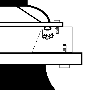

For 10F/TC9 surround starts/glued on cone at diameter 58mm and inner of surround vault start at 62mm. Think about something ala below dirty drawing, don't take dimensions relationship too serious, machined in black nylon or mayby brass on a lathe.

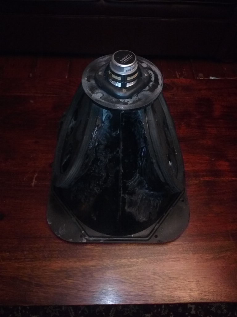

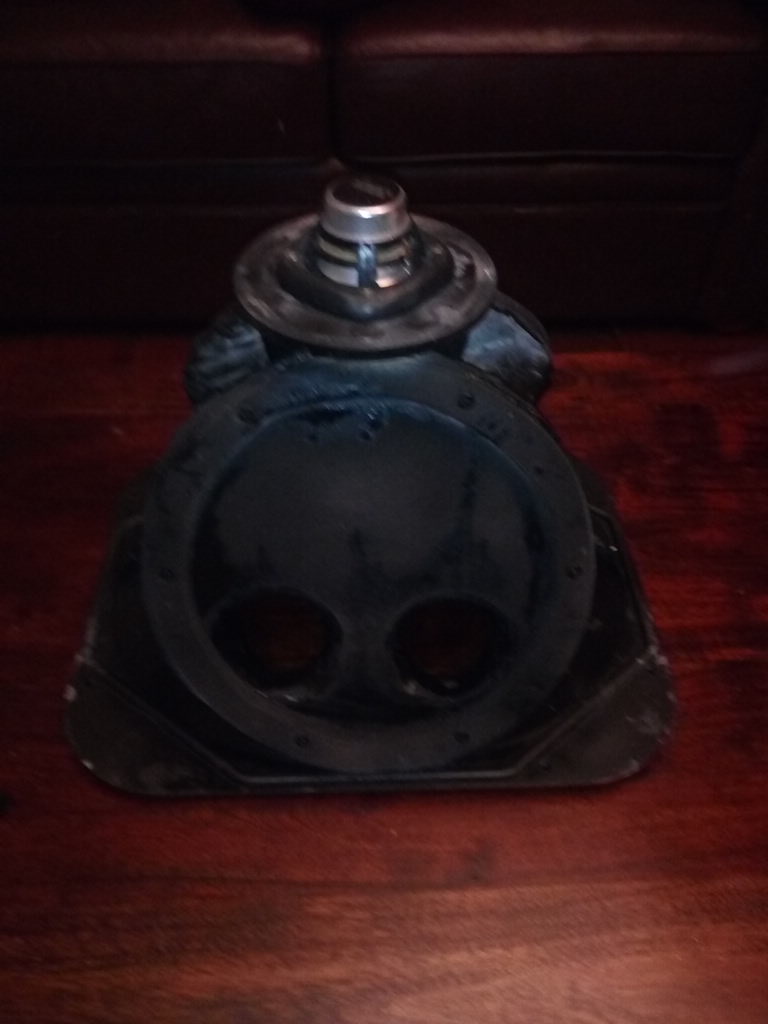

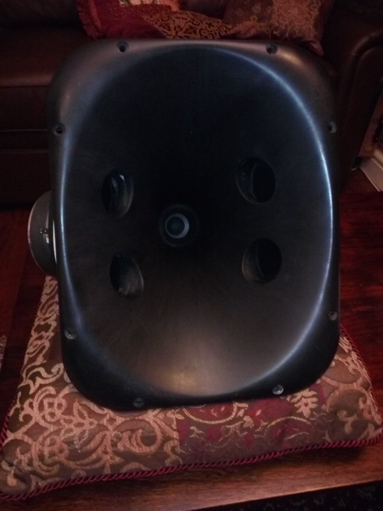

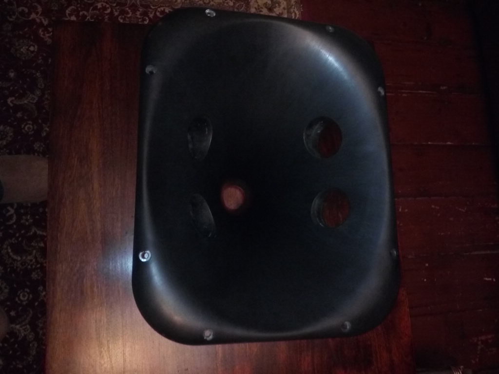

The PH2380 is a (rough) copy of the JBL 2380, which has excellent horizontal polar response, because it uses a pinched (diffraction) throat, which allows a 2" exit compression driver to have the same width profile as a 1" compression driver, which would not require the "squeeze". The treatment of the "pinch" can either be rough corners as in the PH2380, or smoothed as in the horn Bushmeister is using, which because it is not shooting for wide dispersion out to 16,000 Hz, (as the 2380 is) and starting at 1.4" rather than 2", requires less reduction, and therefore less adverse diffraction results.
Compression drivers use a phase plug to reduce the diaphragm size to a smaller exit dimension, the path length in each slit to the exit is (should be) the same, theoretically resulting in a plane wave of the exit dimension, which will theoretically expand according to the horn contour. The JBL 2380 polars prove the diffraction throat to be very effective in providing even polars using a 4" diaphragm 2" exit compression driver.
Cone drivers of the type considered in this thread do not have the magnetic strength capable of useful high end response when driving through a phase plug, so are "stuck" with the dispersion problems the width of the piston diameter imposes.
A careful match of cone diameter to throat diameter is needed to avoid transitional "pockets", but the larger the cone diameter, the lower in frequency the path length differences from the various points on the cone and relationships reflecting (rather than conforming to) the side wall are.
Therefore, although the larger 2" entrance will work OK with a driver the diameter of the TC9, without a phase plug, the path length differences on a wide dispersion, narrow throat will result in wide, but erratic polar response.Using two "full range drivers" on narrow horns, rather than one on a wide horn equaling the coverage angle will result in better better polar response, and also a bit of horn gain up high- the wide response horns actually reduce on axis sensitivity compared to the full range driver's rising on axis sensitivity.

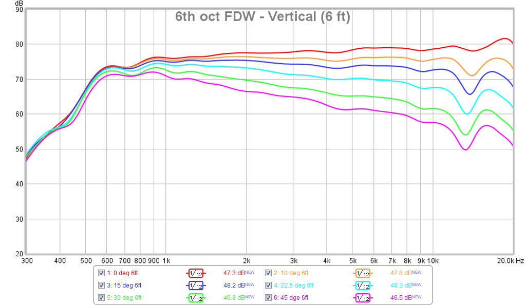

Vertical polar at 6ft LP
I repeated the polar with 90 deg rotated horn (vertical orientation) at the listening position of 6ft. Looks pretty good still. I can live with the narrow directivity - these would be monitors so I don't expect to walk around - mostly stationary listening position so 30 deg full angle seems OK.
note the 0 deg is "hot" because when I EQ'd the system it was based on 10deg offset to avoid on axis hot peaks. 10 deg is flat as expected. I will probably have to XO at 600Hz though.

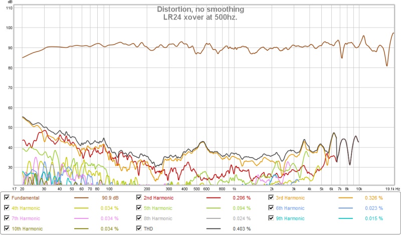

6) The small "full range" drivers we are considering have more than 5 times the Xmax of a HF compression driver, so have less distortion than they have. The downside is less sensitivity, and little to no HF horn gain, which means that flat response can not be achieved passively at any more sensitivity than the "full range" native front loaded response.
7) At lower crossover points (500 Hz) the full range driver has way less distortion than a 1.75" diaphragm compression driver. Compression drivers crossed high enough don't have enough distortion to worry about in domestic situations.

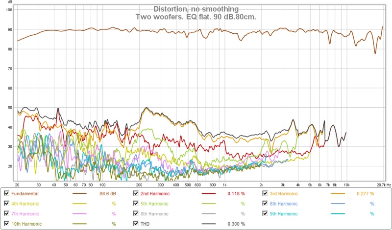

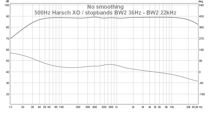

The crazy thing is, all the epoxy, MDF, plywood, etc has made the horn incredibly inert.
I think this is quite impressive. No sub. Just the two woofers:
With measurements like this, who needs a box? I guess it helps your max SPL.
That is very clean, apart from the hump at 200-500Hz. You may want to check to make sure the SB65 surround is not rubbing on the gasket foam - I noticed a hump like that on mine when it was rubbing.

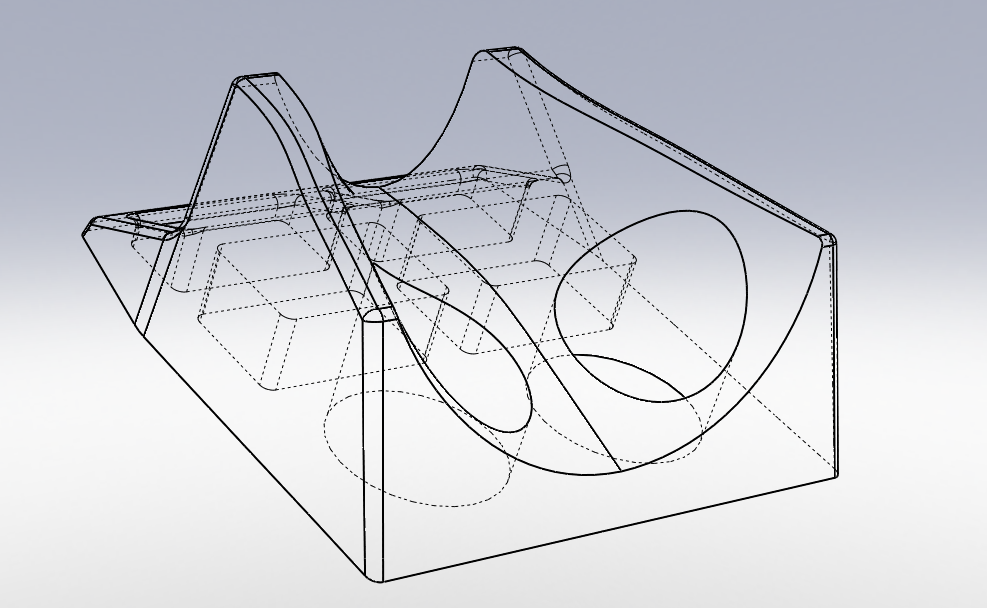

Would it not be easier to model as a solid and let you slicer work out 15-30% infill automatically. Bridgeing won't be pretty in your voids and slicer might create support anyway. 5 wall + top and bottom should be very rigid.

Those pockets and cutouts are saving almost 2 hrs on the job. Maybe not worth the hassle though. I am using 20% infill and 3 layers, supports are being made for the two rectangular pockets. My main problem is getting good adhesion for the first support layer to the glass when it lays down the thinner supports. By the 2nd layer I could see that the supports were not sticking so I tried brushing on 50:50 PVA/water solution onto the glass where supports go and once dry, now the PLA sticks quite well there. I am going to coat the whole glass with this next time.

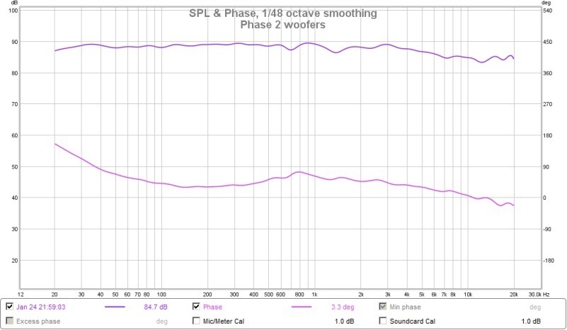

Brytt- I noticed that too. I might be able to optomize the xover more, as I just kept the same settings as for a single woofer.

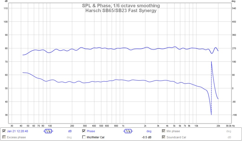

I wonder if the original flat phase had something to do with loading the horn only on one size with a single woofer?

Print job so far so good. 9 more hours to go.
X, sounds like you have your hands full. To be honest I would rather play with epoxy and routers, as I know nothing about 3d printing!
Yes, the difference in phase immediately caught my eye too. Would love to see another early waterfall with the same settings as before. Just to see if there is indeed a change.
