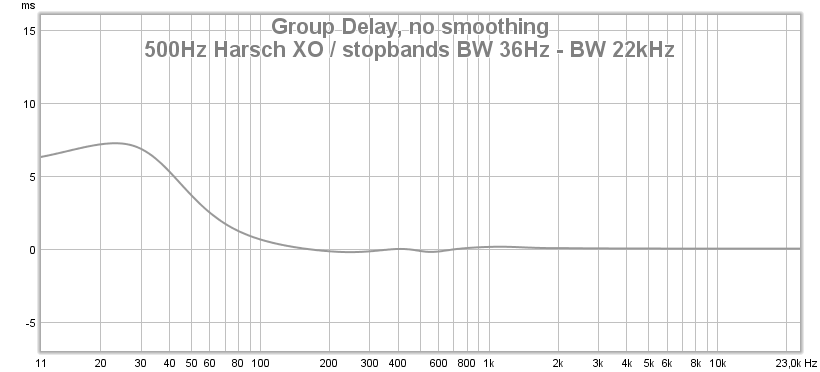

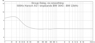

Yes very interesting linear phase as was XO a BW1 or B&O hole filler that both sum perfect when ctc distance is zero as in electric domain, that said phase was very flat but system couldn't run from had the Harsch signature when looking SR/Sq-waves in it was clear woofer fired too early as a kind of slew rate trouble.

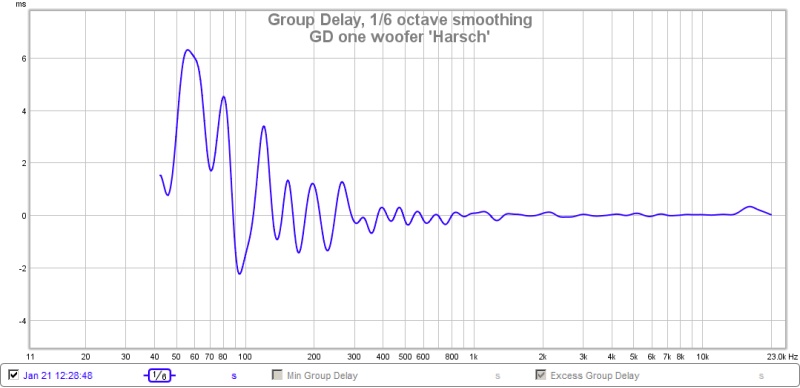

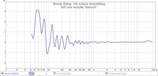

bushmeister don't expect so but if anything look weird in group delay when plot zoomed into for the flat phase example would be interesting see it posted, and also if you have LP and HP acoustic slopes saved and would like to share, then like to have fun with them if timing is included "Export" "Impulse Reaponse as WAV".
Here you go Byrtt:

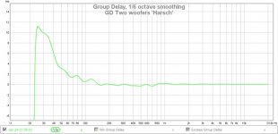

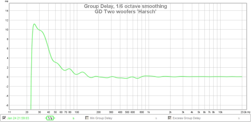

Here you go....
Most of it is the full range top of coarse. 25 drivers help to get a nice clean ridge in those early plots. So I wanted to see if there is a change using 2 woofers.

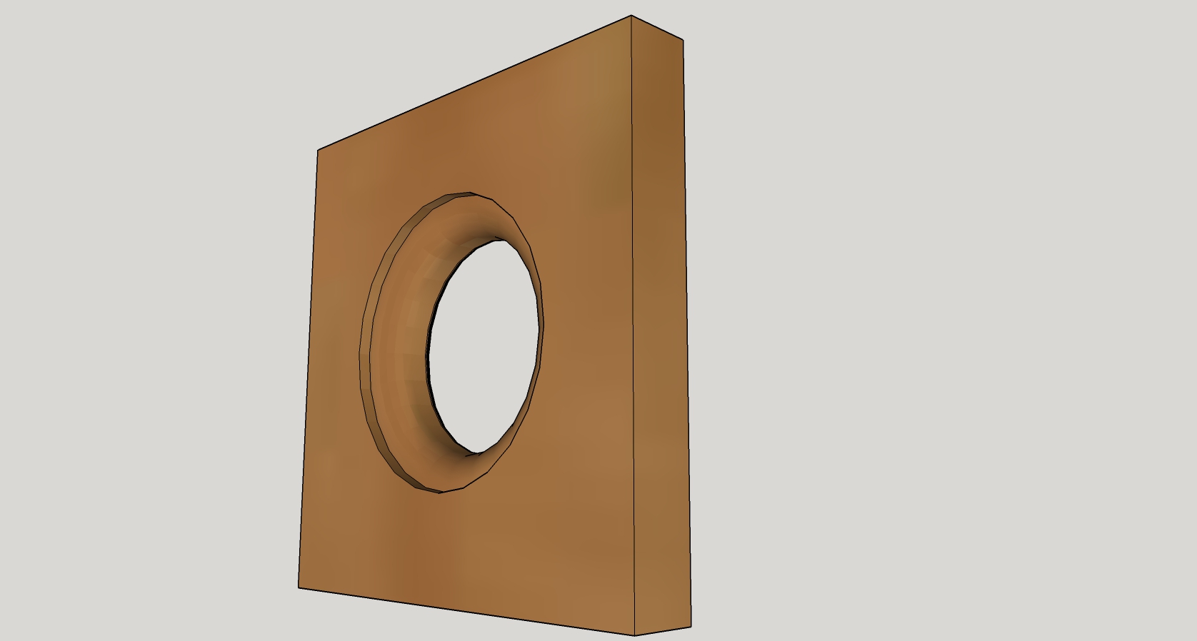

Unfortunately, the woofer mount adapter could not be salvaged. I will have to print a new one but will improve the design a bit and adjust the print settings, hopefully for a better print this time around. Most problems can be caught within the first 3 to 10 layers so I will have to pay better attention.

Thanks group delay plots the one running one leg only is some special with ripple that at five frq points is faster than tweeter or even faster than real time, had not thought of wrapped in some blankets create FIR EQ 🙂.
New dual woofer looks good and close to pure electric filter textbook as below.

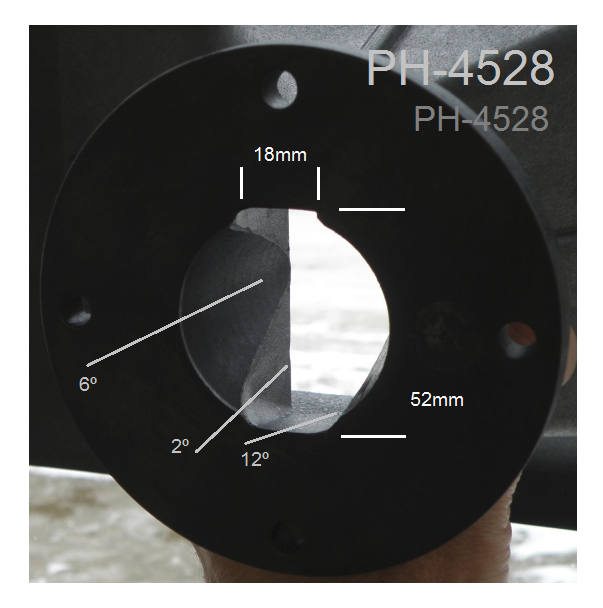

Initial angles PH-4528 below.

The new printer settings are working out much better. I have never seen such a high quality first layer before - difference is night and day. I have higher hopes that this one will work. For those interested in printing with PLA on heated glass bed, use 50:50 PVA/water mixture brushed onto glass at 50C. Then heat bed to 68C and nozzle to 225C, print first layer at 40% speed, no fan. Then slowly cool bed to 55C over 5 layers. I still have to see if this doesn't warp but no cooling fan may be the key here.

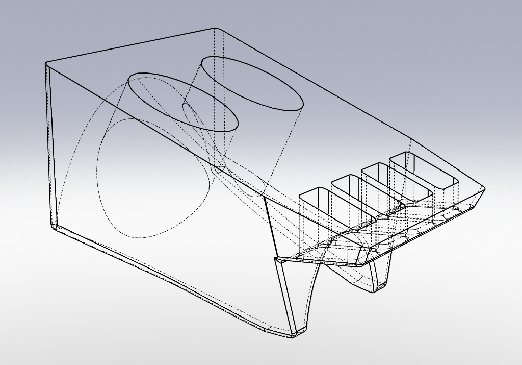

Good news so far, 146 minutes left but the print quality has far exceeded my expectations. This is the best print quality I have ever achieved thus far at any size. Absolutely no warping or peeling, surface quality is smoother with no blemishes or 'zits', feature quality is fine and precise. Absolutely beautiful. I have no fear of overnight 'Big Prints' anymore. 😀
Can't wait to fit it to horn. Wondering what is best way to cut horn wall - maybe use adapter to provide outline then cut with Dremel or even jigsaw? The horn is thin ABS and cuts easily.
For a box, I may break down and gave to get ply as well. The 1in thick XPS foam is too bulky and not befitting of a "bookshelf" speaker. Trying to keep it at a little above 9.5in maybe 10in wide baffle, height will be a little more than horn width dimension to accommodate woofers so maybe 18in?

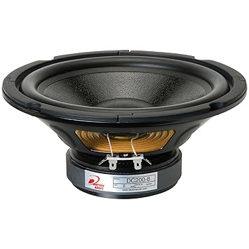

Byrtt,
Those Monacors are nice at 90dB! Should work well. In look, they sort of resemble the DC200's I plan on using except polycone vs paper cone?:
Monacor SPH-210:
DC200-8:

X are the ports not to long, looks nice.
They are a bit longer than I anticipated - although I recall the model was not very sensitive to this - it actually pushes the bass extension lower. I will make a volume filler plug that matches the cone profile to reduce the volume of the band pass chamber to push the HF extension higher.
I guess I should run a sim with the new port lengths to make sure it is all good.
