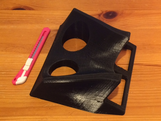

Horn wall woofer mount adapter printed. It actually looks pretty good and is quite sturdy. However, there are a few issues with print quality on one of the layers that is causing delamination (on layer 10 or 2mm from the flat face on the bottom). I think the nozzle got clogged on one layer and as a result extruded insufficient filament to bond. I will try to repair by gluing the partial delamination, and if not successful, this was a teaching exercise to refine and improve the next one. This is the nature of 3d printing large objects with filament. It's iterative and there are so many variable like nozzle temp, bed temp, fan speed, movement speed, etc. And these parameters depend on the size of the job and the color of the filament and I just switched from white to black.

X, sounds like you have your hands full. To be honest I would rather play with epoxy and routers, as I know nothing about 3d printing!
