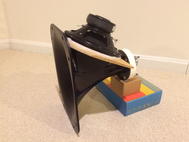

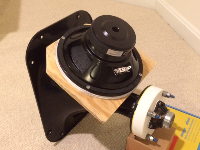

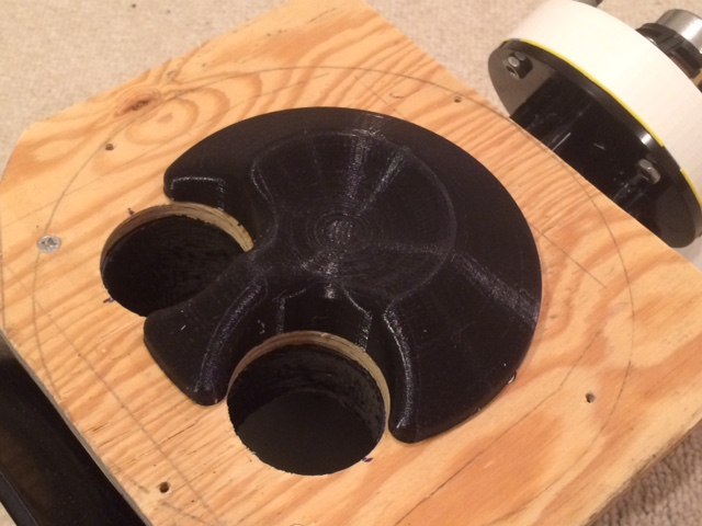

Woofer 1 installed on LTH142

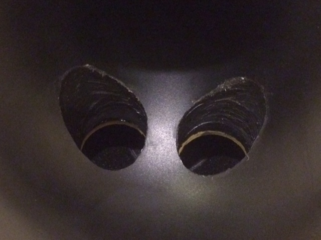

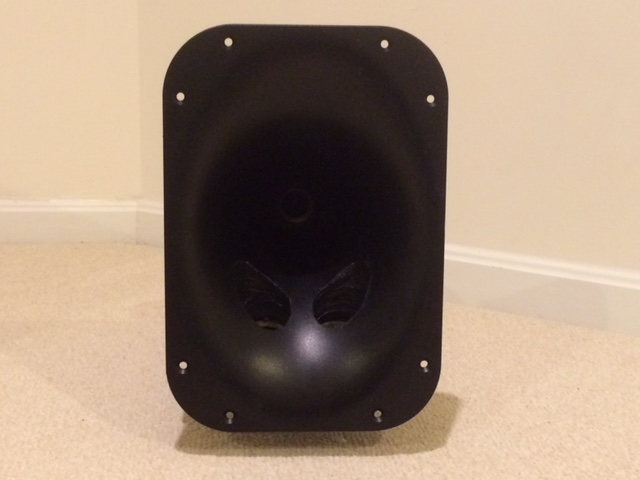

Here is one of the DC200-8's installed on the LTH142 waveguide. The 2in hole saw drilling from the driver board intersects with a much larger cross sectional area on the horn wall. A very large hole is on the horn and I hope this doesn't mess with the polar response. Perhaps I should have drilled perpendicular to the horn wall to minimize the hole and have that intersect with the port from the driver?
One thing is clear is that the woofer when mounted this way is very low profile - it only adds 1in the overall height of the waveguide when viewed from the front. This makes for a very compact speaker considering there are two 8in woofers. In a conventional direct radiator, 2 x 8in woofers would add 16in in height to the baffle. Here we will have a 17in tall baffle that has the waveguide and woofers.
Woofer on top:
Front view with woofer on the bottom:
Closeup of the bass injection holes on the horn wall:

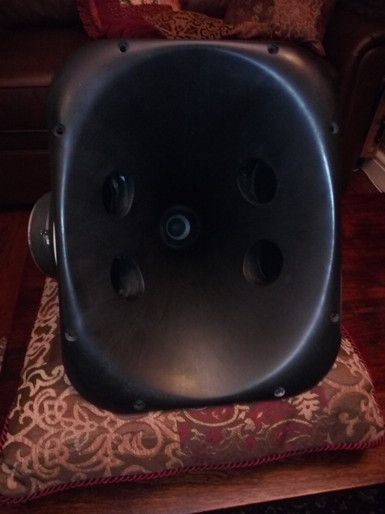

X, those holes do look pretty big compared to bushmeister's horn...
Hoping it won't make that much of a difference in smoothness of the HF...
It's the fact that I have my holes on the small end and my tractrix profile appears to expand at a rather large angle there that the cosine(theta) effect is bigger. I may be able to repair it by patching in a piece of plastic to cover up the extra wide portion of the hole. On the other side I will drill in perpendicularly to keep hole small.
But first lets measure the polars and see the "damage done".

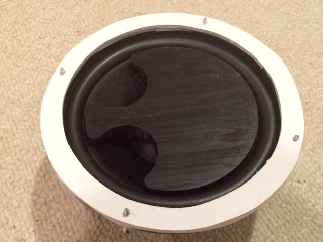

Woofer cone volume filler
Here is the custom volume filler plug for the DC200-8. I left as much clearance as the two foam core gaskets used to prevent surround bumping. But I fear the cone moves more than the surround extends out as manually pushing on the cone I can feel that it bottoms out - may have to either print a thinner one or add one more foam core gasket. Alhough, the bottoming out may just be misalignment between the plug and the driver axis. The print turned out really nice though.
527784d1453987194-bookshelf-multi-way-point-source-horn-woofer-mount-05-volume-filler1.png
527785d1453987194-bookshelf-multi-way-point-source-horn-woofer-mount-05-volume-filler2.png
Speaking of 3d printing, I just realized that I actually have the digitized contour of the horn at the location where holes are too big (well, apart from a small offset as I have the digitized exterior contour). I could just print a plug with a wall and injection hole of my liking and repair the hole. I could even give the hole a custom shape.

As the surround is held in place at one side I'd say the cone would indeed move more than the surround. The print looks great though. You can always make a new one with less height if it doesn't work out. Too bad about not cutting the holes perpendicular.
I guess lesson learned and good of you to show it for others yet to come aboard and try for themselves.
