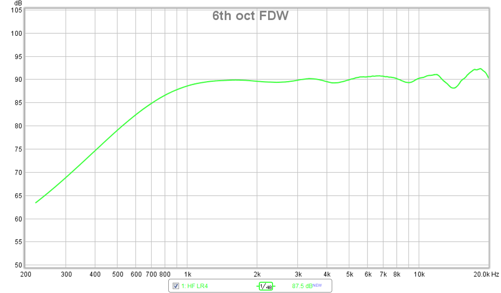

It's not bad and the EQ based on 1/6th FDW was what was used to base the EQ on and it turned out nicely I think.

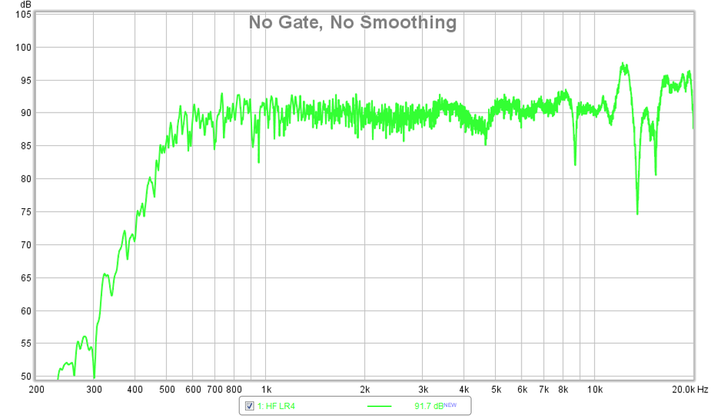

X, what does it look like gated before the first reflection and not smoothed at all?
And another way of viewing/plotting the FR, no gate and ERB smoothing, as that is said to follow the way we listen/hear.

Just an afterthought: when I EQ-ed my lines the FDW wasn't even implemented in REW yet. But now that it is it makes it way more easy than what I had to go trough to find the same answers.
I used to EQ with the 4ms gated response as well as ungated response. Having now tried the 1/6th oct FDW to base my EQ on - I have to say this way provides a more accurate and robust EQ that is good for a wider range of polar angles. I think the FDW method helps to prevent over-correction of stuff that shouldn't be corrected.
I will get that data when I get back to my computer. Probably the same except for smoothing?
It would be interesting to compare the fdw to the fixed gate with and without smoothing. If I think about it when I get home I'll do so with my data.

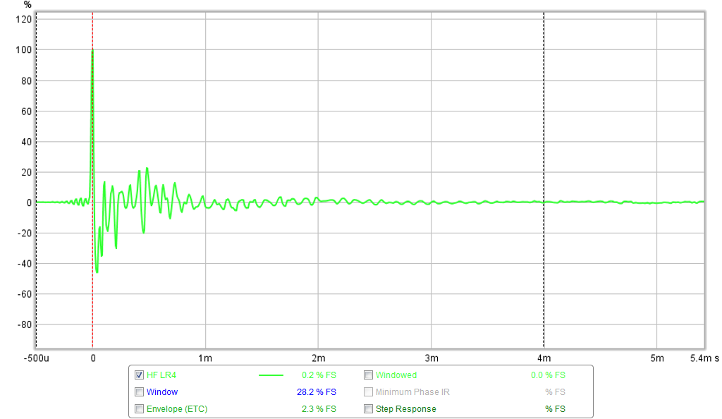

Here is the IR to show that there is no reflection before 4ms:
Here is the data with no gating, no smoothing:
With 4ms gate and no smoothing:
With 4ms gate and 1/12th octave smoothing:

With 6th octave FDW:
