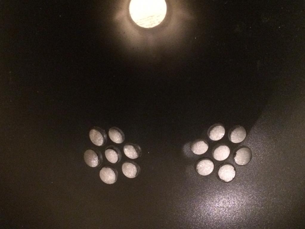

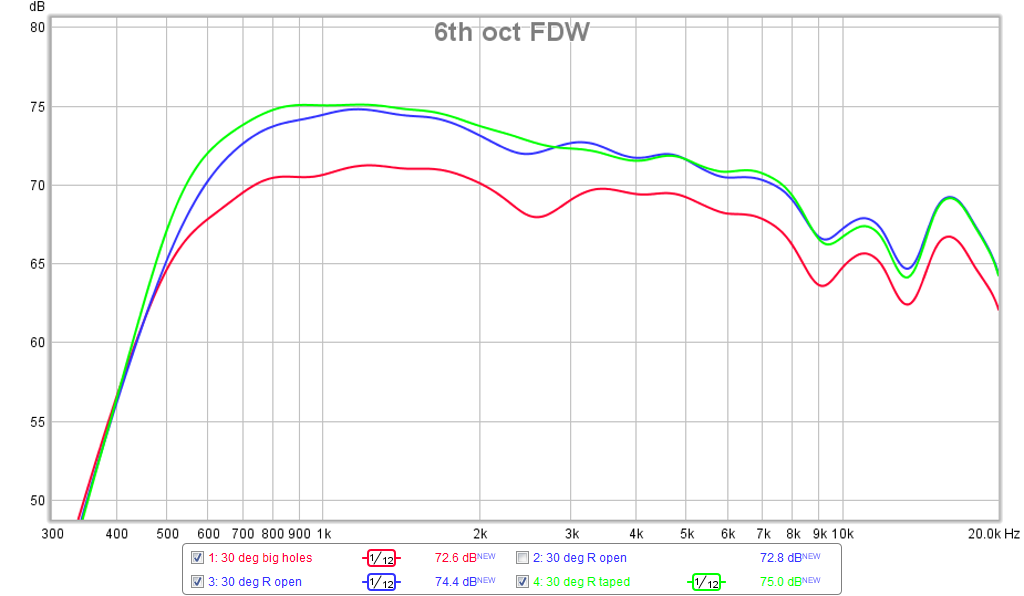

I ended up using hot melt glue to fill the gaps and bond the insert to the horn. I was also able to shape the hot glue as it cooled to a pretty smooth profile. I then put a layer of black electrical tape over the glue for the joint temporarily for smooth transition.
528427d1454257369-bookshelf-multi-way-point-source-horn-hole-repiar-success-photo.png
Measurements show that it was quite successful in boosting the output by about +2.5dB and smoothing it out - compared to taping over the holes to simulate a pristine horn.
I concentrated on the 30 deg measurement in detail to see this effect (red=big holes, blue=repaired, green=holes taped over):
528425d1454257077-bookshelf-multi-way-point-source-horn-sb65-lth142-eq-6thfdw-polar-vertical-big-holes-repair-compare-30deg.png
There is still a mild dip at 2.5kHz but the overall shape follows the pristine horn pretty well that I am satisfied with this performance. The taped over holes also has a bit more bass extension.

Excellent! If you eq the fr so it is linear at 45dgr you should get a mild recess at 3khz for direct sound only. It could be a winner!
Thanks! I will take a look at the EQ strategy - currently it is aiming for flat at 10deg. If I apply additional EQ based on 45deg, it would result in a mild depression over most angles at 3k whixh is sort of in the middle of the "presence" region. There is not much I can do about the resonances above 15k - probanly will leave that alone as it requires a steep Q filter that would add a lot of phase turn. But I can can get your suggestion and see what happens. I still have two more sets of 7 holes to drill and see what that does.

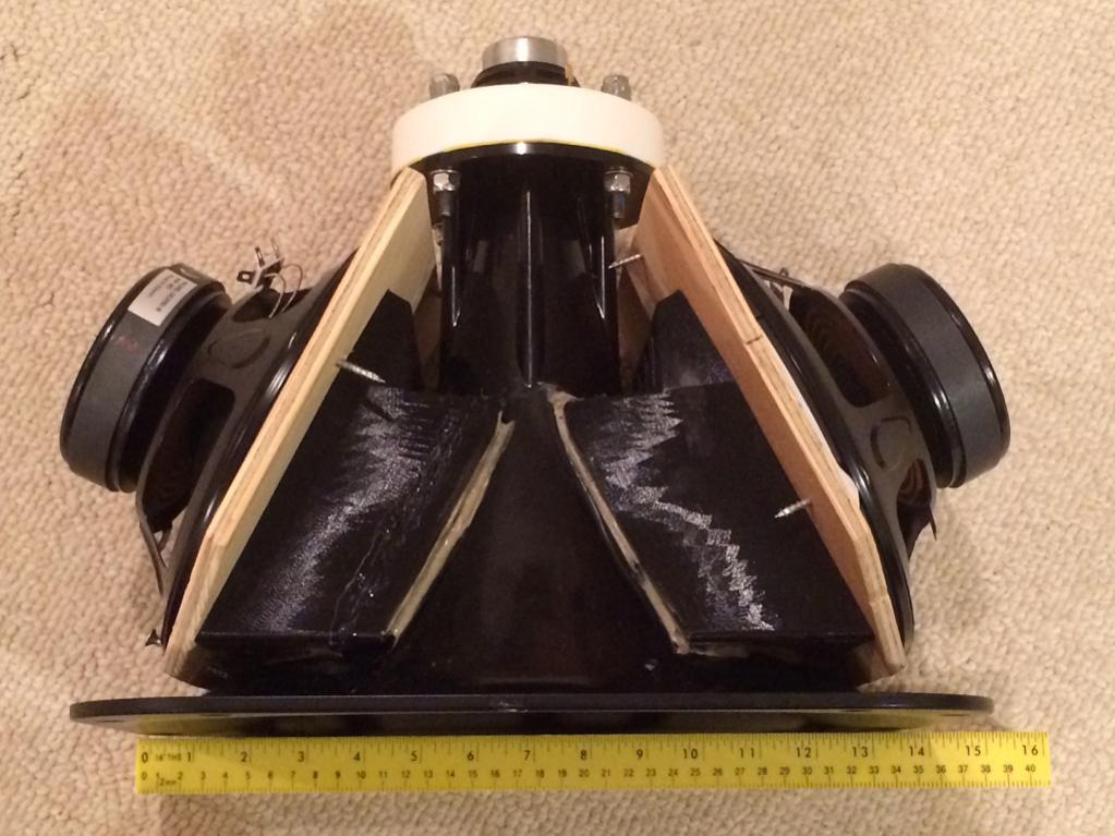

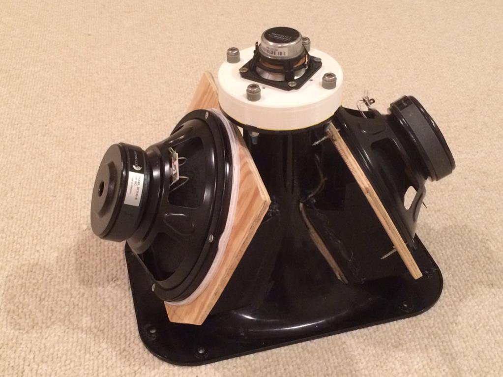

Progress on second woofer mount and holes
Qnty 7 x 7/16in dia holes drilled with assistance of 3d printed template:
528943d1454484423-bookshelf-multi-way-point-source-horn-lth142-swcond-woofer-holes-03.jpg
Second woofer mounted on horn:
Side view of woofers mounted on horn with ruler showing how final enclosure should be just at 17in high with wood thickness included:
I am waiting for the volume filler plug to be printed and can then mount everything together with another set of foam core spacer rings for the bezel, and then take another set of measurements.

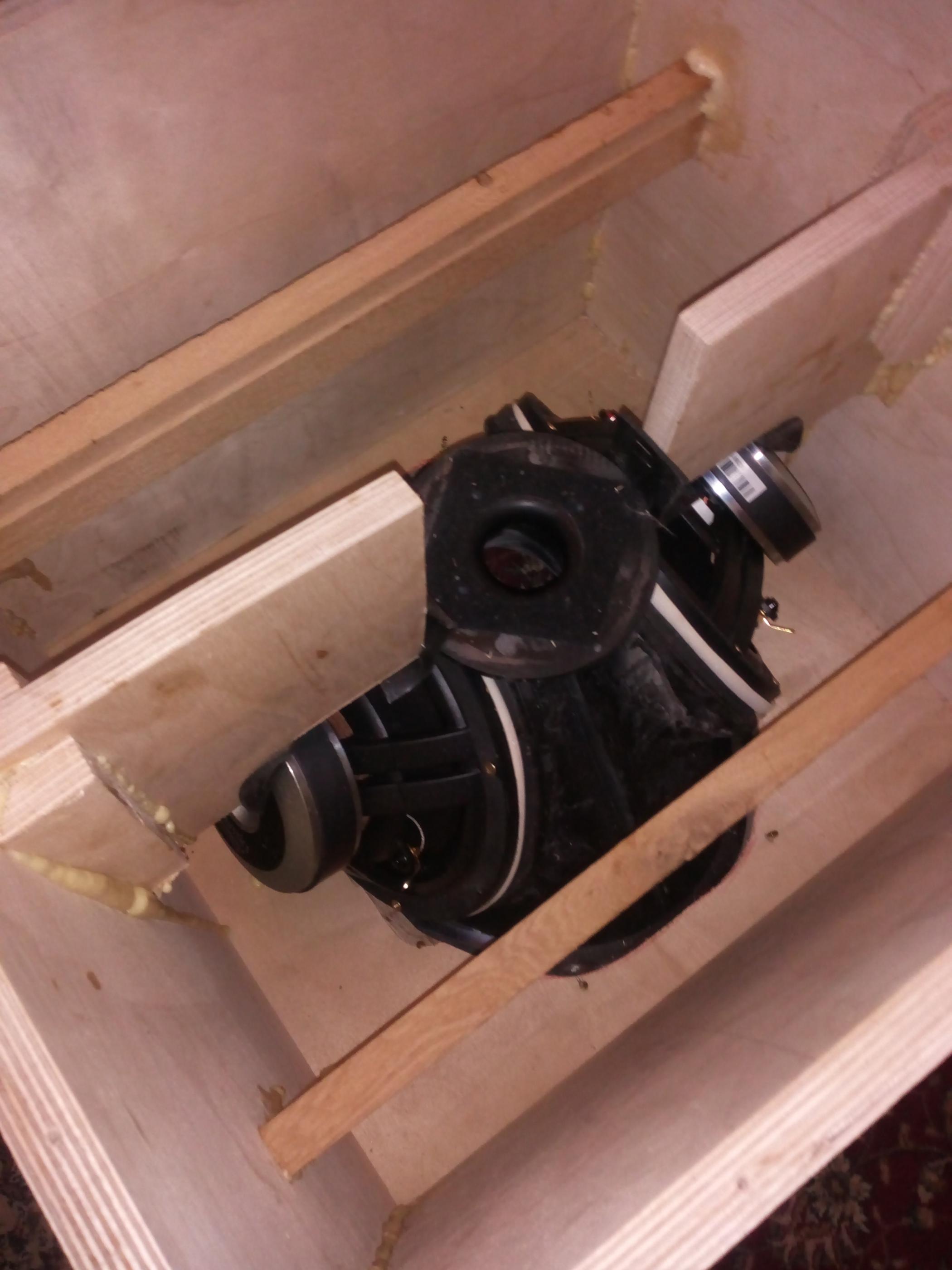

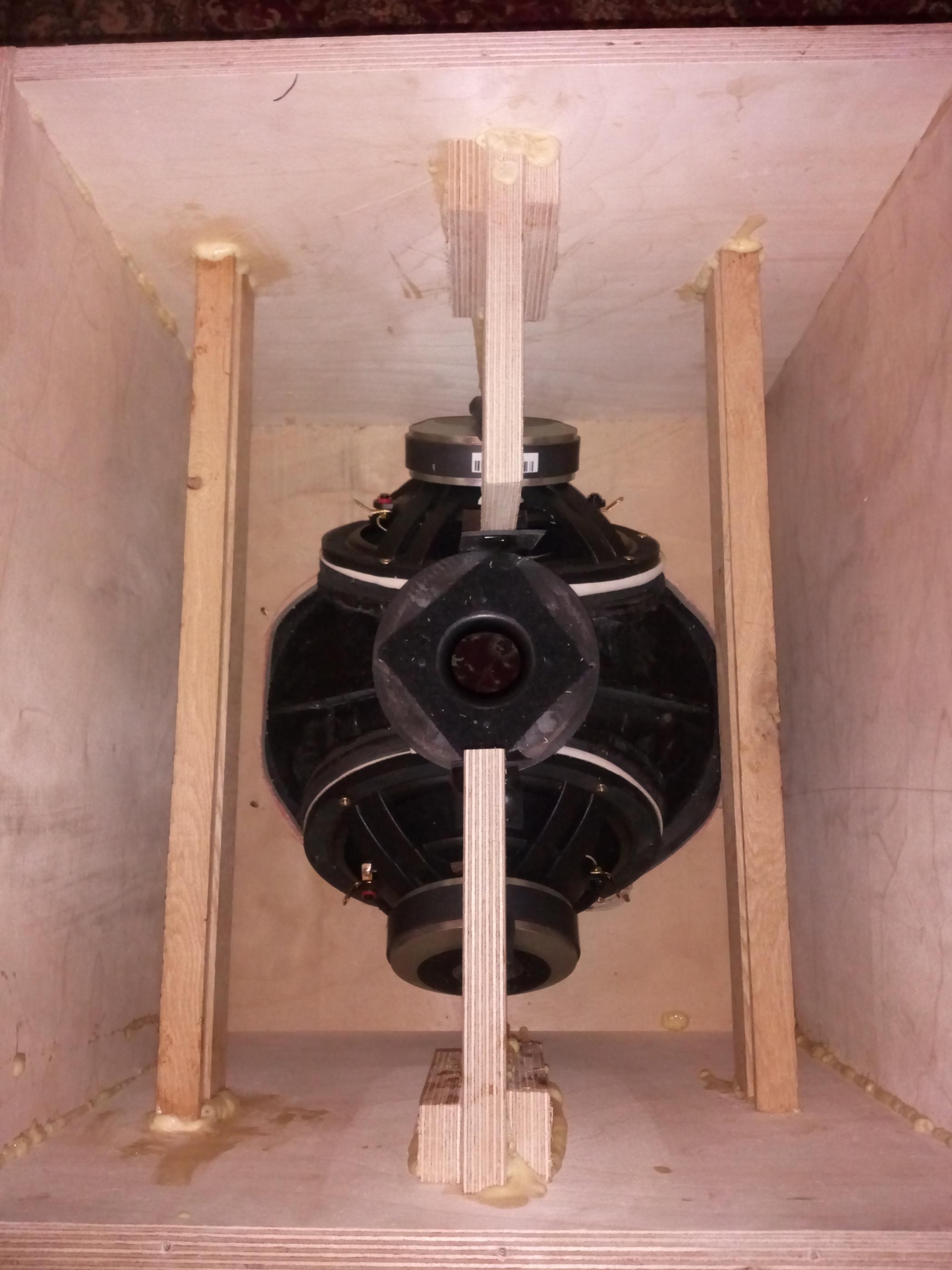

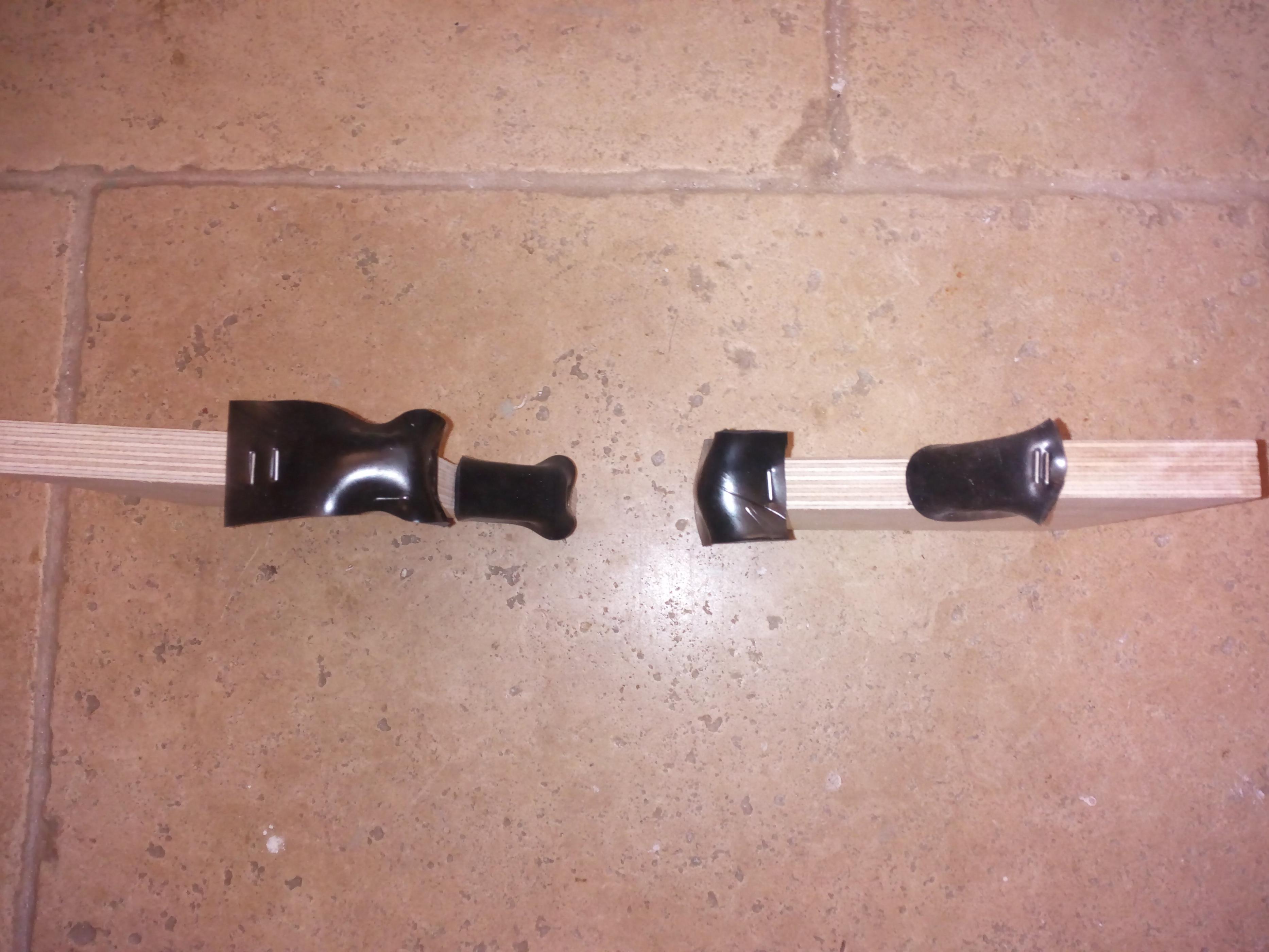

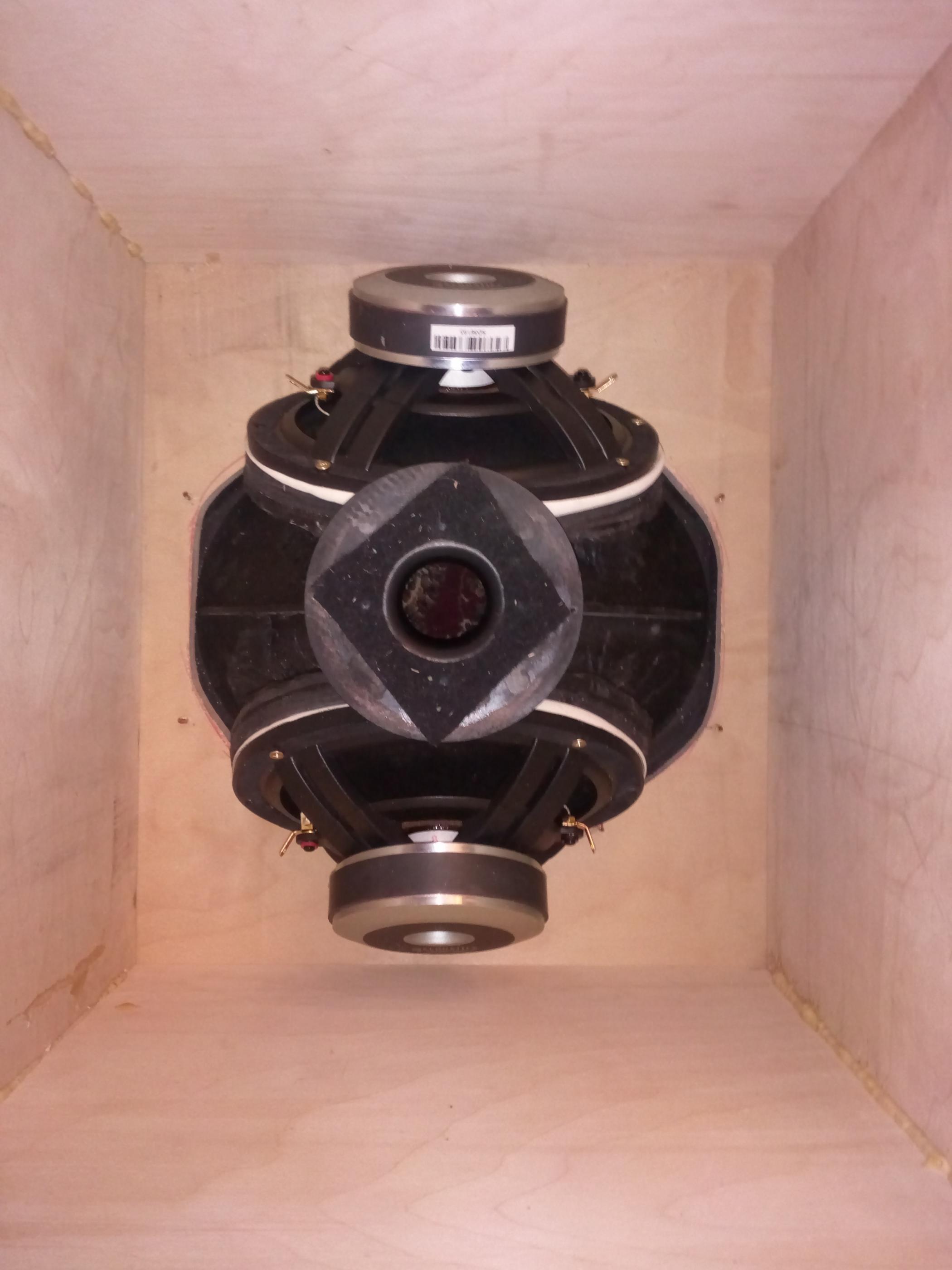

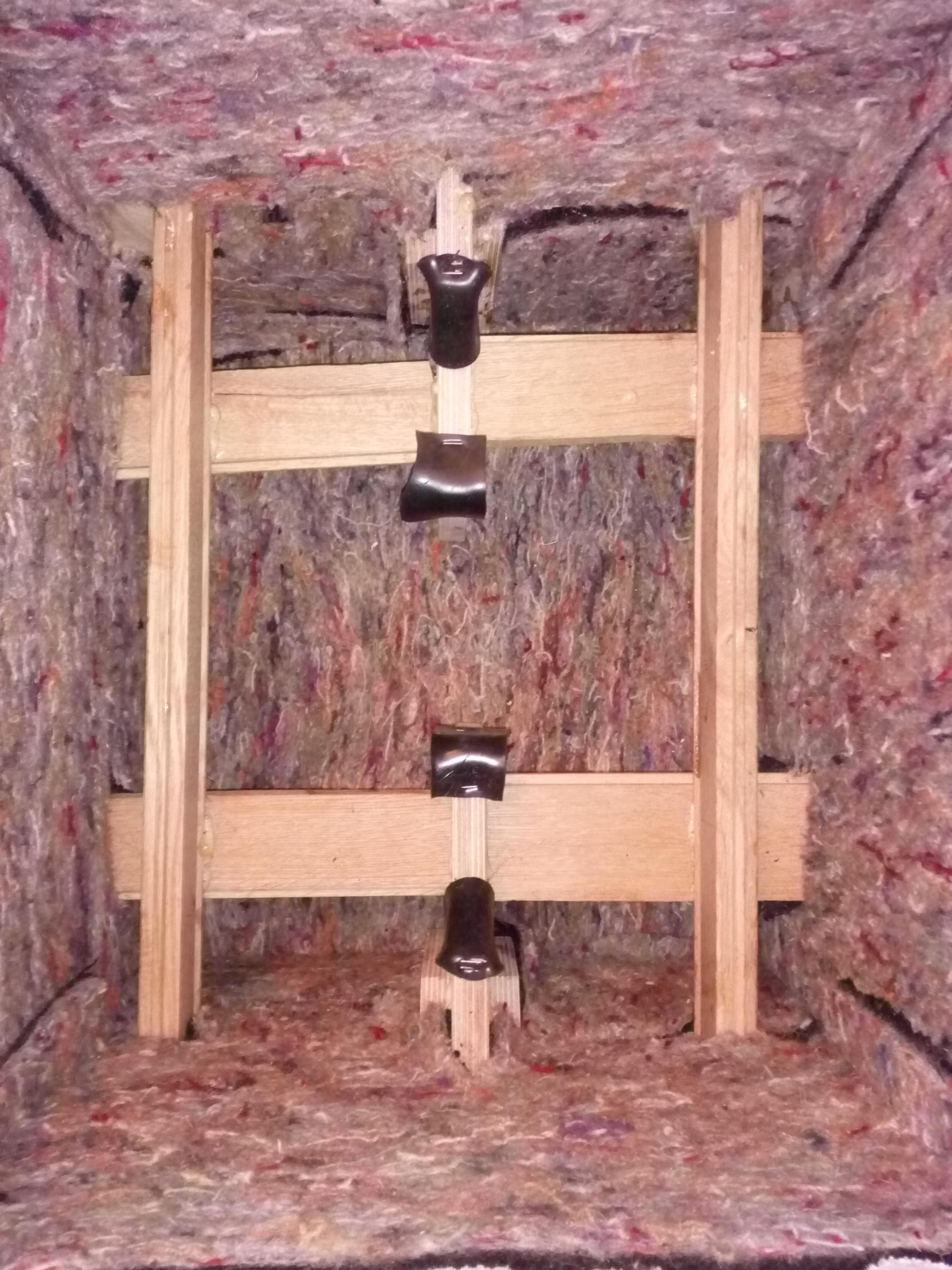

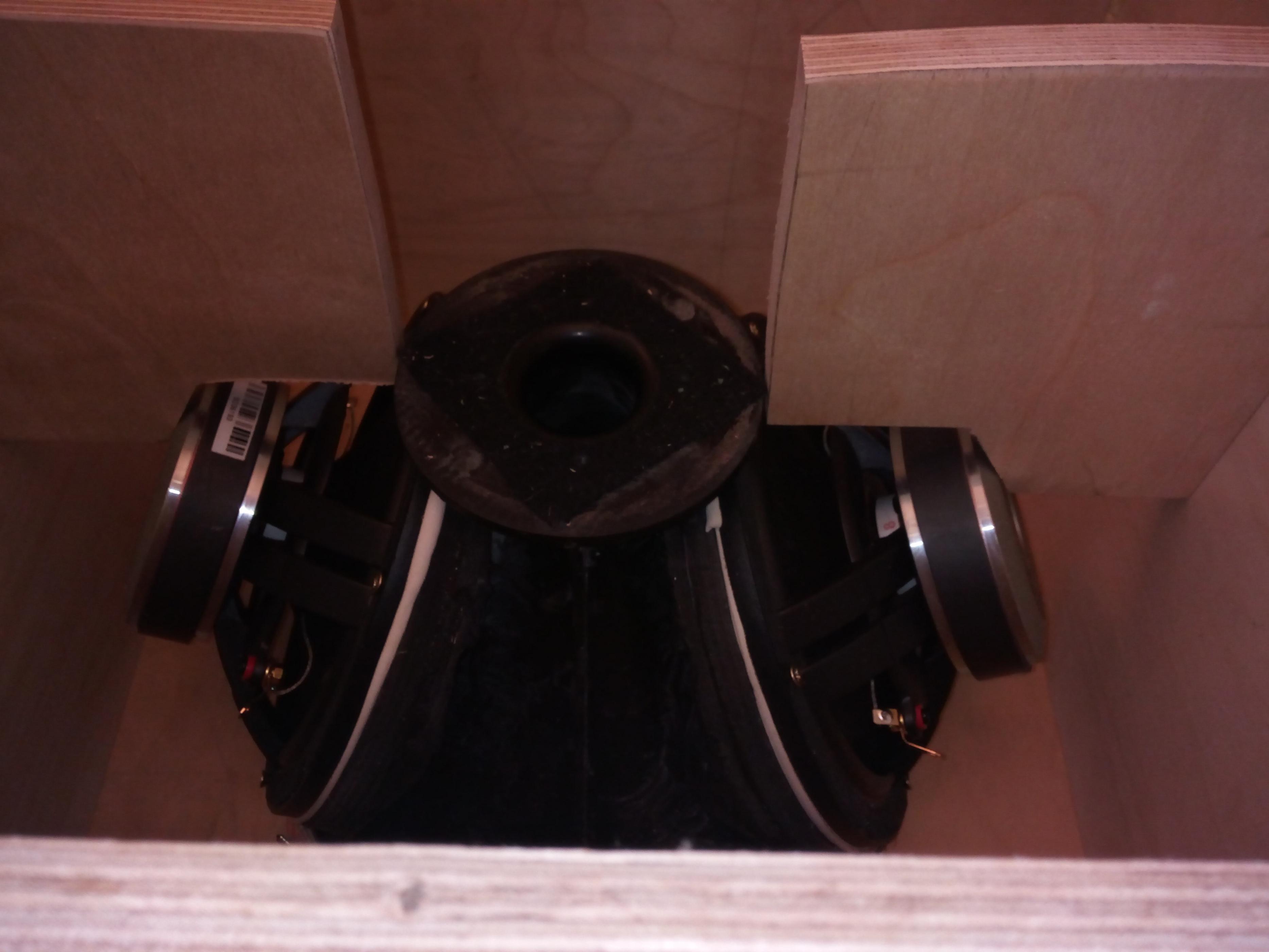

I am making progress two, here are some shots of the bracing and cradle half way through construction. You can see the sorbothane sheeting on the contact points.

Nice work there too Bushmeister! Your box looks quite a bit bigger than minimal size needed to hold the horn. Are you aiming for a larger format or deeper bass extension with larger box volume for sealed?
I have to get to work on my "Starfish" rear chamber which is basically 5 legged radially aligned Daggers with a rear deflector cone to allow a very flat low profile yet low coloration rear sealed chamber. It will be 3d printed of course.
I think it is a bit of an optical illusion - the sides are only an inch out from the woofer magnets and the edge of the horn - if you look at the first picture, you can see how close the front baffle edges are to the magnets/horn edge.
I think with all the bracing, the rest of the cradle in situ, all the extensional damping, rubber, wool felting etc, there will be very little room around the horn left!
I don't reckon on more the 25-30 litres once fully loaded. What I really didn't want, was to spend all this time creating a wonderful speaker design with CD, excellent FR, excellent SR, etc, etc, only to put it in a substandard box that rings and robs it of the magic.
The braces are 1 inch thick solid oak, whilst the cradle is birch ply. I will be adding further braces and layering up shortly. Then measurements will hopefully start tomorrow.....
Yes, it must be the wide angle lens effect. Your box is certainly well braced and sturdy. What are the external dimensions? I am going with 20/32in (16mm) ply on walls and 3/4in on front baffle. I am aiming for 11in wide x 17in tall x 13in deep.

External dimesions are:
18 inches wide (the horn is 15 inches wide) so with the 18mm ply wood this allows 1 inch either side clearance - just enough for damping, rubber and felt layers with a few mm to spare.
20 inches tall - Horn is 12 inches tall, but with woofers mounted on largest sides each woofer adds 2.5 inches height. So again - just over an inch clearance either side.
16 inches deep - to accommodate the rear chamber of the SB65.
X - I would strongly advise leaving at least an inch all around your horn on all dimensions - if only to stuff fiberglass in.
IMHO, suppressing standing waves and cabinet vibrations via a good quantity of stuffing and decent damping/absorption on sealed cabinet walls is really important - particularly with heavy ply - foam-core probably is already well damped, but ply needs a fair bit of extensional damping or CLD techniques to work well.
I will be using 4mm silentcoat for extensional damping, then 2mm rubber mat bonded to 15mm wool felting (this is an expensive underlay that uses 100% recycled wool felt and I have found works really well in speakers) - for further damping and absorption of reflections.
