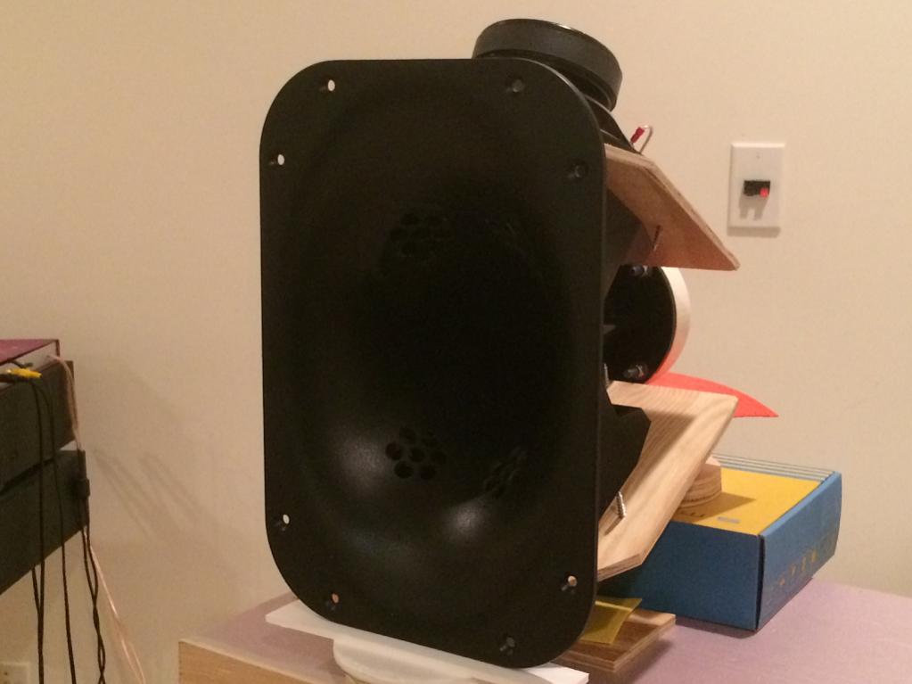

While waiting for the volume filler for the second woofer to be printed, I have been just listening to the horn with dual woofers. The bass of course is about now +6dB with dual 8ohm woofers wired in parallel. I will need to re-EQ once the volume filler is done. However, it sounds quite nice - with or without the blankets on the back, the bass is quite substantial and deep as a dipole/cardiod.
529143d1454556747-bookshelf-multi-way-point-source-horn-lth142-second-woofer-04-listening.jpg
There might be something to the simplicity of a dipole horn? Sure keeps the enclosure simple 🙂

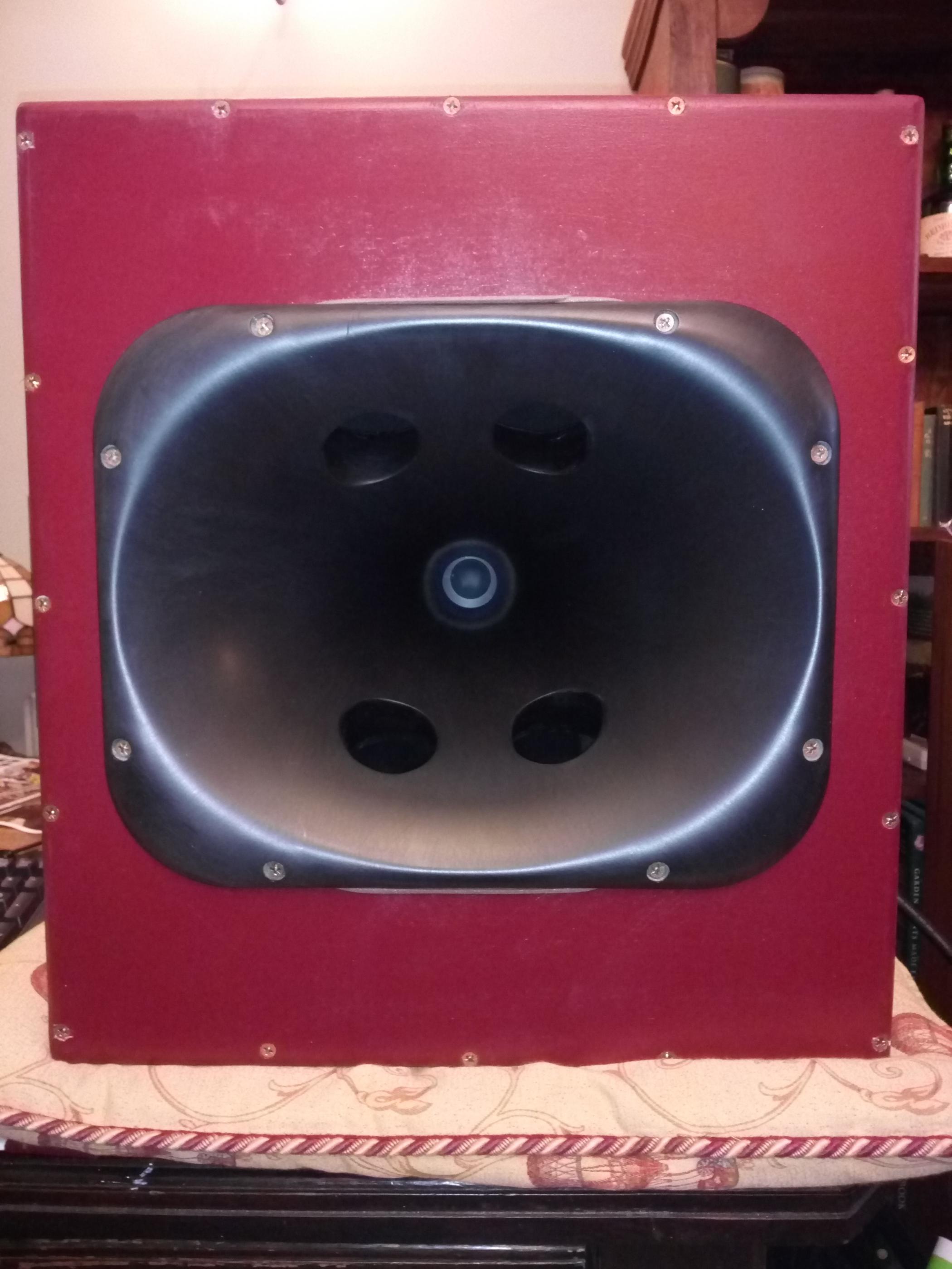

When I started this project, I had an idea inspired by Xrk's foam core home made horn loaded full range driver projects.
The idea was to take his experiments and translate it onto a modern high tech CD horn, thereby getting the best of horn technology, horn loaded full range drivers, and the synergy horn layout for point source behaviour.
I felt this could provide low HD, controlled directivity, flat phase response, and high sensitivity combined in a smaller form factor.
I was going to go it alone, had bought the horn and full range driver and was trying to get to grips with the modelling software.
Then, Xrk took me under his wing and offered to help out with all the modelling.
That was just over three weeks ago. And now thanks to the help and encouragement on this forum I have just finished the first one. Thanks guys!
There are also about 6 others builds in progress I believe inspired by the potential before we have even finished a full prototype! So hopefully soon, others will finish too - I think X is closest behind after me - he was going to sit this one out, but after my initial measurements he bought into it too!
Measurements to follow....fingers crossed!
Bushmeister,
Very nice!!! Thanks for being so motivated and so quick! It has been a real pleasure working on this with you and getting to see your progress and the great results you were getting. You were right - at first it was a vicarious enjoyment. But I just could resist once I saw the initial results which looked so darned good. Thanks for your encouragement and all the encouragement and tips and help from others in this thread. A big thanks to Byrtt and Weltersys.
Well done man. :cheers:
Cheers X! you are right without you, Brytt, wesayso and Weltersys this project would probably not have got finished in 2016!
You have been a constant help and have pushed me to get his done in record time. :cheers:

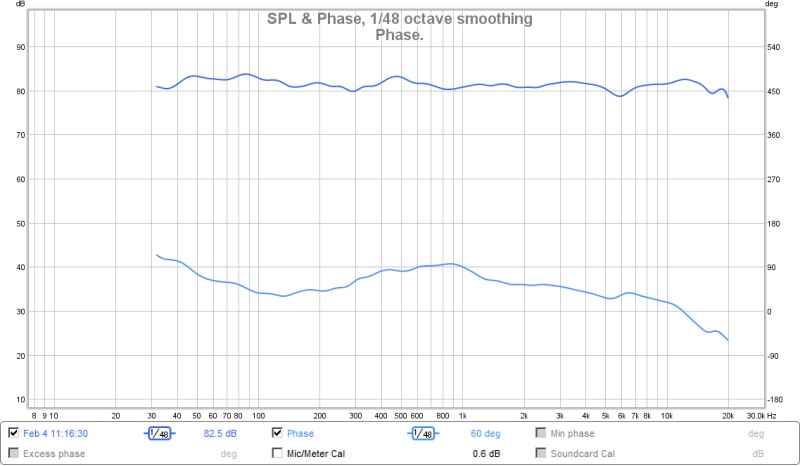

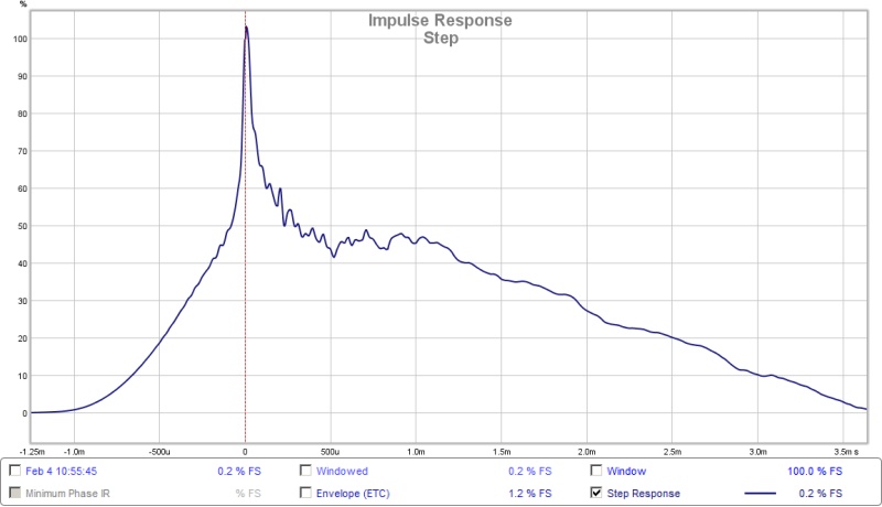

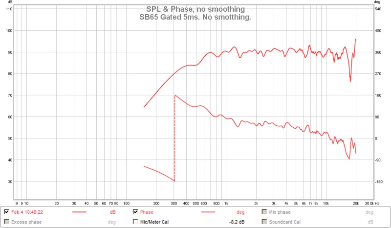

So some initial results...

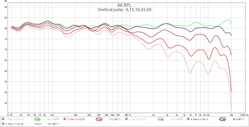

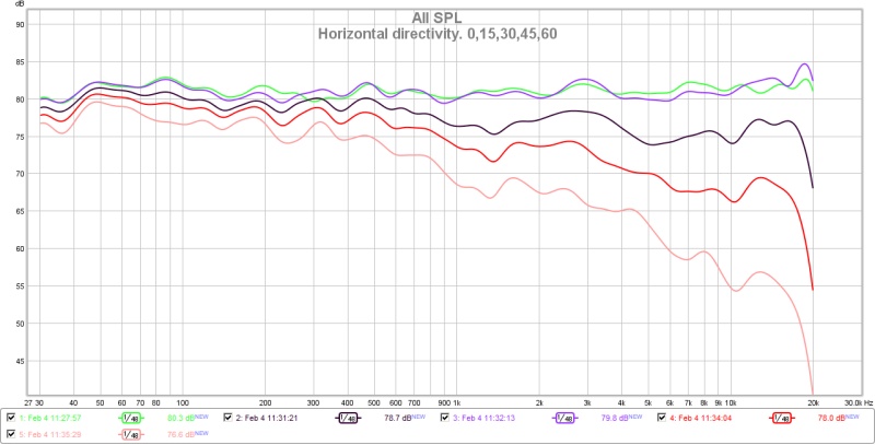

Will do - Am currently furiously measuring to check how the baffle has affected the CD.
Here's horizontal plots.
Those look pretty good! To clarify, you have not touched the EQ you developed with bare horn and drivers sans baffle and box? The variations are small and consistent over angular variation so re-EQ'ing with box should result in superb results.
You will get there but wondering how sealed box affects bass extension. Looks like you still are getting down to 40Hz easily???!
And.... Can't wait to see how all that first class dampening treatment inside and Sorbothane have worked with regards to HD. 😀
I missed this post on previous page!!! Very nice.
Yes, I forgot to mention thanks to Wesayso for the great tip on how to EQ with gated measurements. My bad.
This frequency response and measured phase are excellent. The Harsch XO is probably working perfectly in this setup with a textbook 55deg bump from nominal, otherwise flat over bandwidth of interest. Amazing result.

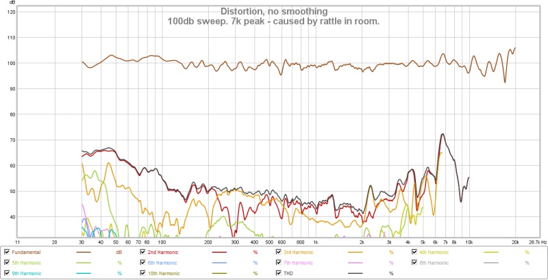

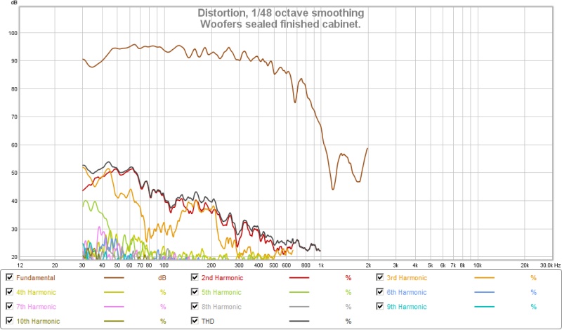

Bushmeister,
Those HD figures in the bass are very impressive for a small dual 8in woofer in a sealed box. -43dB at 80Hz and 100dB is awesome. -33dB at 30Hz is still awesome and up there with the best in this driver class range from what I have seen.
For the HF, you may be getting some HD from surround rubbing on the dampening foam in the driver mount. That rise from 2k looks suspicious.
