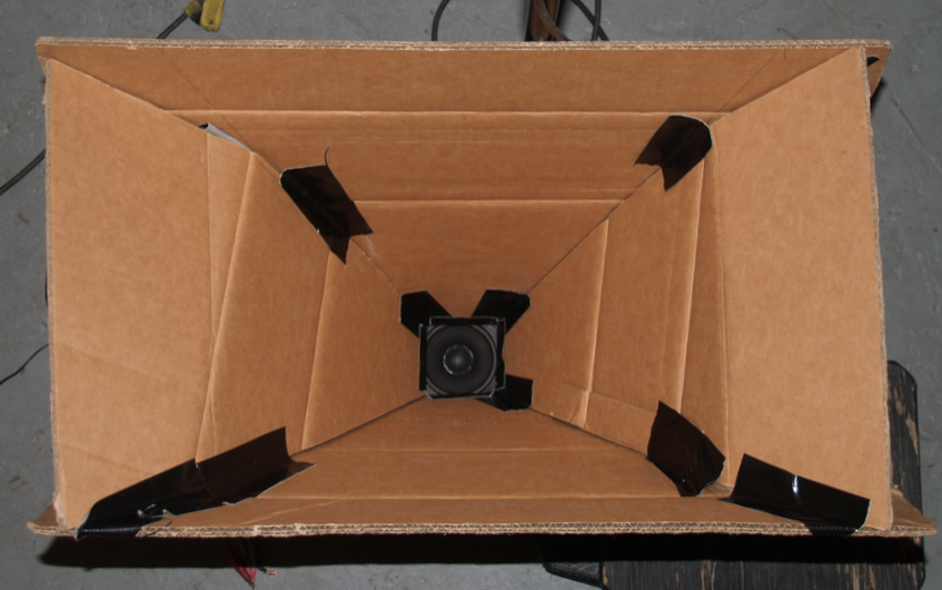

The tape and cardboard TC9FD-18-08 45 x 30 conical horn prototype whipped up in about 20 minutes just before last Christmas had really good polars, and a only a few easy to correct "bumps", raw response below.
Note that only about 6 dB of EQ correction would be required to flatten response from 250 to 16kHz.
Though the initial conical horn flare is 45 degrees, actual horizontal coverage is 60 degrees (-6dB 30 degrees off axis) with uniform constant directivity pattern control to 650 Hz.
It would be easy to build from plywood (or foam core), and much easier to mount woofers on than elliptically shaped horns.

That's a nice cardboard horn. I actually have tons of the same type of triple wall cardboard from moving company boxes. What size is that TC9 horn and can you share dimensions? Is it as simple as going into Bwaslo's spreadsheet and plugging in 45x30 and 3in throat? Did you have a problem with horn wall vibrations? I noticed with foam core horns is that when not CLD'd and unbraced - they vibrate as a secondary resonator sound board and sometimes give a better looking polar and deeper bass extension than a stiffer material. Once you add a second layer of cardboard glued on with a thick layer of latex caulking, the bass extension goes higher, the polar directivity narrower, and it is peakier. But the HD hoes way down. It may just be broadband noise rather than true HD though.
Weltersys,
At the low level of SPL of the testing, horn wall vibrations were not a problem, though I would not use cardboard for anything but a prototype.
The dispersion pattern was chosen because toed in it is adequate to completely cover my couch at 12', and because the TC9 native dispersion pattern is only about 45 degrees at 12.5kHz, a wider angle horn would not have wider HF dispersion. 30 x 45 also loads to a lower frequency than a wider horn, while the "beaming" response of the 3.5" driver (partially) compensates for the HF drop inherent in a constant directivity horn. Low mid gain is 6-10 dB compared to the response of the driver, tapering off to the same HF sensitivity.
The throat is probably close to 2 5/8" x 2 5/8", with a 3" 3/16" deep ring around to keep the surround from hitting the throat.
Mouth width was approximately 32". Bwaslo's calculator would be an easy way to duplicate the horn, though this prototype did not use a secondary section on the top and bottom sections, they are single walls. The size could be scaled down to "bookshelf size", polars response would remain the roughly the same, but pattern control would be lost at a higher frequency.

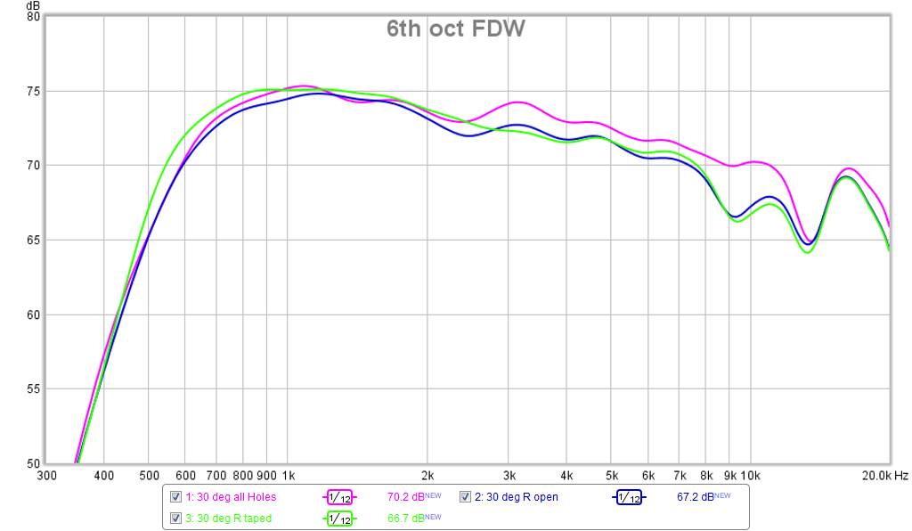

All 4 Band Pass Holes Polars
To my surprise, adding the second set of band pass injection holes for the second woofer actually improved the response relative to having only 2 holes. Each "hole" being the seven smaller hole arrays. Here you can see that compared to the earlier case with only two, the response (magenta curve) improved by 3.5dB at 9kHz, and smoothed out a little more over a range. It is even more sensitive at 9kHz than the taped over (pristine case) - which is puzzling. Overall, the pristine horn is smoother though.
529499d1454732752-bookshelf-multi-way-point-source-horn-sb65-lth142-eq-6thfdw-polar-vertical-2-vs-4-holes-compare-30deg.png

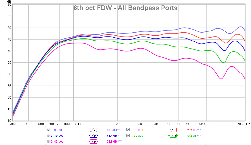

Here are the polars with all holes out to 45 deg:
529500d1454732752-bookshelf-multi-way-point-source-horn-sb65-lth142-eq-6thfdw-polar-vertical-all-small-holes-drilled-5db.png
So it appears that the strategy to go with the array of 7 smaller holes worked out well as it minimally affects the polar response. I can now go back and re-EQ the response for flat at either 10deg or as some have proposed, at 30deg.

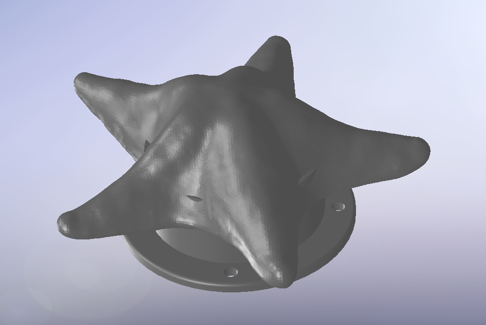

Is there an intent to eventually design a 3d printed model where the drivers bolt right up? It could be sliced into sections in the software so that it could be printed in small desktop printers and then bolted together. Ive never used a 3d printer, or designed for one so I'm not aware of the limitations but that would be so damn cool! You might even achieve a good WAF that way.
I'm surprised there isn't more badass audio related 3d printery going on. Glad to see some of that happening here.
Thanks Bushmeister. The starfish was a bit of whimsy and only reason I thought of making it was that for a 3d printer, it doesn't matter how complex the part is - it prints almost as easily and I really needed a way to get the profile thinner to get the whole "bookshelf" aesthetic of the thread title. I haven't given up yet. Plywood cabinet building is not my strength so here is where it gets hard and slows down. I have thought about making the whole thing as a sectioned 3d print and either bolting together or better yet - glue it together. Hot melt glue is actually an excellent way to bond smaller pieces together as it partially melts the PLA plastic on the process of bonding it for and solid connection. It would be pretty expensive material wise to print the main waveguide that I am still think using a COTS one and adapting it is still the way to go. Also, as more builds in this thread progress with other waveguides, we will see which ones work well. However, my suspicion is that they will all work and that it's not that sensitive to the waveguide as long as you use a driver that is well matched and allows smooth operation. The drilling of the band pass injection holes won't affect the polar response too much of done judiciously and around the corners for the rectangular WG's. Can't wait to see others start connecting their 3.5in drivers to the larger 2in throat horns.
