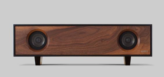

Funny enough I am probably going to go for the opposite aesthetic scheme to you with a mat black cabinet and a dark walnut veneered baffle.
I am hoping this will minimize the apparent size of the cabinet - I have some lovely black walnut veneer left over from a previous project. The walnut veneer will be a rectangle set back from the curved cabinet edge.
A little like this.
A little like this.

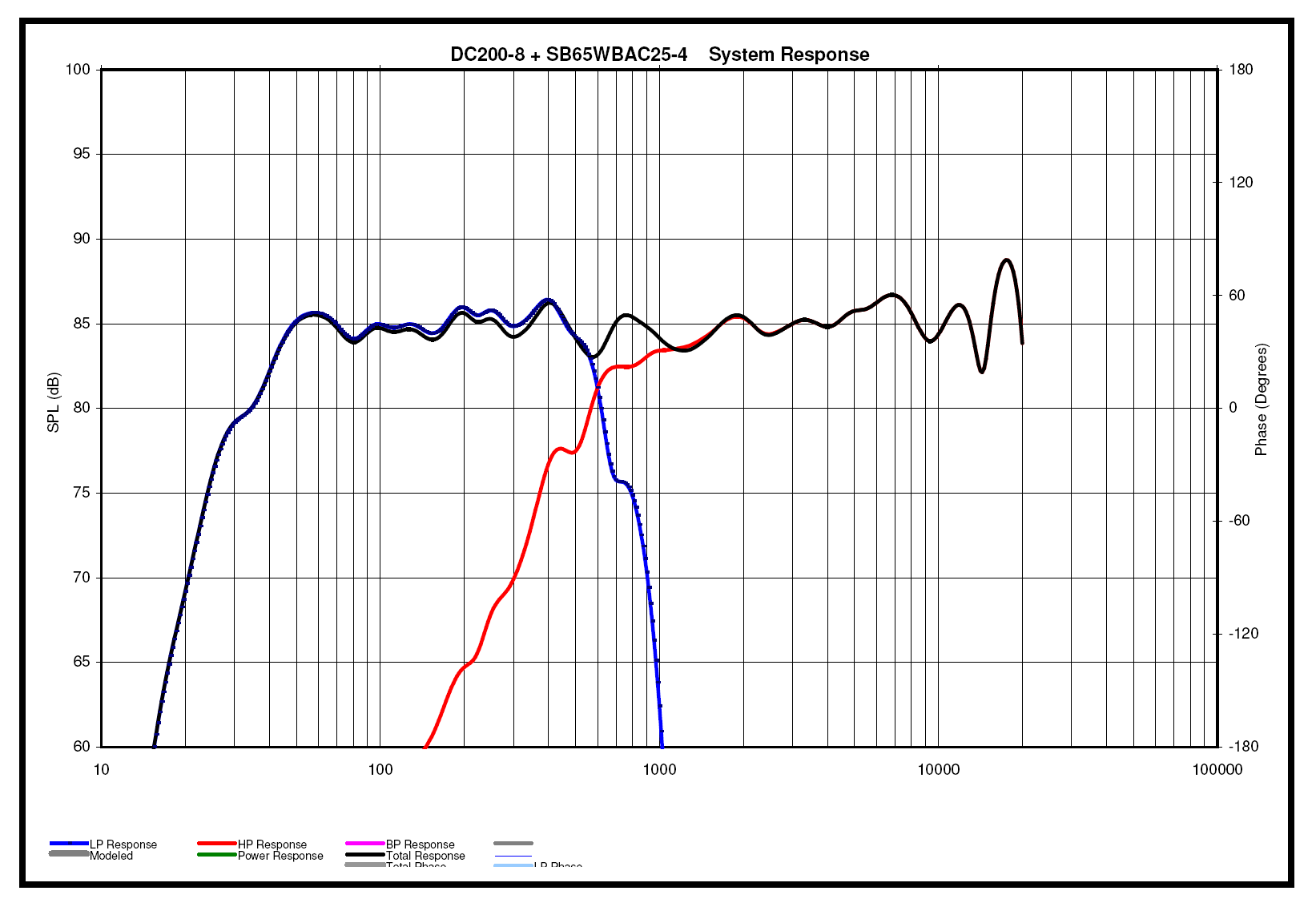

I am using PCD to develop the settings for the miniDSP Harsch XO. Here is the predicted PEQ-shaped response based on measured raw responses for a 600Hz XO frequency:

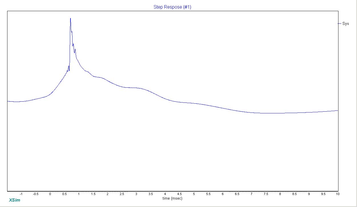

Here is the associated predicted step response from the PCD calculated output FRD file:

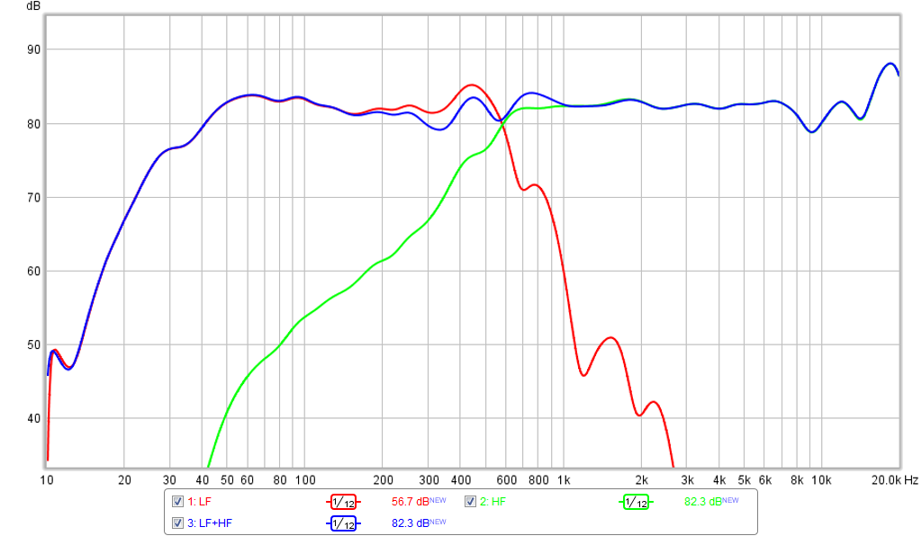

Here is the measured electro-acoustic frequency response showing the Harsch XO implemented with an electrical BW1 high pass on the SB65 and BW2 low pass on the DC200:
However, when implemented, I am having a problem with time alignment - I think I forgot to click the "Estimate IR delay" button in REW before exporting the minimum phase FRD to PCD. More work ahead but even so, it sounds pretty good once I manually tweaked the delay to resemble a Harsch XO - but far from perfect. There is also a box distortion that I need to work on removing with better dampening on the walls. Right now all I have is fiberglass stuffed in the box when it really needs either felt or foam lined walls. Also, there is no separate sealed rear chamber for the SB65 yet - all sharing a common volume so the woofers are probably pushing on the SB65.
