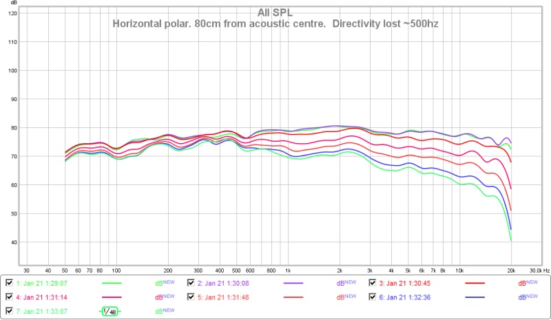

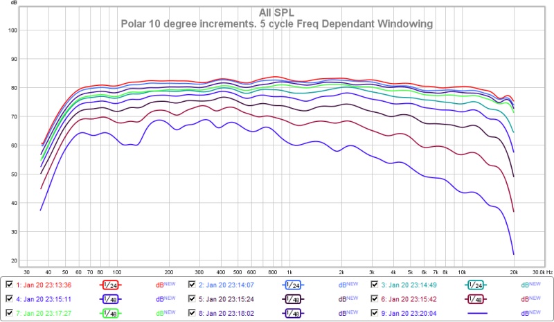

I haven't kept up with this thread, but looking at the updates in the first post, I am having a hard time believing the polar measurements.
You have - 6db point at 60 degrees at 50 Hz? How is this possible from a smallish horn? Something weird is going on and I would double-check the polar measurements.
Those polars were the result of the open back (dipole) woofers, the later polars with the sealed woofers look "normal", pattern going omni below around 600 Hz.You have - 6db point at 60 degrees at 50 Hz? How is this possible from a smallish horn? Something weird is going on and I would double-check the polar measurements.
Ah, ok. But if the measurement is accurate then we may have accidentally stumbled upon an approach to control directivity down low without the negatives of traditional dipoles, i.e., dipole peak, EQ, power hungriness.
The response required plenty of EQ to flatten, the negatives were still there. That said, the phase (and frequency) response of the driver's output on the horn side is different than on the open back, so there are differences between this response and a "traditional" dipole.Ah, ok. But if the measurement is accurate then we may have accidentally stumbled upon an approach to control directivity down low without the negatives of traditional dipoles, i.e., dipole peak, EQ, power hungriness.
Also, the measurement angle of the single woofer was different compared to the on-axis direction of a "traditional" dipole, and probably would not look the same if rotated the opposite direction.
He did remake this measurement a little later and got this:I haven't kept up with this thread, but looking at the updates in the first post, I am having a hard time believing the polar measurements.
Look at post #427 here.
Here is a more accurate set of horizontal polars - all measured! Directivity is lost around 500hz which is correct for the horn specs. Just shows how inaccurate 'freehand' is, but I was only doing quick and dirty measurements first to look at the CD up top.

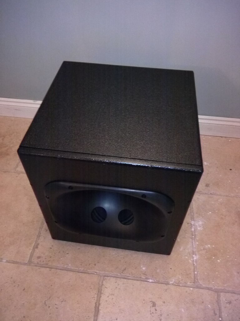

After listening to this speaker I can see that a higher quality woofer would be more appropriate to get the most out of the sound quality. I have decided to upgrade the woofers with a pair of RS180P-8's that are on order. These are a little smaller but have higher sensitivity (90dB) and more xmax. Most importantly, they have a cast alloy frame and more advanced motor with shorting rings to reduce distortion. I did not get RS225's as those are much bigger than the DC200's and won't fit in the box.
My RS180P-8's arrived yesterday - amazingly 2 days after order was placed and free shipping too. I have to say, I am quite impressed with their build quality: top notch cast basket with crinkle paint finish, great neatness of glue and fit and finish, nice paper cone, solid aluminum phase plug, a large beefy magnet, and built-in EVA foam rubber gasket on the bezel rim backside.
To top it all off, the first thing I do when new drivers arrive is I put them to the TS parameter test with a DATS v2. These drivers measure spot on within 2% of all critical parameters like: Qms, Qes (and Qts), Mms, fs, Vas (was a little more off at 24 liters vs spec 22 liters but not a problem) and the surprise was that the Le was much lower than quoted at only 0.2mH at 10k. Anyhow, when a Qts spec of 0.34 measures in at 0.35 - I am happy. Also, the predicted sensitivity was almost spot-on too, coming in at 89.5dB at 2.83v.
Dayton does not exaggerate their TS parameters like some manufacturers. This driver is a great value at $51 for a 6mm xmax 89.5dB driver.
These will be swapped over for the DC200'8's shortly.

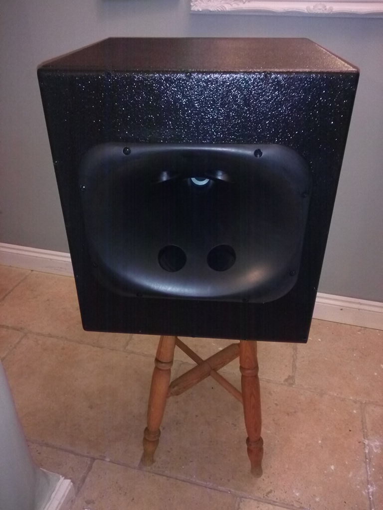

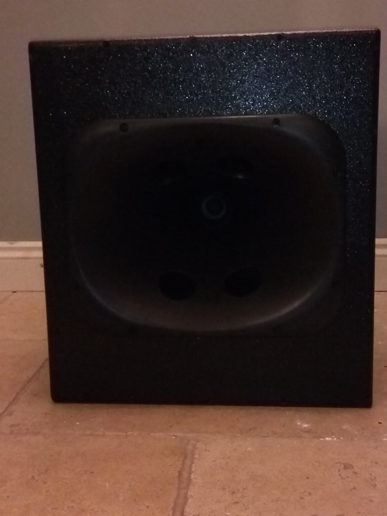

New upgraded stealth finish. Van damme studio cabling and 4 pole speakons used. Stuffing done. Measurements to follow.
I plan to sit it on top of a large 15 inch sub - in sealed cab - same width and depth but height optimized to put horn at listening height.
I love the stealth "Darth Vader" look! Great job!
"pffuffhhh, pffuffhhh, Luuuuke, I amm your Faathhurrr..." 🙂
