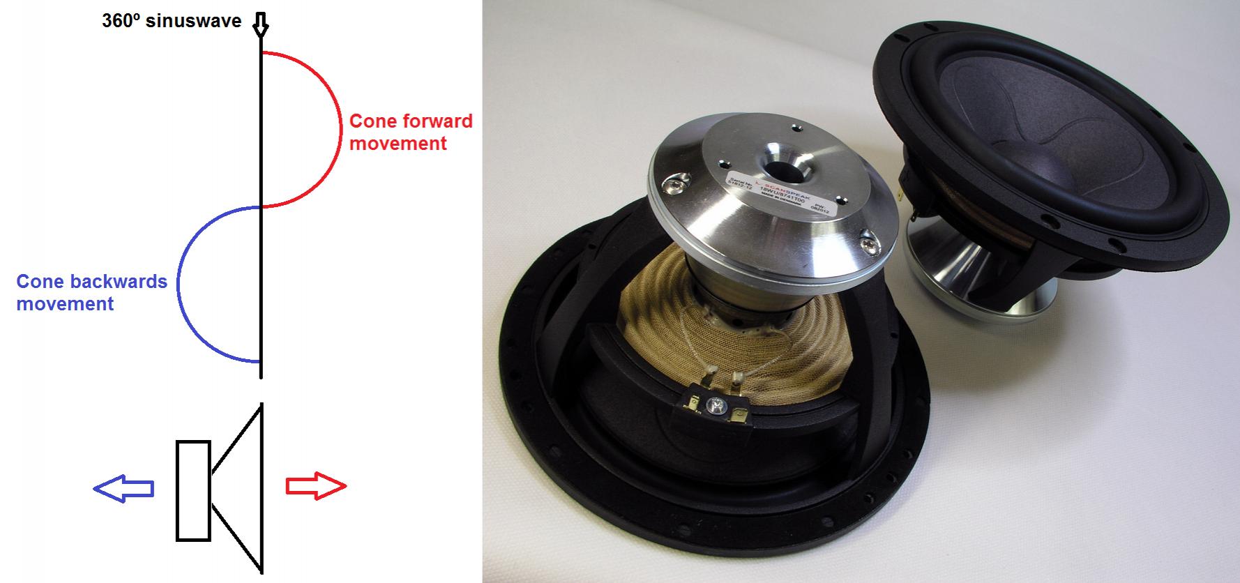

Makes me think about open construction with many top end products as these ILLUMINATOR or SATORI, more open baffle : )
Seen wesayso link to some klippel tests for these somewhere they seems perform better symmetry but is costly.
So going a step up in quality for woofers with your new RS180P-8 would probably be better into sealed as the SB23NRXS45-8 woofers bushmeister use.
Wonder if we can see this unsymmetrical troubling simply by making a near field measurement with REW and after that change polarity for speaker cable at power amp and run same measurement. Overlaying those two measurements and invert one of them should show exactly same data in all the different measurement windows into REW including HD, and if not one of the directions for cone has trouble that need to be looked at is a thought.

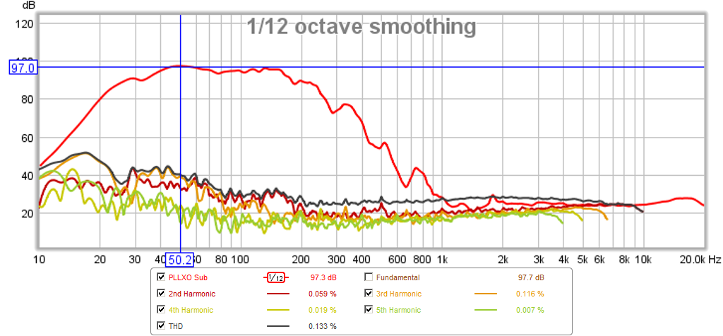

Have you taken the Klippel online distortion audibility test? My ears are sensitive to HD down to -45dB. Most people are circa -21dB or about a little under 10% - which is why they spec amplifier power at 10% THD levels. "Most" people can't hear any difference below that. I guess I am an exception.
If you can get 97dB at 1m with circa 0.13% THD, why not? It's hard to go back to dirty bass once you have heard bass like this.
