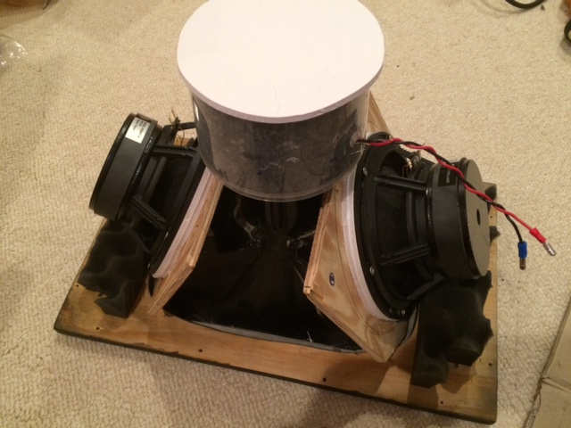

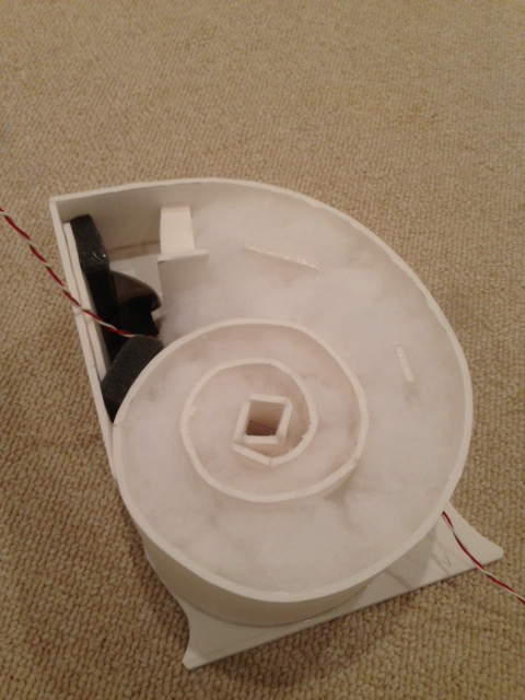

SB65 Rear Chamber

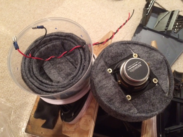

I got lazy and found a round cover from a CD spindle that fit perfectly around the horn flange and adapter. So I lined it with several layers of felt, sealed it up and took a spectrum. It's actually very good everywhere and has low HD but still suffers a rear wave cancellation at 1.5kHz corresponding exactly to the 4in round trip distance from the cone to the side wall. It's a sharp dip though so not very noticeable. I will use this for now until I build a proper "starfish" Dagger rear chamber. It does make a difference to use a Dagger or Nautaloss vs a cylinder rear chamber.
Here is the inside of the chamber:
Installed on horn (white disc is foam core with a layer of latex caulking in between for CLD and to give more mass and stiffness to rather thin flat end which may vibrate in a drumhead mode):

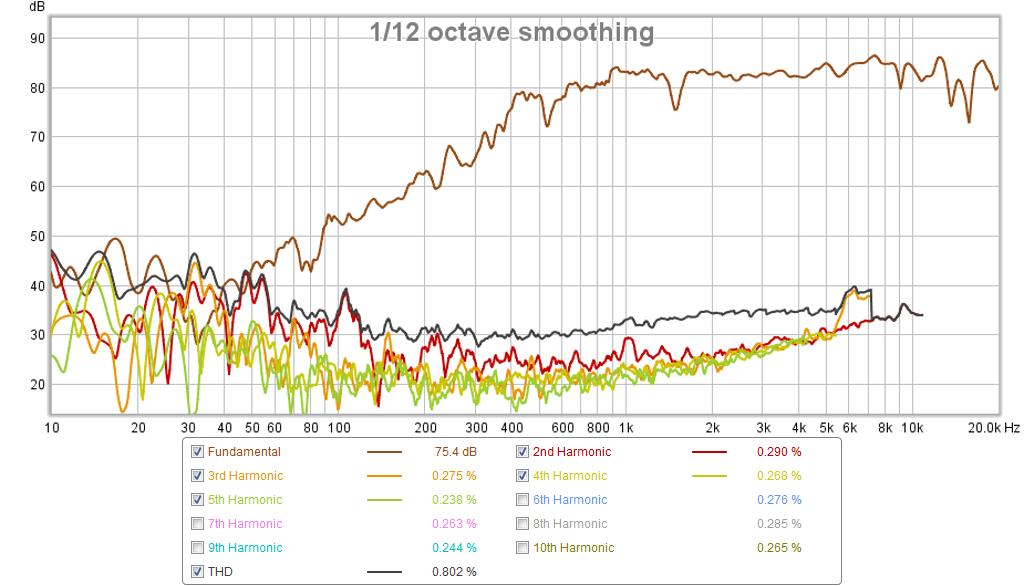

Here is measurement of frequency response with 600Hz 2nd order Bessel HPF (electro-acoustic target profile):

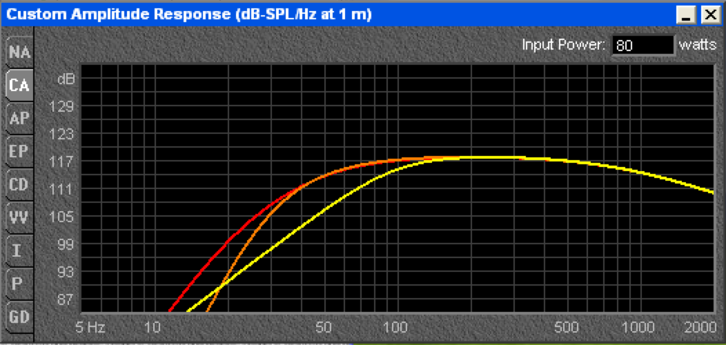

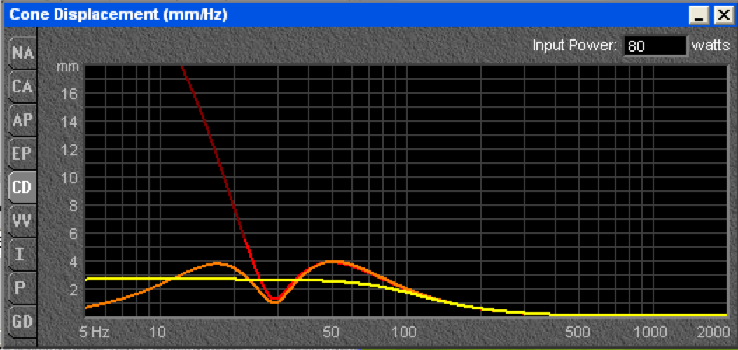

I am very close to buying a pair of Beyma SM115N/8 drivers as they seem to have a low Fs reasonable Xmax flatish response and a good price. In a 100 to 150 vented cabinet tuned to ~30Hz they have an extended but slow roll off that doesn't need a big port. Room gain should help to boost the output at the low end and result in a reasonably flat in room response in theory. If it doesn't work then they can still be used in a sealed cab to 80Hz and subs below.
Beyma SM115N8 Bassbox pro sims
Red 150 litre vented 29 Hz
Orange 150 vented 29 Hz with 30 Hz high pass
Yellow 41 litre sealed 89 Hz F3
Output
Excursion

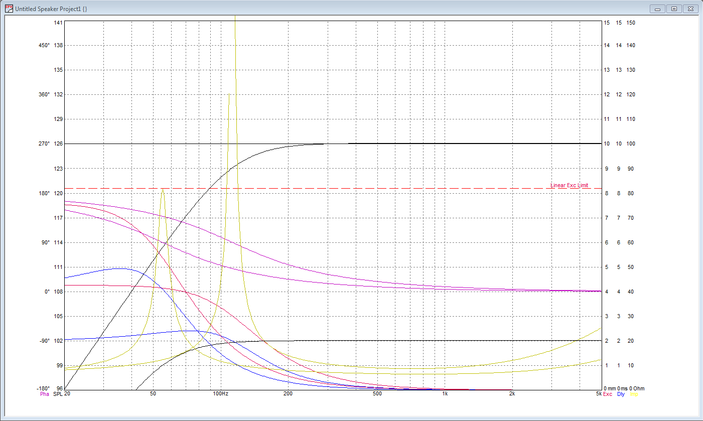

fluid admit have no experience PD pro woofers but think a couple 15 inchers models as recommended by Overkill Audio looks like good theory.
PD.1550 is 99dB SPL, 600 watt, Xmax 8,2mm, in sealed 25,56 liter for a Q 0,7 resonance at 112,6Hz.
PD.155N01 is 98dB SPL, 700 watt, Xmax 10,5mm, in sealed 26,99 liter for a Q 0,7 resonance at 102,6Hz.
Feed them with a low cost digital pro amp from Behringer or diy some hypex module.

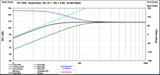

Below example is PD.1550 with 512 watt overlayed with a 55Hz F3 full range system at 102dB SPL. Filter with EQ and or LT all the HF away for woofer and XO with low pass filter in 50-80Hz area. For 512 watt example excursion is only in area of 4,3mm out of 8,2mm so no problem for home audio setup, enclosure is small and resonance bump is up in mids so passband is without any resonance bumb.

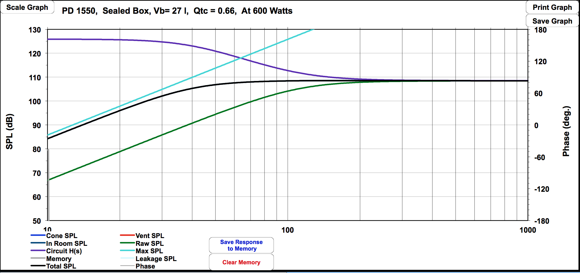

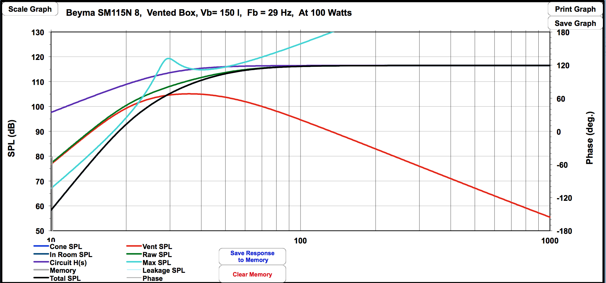

I have also never used any of these woofers and am basing a lot of my thoughts on how the simulations come out. I have seen the information Derek has posted on these before but as it is part of his commercial interests the details are a bit scant on how he uses them.
I can't really understand the graph you posted before. I have attached here some PDF's of the output from Jeff Bagby's Woofer designer spreadsheet as this is very good at modelling Linkwitz transforms and other filters when applied to box models.
I have used a Linkwitz transform target of Q=0.7 and Fp of 40Hz which is quite conservative as Q=0.5 and Fp of 20Hz would reduce the level a lot further. If you relax the LT to have a higher F3 then more output is available.

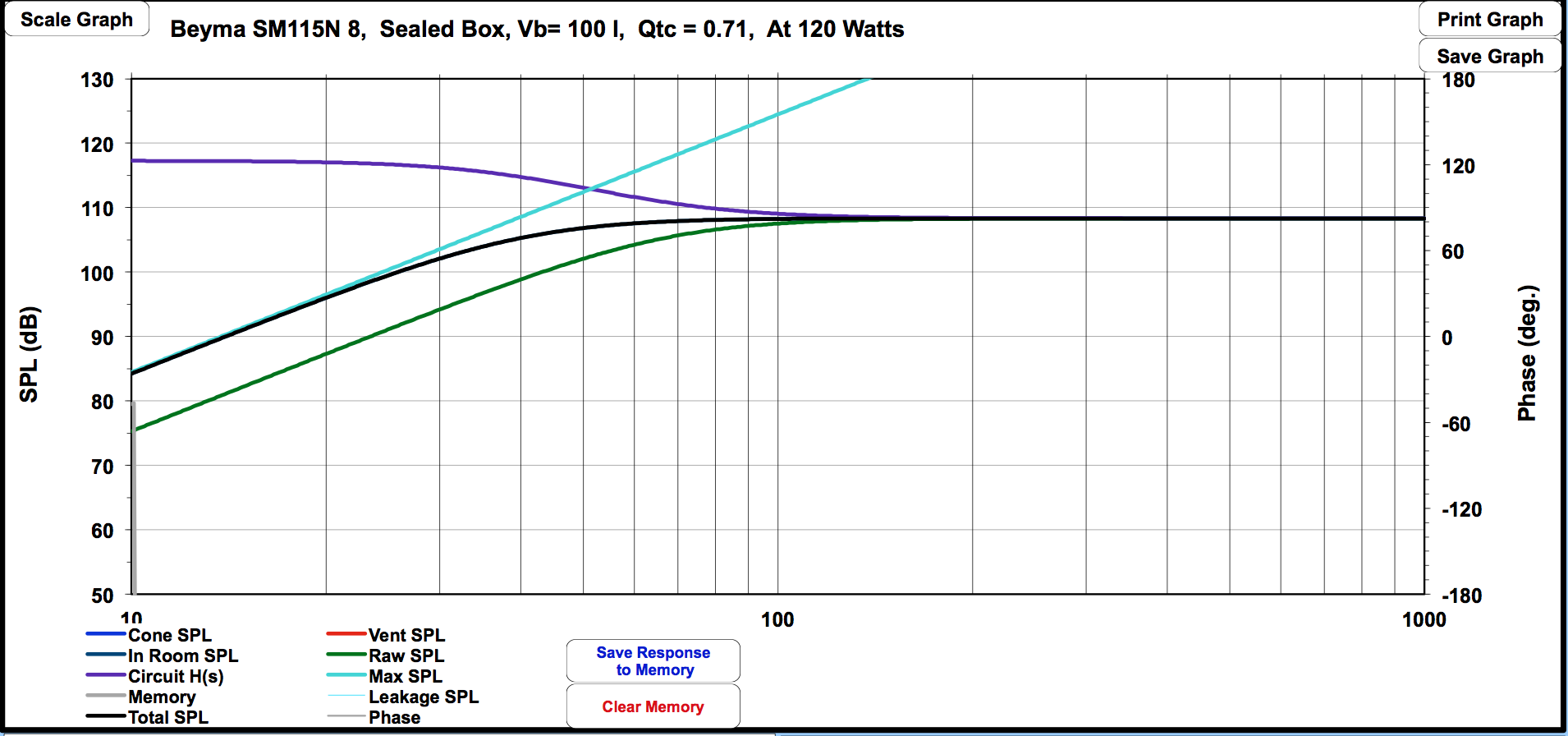

The PD 1550 can produce 105dB when given 600 watts in 27L
The Beyma SM115 can also produce 105dB but with 120w in 100 litres

Beyma SM115 vented in 150L tuned to 29Hz with 30Hz highpass produces 115dB with 100 watts
The roll off is quite gentle for a vented cab and the group delay and phase may be able to be "fixed" somewhat with FIR.
The PD18N02 can produce 113dB but it needs 1600 watts to get there!
For me the PD1550 is almost 100EUR more than the Beyma and feeding it 600 watts to get 105dB isn't something I want to do, others may disagree.
The reason I will probably choose the Beyma is that it is flexible and can work in sealed or vented so I can try out the different options to see what I prefer as all the theory is great but the proof will be in the building and listening to the output 🙂

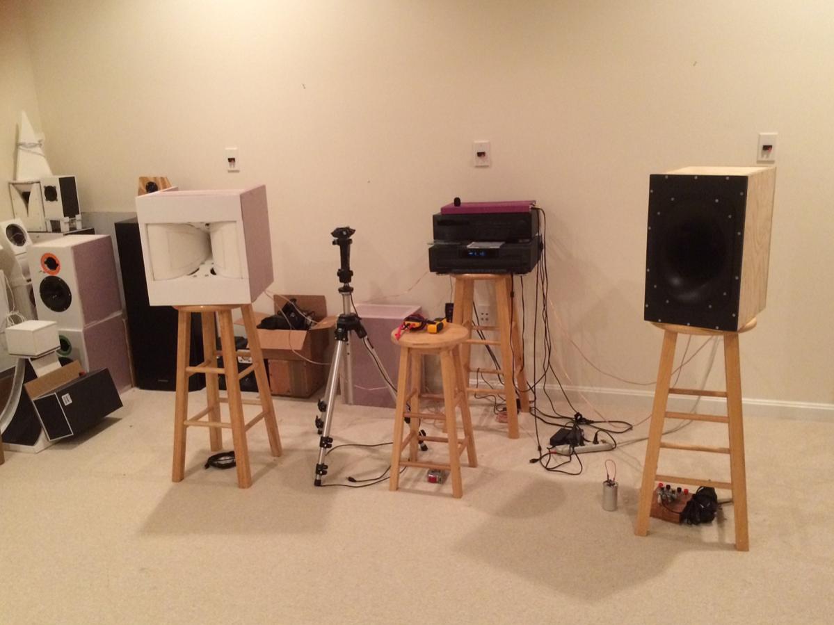

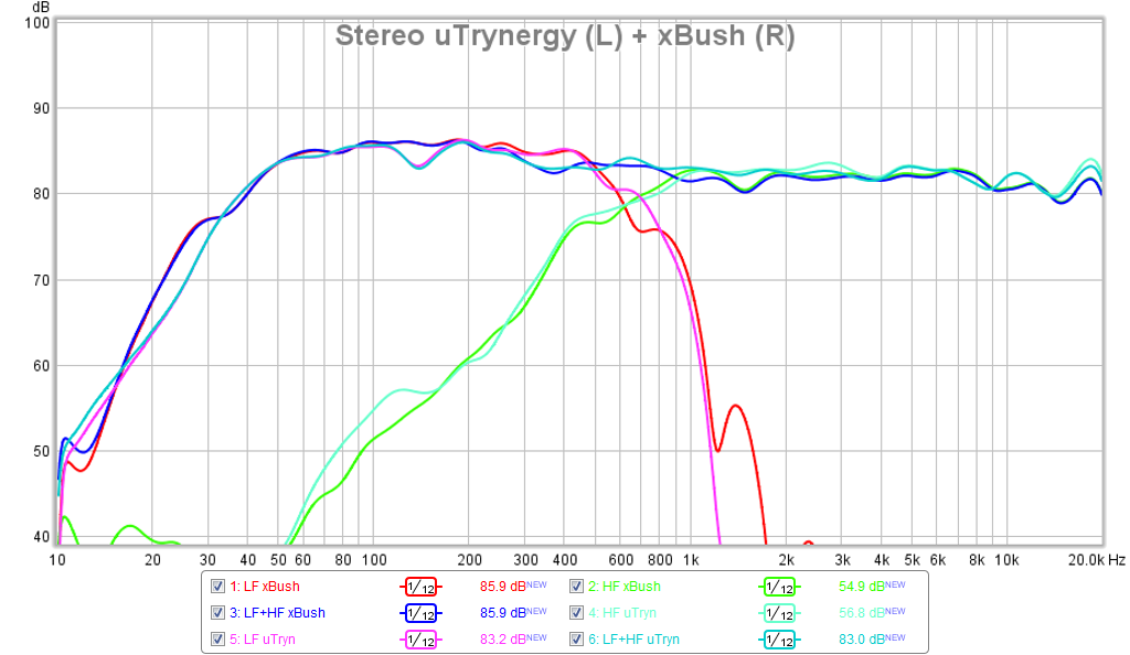

Stereo, sort of, with uTrynergy and xBush
I have a micro Trynergy (uTrynergy) on the left channel EQ'd to have the same response as the xBush point source horn on the right channel. It sounds quite integrated with good stereo imaging and sound stage. Both are tractrix horns with about the same pattern. I am listening to several test tracks and just enjoying it. Nice to have stereo, even if not perfectly symmetric (level wise and frequency response, and time alignment though, they are matched). Through total coincidence, the speaker centerline heights are matched within 1 inch so the height works out just fine.

Yes, the distortion is much improved with the new drivers. It is about 1% at 80Hz at normal listening SPL's of circa 82dB. Not crazy good like yours which was I think 1% at 100dB. The main thing is that several of the really nasty peaks like the one at 104Hz (mostly 3rd harmonic) went away completely - so that must have been some wierd thing with the driver and not the cabinet. It's about 3% at 50Hz. The original design goal of this speaker was to handle bass down to 80Hz, and I think it has almost done that - I say almost because ideally, I would have liked to see 1% at 90dB. The rest above is fine and typical of the HD I showed earlier for the SB65. The left channel uses four buyout $8 5.25in woofers, so the HD there is higher than the nicer RS180P's.

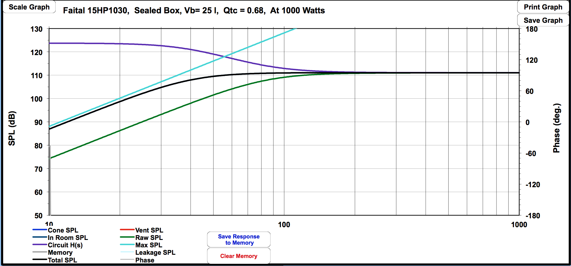

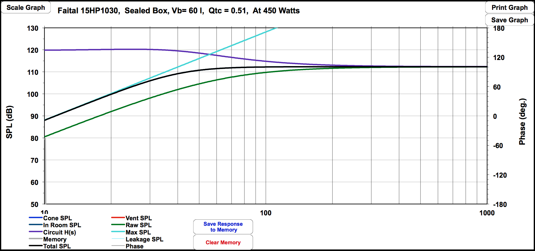

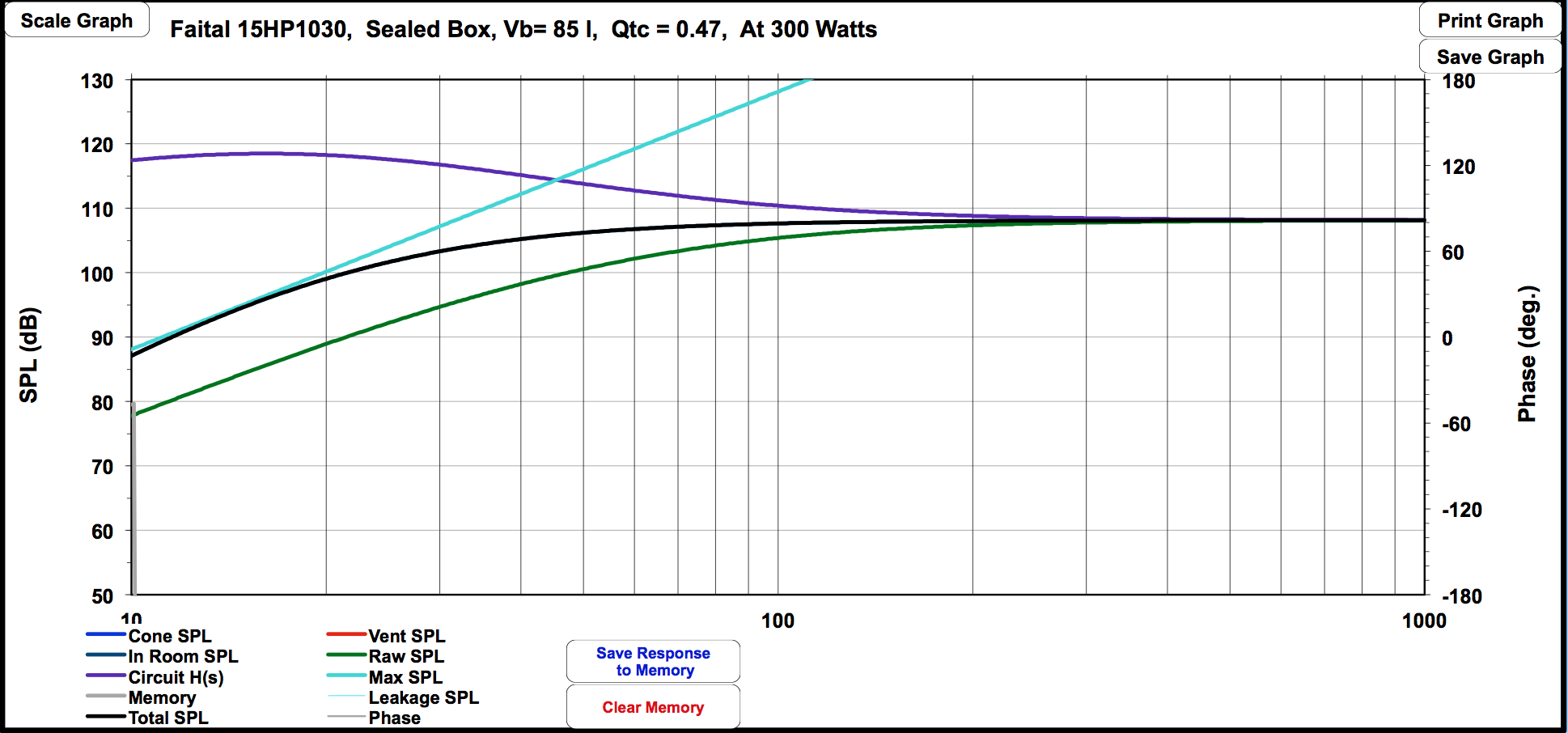

I have put the Faital Woofer through Woofer designer and attached the PDF's here so you can compare them against the others with the same LT parameters. I have done a small cab at 25 litres and two larger ones at 60 and 85 litres to show the difference. 60 litres gives a Q of 0.5 which is also another popular target.
Basically the larger the cab the less power you need to reach the same target so X's suggestion of 2 to 3 cubic feet (roughly between 60 and 85 litres) makes a lot of sense if you are going to use a Linkwitz Transform.
25 Litre
60 Litre
85 Litre 20 Hz Q=0.5 LT with 6dB Butterworth High pass at 20Hz
This gives about 105dB at 300W and flat extension towards 20Hz which is about as far as you can take this drive in a sealed cab with LT.
Takes 1000w in 25 litres and only 450w and 300w at 85 litres. The same would apply to the PD woofer. The faital has a fairly sharp dip in response at around 375Hz but otherwise the response is pretty good. The Faital's greater xmax gets about 5dB more output when maxed out so is probably the better choice of the two for this use.

I think the sealed cabinet either has internal modes that re-radiate through the cone and this may cause increased HD, or the excessive pressure causes the motor assembly making it travel non-linearly in the magnetic gap, or the cone membrane deform in a non-linear way and that causes increased HD, or possibly, it may be a lot of air pumping around in the rear chamber and that generates sound. But I don't think re-radiation through a couple inches of eggcrate foam and half in ply is a significant contributor to HD.
Sound clips of stereo uTrynergy and xBush horn setup
These are recorded with a Zoom H4 at listening position 7 ft away - so there will be room effects. My room is particularly reverberant. I have been thinking about getting some sound treatment panels one of these days. However, I feel that the controlled directivity of the horns has actually reduced the effect of the room versus a direct radiator speaker from the same position.
