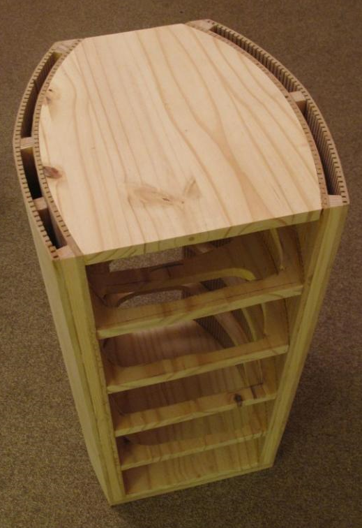

How did a DCR enter into this? If you are talking about this one with the TC9FD, it does indeed have low and level HD (no broad peak at circa 60 to 80Hz like most of my sealed boxes) but I thought that was mostly because it was measured at a small signal level of 72dB (which was about the volume I intended to use it at as a nearfield). Byrtt actually has this speaker now but has put a 10F/8424 in it as a "holder" for his transient perfect FAST system with a Monacor woofer.
http://www.diyaudio.com/forums/full-range/252627-viva-la-vifa-curvy-cabinet-dcr-tc9fd.html
Here was the HD from the TC9FD DCR - I never knew DCR's had the potential for lower HD:

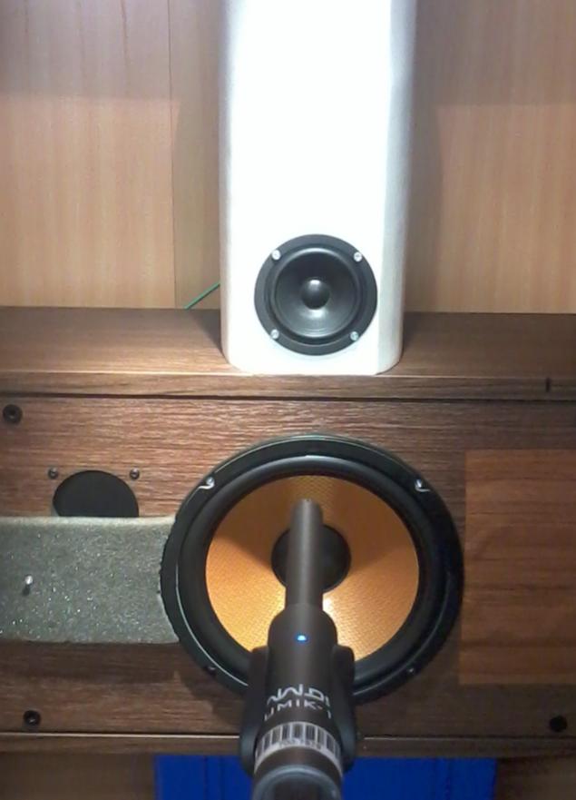

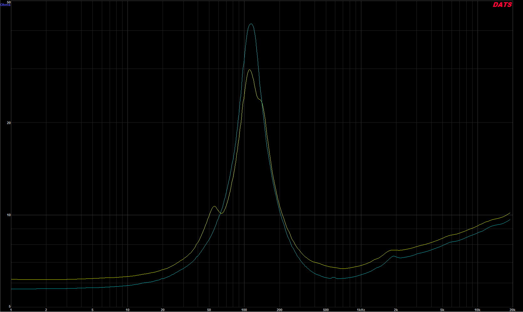

Yes thanks and lucky me they flew far east from US without any sign of jet lag, a 10F into that enclosure have nearly same main resonance as in free air as seen below where blue is free air and yellow is DCR.
Could be wrong but from discussions regarding use of sealed box for low frq duty say 200Hz and below where some air will be moved compared to higher frq it could look like don't go high Q alignment, still its possible to use smaller volumes this way but drivers TS data need to support smaller volume.

You have a great point here, and I forgot to do it in this case - but always a good idea to model the driver in a standalone rear sealed chamber of equivalent volume as intended use in whatever alignment on front of cone (such as band pass) to see how the driver's TS parameters deal with smaller volume from looking at the Q overshoot. In some cases I was using that overshoot and massaged it with a high pass filter that would then bring up the SPL efficiency at the bass around 90Hz. On paper that works but in practice it is forcing driver to operate in a place it doesn't like with lots of air pressure compression and concomitant higher distortion of stuffing a driver in too small a box.

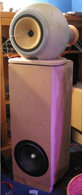

So. I painted up the second speaker this evening. I have been listening in stereo for the last few hours.
I have got some pretty good DIY speakers to compare these to. I have the high end sealed three ways I made - with SB tweeter/12MU scanspeak mids and scanspeak woofers complemented with multi subs, a few single driver speakers, the WA prestige you can see in the picture above with very high end drivers and have had numerous shop bought 'Hi-Fi' speakers and studio monitors such as the Focal CMS....that is where I am coming from...
I have experienced high fidelity, and many times experienced the 'they are here' phenomenon - i.e. the band is in the room etc.
I have never before experienced to such a degree the 'I am there' feeling.
If you have the space for these speakers - I admit these are not 'bookshelf' speakers! - these are really something quite special.
Every recording I listen to, I can hear the venue, the recording process etc. etc. greater than ever before.
I don't know if it is the excellent phase, step response, controlled directivity - removing the room effects, low HD from 30 Hz right up, or the point source behavior of the synergy design, but these speakers are amazing.
If I listen to a recording made in a large space and close my eyes, I am there. The detail retrieval is amazing - I am comparing these things to the Volt VM752 domes and scanspeak 12MU mids directly...
I was only going to listen for 30 mins or so to get an idea of the sound, I am still here two hours later.
Seriously. I am blown away. I also am now seriously doubting the need for a sub cabinet. The bass is extraordinary.
OK I gotta get back to my albums. 😀
It's all of the above all together in one package. Still quite a compact package when compared to what you are contrasting them to.
Congratulations on an awesome build and in record time for a first-off prototype built from plans cobbled together in real-time. I thought they would sound good but that is so cool that you think they sound better than all your other speakers!
Well done man. 🙂
:cheers:
One more thought: I wonder how much of the "you are there" feeling is the flat phase and quasi transient perfect Harsch XO. If you were to switch to a traditional LR XO that you would have used otherwise, how much of the magic is lost (or still there)? Don't have to do it right away - enjoy your new creations for a while. You deserve it.
Happy listening.
