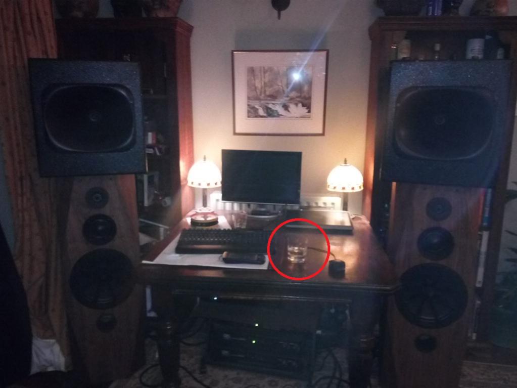

So. I painted up the second speaker this evening. I have been listening in stereo for the last few hours.
I have got some pretty good DIY speakers to compare these to. I have the high end sealed three ways I made - with SB tweeter/12MU scanspeak mids and scanspeak woofers complemented with multi subs, a few single driver speakers, the WA prestige you can see in the picture above with very high end drivers and have had numerous shop bought 'Hi-Fi' speakers and studio monitors such as the Focal CMS....that is where I am coming from...
I have experienced high fidelity, and many times experienced the 'they are here' phenomenon - i.e. the band is in the room etc.
I have never before experienced to such a degree the 'I am there' feeling.
If you have the space for these speakers - I admit these are not 'bookshelf' speakers! - these are really something quite special.
Every recording I listen to, I can hear the venue, the recording process etc. etc. greater than ever before.
I don't know if it is the excellent phase, step response, controlled directivity - removing the room effects, low HD from 30 Hz right up, or the point source behavior of the synergy design, but these speakers are amazing.
If I listen to a recording made in a large space and close my eyes, I am there. The detail retrieval is amazing - I am comparing these things to the Volt VM752 domes and scanspeak 12MU mids directly...
I was only going to listen for 30 mins or so to get an idea of the sound, I am still here two hours later.
Seriously. I am blown away. I also am now seriously doubting the need for a sub cabinet. The bass is extraordinary.
OK I gotta get back to my albums. 😀

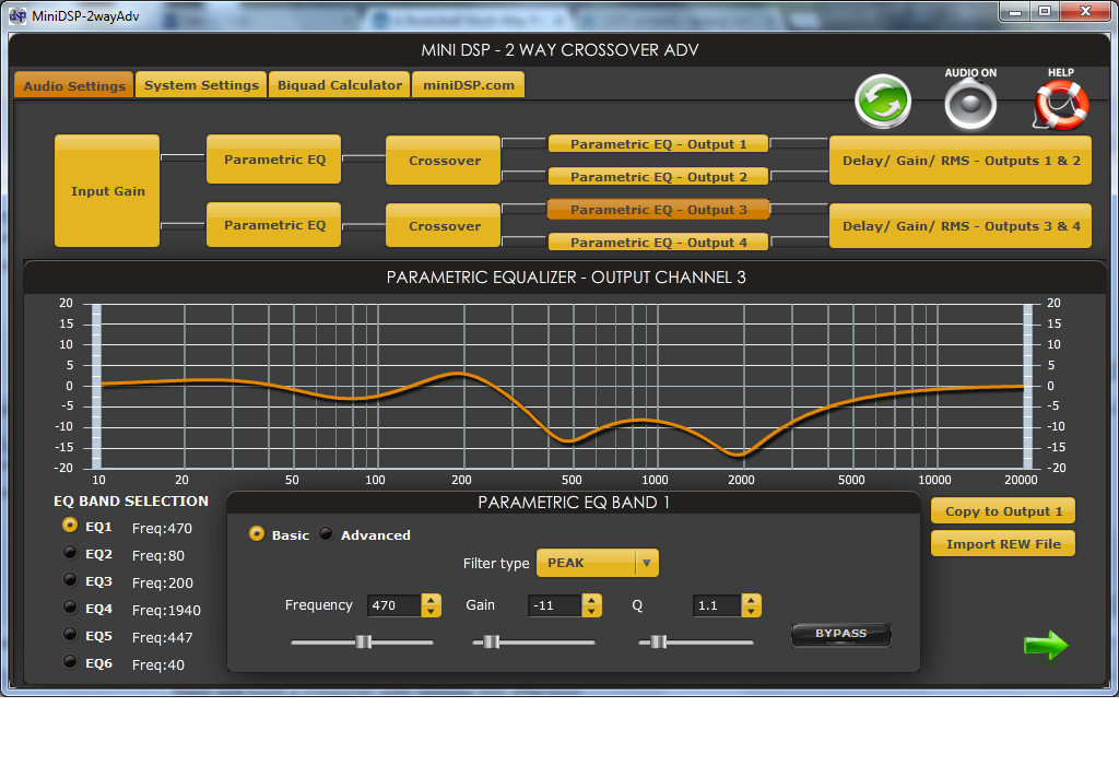

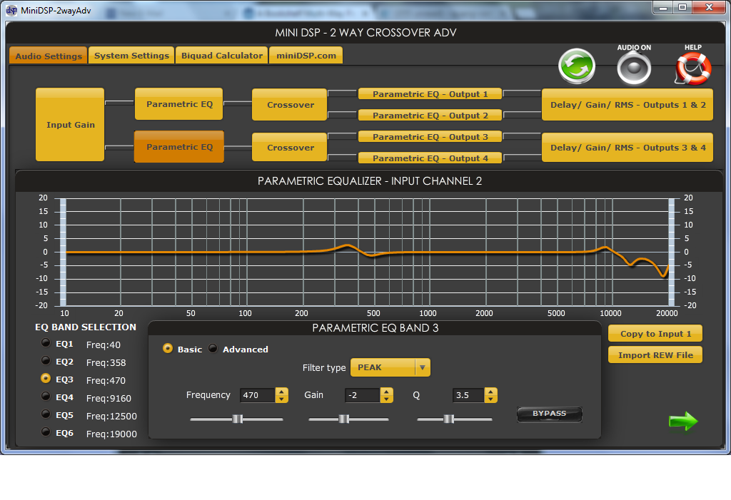

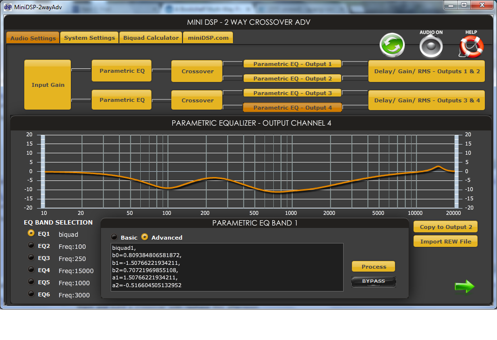

Thanks for the screenshot that makes it much clearer. Do you have a 2.83V or 1 watt measurement with all the EQ applied?
Here are some screenshots of my EQ strategy. I did it all manually via importing the FRD files into PCD and massaging the EQ and XO in simulation and then manually hand typing the EQ and XO settings into miniDSP, followed by just a few very small adjustments by eye on top of that.
RS180P-8 woofers:
SB65WBAC25-4:
Overall applied to both:

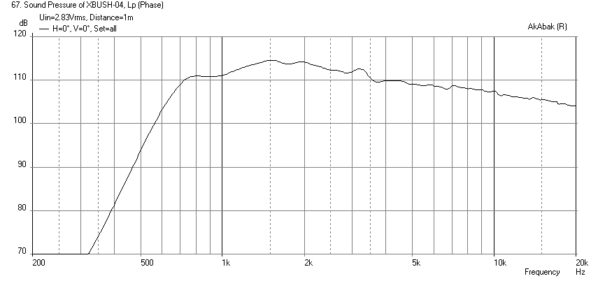

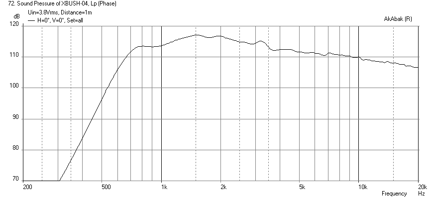

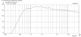

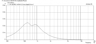

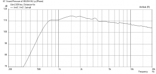

Here is a sim of the SB29RDC in the 18Sound XT1464 waveguide with a 1in long conical adapter to go from the tweeter to the 1.4in throat. I am running a 600Hz BW2 high pass filter to reduce excursion with hopes of a 600Hz XO. I made some assumptions of the tweeter rear drive chamber volume and depth. It might be on the small side...
It looks like it can work down to about 665Hz (-3dB) and give a maximum SPL of 113dB at only 3.8volts drive. Beyond that and you hit xmax.
Here is 2.83v reference SPL vs Freq:

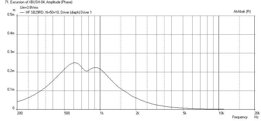

Here is membrane excursion at xmax (3.8v):
Here is SPL corresponding to xmax:
So I suppose, one could try this tweeter with a 670Hz XO and have some success - just be careful with amp power.

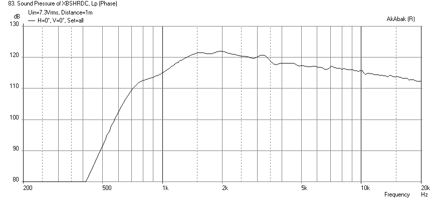

With a more conventional 1200Hz BW2 HPF, you can reach 120dB+ at 7.3v before hitting xmax. The WG is a great way to boost max SPL.

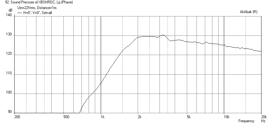

And with a 2000Hz BW4 HPF, you can drive it to 22v before hitting xmax for 129dB max SPL from 2khz on up (this is probably how most people would use this tweeter conventionally without a WG:
