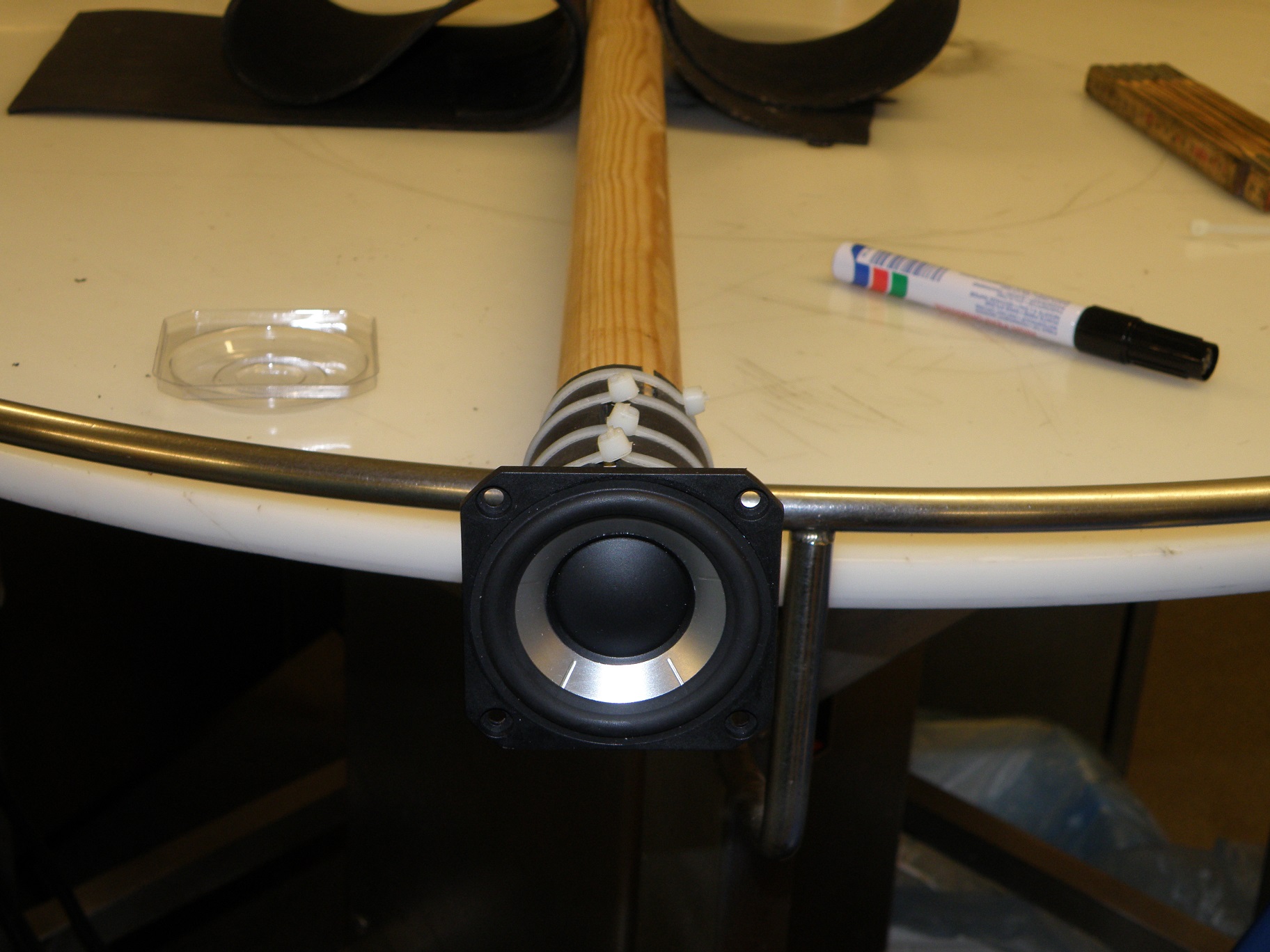

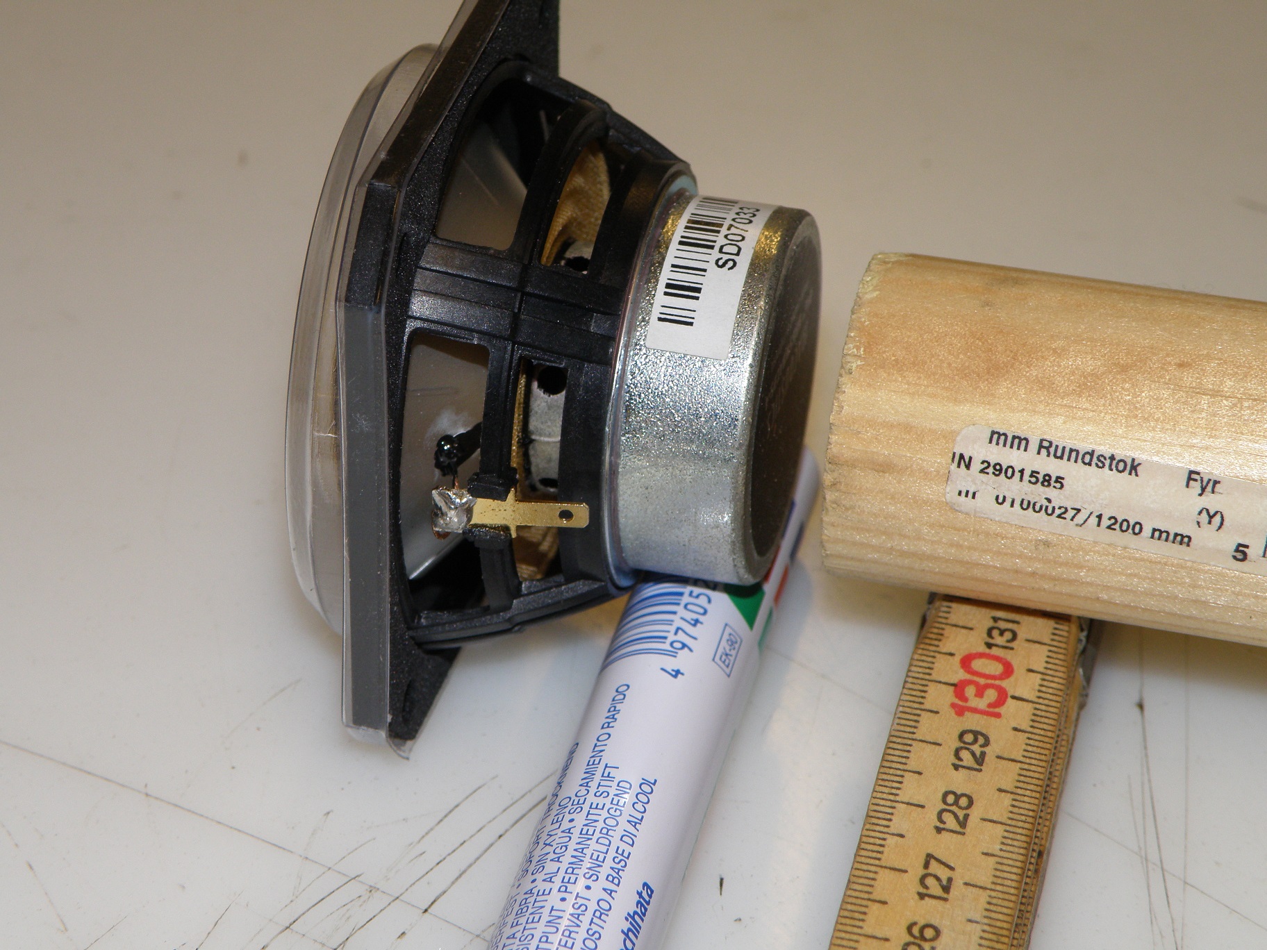

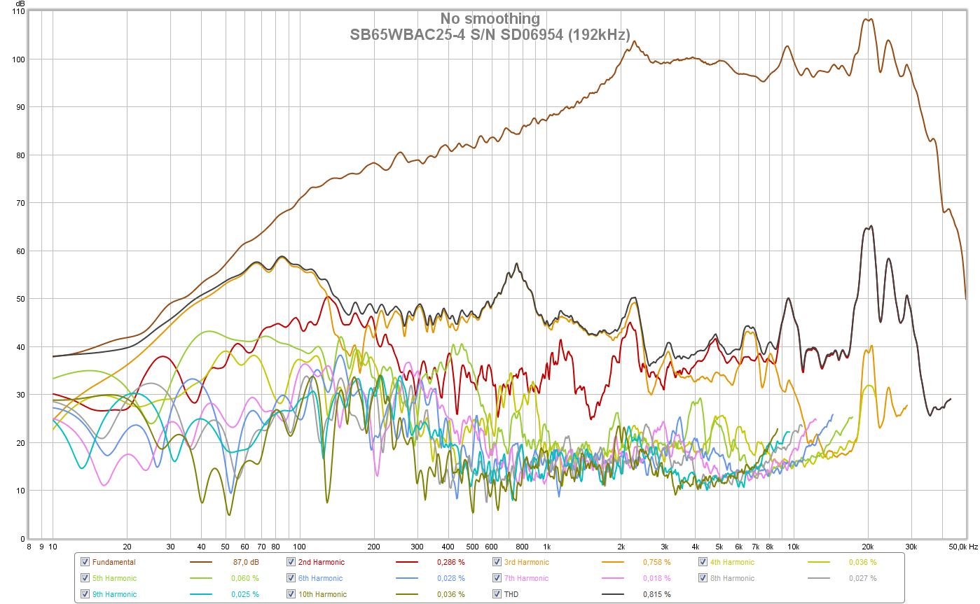

Know i'm not a star anymore but job and life got between, there is light ahead and had just got back from workshop where created below non magnetic flexible rubber interface for SB65WBAC25-4 to mount on a second microphone stand.

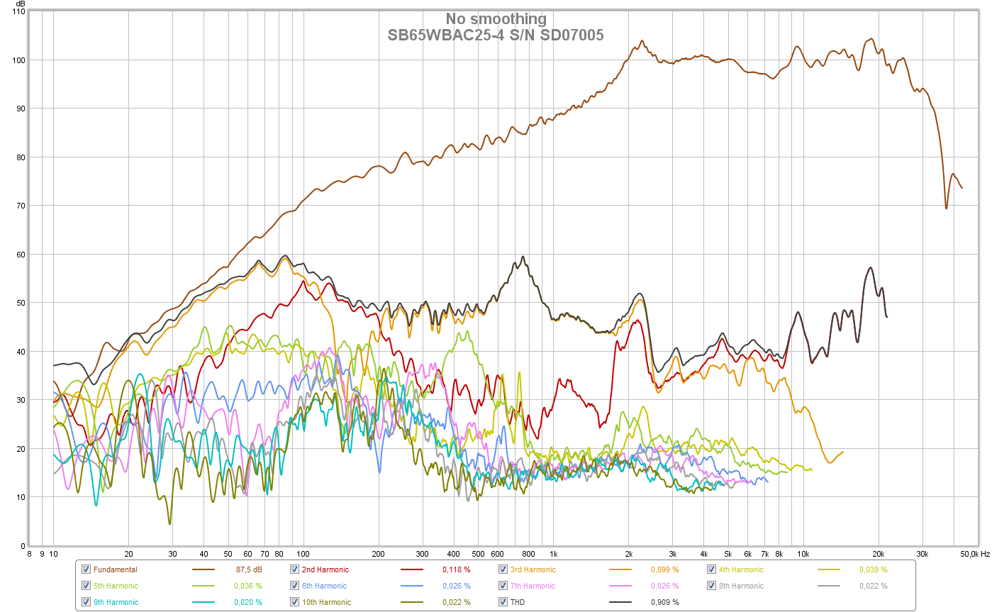

.....Could you just do a quick distortion sweep at 30 cm, naked driver around 90dB?.....

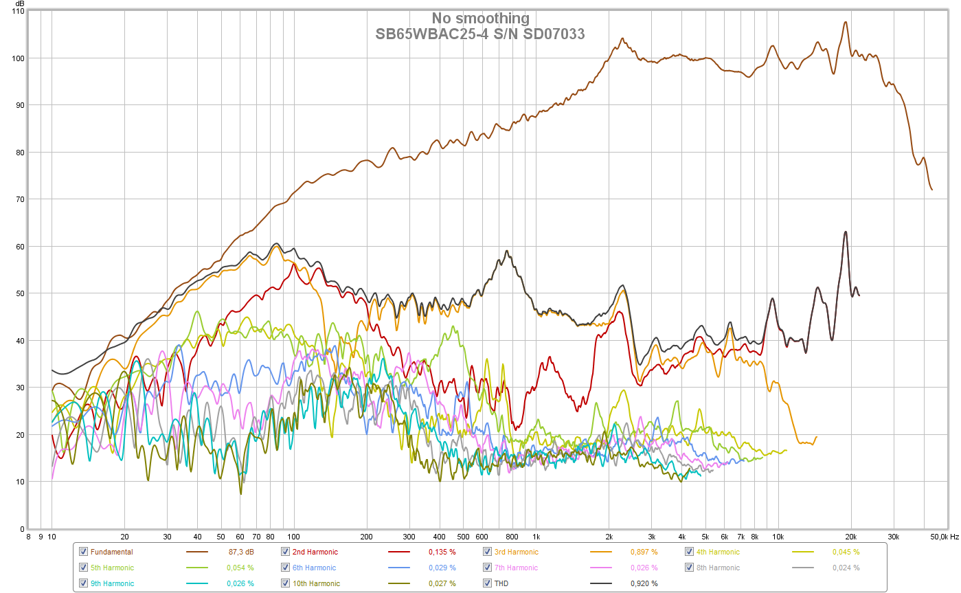

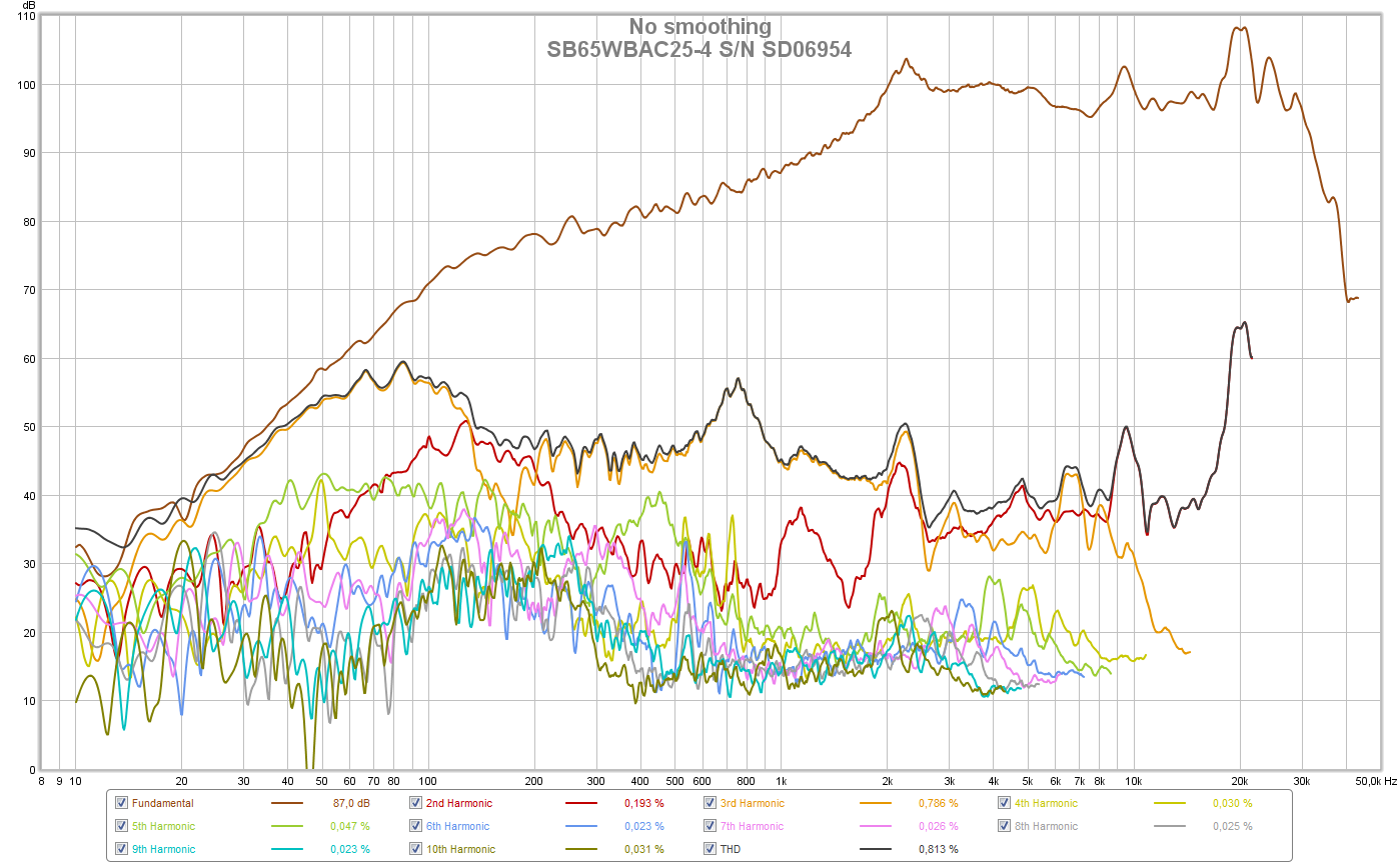

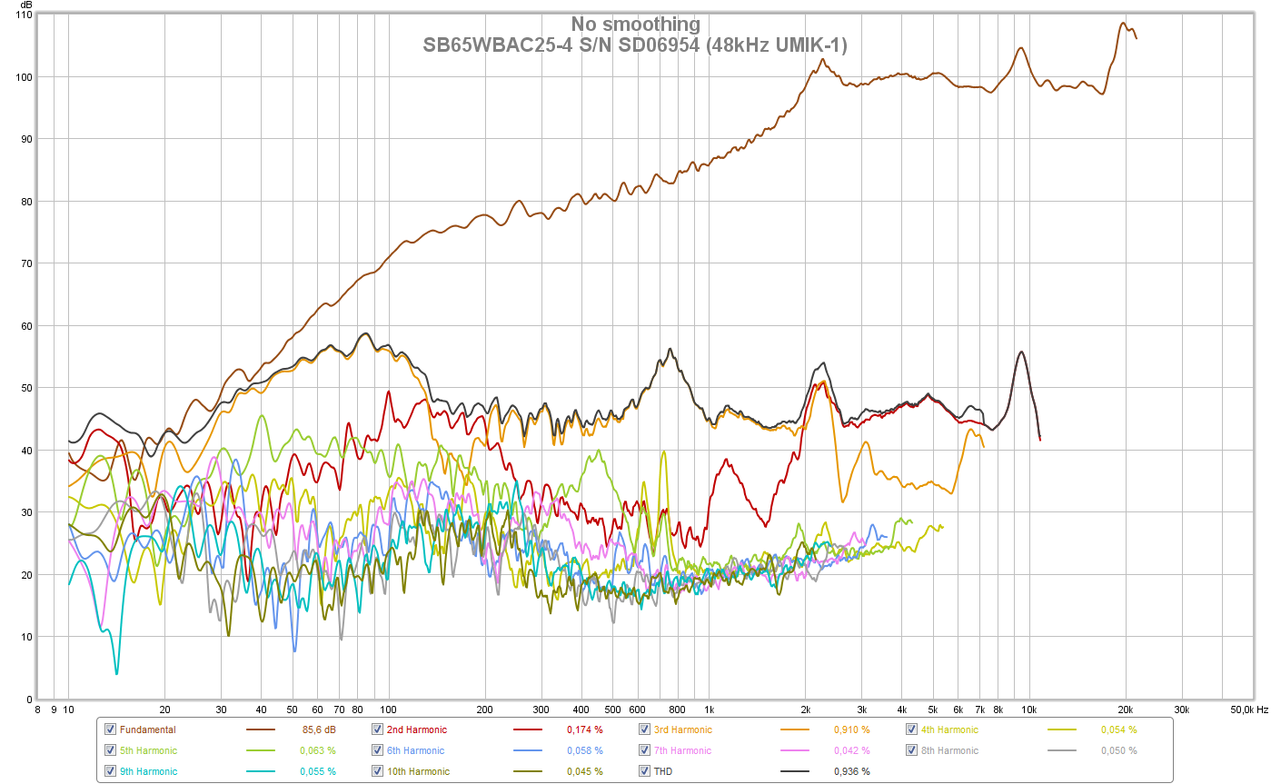

3x SB65WBAC25-4 S/N: SD07005 SD07033 SD06954 mounted as a SL look alike Omni thing way as shown in previous post. First three plots are those drivers measured with new iSEMcon mic at 96kHz via M-Audio AP192, correction file for soundcard I/O and mic is active but mic preamp and power amp had not yet got calibration. Fourth and fifth is same measured driver as third, but fourth is at 192kHz and fifth is UMIK-1 USB mic at 48kHz and a shift to Java/WDM drivers where the first four is ASIO driver. Cursor is at 1kHz at all plots should any read % in legend.

Thanks brytt, you are deffo still a star! Well that confirms it, I think mine is a faulty driver. I will look into getting another.
???.........although his measurements are at higher output, the 7khz is still there as well as an addition nasty peak at 2khz. That fact that each harmonic follows the fundamental by an octave makes his measurements fairly convincing as accurate.
Maybe I'm missing something?
Yep, I think you are.
At the same drive level, the 7kHz peak on mine is only 15dB down. On his it is 50dB down.
My other driver shows the same distortion profile as his.
Hence = likely a faulty driver.
