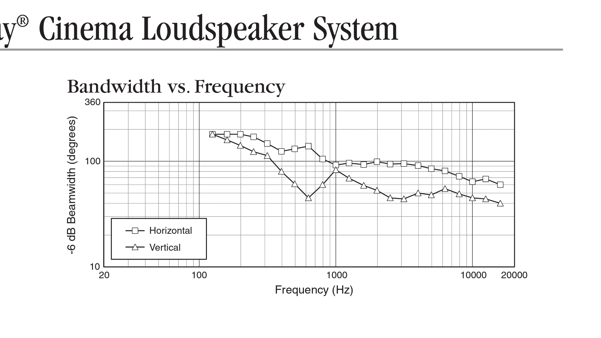

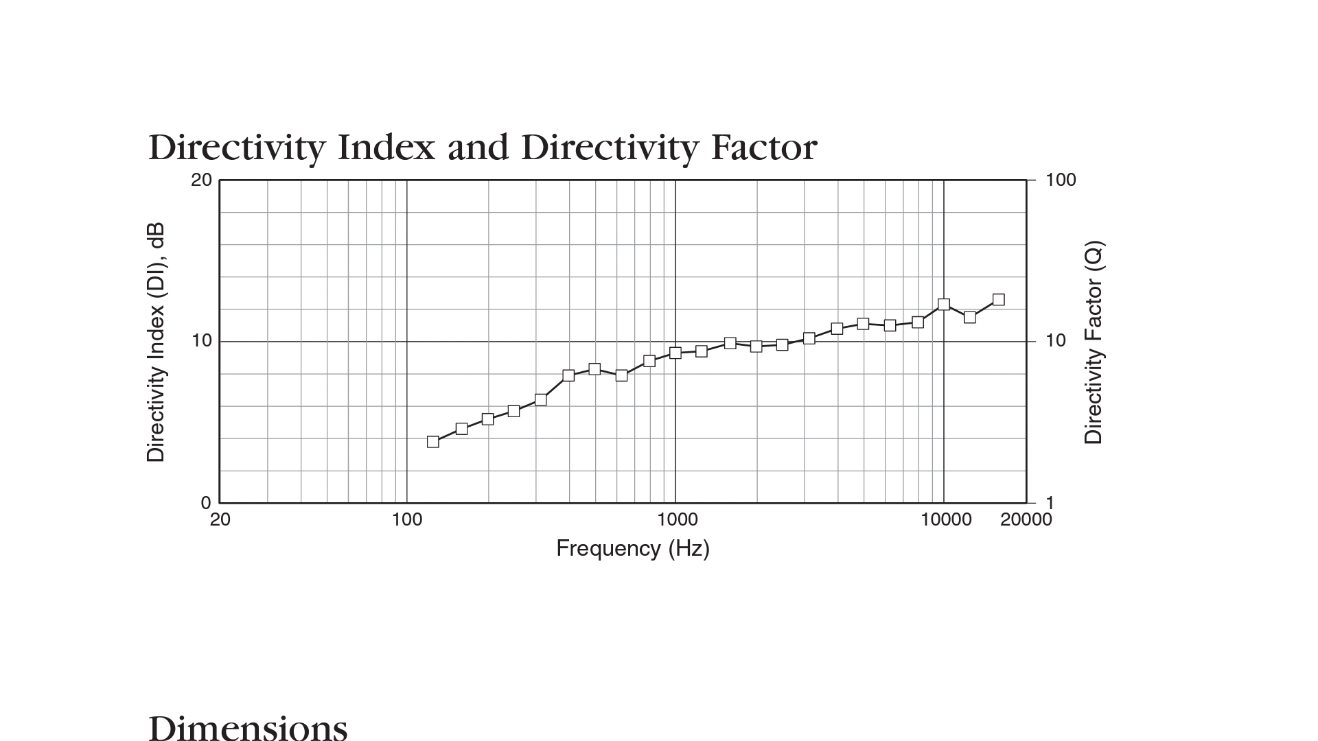

Regarding pattern control, these are from the 4722 datasheet. For a 30in wide waveguide, it doesn't seem to hold pattern that much lower than the 18sound 1464.
Also, it's got a much wider beam width, about 100 degrees, compared to 60 degrees on the 18sound.
JBL 2384
18sound 1464
Sent from my GT-I9505 using Tapatalk

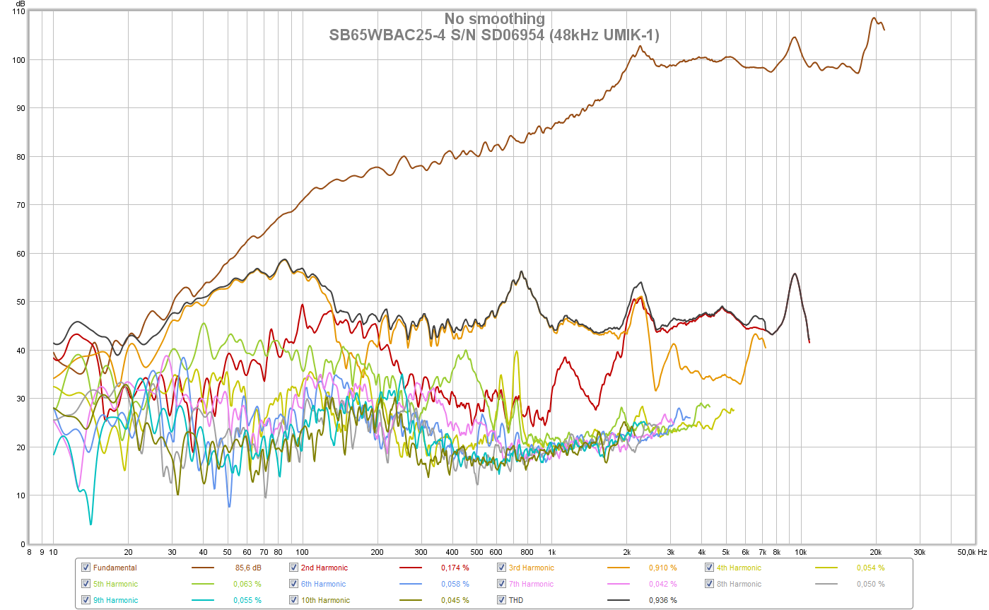

I have run many sims with a bunch of pro and hifi woofers and it turns out that the SB29SNRX45-8 that Bushmeister is using is the best option of you want to reach 30Hz with low distortion. It has the right balance of everything and very low distortion. Pro woofers tend to have too high of an fs and to low of a Qts that bass extension will not be as good.

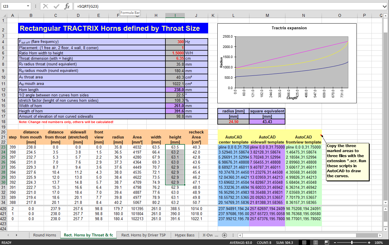

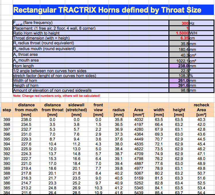

That appears to be the simplified version of the spreadsheet with less resolution. I used the original v1.2a with more fidelity and it has the following output for a 300Hz horn with the 3.5cm throat. There is a small pinch in the curved wall as shown by the highlighted box. Although, the overall cross sectional area still increases, I guess this has to do with fact that one set of walls are flat and expanding.
The original spreadsheet is here:
http://www.volvotreter.de/downloads/tractrix_v1.3a.xls.zip
Here is a screenshot of the spreadsheet:

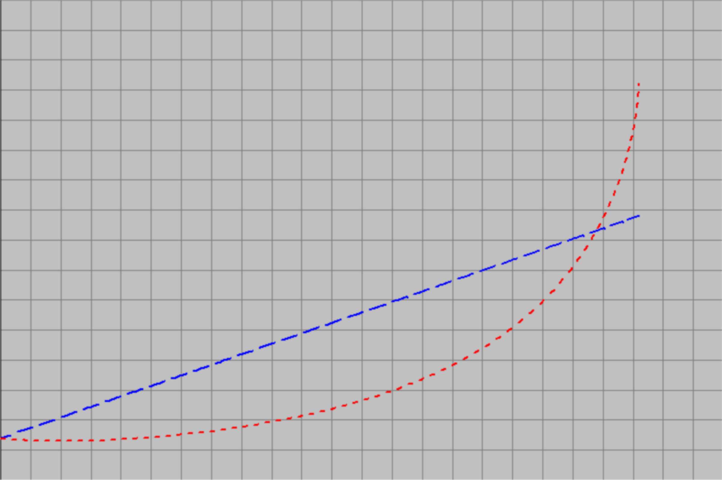

And if you plot it you can see the slight pinch. So when I build them, it starts at the driver throat with a very mild contraction for a few inches then expands:
The above is the actual plot I used as an overlay to superimpose a single spline function in SolidWorks to replicate the tractrix mathematically without entering the complex function in the solid model.
