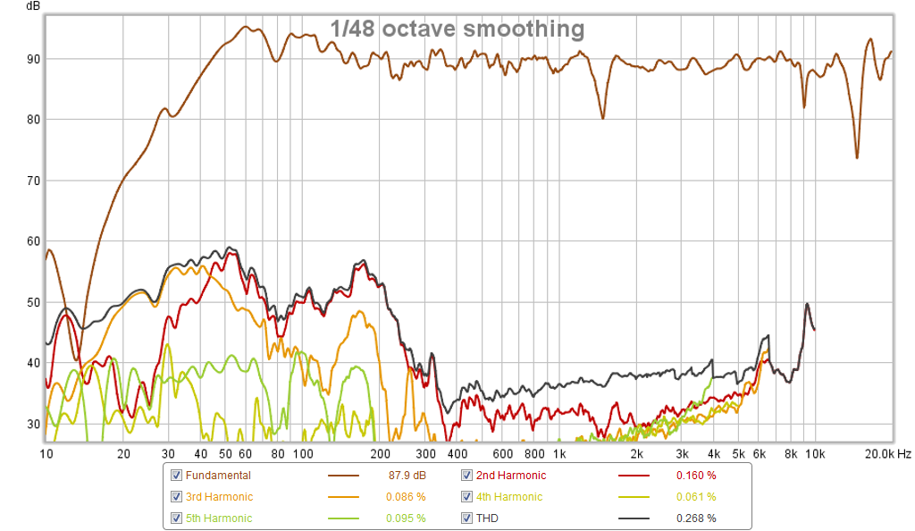

Another measurement of LTH142 and RS180P and SB65WBAC25-4

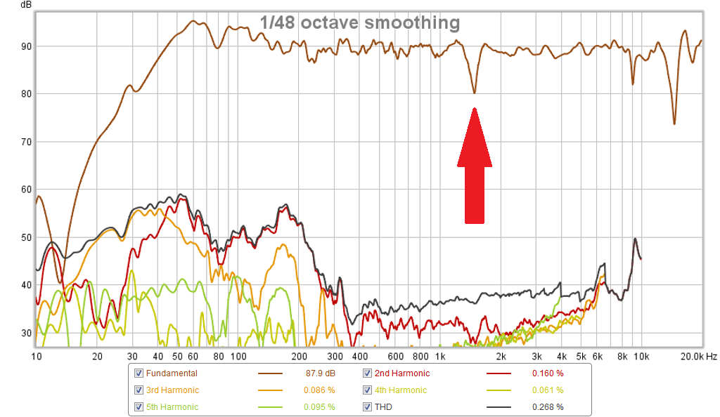

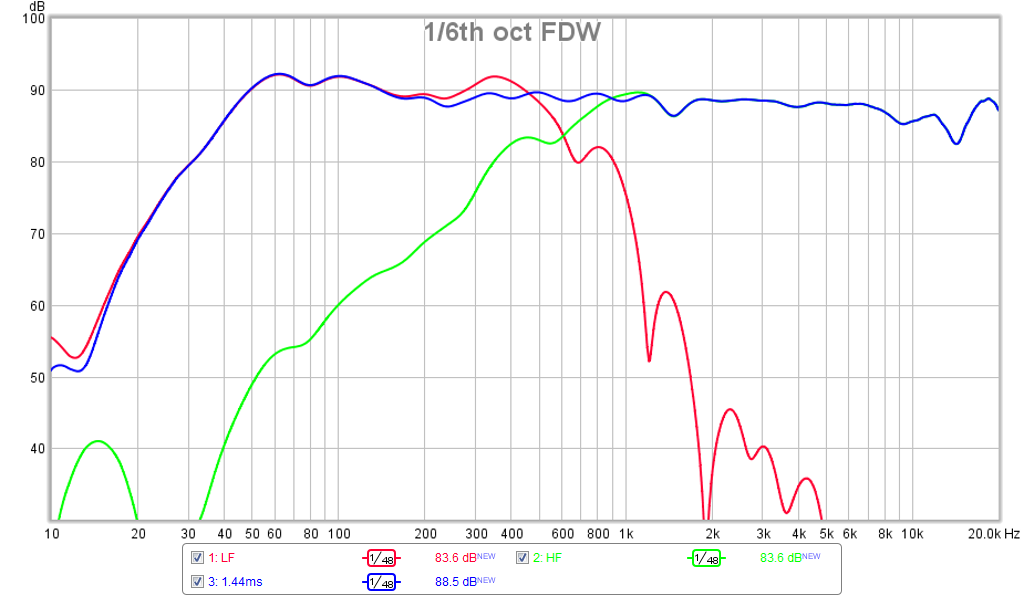

After letting the speaker rest for a couple of weeks, it seems that the glue or something may have cured some more but the measurements are a bit better now. I did switch to a TDA7498 amp with 24v power supply vs the old TPA3116 and 19v but I doubt that was the difference. The Harsch XO seems a little better now but I still can't get a flat phase with 55 deg bump. Also the step function of the woofer appears to have a negative rarefaction followed by the compression pulse which the mid/tweet rides on.

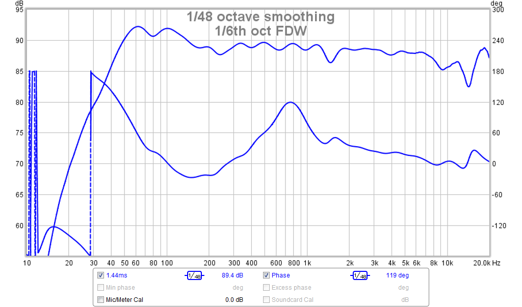

XO plot:
Phase (I settled on a 1.44ms delay of the SB65 behind the woofers):

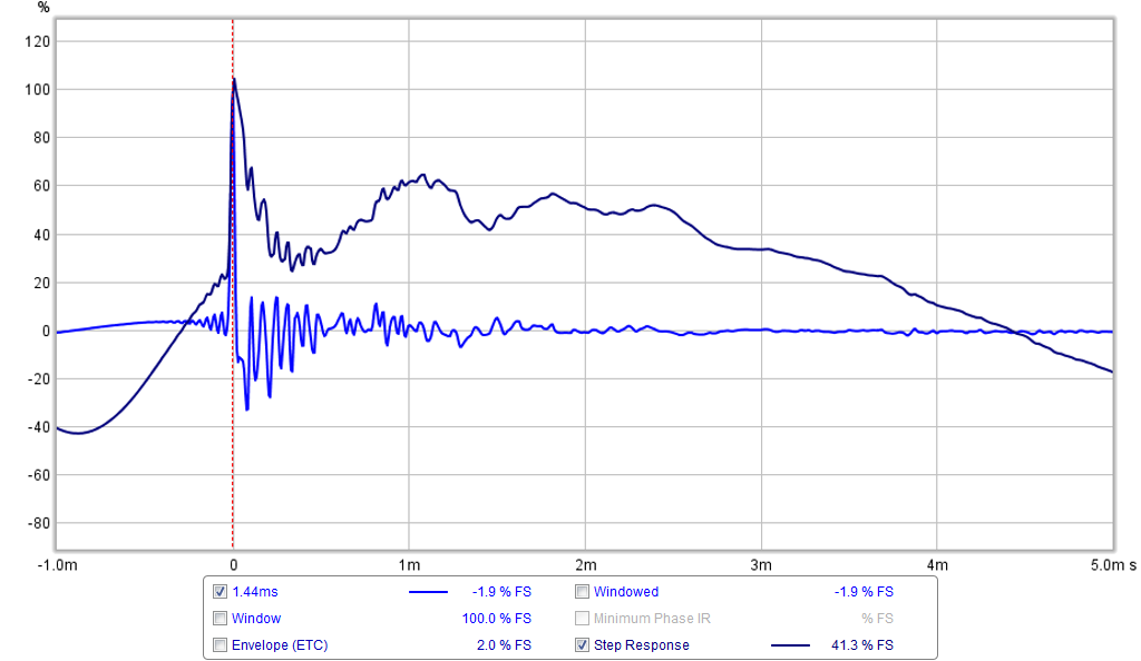

IR/SR:
Distortion (at 0.5m and -6dB below 2.83v):
I am listening to it again and sounds very good on drums, stand up bass, guitar, and piano.
Xrk971,
It looks like the delay and filters you are using is putting the HF almost one wavelength behind the bandpass woofer, resulting in the "up and down" phase changes through the crossover region.
The offset horn bandpass introduces a phase lag compared to the "normal" horn phase response of the HF (which is also different than the phase response of the front loaded drivers that the Harsch crossover is designed for).
The HF location physically behind the bandpass mids should result in a near flat phase response through the crossover region using symmetrical filters and no (or very little) delay on either the HF or LF.
It is possible to achieve flat (or smooth) phase through the crossover region in this type of design with passive components and no delay. In your horn since the woofer ports are a bit closer to the mouth compared to the usual location closer to the throat, the woofer may need a fraction of a ms to phase align through the crossover region.
Art

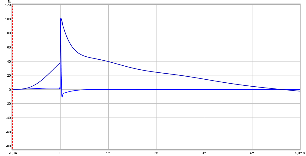

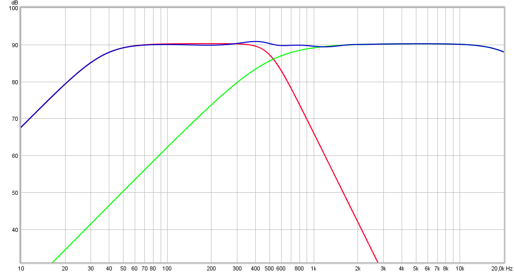

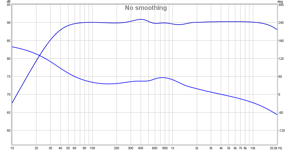

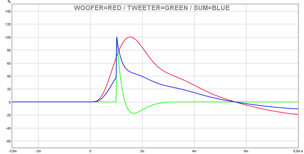

xrk971,
Some comparison plots in same X Y scales as yours, system stopbands set as BW2 at 37Hz/22kHz, HARSCH XO point 500Hz tweeter delayed 1mS.
SR starting over 40% negative looks like you have got a FIR filter turned on : ) have you any strange setting in miniDSP that belong to another setup that by accident is turned on.
Low pass slope for woofers is not special smooth it looks like three notches (360Hz/800Hz/1,4kHz) probably from symmetric band pass port, have you any PEQ's left to smooth them a bit.

Xrk971,
Art
Agreed with all of this above. I tend to pack my mids a lot closer than Danely does, and since I generally use direct radiators instead of compression drivers, I don't have the delay that's introduced in the throat of the compression driver itself. The steps mentioned by Art work for me.
Another one, that's a bit annoying, is that some manufacturers mislabel the positive and negative. So take a look at the impulse response of each driver and verify that what's labeled "positive" actually produces a positive spike in the measured impulse response.
There is something strange going on with my bandpass setup. The first pulse is followed by a larger negative pulse - so my thinking was to get the most impact I would align the tweeter with the second pulse by flipping the polarity of the woofer and delaying it an additional time period. This is why the leading edge has got a negative offset. This is the residual first pulse of the woofer which is the opposite sense. I tried time aligning with the first and it sounds better with the second. I don't have any wierd settings in miniDSP causing this. It is present when running full range with just an amp and removing miniDSP. It may be the extra long duct from the driver to the horn and maybe having the small holes act as an impedance mass loading of the duct. I did not model this detail of system so I don't have the multiple pulse in the sims. Cutting a bigger hole in the horn wall may fix this.
