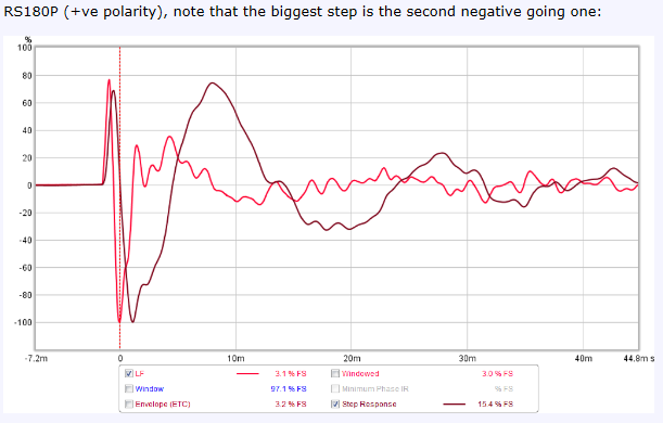

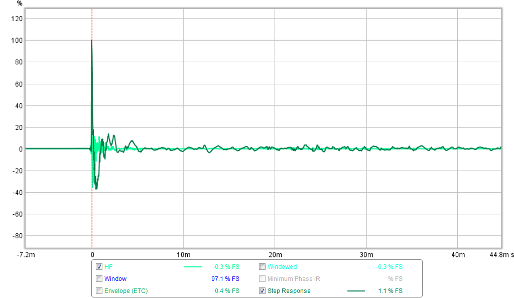

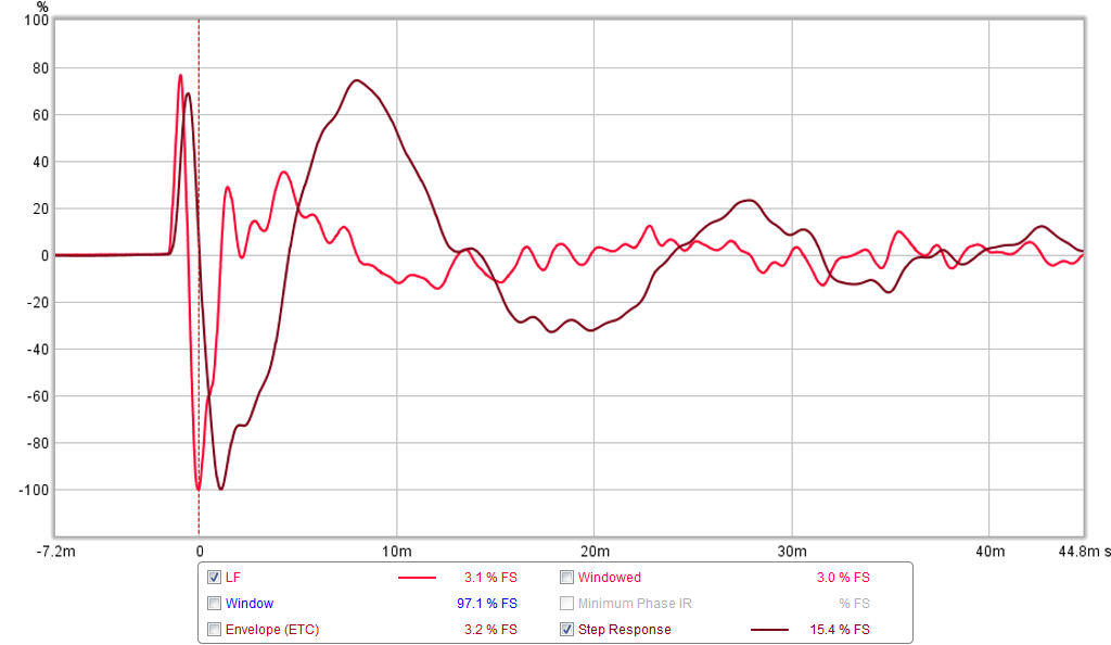

So here are longer time scales for the IR/SR plots for the individual drivers.
RS180P (+ve polarity), note that the biggest step is the second negative going one:
SB65 (+ve polarity):
SB65 (+ve) and RS180P (-ve) and time delayed to hit the second, but bigger pulse:
I guess this is not the way to do it... Anyhow, that's why my delay is so much longer. If I go back to aligning it with the first pulse, it can work but it seems like the second rarefaction wave is now overtaking the first compression wave. So this bounce in the step may be caused by the impedance mismatch of having the smaller holes blocking the larger 2in dia duct from the driver? Do you see this bounce? Or it could just be the driver rear chamber is not well matched so the Q is rather high?

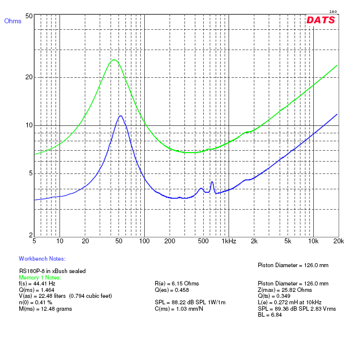

Let me take a DATS impedance sweep...
Here is the sweep of the dual RS180P's in the sealed back horn (blue) vs a bare-driver TS measurement sweep (green). It looks like the fs went up to 50Hz and the Q went up to about 0.7. The small bumps near 500Hz and 600Hz are probably the port resonance peaks.

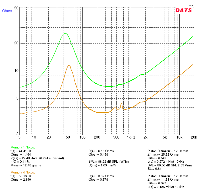

I remeasured the sweep in the sealed speaker (yellow) again with TS measurement enabled to see that the Qt is actually at a very good value of 0.627.
But maybe it is the little port resonances at 470Hz and 640Hz that are causing the multiple oscillations in the step response?
Bushmeister, if you get a chance, can you take an impedance sweep of your SB23 woofers in the enclosure for me to get an comparison?

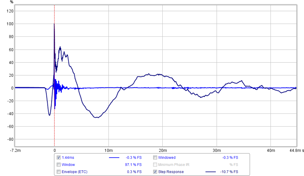

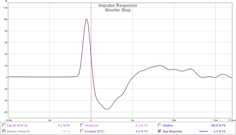

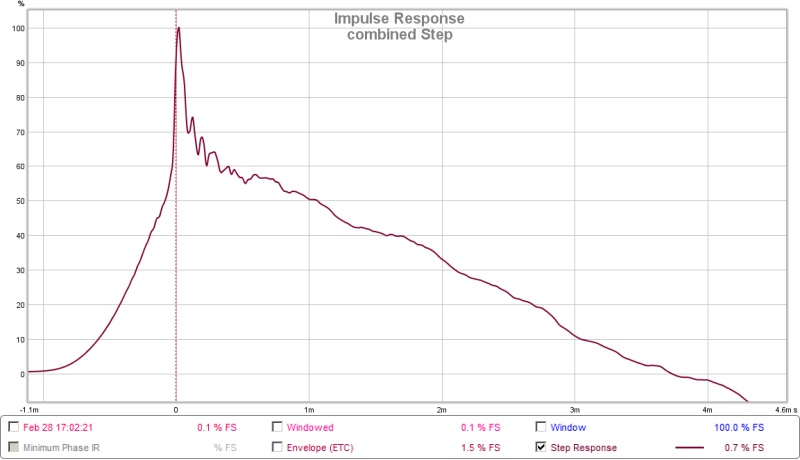

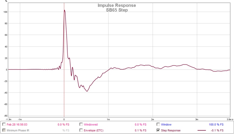

I still have my UMIK-1 to hand so - here are my SR for SB65, SB23 and combined just taken now.

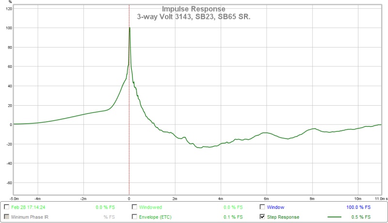

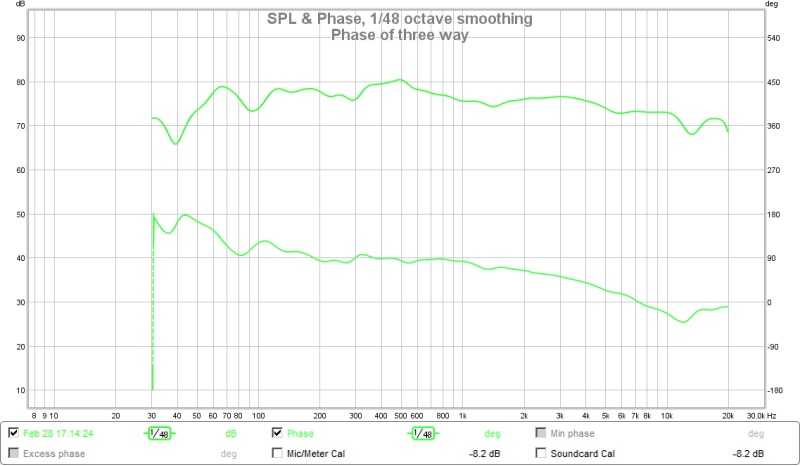

Well here are the measurements with a quick and dirty 3-way harsch x-over at 600 and 90 hz.
So far, despite the 4 SB23's being able to play happily down low and with a fairly decent VD - this is 4x8 inch drivers after all, the difference is like night and day.
There simply is no replacement for displacement......

Step in third plot is fine and near to 4mS, so guess woofer alone in second plot was in three-way mode high passed at 90Hz : )

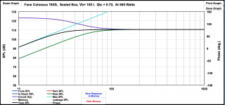

So you can compare against the other drivers I ran the Fane 18XS driver through the same simulation. As this one has a much higher Vas the bigger enclosure is better.
I used 100 litres as this is just over 3.5 cu ft. With 600 W and a Linkwitz transform to 30Hz with Q 0.7 the output is around 110dB at 100Hz. You can use 20Hz and 0.5 but you lose about 7dB of maximum output and need more power.
This driver seems to work quite well compared to the others and the truncated frame makes it not that much bigger across the width.

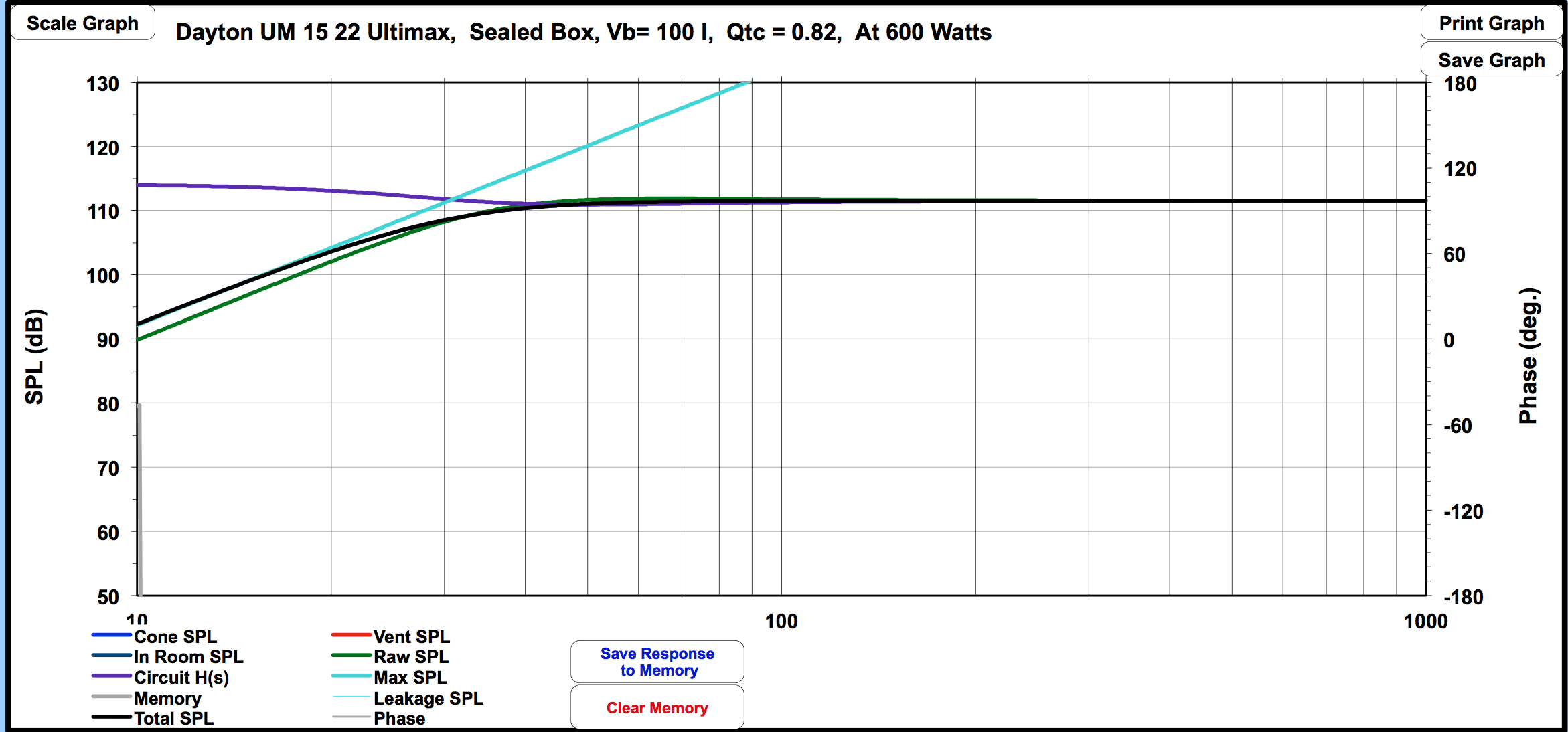

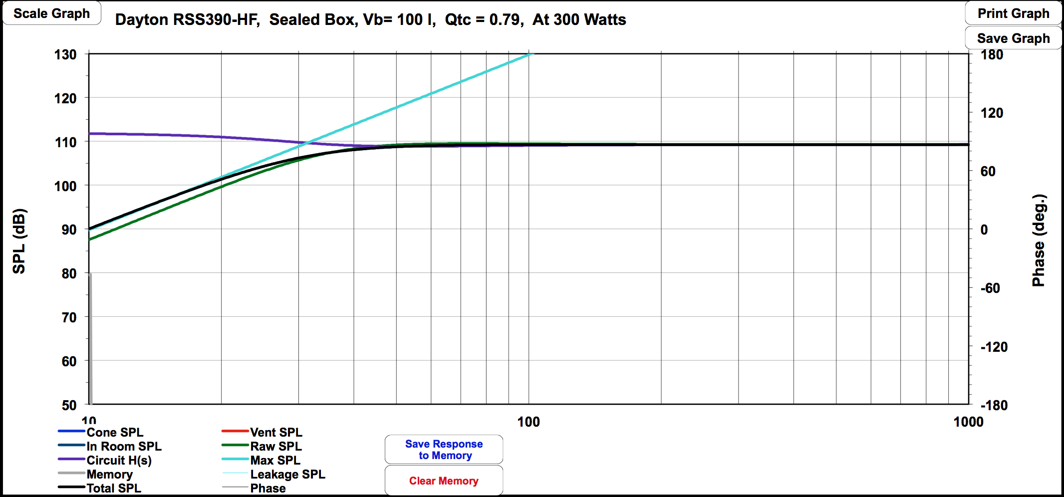

Here is the Dayton UM15 22 for comparison. They are pretty much the same. If you could give the Dayton a bigger cabinet then it would take less power to get the same result.
They are both xmax limited to about 104dB at 20 Hz so a linkwitz transform will give the same result for either. As you can see the Dayton needs less EQ but the outcome is the same.

Thanks for the comparison of the Fane vs UM15. To me they seem very different but I guess when asked to get the same bass SPL at a given frequency down low they seem similar. However I would add that the the Fane is a woofer capable of higher frequencies and has a light cone. So the dynamics may sound very different. I think for better transients, the Fane will have the advantage.
I agree with you that the drivers themselves are worlds apart. What I should have said is that when EQ'd with the same linkwitz transform the output is very similar i.e. their xmax limited output is basically the same.
The ultimax is much more of a home theatre sub with a lower Fs and needs less EQ to reach it's maximum output.
These simulations don't take into consideration frequency response or any other variables so no doubt even though they sim the same the actual results will be different.
Either will work well in about 100 litres with about 600w of power to get the most output. I would also choose the Fane. Also I don't think the ultimax cone and huge rubber surround would really go visually with the horn above.
The RS390 HF with the aluminium cone would be a better match and only needs 300w in 100 litres to come pretty close.
