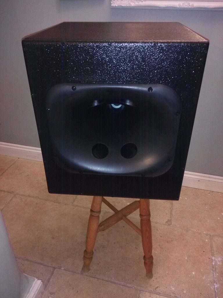

So, I have been playing.
Seeing as I am using some very expensive speakers as stands for the full range driver synergies at the moment (see my pictures earlier).
I thought I could use the Volt 3143 12" woofers in those speakers to see whether relieving the SB23's of the heavy lifting and crossing them over to the volt woofers at about 90Hz would make a difference to the sound.
Well here are the measurements with a quick and dirty 3-way harsch x-over at 600 and 90 hz.
So far, despite the 4 SB23's being able to play happily down low and with a fairly decent VD - this is 4x8 inch drivers after all, the difference is like night and day.
There simply is no replacement for displacement......
So I am thinking bring on the um15-22's......

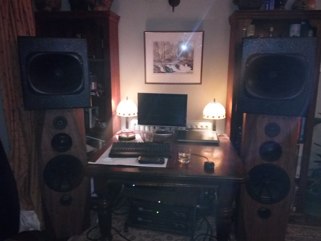

OK. So as you know, I have a few nice speakers for direct comparison -
One uses the scanspeak 12MU for the mid (the most important driver in a 3-way in my opinion), and one the Volt VM752 - both speakers are optimized as far as I can take them with sorbothane, extensive bracing, damping etc. etc.
So what amazes me is the sound from these synergies. There is only a few hundred quid of drivers in these things and the sound is incredible.
Don't get me wrong - the three way sealed monitors I designed are excellent 'social, party speakers'. i.e. - they create a very wide sound stage which doesn't collapse off axis - they create a true 'wall of sound'.
But the sound stage is an enveloping kind of 'they are here' which probably is not completely true to the recording, I think largely a result of their very broad, even power response in room:
The larger three-way prestige based speakers (but my own crossovers and cabinet mods), have a less pronounced broad directivity, due to the VM752 being horn loaded and the known beaming of the Scanspeak R2904/7000.09 ring radiator.
These are obviously high resolution units too and a lot of time went into optimizing the cabinets with additional bracing and damping to remove cabinet coloration (a problem with the stock kit enclosure).
However, I still feel our home cooked Xbush synergy sounded better.....
They are all fabulous speakers, they all sound different as a result of design considerations and I guess a lot of it is down to personal taste....
BUT, without doubt the Xbush synergies have better resolution, sharper imaging, and create a soundscape which moves from 'they are here' to 'I am there' more than the others.
The window into the recording is much more transparent - I can hear the acoustic space in the background of the recording very clearly.
I am almost certain this is due to the absence of diffractions/reflections from the CD the synergy design provides:
However, again it s a choice of design considerations. The sweet spot, particularly for my sealed monitors is almost the whole room, whilst for the Xbush is perhaps a two seater sofa - (although I suspect this is partly due to a restricted maximum listening distance in my room).
So in summary, for selfish single or perhaps two person critical listening, when you want the highest fidelity into the recording, the Xbush reigns supreme.
However, I would not choose them for my living room party speakers, and I would not be allowed to put them there anyway as currently they have virtually zero WAF! (Also an important design consideration in some households...)
So I am awaiting the conversion of my garage into a dedicated listening room. They will likely be repainted, and placed upon a 100L braced cab of similar width/depth housing an 18inch woofer to cover from ~100hz down.
I can then selfishly enjoy some of the most incredible listening experiences I have had, on my own with a nice single malt, without anyone commenting on how 'large they look'.

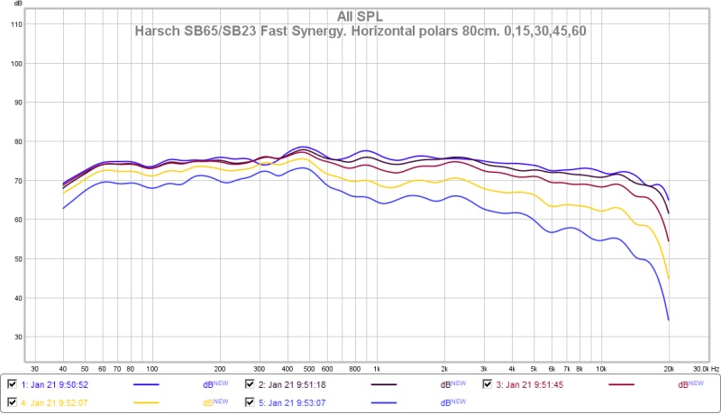

Some observations based on yours:
1) It looks like the effective non-straight-sided coverage angles of your DIY "synergies" is less than 90 degrees horizontally, which should be factored into the width of the sound stage that you're experiencing (two seats). As a point of departure for talking purposes only, the K-402 multiple entry horn does almost 100 degrees horizontally and 60 vertically and it has no limitations of sound stage from wall to wall, standing on top of a chair or prone on the floor, down to about 175 Hz, whereupon the room boundaries themselves begin to support the horn's polars--down to about 40 Hz. I've found that the lower frequency that you can support the polars, the more convincing the imaging and overall performance.
2) Increasing the distance to the horn mouths to your listening position always increases the apparent "realness" or sense of actual musicians in the room--but further away. When I stand close to the back of my 12-metre-long listening room, it sounds very convincing, but the sound stage imaging and the sense of LF impact is much, much better the closer you get, up to about ~1.5-2 metres from the front three horn mouths (two in corners, one in the middle) all with the same same coverage angles
3) I see from your off-axis FR plots that your pattern control begins to be lost at ~500 Hz. The listening band 100-500 Hz is pretty critical in terms of midbass "realness" and presence, and having those frequencies bounce around the front portion of the room (much higher power response in order to compensate for the loss of pattern control) I find to be a big deal in terms of changing the timbre and character of the sound.
4) The decision to use a short, small horn to a direct-radiating woofer up to above tuning fork (e.g., A440) frequencies has its advantages and its costs. Direct radiating woofers themselves produce a certain sound (mainly due to significant modulation distortion) which piles up at the highest frequencies of the woofer, which I assume is ~600 Hz. The sound at and below that frequency will sound significantly less transparent and focused because you've chosen to use a smaller loudspeaker--which is okay, since you're fully aware that you've made those choices--in this case, smaller loudspeakers to fit the decor (what the eyes see, not what the ears hear).
I think that you're getting all you can out of the design decisions that you've made, and it's good to read that you're still impressed with the multiple-entry horn design. I am, too--very impressed.

Chris thanks for your input -
I agree with all you have said!
For me the 18"x20" front baffle size is as large as I can go - so you are absolutely right, 500hz is the limit to the CD.
I hope to assist them with heavy room treatments in my 'dedicated listening space'!
I am surprised that the K-402 can hold pattern control down to 175Hz though, but I guess it is over a meter wide!

One question regarding this point Chris - the Xbush is a synergy design with no direct radiators at all - two 8 inch horn mounted woofers with dual taps per speaker crossover at approx 600 hz:
The X-Bush is quite capable of running down to 30hz without the assistance of a direct radiator at all at over 100dB and very low distortion:
I am suggesting an 18" direct radiator to supplement this performance - possibly from 80 - 100 hz down - i.e. a sub woofer module.
So I assume this point is not referring to the x-bush or any of the design decisions I have made? But more to the SEOS type designs?
