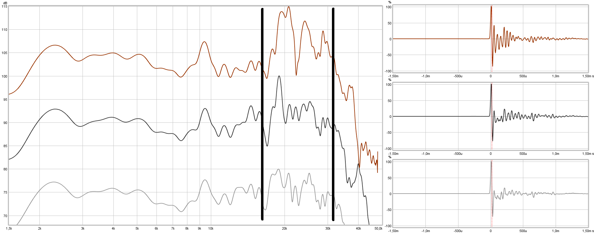

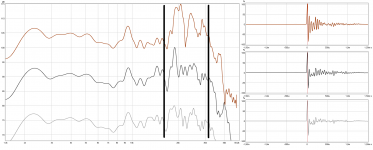

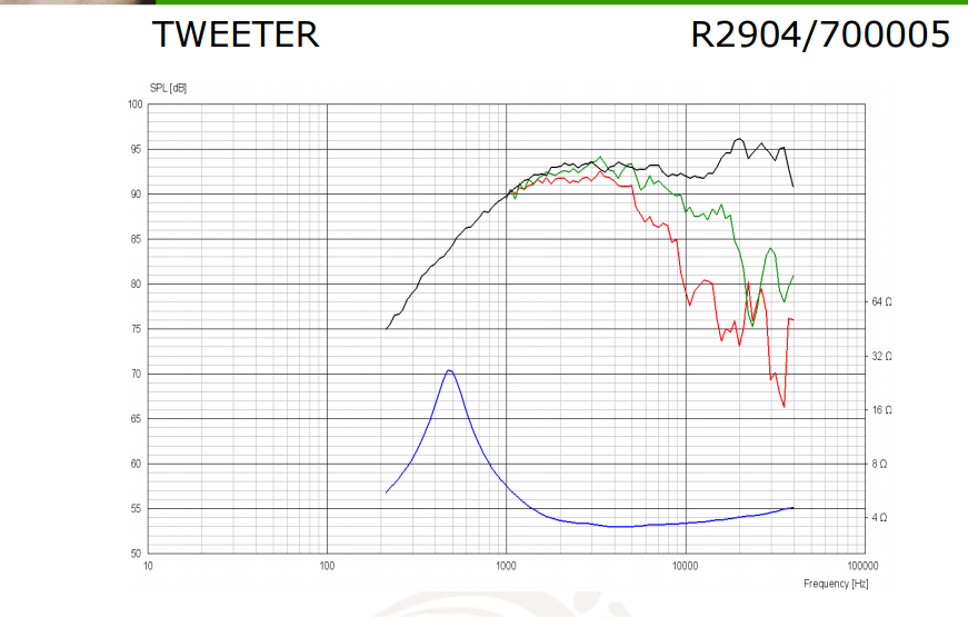

Datasheet for SB65WBAC25-4 show a 10dB raise where plot ends at 20kHz and below is my 3x driver from the distortion test measured at 96kHz. They seems pretty hot up there from 15-32kHz and not very smooth, and maybe they have even higher reach in that my measurements setup had not mic preamp Behringer Xenyx 802 and old power amp in a Luxman R-2050 reciever's frq response calibration included. Can't say if its related but something to think about in learning process of what we hear, not that >30Khz reach is unusual for tweeters, but real tweeters have usual more smooth response and clean IR. Plots are 1,5mS window without any smoothing.
Very interesting idea Brytt!
I am certain I have no hearing past 19,000hz. And I have EQ'ed the SB65 fairly flat - right up so am not certain it would be the 'hot top end'.

Mention it because had the measurements taken at higher bandwidth and my hearing is gone past 16kHz but if i run DSP at 96 or 192kHz and put high shelve boosts above 20kHz i hear a very clear change and if on axis it actual feels like one can hear deeper into recording and room. Below is 10F in FAST setup with simple high shelve boost verse normal 18kHz roll off, and because its not smooth above its normal roll off slope it starts look like SB65 with added HF ringing up to around 1,5mS point.

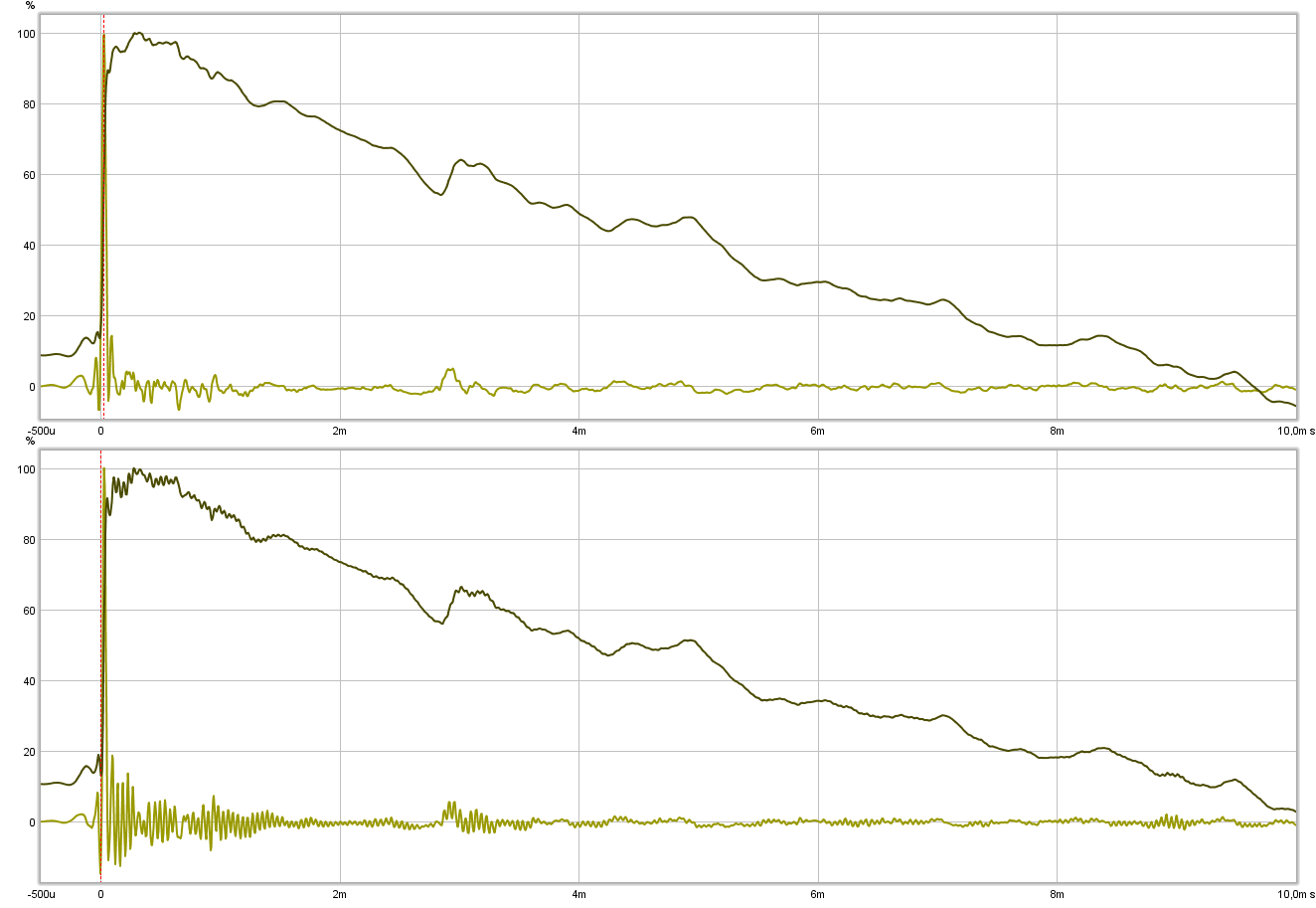

Why not show the IR and STEP, as measured at the listening position, along with the filtered IR and a spectrogram (to about 30 ms), or even better an APL_TDA plot.
If you do this, show the first ~25 ms in the IR, STEP can be in the same plot at that scale. The filtered IR could show 300 ms, and about 60 dB down from the top peak. The spectrogram about 30 ms (to show the early wave front) and for starters down to 25 dB?(*) That would show a lot of room for most type of speakers. Lately I love to look at how APL_TDA plots show it, you can still "see" the room. But a combination of both shows even more.
All three of them would/should show if there's less room interaction. Not trying to be a bore here. But as long as we are playing, let's see the graphs that support the speculation. That's the reason why I have posted that many graphs on my own thread. Let's learn how these things look and what the differences are. Not at 0.5 meter but at the listening position. In the end, that's where the magic should happen 🙂.
I'm hoping you're willing to play along 😉. Even better if you show it from the conventional speaker as well. Then we can compare even more data. In the end, the measurements should be able to tell us a story. All of the combined views should teach us where to look. Not the semi ideal close up measurements, the ones at the listening position, that's where we listen after all.
Sure, I know a filtered IR isn't telling everything, but we've got to start somewhere. Are you guys willing to play? I'd love to see that data. Even the early waterfall plots like I've asked about earlier on the thread tell me something. Let's learn people! Stop guessing, at least as far as we can. There will be enough left to guess about, I promise 😉. There's still more to be seen of coarse, but there's hardly any data like this around! Let's start somewhere! Sure this will be your room", but let's link a couple of these plots to what the subjective listening impressions say.

Probably reason is mostly pay back from the clever build plan and steered CD, enjoy sound and whiskey : )
