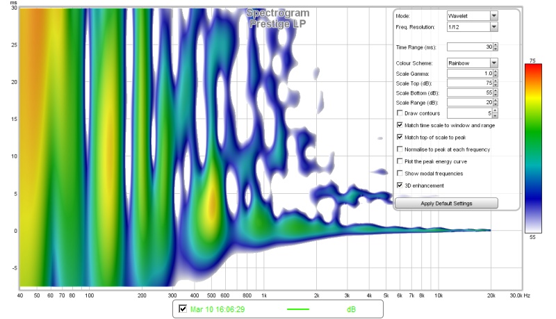

2 things that stand out immediately.

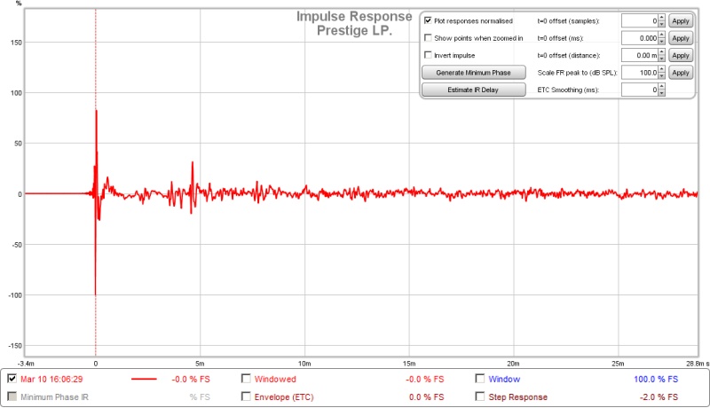

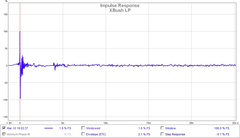

The early reflection at ~4/5 ms:
Prestige:
XBush:

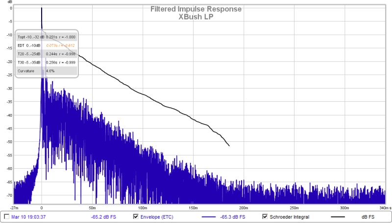

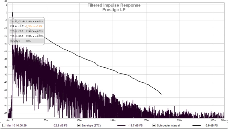

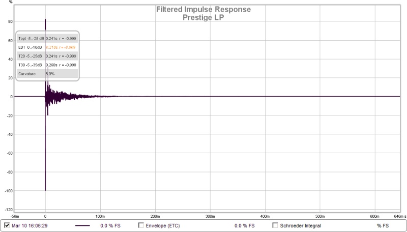

Seen even better in the Filtered IR (except for that pesky options dialog):
Prestige:

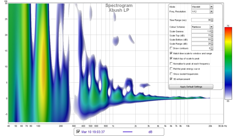

XBush:
The reflection peak at ~4ms is down by almost 9 dB! Making it nearly below the -20 dB mark. I love how that horn keeps the early reflections down. So you ARE listening to less early reflections, and not by a small margin. You should overlay those two to compare...

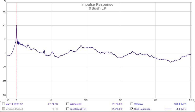

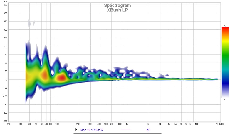

The second is the timing in the wavelet. It follows an almost straight line with the XBush. Less drop outs in that plot but I'd like to see the early 30 ms in the wavelet. Edit: seen it, both have room for improvement, that's obvious. The XBush shows a cleaner result where the horn guides the wave front. But both suffer from problems at 300 Hz, XBush more than the Prestige. That's a pretty huge hole. If I were you I'd play with the time range to see if you can figure out what's happening over time. Check FR and Phase at similar gating settings...

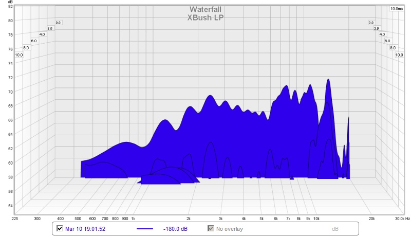

But what happened to the mid's output in the early waterfall plot of the XBush? it seems missing in action completely?
Prestige:
XBush:
Prestige:
XBush:
Thanks wesayso -
So it looks like my listening impressions hold water! The CD of the horn from 500hz upwards really does reduce the early reflections and allow that window into the recording.
My study is a terrible place right now for measurements and listening - I suspect the 300hz dropout is caused by the desk in between the speakers.
So there is little point me trying to optimize things too much, as I only just dragged one Xbush in here, perched it onto a stool and quickly did the measurement!
When they have a permanent home in my 'man cave listening room' I will look at solving issues as they arise.
But as I have said all along, even in this terrible, reflection ridden room with sub-optimal placement, the Xbush shines.
Maybe, but from my experience this kind of reflective surface (of this size) are usually more objectionable higher (800/3000hz).
I would suspect more something like a rear wave radiation issue.
Bushmeister next time (if there is one) maybe you could try to move speakers more inside the room (far from rear wall) or the inverse (closer to rear wall). If the valley (in fr, the 300hz 'hole' in wavelet) move you know from where the issue come (one of the reason flush speakers are great).
Overall this is quite nice: the 9db attenuation of ER means it will be easy to treat them using some sidewall absorbers.
The tradeoff for small sweetspot (versus a 90° horn) is gained in accuracy of reproduced message and easier acoustic treatment. Nice to be selfish sometimes!

I bet you are right - they are right against the wall, - although I would expect a lower cancellation dip as the front of the horn is probably about 60cm from the wall - perhaps a combination of desk/wall....
Anyway - I bet it is positional.
You are absolutely right about the 60 degree horn choice - I have many 'social' speakers, these are just for me!
I don't think the room is that bad, I only see one real big reflection there (the desk?) the rest is minor, the gradual decline in the ETC is quite quick, with a bit of help these speakers will knock your socks off! Check your mail .
