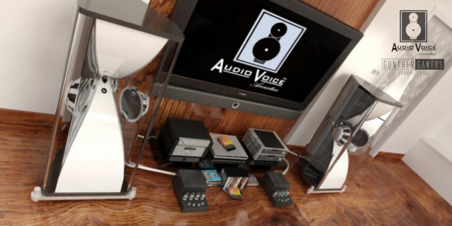

A Bookshelf Multi-Way Point-Source Horn
If I had not gone the line array route, the synergy concept would have been in my future.
I've been following all of the synergy threads on here for a long long while. After seeing the predictions it made perfect sense. There aren't that many concepts I can think of able to pull this off. Synergies make a lot of sense to me for the home environment.
All one's got to do is make it pretty 😀.
Something like this:
or
attachment.php
(Originally found on a Russian forum)
