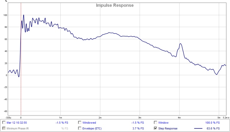

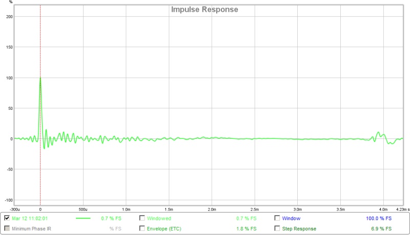

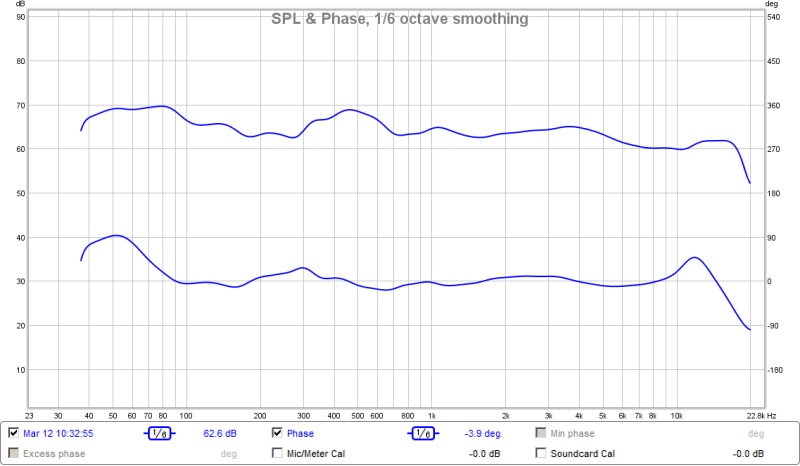

So wesayso sent me a convolution file to try.
So I downloaded the trial version of Jriver. Downloaded the WAV file into the convolution box. And enabled the WDM driver. Then I selected Jriver as output in REW and ran some measurements.
There is significant latency, so REW cuts off the top end - any ideas how I can get past that?
Anyway some initial results. I don't think the speaker and mic are in exactly the same spots, but some fairly impressive results nevertheless!
I've emailed you a couple of pointers on how to setup JRiver. We should be able to get this going, all the way up to ~18 KHz. There will be latency, as this is a phase correcting FIR filter with 65536 tabs.
Hope to see the full results soon. Take your time setting things right.
Yep!!!

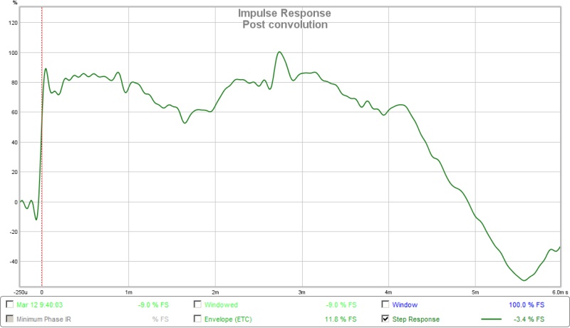

Amazing results - bearing in mind these measurements are taken 2.5m away from the speaker, in my study at the LP. 😀
You mentioned the speaker, nor the mic being in the exact same position. Now I'm not worried about the exact mic position, that's why we are testing a short filter(*) here. But technically the speaker should have been in the exact same spot. As well as anything in it's close environment.
But even with that disclaimer I think the power of FIR correction is already showing a little here. Did you listen to something? In mono? Something snappy... but with a good vocal?

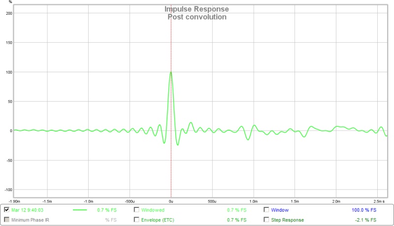

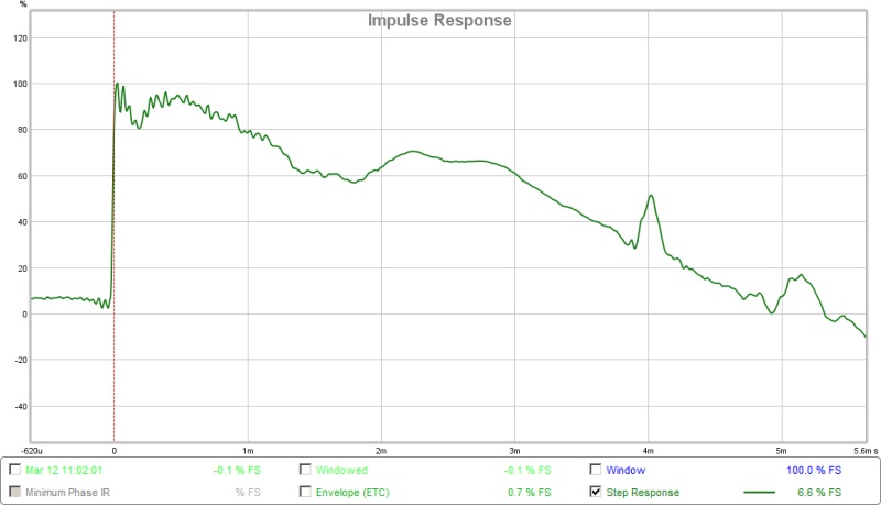

What we did here was to use a short frequency dependent window to correct FR together with an even shorter window to correct the phase on the low end, extending just past the x-over. If the speaker is up to it (and in my view the Unity/Synergy is) this will actually work over a large listening area.

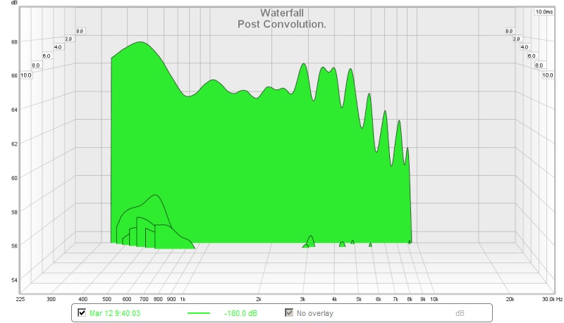

As is evident this correction clears up the early waterfall plot immensely. That is something you will notice in listening, no doubt. It's even beyond my expectation. Great to see that.
This is by no means a final result, as the setup is temporary. But it does show the things only FIR can do. This is speaker correction, more than room correction though you cannot avoid to have the room mixed in at the listening position. That's why you first need to make sure to solve things like early reflections, have a speaker that is consistent up/down and left/right. The Unity/Synergy can do that.
In a permanent setup you'd need to worry about toe in etc... to get the best of it, but due to the Harsh crossover and the low level of early reflections I figured this speaker was a prime candidate to show the potential.

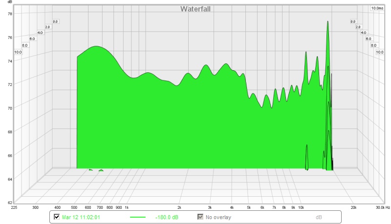

The early waterfall plot shows great potential. It is showing the diminished cone movement from the tweeter and the shared load of the woofers does work to get a really clean midrange and even a very clean top end. Would love to listen to a setup corrected like this.
Many more ideas to try and improve the listening experience though, but this should be a nice start.

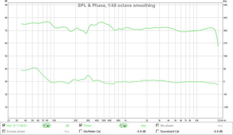

Ronald low limit of correction is set to approximately 100hz?
The FR correction is 20 hz to 20 KHz, the extra phase correction is using a shorter span, not correcting the top end. That part is more "in room" correction.
The waterfall only shows the first 3 ms.

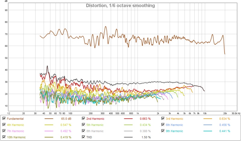

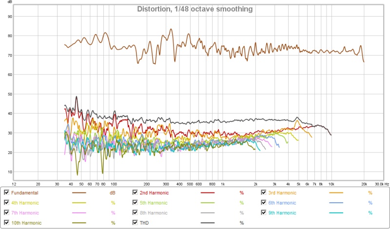

Allow me believe i can see sample rate conversion (SRC) distortion in REW plot, if you can manage to get all hardware and software to be in exactly same sample rate setting under measurement then 250uS before and after IR will be even cleaner. In practice i mean because UMIK-1 is a locked device at 48kHz it will be steering setting for measurement so in windows sound settings set output device also to 48kHz plus set the two software pakages REW plus JRiver also at 48kHz. Feel free after that to use whatever settings but because of UMIK-1 48kHz locking then for measurement chain to be as clean as possible set rest of chain to same.

Please show a waterfall plot of the early signal of your speaker to compare.

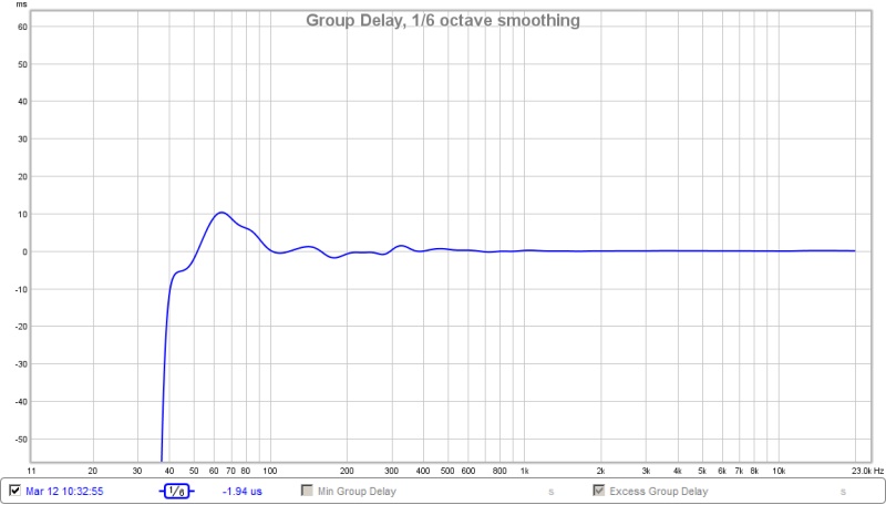

The speaker moved, all bets are off 🙂. Phase correction is only valid at a single point. I'm not trying to correct all of it. Don't trust the REW group delay plot too much. Better to use APL_TDA for that i.m.h.o. In REW it's never going to be an exact representative.Ok i would have thought it could counteract the group delay of the acoustic lowpass the box represent for low end as it should be easily treated*, so my question about low fr of treatment.

The FR was corrected up to 20 KHz, speaker correction with a very short frequency dependent window. Just not the phase part separately. But the phase still is more minimum phase than before this correction was applied.
That is evident in the STEP.
EDIT Forgot in above that also JRiver WDM virtual output device need tweaked to 48kHz.
My correction was a quick job, which had is own conversion from 48000 to 44100, so that would be me. 🙂 Bushmeister knows it's sub-optimal (I think).
Don't blame him, that's my doing, I didn't have the files ready for 48000 as I run all my corrections at 44100. Only my DAC up-samples but I never could live with up-sampling everything in JRiver, for whatever reason. It just sounds a bit off to me for whatever reason. Never bothered to look into it.
I did try a long time ago, even though the plots seemed cleaner, my ears said something else. These plots are average representatives and need to be picked apart to tell the complete story. Especially the IR. That's why we need so many different ways to look at it.

I've seen FIR used to 'correct' phase behavior of closed box acoustic lowpass behavior. what i was trying to explain was related to this: as net volume of XBush box is approximated, in order to determine qtc (then the groupdelay intended of couple box/speaker) and verify it correlate to FIR correction done. But it's different that what you are doing: DRC.

This time you could as this is pure assumption and shot in the dark! All that can be said is that this is a reflection which traveled approximately 1.3/1.4 meter more distance than initial signal.
Could be some side wall or ceiling ER too.
