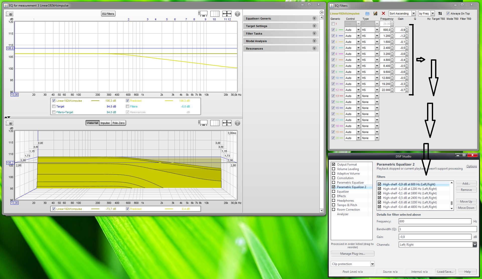

Notice target is flat so if down the road under listening it gets too hot attach a 5 minute operation into REW PEQ container that with 11x Q=1 high shelving filters give very close to original B&K curve starting downward tilt at 400Hz.
Interesting to see an implementation of that curve. Nice.
Another alternative is 1.1khz hinge point an 'linear' attenuation at -1.5db/octave up to the highest you can. Work well with my monitor (direct radiator mid/tweeter).
When i say linear i really mean it so it is not easily implemented using shelf filter or even graphical (rare are the graphical eq which are not in fact bell eq stacked in serie so they never end as a linear attenuation general profile), my dsp allow for that (in Lake you have 'Mesa eq' which give 'linear' target when used as graphical eq).

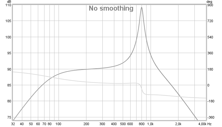

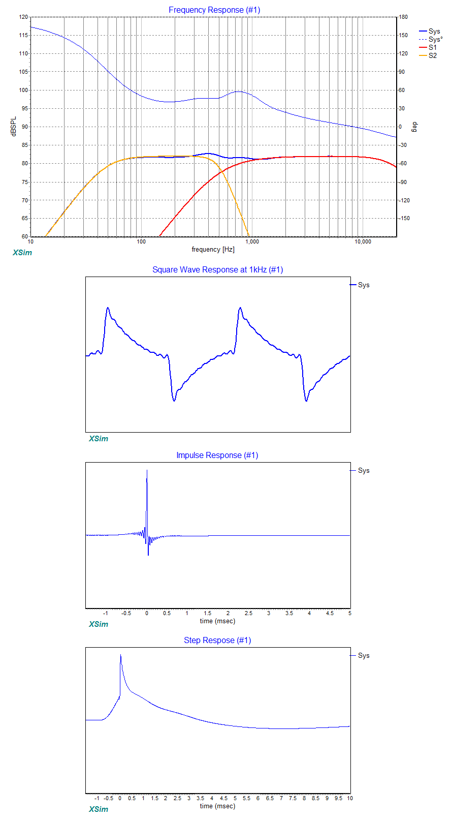

Hope this can help in that pretty sure that when speaker was planned it was calculated that either woofer injection ports position should be placed in the correct position for timing relative to tweeter, nor should injection ports acoustic low pass be the natural precision slope for intended XO point but just have enough bandwidth. Planned from start was build would need DSP steering and this gives freedom to best placement of injection ports in other regards on a low cost consumer horn that is really not brought to market in first place for be used as a point source horn.
Therefor think you too fast when complaining about acoustic low pass of second order is wrong because wesayso make some FIR cleanup. Planned acoustic low pass running minimum phase XO is not 2nd order but BW4, and filter is Harsch concept which have BS2 high pass slope for tweeter. In first picture Harsch XO can be seen and with correct set delay for tweeter will give a nice transient response compared other minimum phase filters. Also EQ is needed because woofers acoustic 4th order symmetric bandpass have huge resonance ala what is seen picture two.

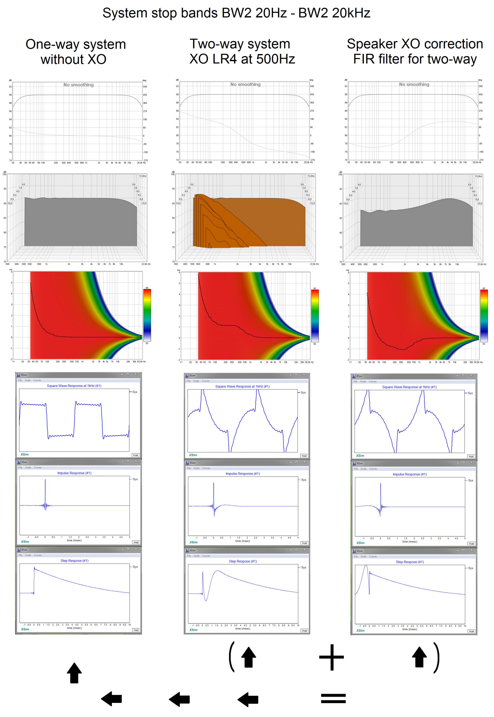

Picture 3 is to show how a minimum phase XO point or should we say stop bands or high Q amplitude changes adds ringing to waterfall. As seen in first column a one-way very wideband driver throw very clean waterfall and waveform, where column two show with a LR4 XO example and the ringing plus waveform distortion it adds. In column three is a FIR filter with nothing that the inverse phase correction to clean exactly the LR4 XO distortion in column two. This FIR filter is speaker correction but wesayso use DRC which handle room correction too plus think he is very good setup far field data at listening position.

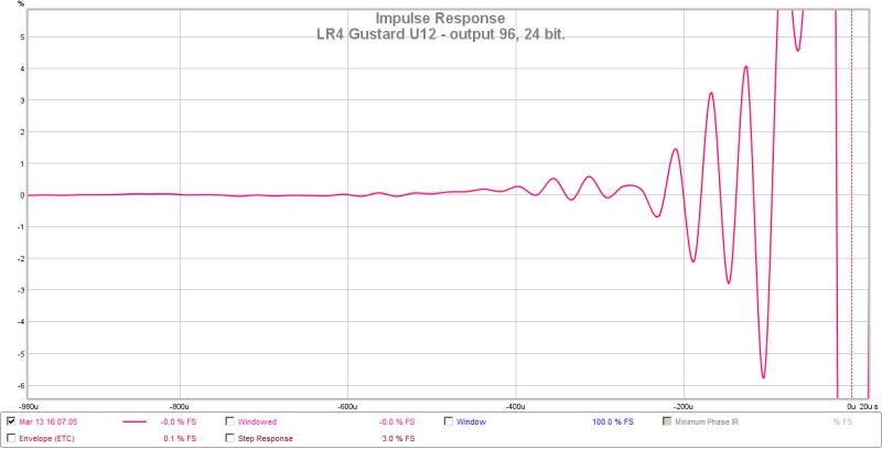

OK guys - after you all noticed the digital artifacts from the sample rate conversions that weren't optimized a few posts ago, I started thinking about my digital source and processing a little more.
I currently use a PC source with foobar and my source material is nearly all 44.1, 16 bit. I output this material via USB into a Gustard U12, then via AES/EBU into the digital input of my miniDSP 4x10 Hd with 96Khz plugin.
I am aware the miniDSP 4x10 HD, re-samples all digital inputs to 96KHz, 24 bit depth internally.
The Gustard U12 uses XMOS - U8 chip, Two 0.1PPM precision crystal 45.1584M 49.1520M, nice power supply etc. And is highly regarded.
So I am wondering if it is better to get the Gustard U12 to do the sample rate conversion before the 4x10HD. i.e. Change the U12 to output 96KHz 24bit straight into the 4x10 HD, so the miniDSP doesn't have to do any internal sample rate conversion.
To explore this, I tried looking at the impulse responses with the two set ups.
I am aware this is a little off topic, but would like to get this side of things right given the potential of the Xbush speakers. Note - these measurements were done using the prestige speakers.
Does anyone think there is a significant difference here?!?
Thanks for your advice.

You forgot the K-hz😀
Bushmeister, loop back the output of the mini DSP to the line in with a cable. That way you're only looking at the signal itself and the components involved, a speaker has way more problems than that.
A loop back of my PC to DAC to line in looks like this in APL_TDA:
In REW you can closely examine the differences with a loop back like this which should present you with the cleanest IR. The 16 bit option is always wrong. Even 44100/24 bit will be way better for headroom. From that point on it depends on the up-sampling. Which device does the best job, do we even need up-sampling... etc...
I have an up-sampling DAC. I feed it 44100/24 bit for now, until I find something better.
You've got to realize the IR REW presents is just a chosen form of presentation. Sort of like a rendering. There is much more info in the IR than you see in that standard representation. Do not go past that fact. It's the reason for all the different looks on that same piece of data. The waterfall, the Wavelet etc.
It's all the same data looked at in another way.
