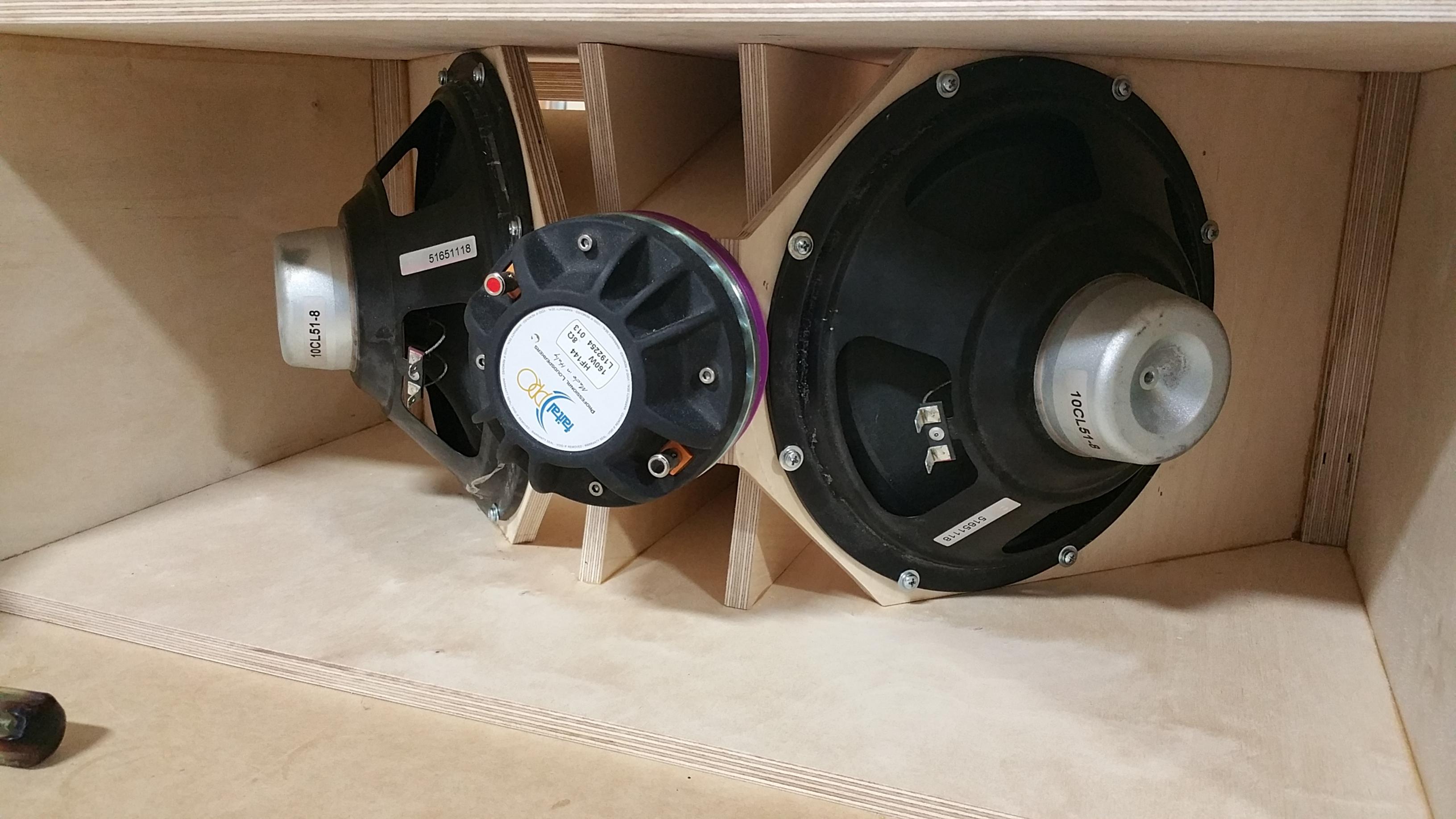

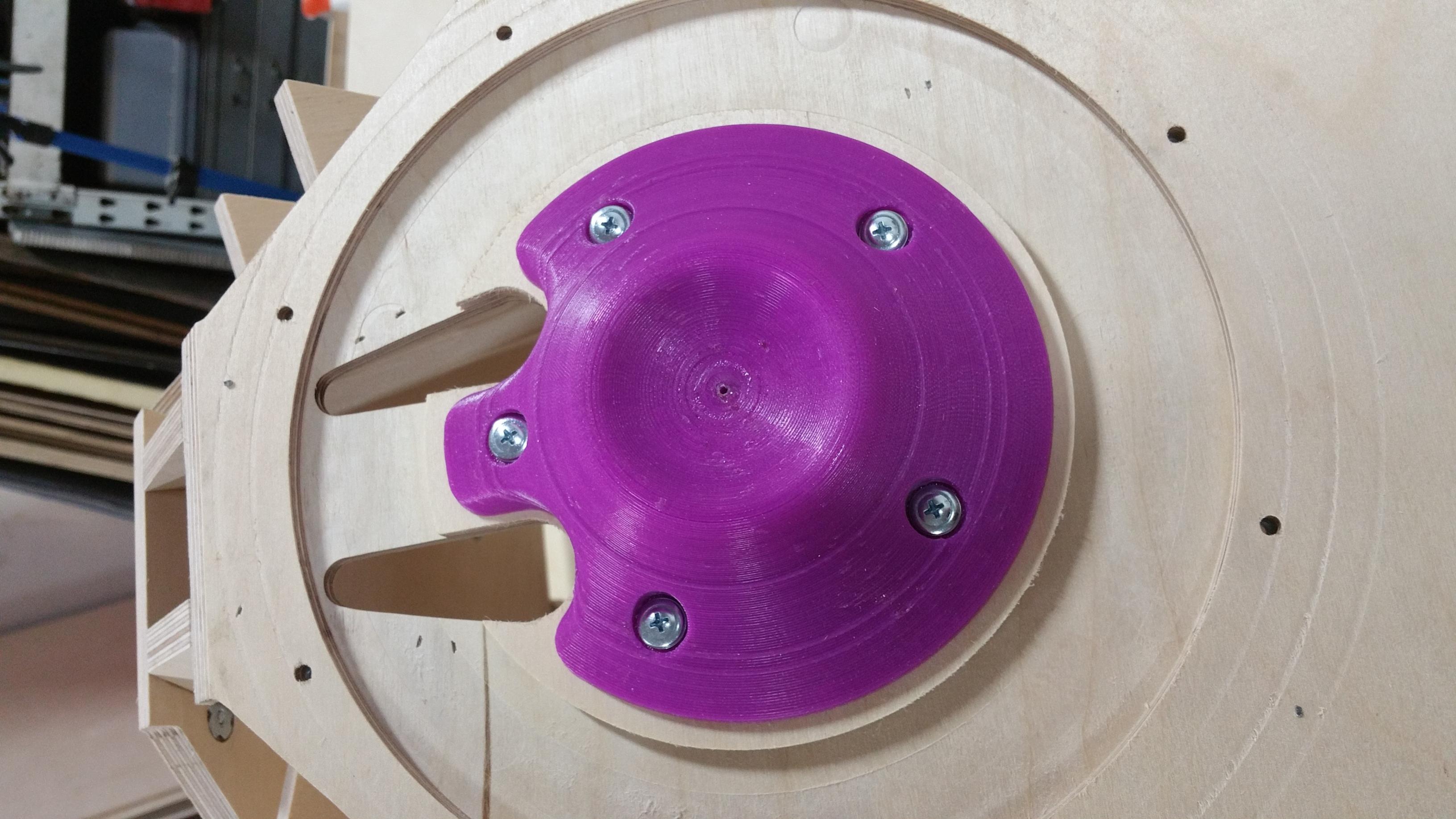

😀 weltersys have 4x TC9 on duty per side....he did take part and share a lot in this thread. Picture below is from weltersys own thread, the one that X link to regarding Jennygirl's new horn build.
Myself talks mostly 10F because i have it and also motor is stronger to push into a horn, but its nearly 7x the cost a TC9 and is not 7x better on sound, feel in camparison its some smaller finesse better than TC9 when used as open direct radiator.
