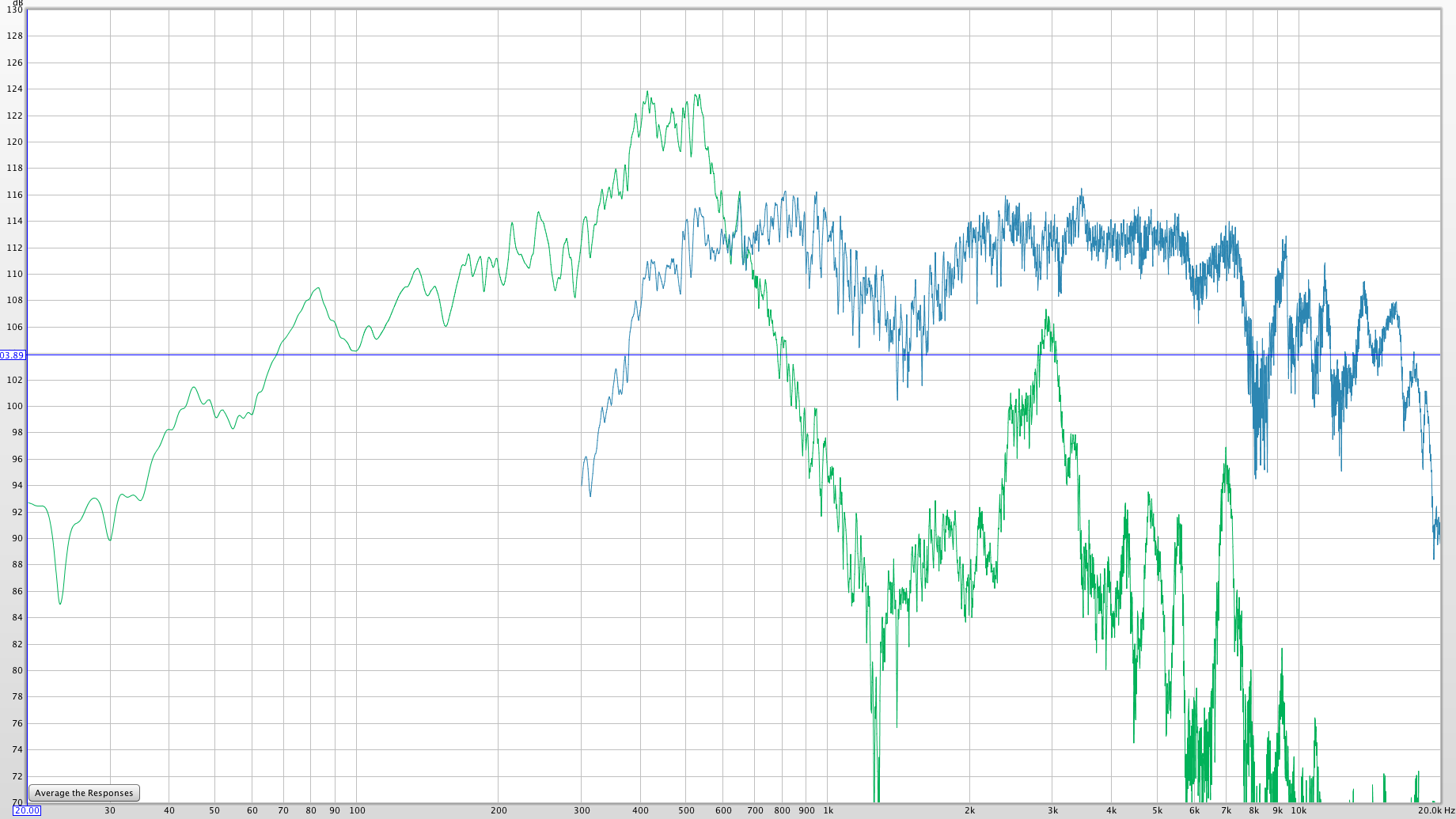

Raw responses - ca 30 cm away from horn mouth, after adding some stuffing.
Note: CD had 10db lower output level.

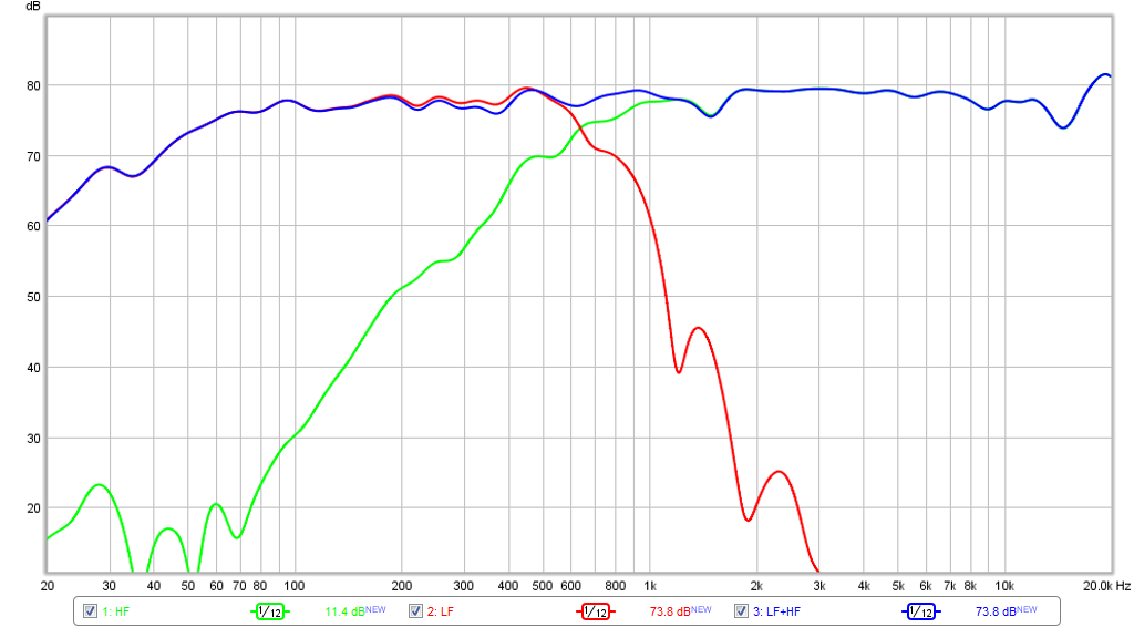

Here is the XO plot with 600Hz XO (BW4 LPF and BES2 HPF both at 600Hz electrical):

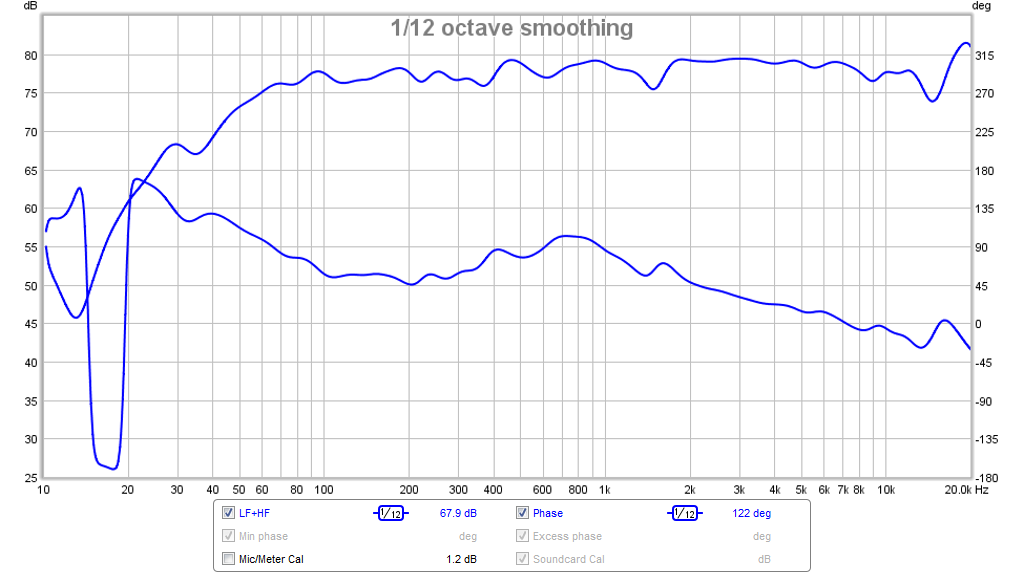

Here is the measured phase with the characteristic 55deg bump near the XO point, F3 is about 50Hz.

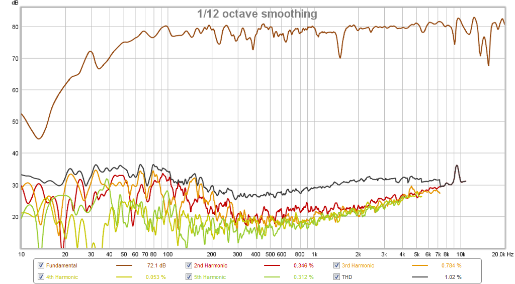

Here is the distortion:

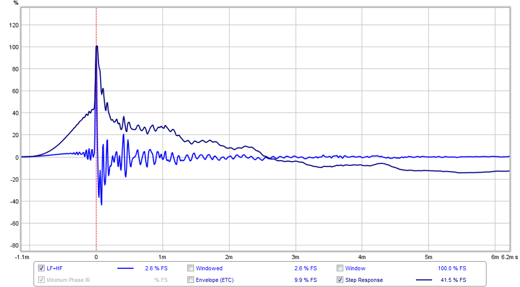

Here is the impulse and step response:

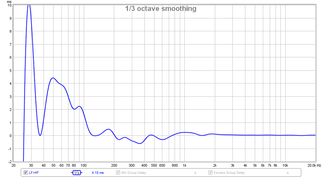

Here is the group delay with 1/3rd octave smoothing (all under 5ms above 40Hz):

The mids and highs of the TPA3116 or TDA8932 or TDA7498 are all excellent - but they don't have as low of HD at 50w as the VHex amp (0.005% at 1khz 50w into 8R).
Subjectively, the biggest difference I hear is a tightness in the bass and ease of play - there is so much headroom the amp never sounds stressed. I can clip the 3116 but here I have to be careful about blowing the driver.
