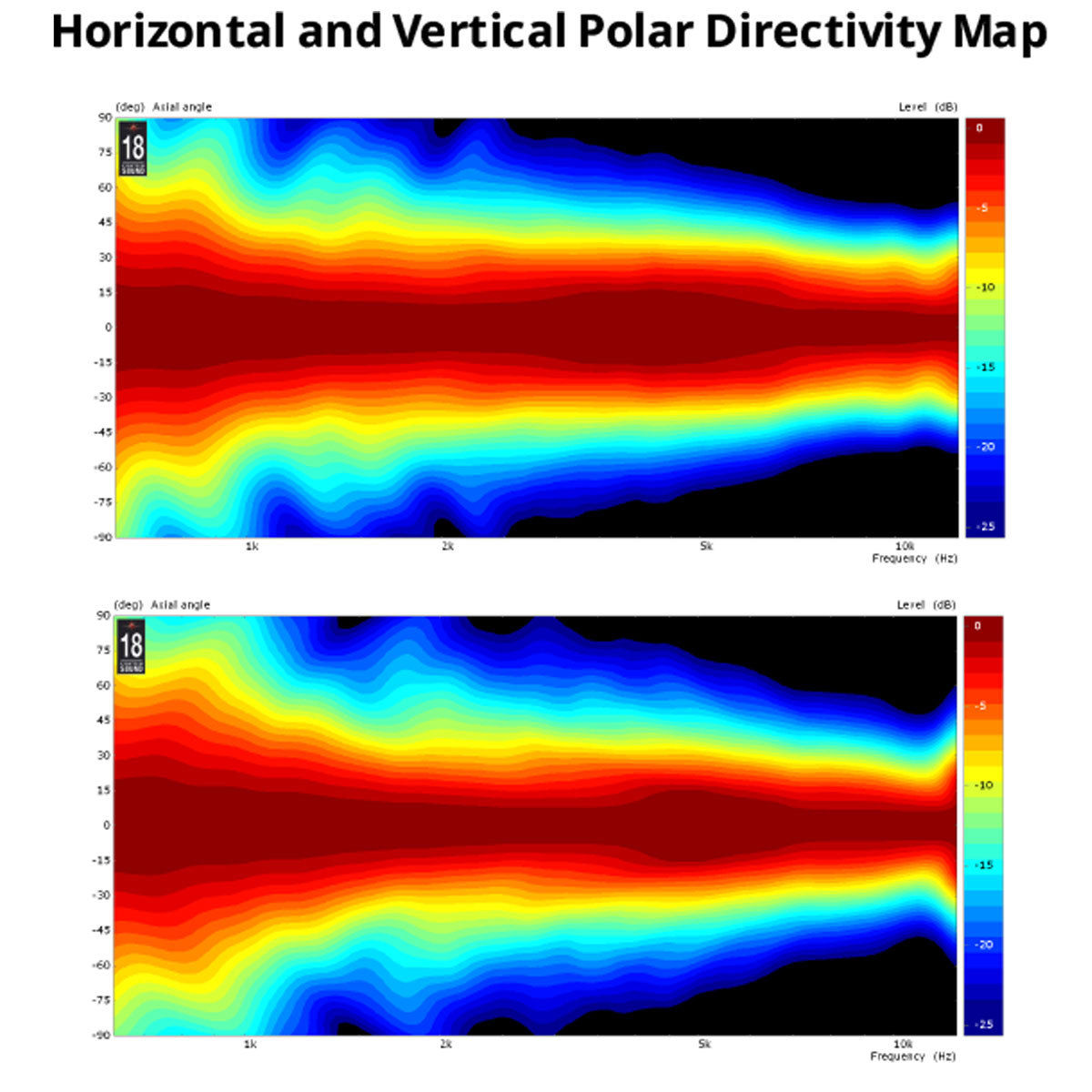

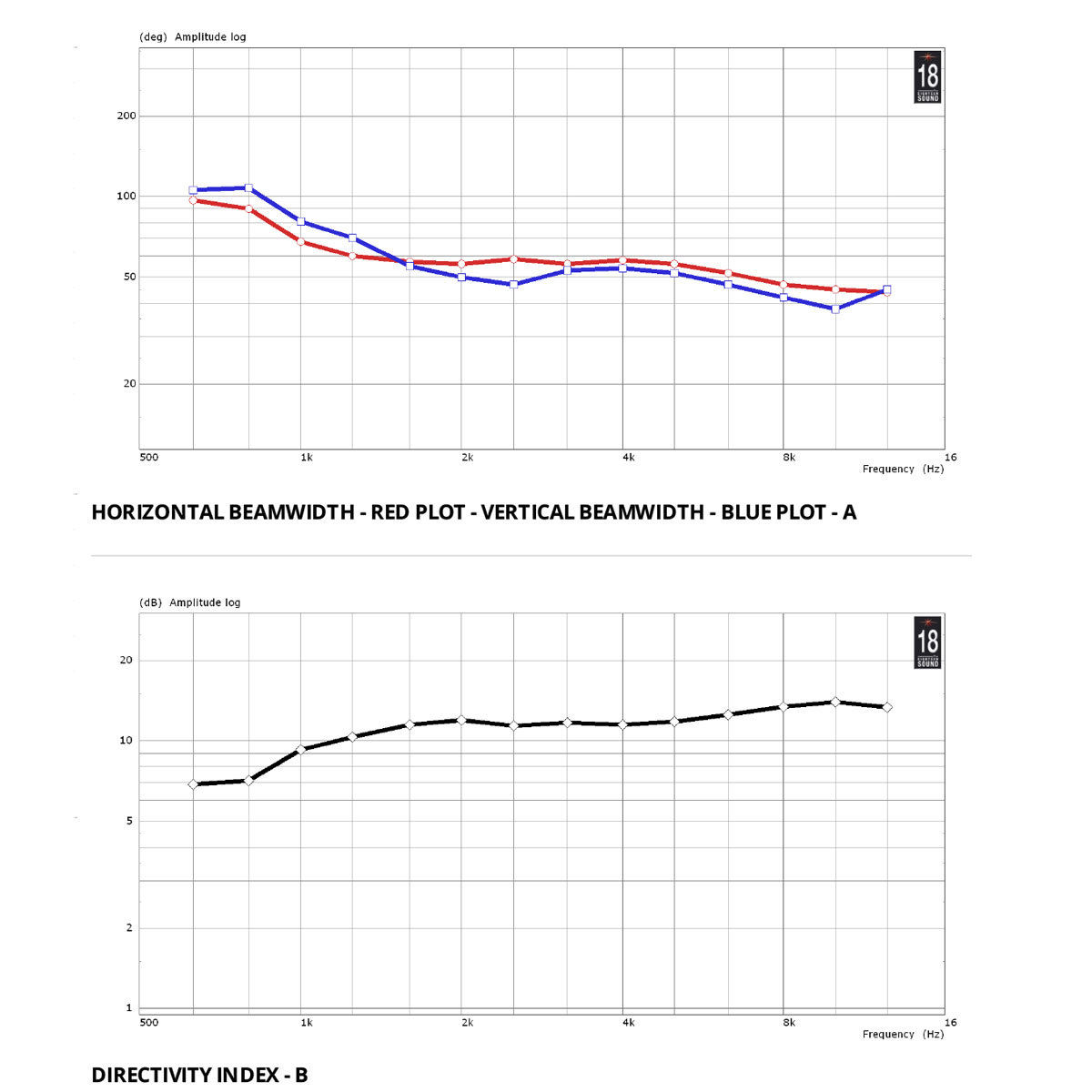

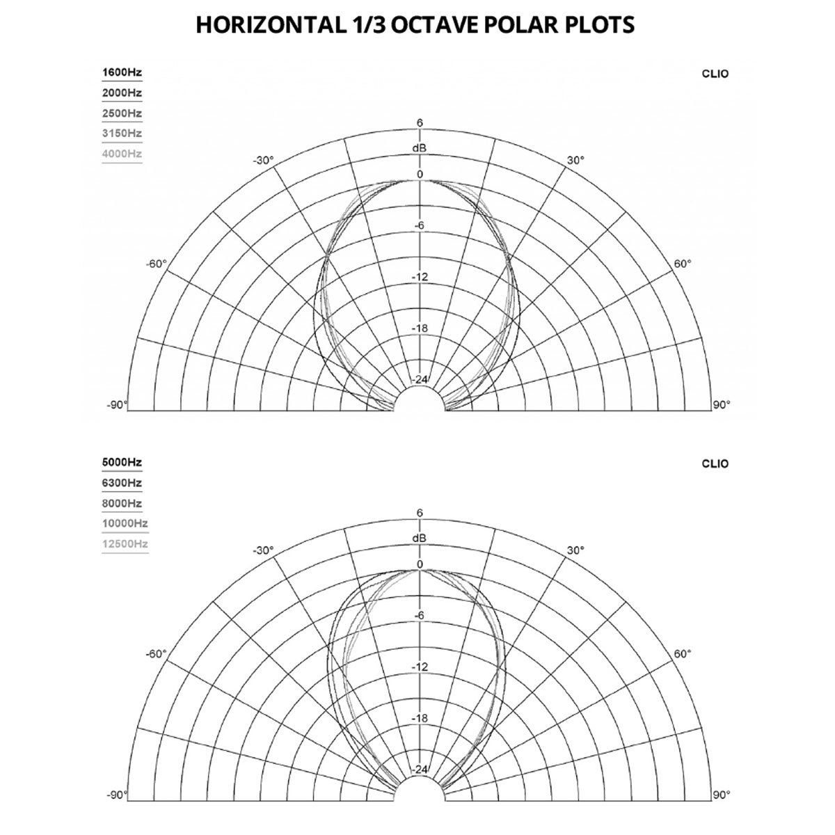

My first contribution in this thread was to point out that the horns you use have a quite uneven beamwidth,
Really??? They look OK to me.
My first contribution in this thread was to point out that the horns you use have a quite uneven beamwidth, as they are not conical, like the one in the original Synergy is, but more or less exponential. And a beamwidth which i consider too narrow in the trebles: I do not believe that there are so many people living in full nude rooms listening to music only while being glued into a certain fauteuil which is glued to the floor, to justify 128 pages on a serious technical forum. You buried this in order to add 3 more pages.

Yes, this measures like a good monitor. But the following horn taken from the beginning of this thread radiates more narrowly:Really??? They look OK to me.
For me there are horns, which are acoustic transformers, and direct radiators. What is no horn, is a direct radiator, even if the wave first travels thru a transmissionline before entering free space. About lobing: Your designs use two woofers with each at least one port. Each port is a sound source. So you have two sound sources outputting the same frequency. So you get lobing, if the distance between both ports is greater than lambda/2. About baffle size: The best baffle is the infinite one. Less than that, and we get diffractions. On the other hand the loudspeaker is often supposed to be a piece of furniture hence must have finite dimensions. One of my principles is, that recreational loudspeakers shall not be concave like horns but convex like CBTs. About FAST: I have no grump with that, quite the opposite. I have a little grump with FIR, which i consider faking.971 said:Not sure where all the animosity for a point source FAST concepts comes from. We never claim the bass is horn loaded with horn gain. It's certainly not a direct radiator. Anytime a cone goes into a chamber connected by a narrow duct to the outside world it stops being a direct radiator. It's by combining the woofer output into a larger duct (the waveguide) that it becomes a virtual point source. This will be free from vertical as well as horizontal polar lobe variations like a D'Appolito would be. Let's not forget the added benefit of reducing. The front baffle size relative to having two direct radiators.
My last polar directivity measurement with the bass injection holes was this:
Seems close to the contour plot above for LTH142 (60deg x 50deg horn). The holes added some wiggles but overall, very close to pristine horn. I am using in vertical orientation, so design goal was only 50 deg full angle beamwidth - or somewhere between the green and blue lines.
