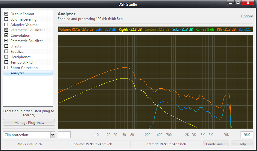

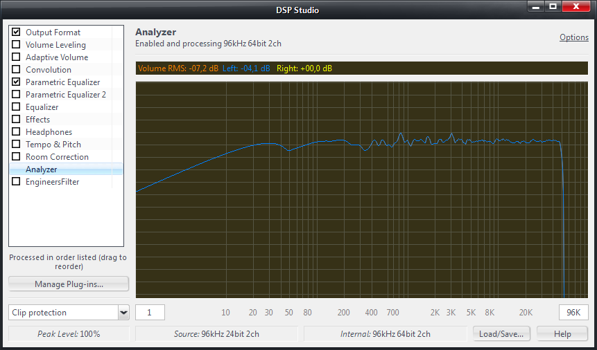

Took a check my own DSP what electric signal it sends to DACs and can see would benefit power amp for woofer had some make up gain or more sensitive input, or even better XO in 80Hz area as bushmeister's new plans. DSP is JRiver and internal run 64bit plus DACs are 120dB capable so there is some DR to do with.
Signal sent to DSP in first picture is normal pink noise so to see electrical speaker correction and scale steps 3dB, second picture is acoustic output on axis at one point in space, and third picture is same pink noise seen on another computer without any filters.

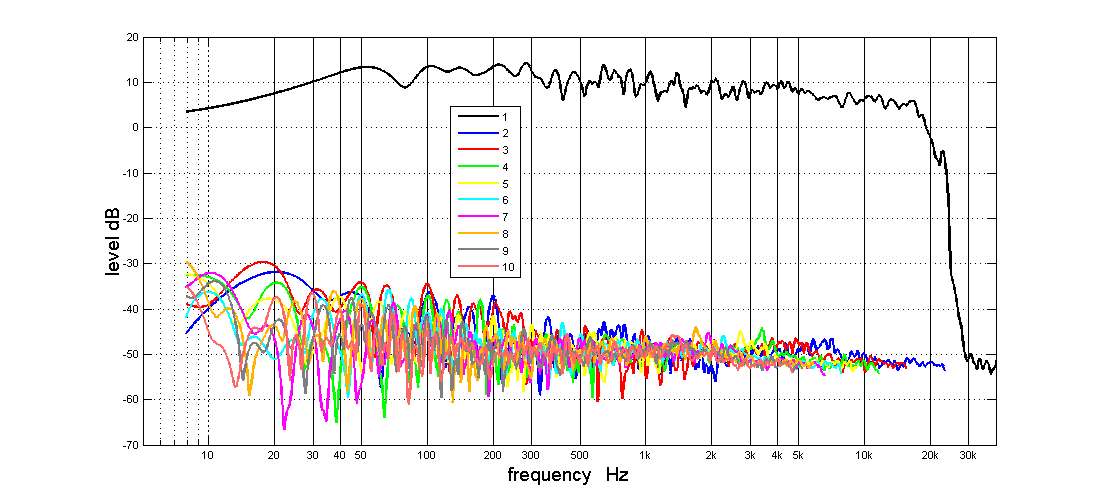

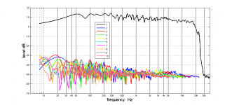

The example above uses 21 dB between highest and lowest peak. Maximising the gain as to (just) not clip the signal and you're still left with about 16 bit resolution. Gain structure is important though. You don't want to spill bits unnecessary.
That's some difference in top and bottom though. You have almost as much difference as I have. I use up 24 dB between the lowest attenuation and largest peak. But that does make it flat from 17 Hz to 17 KHz. My DAC does 20 bits according to a test on Stereophile. Which means I theoretically still have 16 bit left, as long as I adjust the gain structure properly.
My room does worse than that though 🙂. Or my ears.... and even my speakers! I bet I don't get to enjoy 96 dB of resolution...

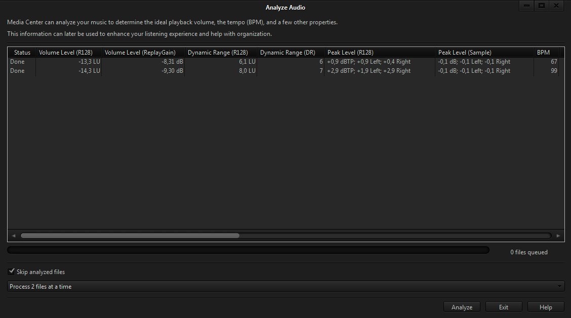

That would depend largely on how the device is designed. I know how this works in JRiver, and if you look at it form that point of view, I attenuate everything because I create the needed headroom by lowering the internal volume in my case.
I make sure I don't clip my signal when it's maxed out. But You have to know the device you're using to know if you indeed use all those bits. Wasting headroom is a waste of bits. Having headroom is a necessity 🙂.

Here's JRiver's analyser on a couple of tracks. So even with all the care in the world, it's already clipped. I whish it was an exception. 😱
Do note that in this above example, the sample remains under that 0 dbfs number. But the R128 algorithm reports clipping.
