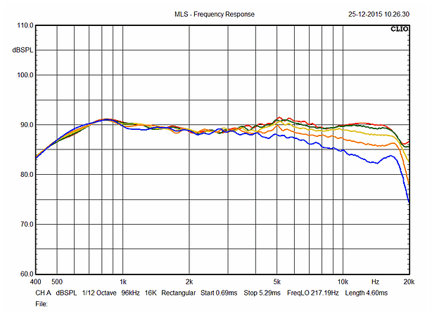

The RDC has a soft dome, the VHF is radiated from the outside, near the voice coil. It actually has more narrow dispersion than the 3.5" TC9.
The ADC dome is more pistonic, dispersion is much wider, as well as having more Xmax.

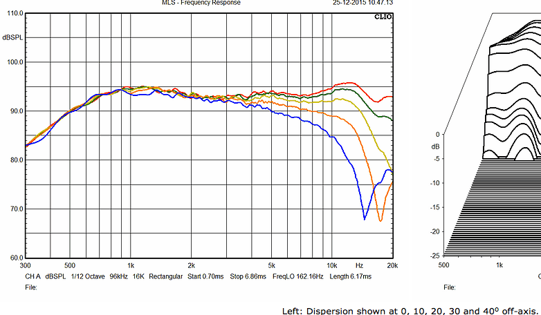

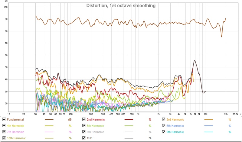

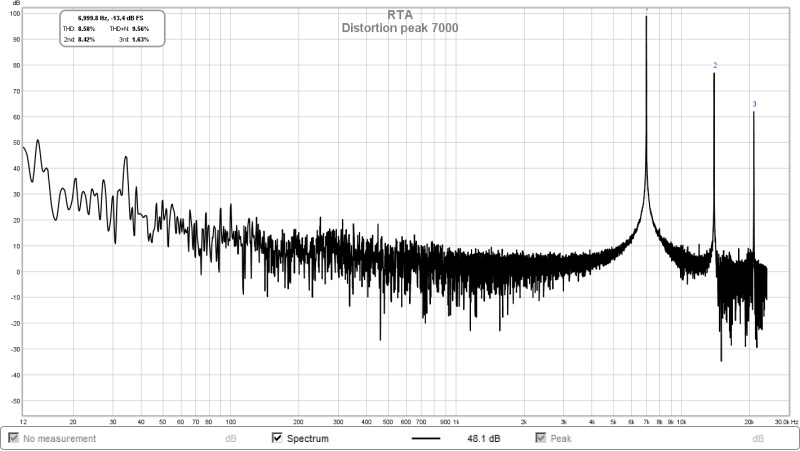

OK guys - took a few moments out from my listening to do some distortion sweeps of the second speaker I made - I am a little worried by an odd peak in the HD at 7000Hz.
I just wonder if I have a faulty driver - should have done some sweeps before installing it!
It is a narrow spike which isn't present on the other SB65 and is -35dB down - so extremely likely to be inaudible - but if I could solve it, I would like to. I have tried relaxing the screws in case I had overly tightened it down.
It doesn't seem to be broadband in nature so I don't think it is rubbing of the surround or a mechanical problem. It is also present when taken off the horn.
Bushmeister, does an impedance test of the separate speaker show anything at that frequency?

That's a overly tight screw on the SB65.
Brytt you are a star! Could you just do a quick distortion sweep at 30 cm, naked driver around 90dB?
Just to give me an idea of the levels to expect. Thanks so much. I know your way is the right way - but hate the idea of ripping them both down - so will just pull the defective driver first!
